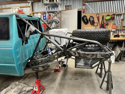

1993 Camburg ranger build.
Now comes the fun part. Mounting the cooler, trans cooler, battery, tire strap, jack & handle should have some progress pics over the weekend, I got most of the plumbing stuff showing up over the next few days. Can you mount a harbor freight jack on its side?

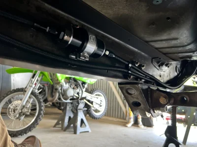

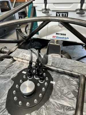

I sooo wanna jump ahead and just skip through things, but this is the first truck I’ve done from the ground up. So I wanna make sure I check all the boxes of the stuff that’s gonna go back there. I’ve collected parts for years to be ready for this moment. 😂 I think with the info marcel provided I’m gonna mount that jack on its side and see what happens lol as a experiment before I read all this I left the jack on its side for a day and then put it right side up and she pumped up just fine. I ordered most of my plumbing shit off Amazon. I decided to see what happens and use the EVIL MFG branded fuel pump, filters , hose and AN fittings. The quality seems about the same as XRP. I had to ship the fuel pump to my cousin in Colorado! It’s getting ridiculous to buy stuff in CA

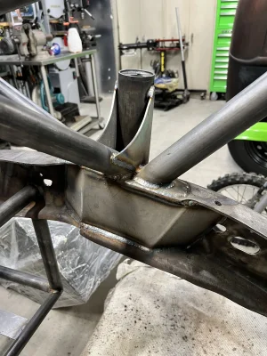

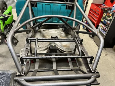

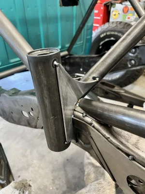

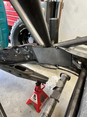

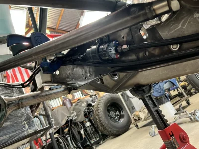

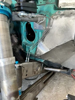

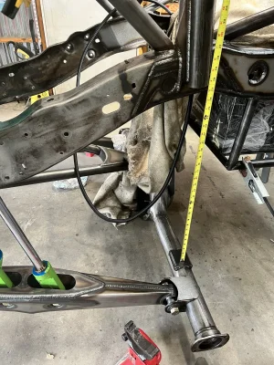

Well I got swapped to working a swing grave yard shift for 3 weeks so progress slowed a bit as my days off were Wednesday and Thursday but here is some progress!

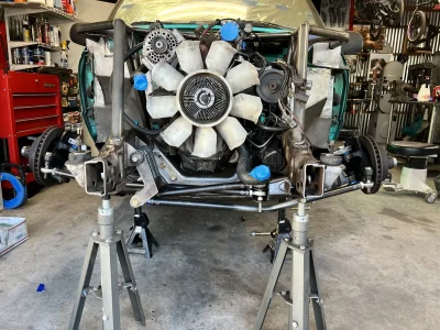

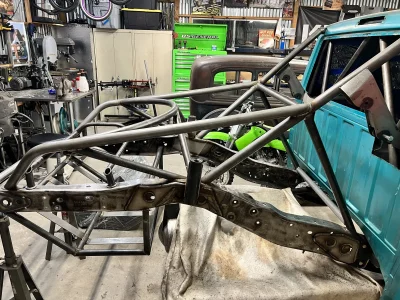

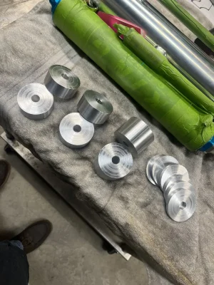

I bought a piece of round stock aluminum to make some body mounts and my buddy / Roommate talon took them to work and turned them on the lathe to delete the rubber ones. As far as droop goes the trucks got about a 1/8” to go but it will most likely will be strapped at 24”
