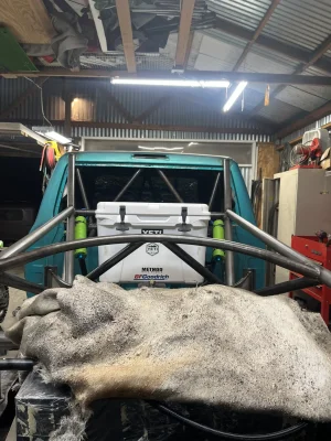

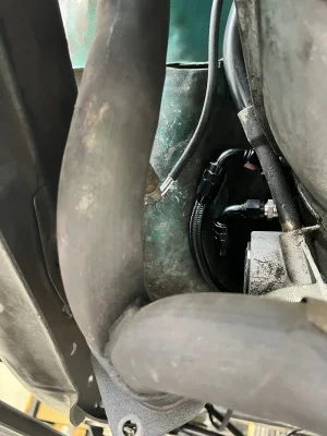

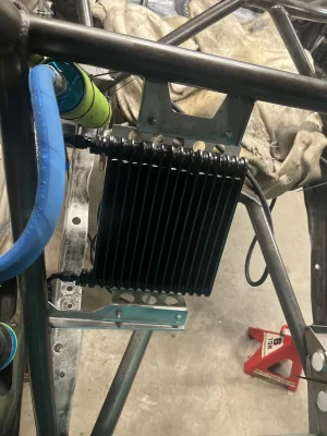

1993 Camburg ranger build.

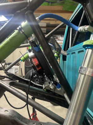

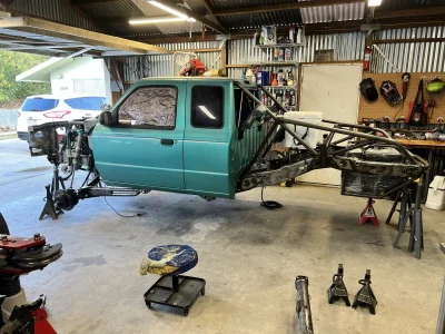

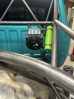

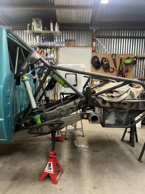

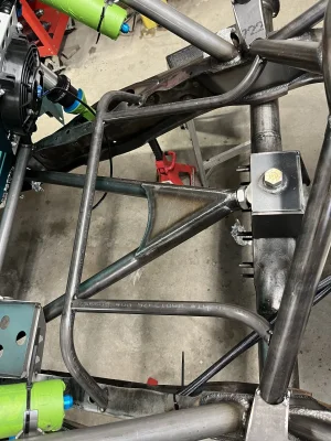

Trans cooler, battery and coil over resi’s are mounted chipping away at this thing.

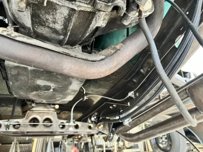

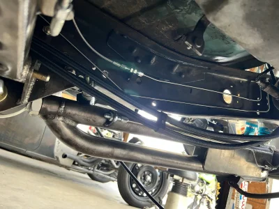

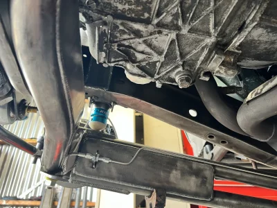

Here’s the front brake lines for the truck. I’m waiting on soft lines and some more bulkhead fittings from Kartek to finish up the rear, My other question that maybe someone can answer is where should I run the transmission lines? Tuck them up on the cab floor with some straps and rivets?

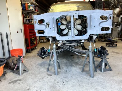

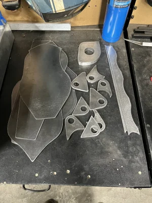

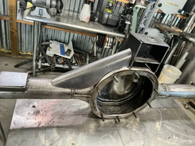

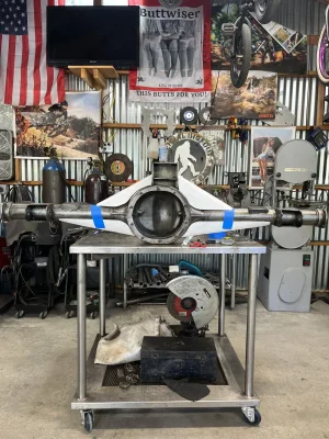

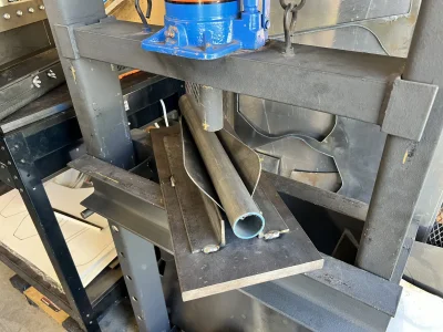

plates are cut out. The weekend was spent drawing and coming up with a punch list of things that need to be completed. I finished plumbing the trans cooler in and pressed in some ARP wheel studs there 1/2” for now. The 4.0 with A4LD should be the limiting factor

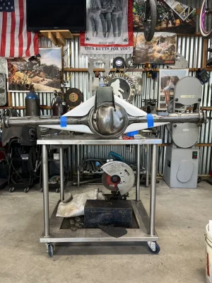

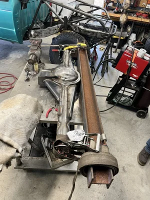

On the axle I used to use a chain and bottle jack when I would weld the rear truss on. I would preload the axle once chain around the end 1/2" on the bottle jack in the diff pushing against a block of wood. I would also just jump the weld from top to bottom of the truss in 3-4" of weld on each. Then I would loosen the jack after it was all welded. I did that one 2 or 3 rearends and never had a problem with the axles not being able to slide right in no problem.
