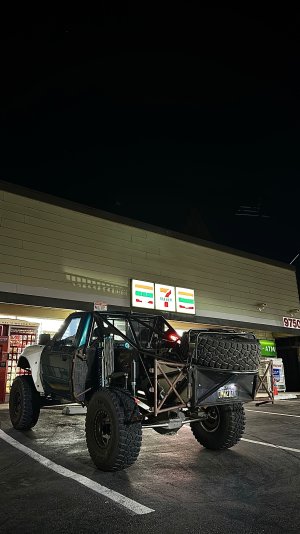

Said screw it and cruised to 711 up the street for a beer mid wrench

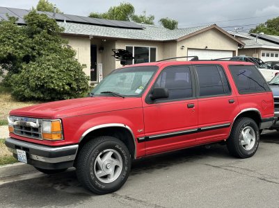

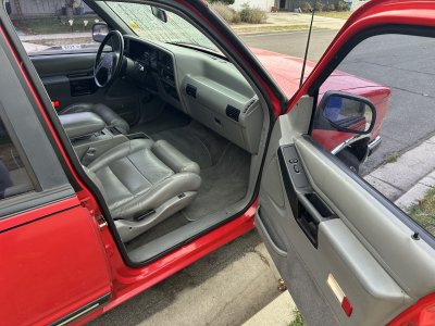

I’ve wanted an explorer for a while now and have always been looking. More specifically for a paint matched one. But they’re always so beat up. Came across this 91, 80k miles, 1 owner, garage kept. Bag from the dealer and all the og manuals. Pretty clean inside, could use a lil headliner help.
Stoked! Excited for other types of off road adventures. Plans so far is keep it clean, simple and reliable! Could use tires so I plan to get some ko3s. I was set on getting some AR62s to put them on but the stock wheels look kinda tuff imo.
