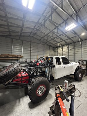

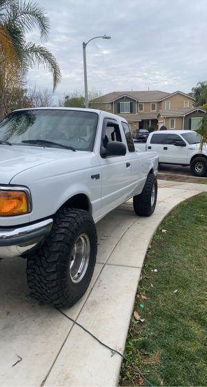

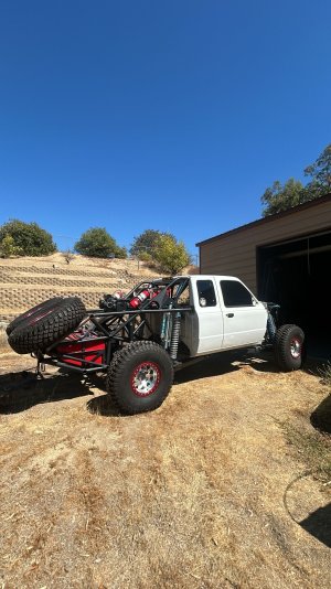

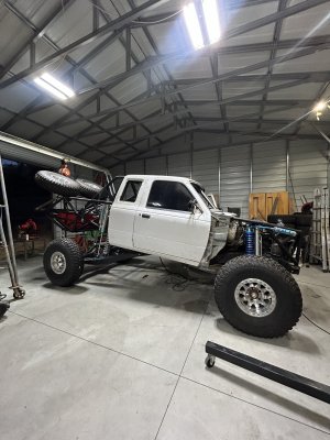

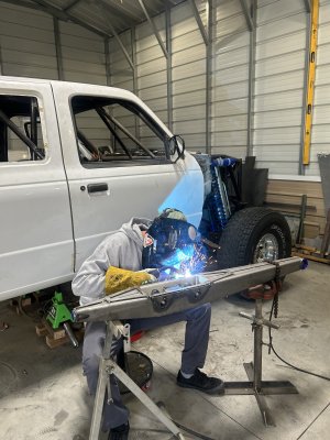

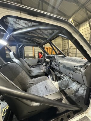

Been building this truck for about two years with my buddy in his shop, bought this truck stock in high school. My buddy convinced me to start building it, and it snowballed from that point!! The trucks about 90% done still not complete. I’m running the 4.0 v6 in the truck, 1’inch king pin 6.5 over beam kit, 2.5x14” coilover, 2.5x16” bumped and strapped at 19”.Fully caged with prp seats a long with prp harnesses. Te designs backhalf kit, with 55” links, 2.5x16” coilover and 3.0x18” bypasses, bumped and strapped at 28.5” in the rear, 32 gal jaz fuel cell, running 35” UTV tires. Super fun build and I’m ready to see what this truck can do in the dirt !!!!
