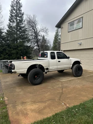

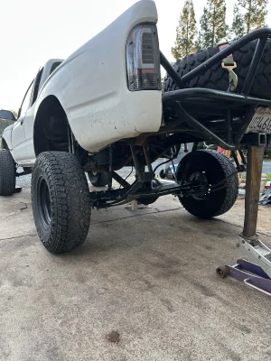

I can say it’s finally time I introduce myself, this may be a long write up haha, I’m 18 currently in school to become a lineman, been on the forum for a year and a half when I bought a ranger and was wanting to build that but it blew up it didn’t work out so good so I bought and 95 Tacoma 5 lug it had a total chaos kit on it with some poor welds and a bumper rest of the truck was stock I’ve had it for a year now and the rear end is done front is redone has adv glass frame plating etc just needs a cage now
Here’s how it sits today on 35x10s has a trussed 9” from a 78 f150 with 5.13s a spool, Currie axles and gm disk brakes. Has Chevy 63s sua with a 10” shackle mounted under the frame, fox 2.5x16 3 tube bypasses and trail gear 2.0x3 bumps, it’s bumped and strapped at 16.5 inches of travel and has 10 inches of up travel at ride height. 4” adv bedsides gonna get the fiberwerx 8” glass. Custom bed cage rear bumper with a single spare for now.
Fronts got the 3.5 gen 2 total chaos kit for a 5 lug bumped and strapped at 14 inches of travel it’s quite modified, fox 2.5x8 coilovers with 600lb springs, fabtech 3” lift spindles that also give me an additional 1.5” if track width a side. Front track width is 87 inches and rear is 83 inches. 3.5” adv glass hoping to get 6” McNeil glass in the future. Gonna be picking a te designs cage kit for it next and some new prp seats and harnesses and make an engine cage and delete what’s left of the stock bed and add a fuel cell and 2 spares. I do tig everything on my truck even though it takes longer that’s just all I’ve got.
She’s slow and loud but definitely fun I run in the Reno Fallon area when I can need to get it tuned now that the suspension is a decent point this is what I’d call a more budget build most parts were used and freshened up.
Sorry for the huge write up haha I just know when I was building/rehabbing the little work that was done I noticed little 5 lug info was out there. If you made it those far thanks for looking if you have any questions feel free to ask and if you’re in the NorCal Reno area and would like to hit the desert let me know
Also if you have a tips, pointers or advice for me anything would be much appreciated thank you.
