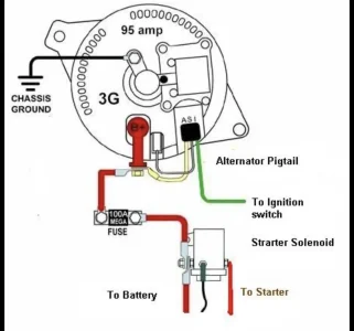

if you didnt use factory cluster... I think i remember there is some trick to get it to charge. like a resistor or light needed?
