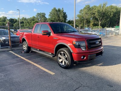

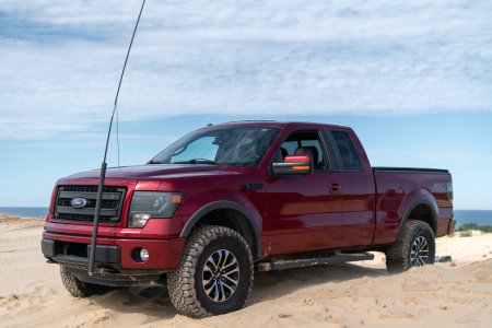

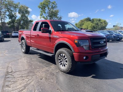

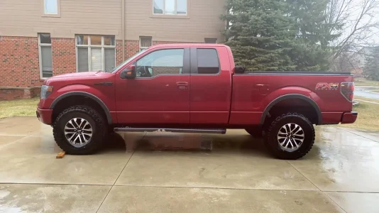

August 2019 when I got the truck. It is a 2013 fx4 5.0 with basically every option you could get at the time (it’s a lariat without the chrome. Nav, heated and cooled seats, sunroof, leather seats). Its got the 6.5 foot bed which I liked at the time because it allowed me to keep 4 spare wheels flat with the tonneau cover on it.

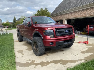

Which I promptly did.

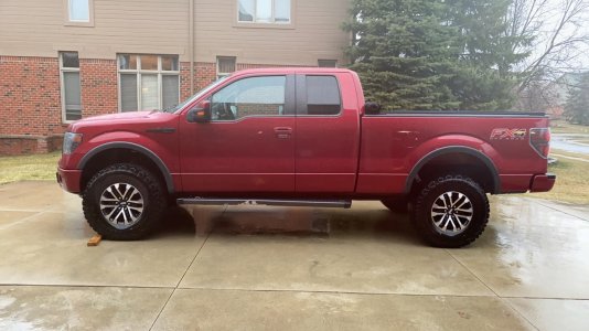

I went a little overkill on the shocks because I did way too much research and a puck level wasn’t really something I wanted to do (I had no real clue what I was doing lets be honest) so I got a way too nice set of fox 2.5 dsc coilovers
This is how the truck would stay for the rest of the year in 2019. I put a set of fox 2.0 smooth body shocks on the rear to replace the totally worn out stock ones.

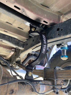

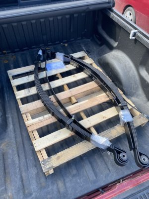

I started to look into doing a lift in the rear and getting more performance out of the truck but did not like the idea of rear lift blocks. So I got these. Icon RTX leaf springs. I liked these over deaver springs at the time because it came with an additional spring you could add to the pack to give it a little more loaded capacity and height.

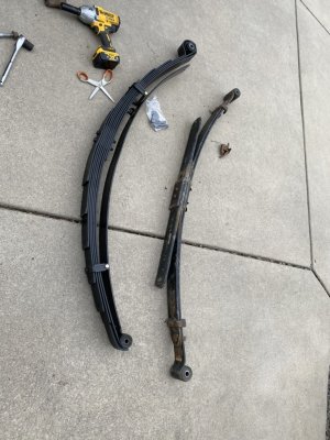

Stock fx4 leafs next to the icon leafs
stance after putting on the leaf springs. returned some of the factory rake. I wanna recall it was like an inch or two higher than before.

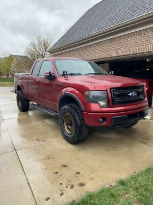

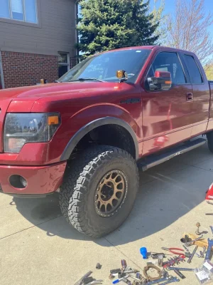

Fast forward to April I got a set of method wheels to replace the factory gen 2 raptor wheels I had on the truck. These were zero offset which I knew I needed because I had discovered at the time that with the lift, you could install gen 1 raptor rear shocks and they would be the correct length but the wheel backspacing needed to be changed.
I also at this time added some rigid pod lights.

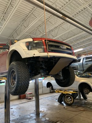

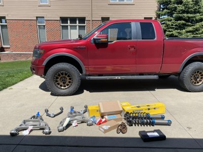

all the parts for the front gathered up.

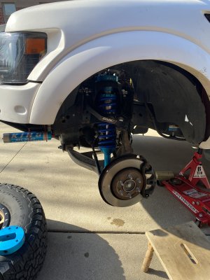

A little in progress build picture.

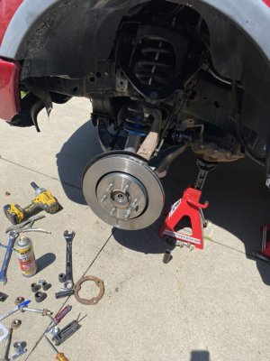

driver side done. I remember having a hell of a time getting the lower control arm bolts out because after 7 years of Michigan weather they had totally seized inside of the bushings and did not want to come out. Other than that and needing a couple pry bars to get the cv axles out of the housing, it went off without much fuss.

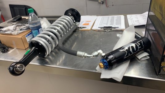

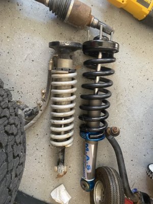

a comparison between the 2.5 f150 dsc coilovers coming off the truck and the raptor length 2.5 shocks. At the time I thought these were the biggest shocks on earth (little did I know....)

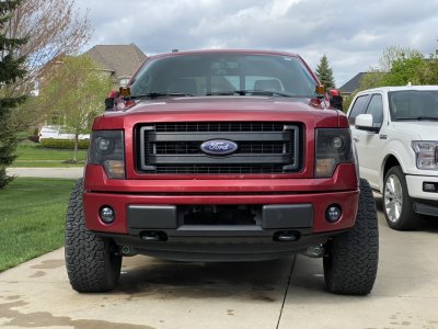

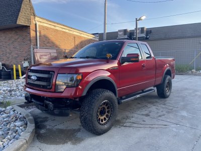

here is the truck completed after the front suspension swap. The truck was now 6 inches wider than it was before.
Now as you can imagine I was probably going to have to some trimming to get this thing to turn properly right?

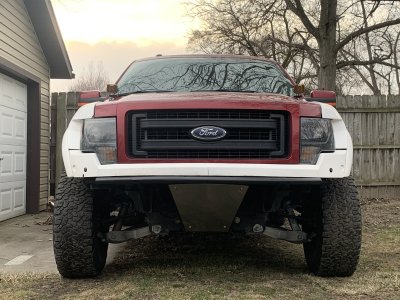

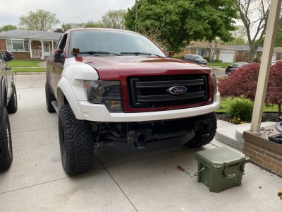

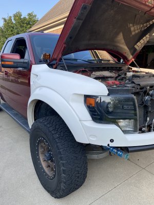

Nah I said screw that and just took the front bumper off and drove around like this for a while lol.
knowing I would eventually have to put a bumper back on it I looked around on marketplace for fenders and a bumper. Some guy near Indiana had a set of raptor fiberwerx fenders and a valance so I went and grabbed those from him.
at this point she was a solid 20 footer. My goal was to get the glass on, not necessarily make it fit like OEM.

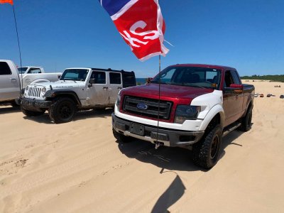

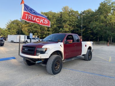

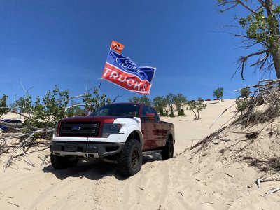

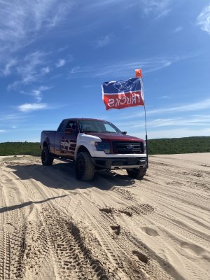

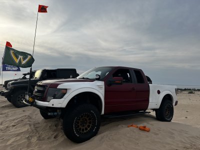

So mid 2020 we are at here and I am enjoying the truck at the dunes on trips but I find myself just wanting more and more performance out of the truck.
Couple pictures from trips in June / July

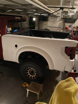

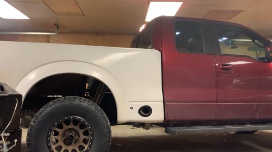

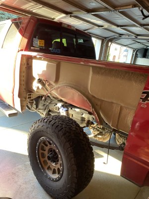

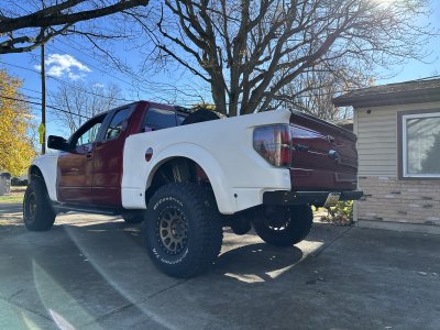

At this point I wanted the rear width of the truck to match the front, so I ordered ADV raptor bedsides for the 6.5 foot bed.
And got to chopping.
This was the first time I had ever done bodywork like this and at first was pretty intimidated by it, but I gave myself a week to get it figured out. Unbolted the bed bolts and scooted the whole bed like a foot back, I bought an assload of cutoff wheels and slowly but surely cut until I could get them to fit. Lot of on off on off on off with the bedsides. IMG_5833.webp

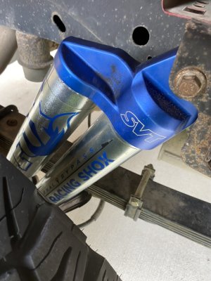

At this time I also installed a SVC bump stop kit with King 2.5x2.5 bump-stops. I went with this kit because I liked that the bump stop cans were adjustable, so that if in the future I wanted to tow with the truck you can adjust them down or if you have bypass shocks mounted through the bed, you can move them up for more up travel (foreshadowing)

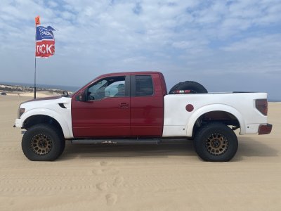

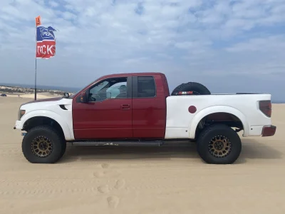

And here was the truck after all of that work was done.
couple trips to the dunes and was happy with the truck again.
Loved how wide the truck looked from behind now. Used Bora spacers to get the track width in the rear wider too.

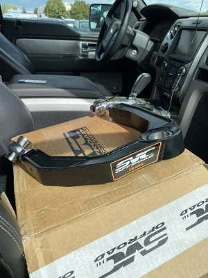

I noticed the ball joints on the upper control arms were wasted at this point so saved up and in September ordered some SVC upper control arms.

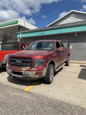

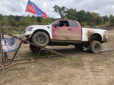

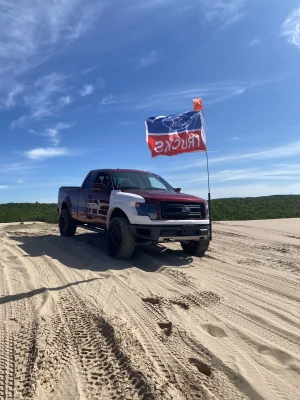

Went offroading with some jeep friend that same month.
And one last trip to round out the dune season, Our dunes close at the end of October for the season.

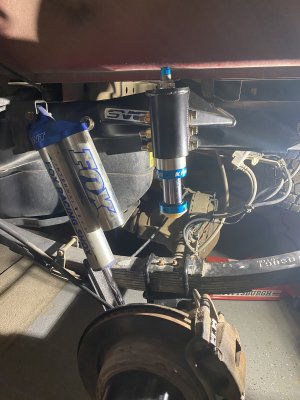

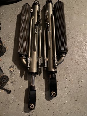

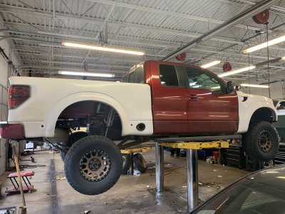

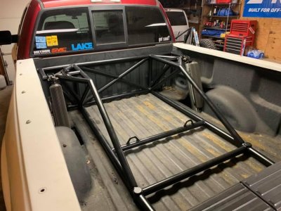

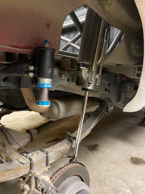

With too much time to think and with some newer friends who had trucks that were quicker than mine out in the dunes, I decided I wanted to go with longer bypass shocks through the bed for more rear suspension travel, so I schemed for a couple months and in December right before I pulled the trigger on some new fox shocks, some Kings came up for sale locally for a price that was too good to pass up.
King 3.0 x 18" bypasses with all the fixings. 5 tubes, +3 rod ends, extra extra extra big finned reservoirs, these things were sweeeeet.

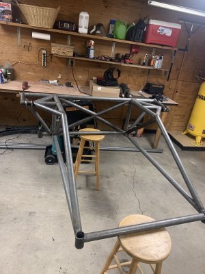

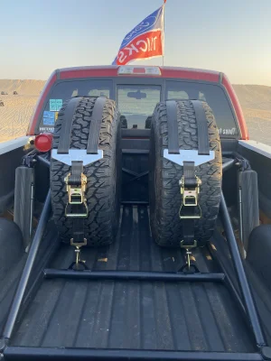

a very good friend Paul (Offseason Fabrication on instagram) built me a bypass rack for my truck since he also had a 6.5 bed truck and at the time there weren't really anyone building these setups for 6.5 trucks, let alone anyone in the midwest at all.

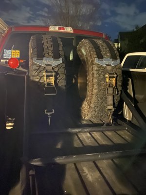

He built it so that I could run two spare tires vertically in the middle, and tie down a cooler in the middle of the bed as well.
It turned out really really nice and I was stoked on it. It was bumped and strapped at 17.5 inches of travel, I believe it was 10 down 7.5 up which I though at the time was a ridiculous amount of travel. Was super excited for the season to begin.

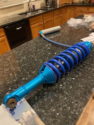

Early into 2021 Someone was selling a set of used raptor 3.0 king front shocks so I ended up getting those as well.

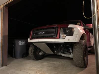

And he also did a frame cut front bumper since the bumper my girlfriend and I went to Wisconsin to get was smashed to hell at this point, I smashed it like the second trip out to the dunes which you can kind of see in the other posts with how wide the gap is in the middle compared to the edges. She was not amused by this lol.

And got two spare tires and ordered 2 more method wheels to go with it. Along with some nice tie down straps from SDHQ.

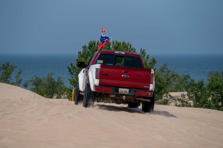

And this was how the truck would be for the rest of 2021 basically, with some minor tweaks here and there. I was so pumped with how the truck was performing. The 3.0 shocks all around really helped to smooth out a lot of stuff in the dunes and the bump-stops gave me the confidence I wasn't going to totally smash the axle into the frame if I got caught out on stuff.
More dune pictures

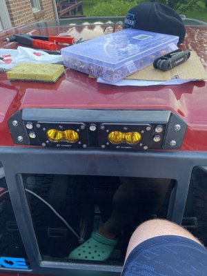

July I installed both the 3rd brake light and some Baja designs squadron sport lights I had traded off a friend.

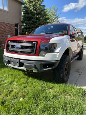

Also in July I had ordered and installed some ADV +2 raptor front fenders as well to replace the fiberwerx fenders I had on there. The fiberwerx fender on the passenger side had a huge chunk missing on the very tip of it that bothered me ever since I had got them. The ADV fenders were on a 4th of July sale if I remember correctly so I ordered em up and slapped em on.
And that is how the truck would sit for the rest of 2021. A lot of the changes over the next couple of years are much more incremental leading up to present day so I'll probably condense those posts a little better moving forward.

Nice truck. Is your lower bypass mount using the stock mount on the axle or did it get moved? Did you get longer brake lines for the rear?
there are new bypass mount tabs welded onto the axle lower. The +3 rod ends for links made it so that we moved the mount lower. And yes it has longer brake lines from I believe crown automotive

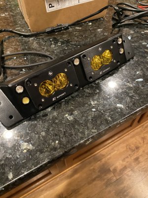

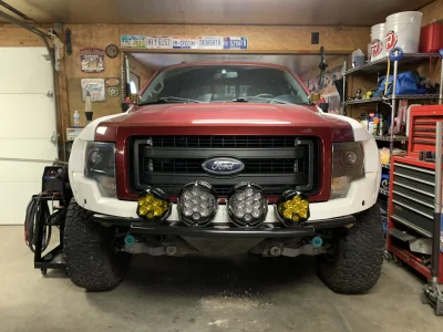

Around August of 22 I got a smoking deal on some lightly used LP9'S and had Paul at Offseason Fabrication put a push bar on the front bumper he built and installed some lp6's as well.

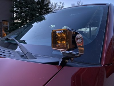

September of 23 got some lp4 pod lights for the a pillar mounts as well.

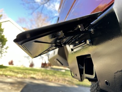

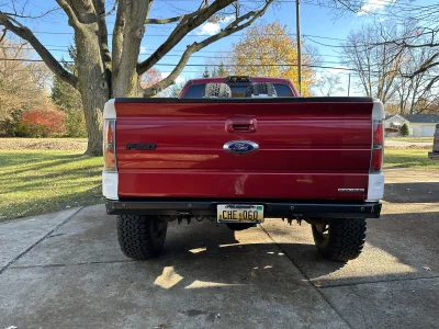

And then November of 23 Got a Mazzulla rear bumper and had Paul fabricate a hidden hitch and park sensors for it.
And the truck has been pretty much the same for the last two years. I have been accumulating some parts over the past years and ill go over that with my next post.
