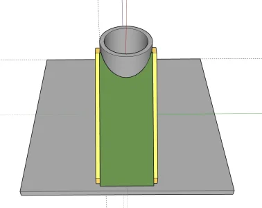

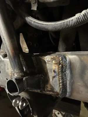

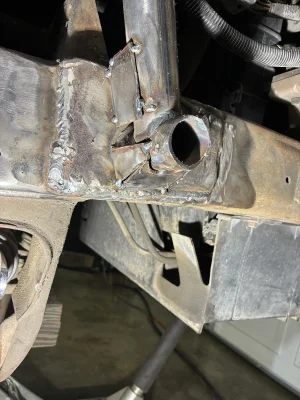

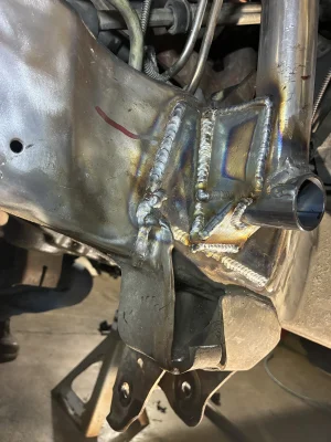

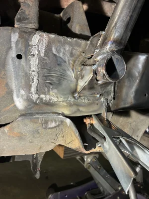

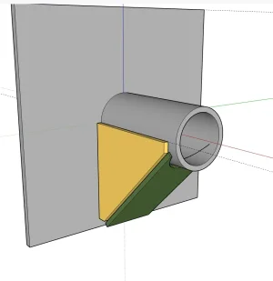

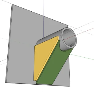

That bottom part is pretty bad. I recommend cutting off and doing new templates out of cardboard. Draw a line along the center of the open tube. This line can be used as a reference point to make the templates.
I can do a drawing for ya if you'd like. Others here could provide help too!
We are all here to help, don't hesitate to ask!

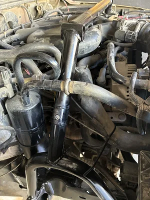

Could you show me what you mean and damn that sucks wasted all that time lol. I ain’t got much time to spare lol

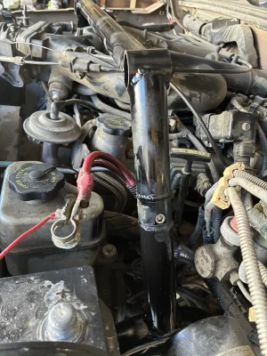

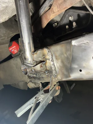

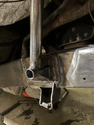

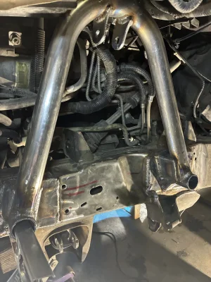

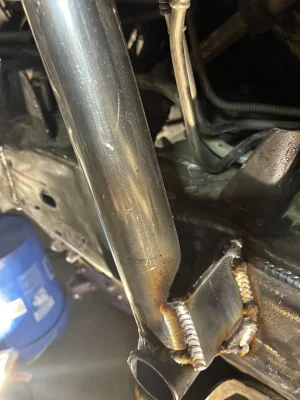

This is what i came up with. Passenger side is done gonna finish up driver side tonight and hopefully have the shock towers cross brace that goes over the engine all done by tomorrow so come Wednesday o can burn it all in and start bolting the kit back together and get this thing out of the garage

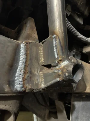

Haha we all gotta learn sometime the other side looks better I promis
You’re right that you have to learn sometime, but when it comes to building or installing a critical part such as suspension you should really leave that to someone more capable.
This holds the entire vehicle up, and the quality here really puts you and/or passenger lives at risk in the desert. Off-roading at speed is already a risk, and not something that should be increased by unsafe work. I have seen better quality work fail in off-road conditions.
Please do not take this offensively, but I really think you need to step back and take a look at some other trucks, and the steps that people take to make them as structurally sound as they can.
Practice welding, build some shit outta scrap, build a fab table, or bumpers. Work your way up to something like this.
Budget build or not, it should be safe.

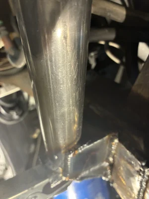

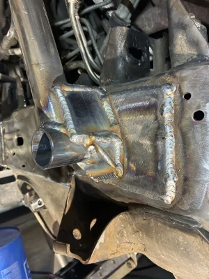

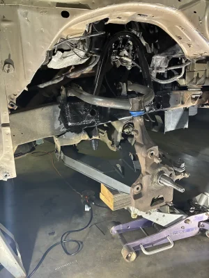

I totally agree those frame plates were welded in by me on the passenger side but after seeing how it came out my buddy has welded the rest for me.

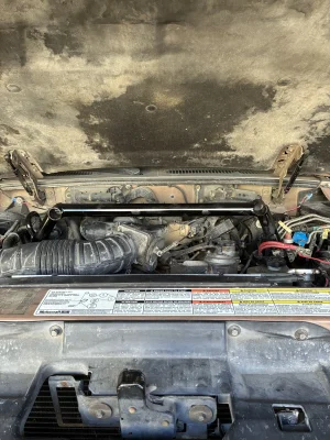

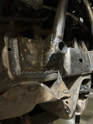

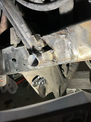

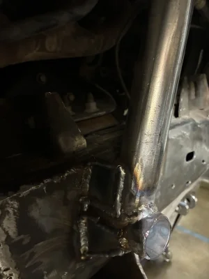

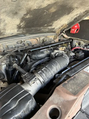

Here we go boys took all the advice I grinded out the old welds on the frame plates and my buddy re welded them for me also got the towers all boxed in now I just gotta build the cross member and get that welded in and start bolting it all back together!!!! Getting that much closer I can taste the dirt!!!

Cross member is done for now will be throwing in gussets next weekend but for now this how she gonna be. Ima start bolting everything on tonight and get her on her now weight. The stoke is real 🤘🏻🤘🏻🤘🏻

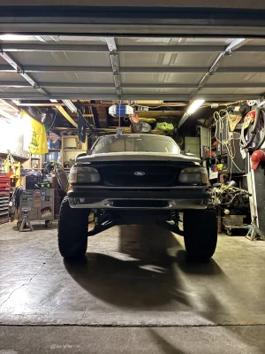

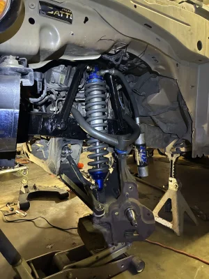

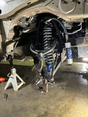

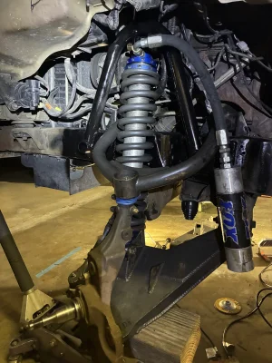

Got the coilovers in and everything tightened down. Filled the shocks to 200 psi with nitro gonna set ride height tonight and put it all back together tonight hopefully be standing on her own. Just got a few small things left to do but we are pretty much there so pumped and can’t wait to drive it.

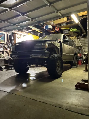

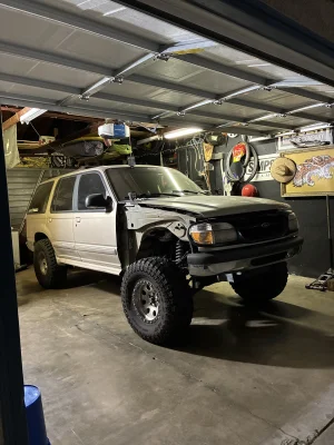

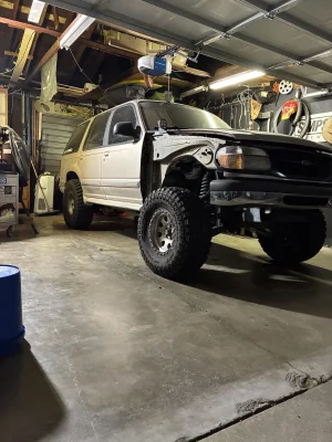

Got her sitting on all 4s again. Just need to bleed the brakes, weld in the limit strap mounts, weld in the reservoir mounts and put the coolant/windshield wiper fluid reservoir back inand an alignment. Man has this been a learning experience and great practice for when I build the 88 bronco.
