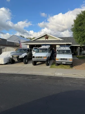

He saw that @Nick619nc had to explorers for sale on Marketplace

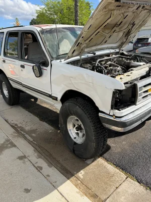

One was kind of built but was rolled onto the roof and he also had a non running donor explorer for a body swap.

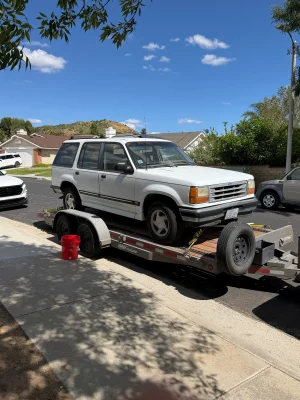

So we did the 3 hour drive down to San Diego to bring them back home.

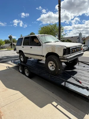

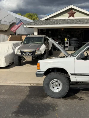

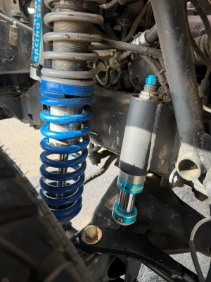

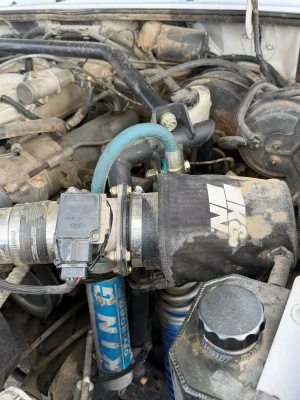

The rolled one has a
Front
Solo Motorsports stage 4 kit on it. With cut and turned beams.
Solo shock hoop brace kit.
King 2.5x12 coil overs
King bump stops.

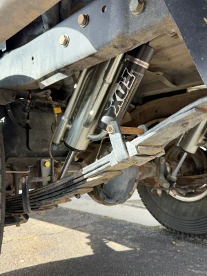

Rear
Cookcraft rear shock mount kit.
Fox 3.0x12 triple bypass shocks
Deaver G50E springs
Solo shackles
Almost new 35" Tensor tires and AR23 wheels.
New clutch and flywheel
new steering box

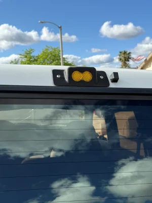

Baja Designs dome lights
Baja Designs rear chase light
3 Baja designs in the grille

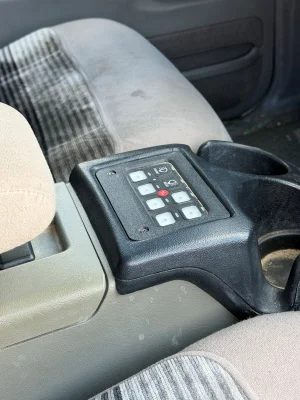

Auxbeam 8 gang switch panel.
Pics of the goodies on the rolled one.

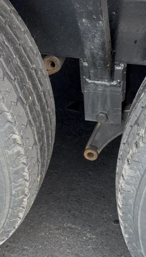

Only a 1/4 mile away from leaving Nicks house with both Explorers, we get flagged by someone that our trailer tire is smoking and rubbing the fender. Pulled into a parking lot and realized we lost a shackle on the way to his house. Didn't notice it when we loaded that one trailer.
Tractor supply company 9 miles away for the win.

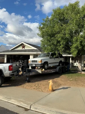

Now how do we get a non running one parked in the up hill front yard next to the driveway with only 3 people.
You back it up to the porch where its flat with the hopes to push it downhill into its spot.
But don't forget to jack up the trailer tongue and truck to make it level as possible.

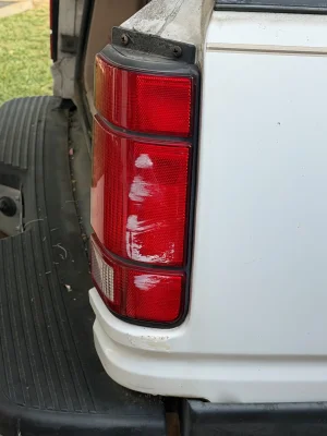

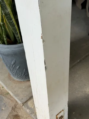

Everything looks like it will work, Lets push it off and proceed to run it into the porch swing and the front house pillar.
Just miss the marked by a half inch. Unfortunately we got a little damage to the passenger taillight. And of course that's the one taillight we actually needed. Oops.

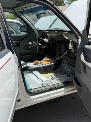

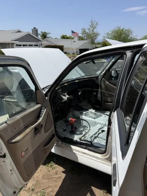

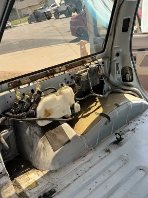

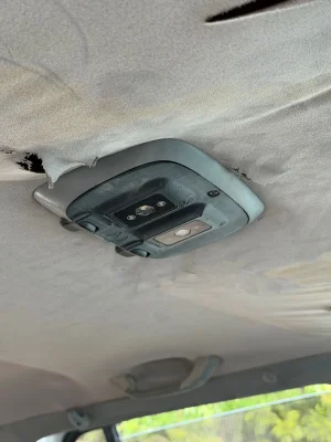

One is the wiring. We were hoping not to have to transfer wiring harnesses. But the rolled 92 has a electric transfer case and the 1994 donor is a 2wd. Also we noticed upon pulling out both interiors that the 92 rolled one has a few extra relays around the rear water reservoir. and a computer box on the drivers rear quarter right by the washer tank. You can kind of see it in the picture below, One has the box and the other doesn't. So looks like we need to transfer the rolled wiring harness to the new donor body. Just a little more work. But shouldn't be that hard if you take your time and label and take pics of everything.
The second issue is we were hoping not to have to swap core supports. But the rolled one looks to have a little bend on the side it landed on.

91-92 are different from 93-94. You definitely are gonna want to swap EVERYTHING into the new body. Also, all of the relays and things in the rear are for automatic 4x4 tcase.
Personally I would swap the engine crossmember on the new one, then you can put the ttb on it. Then source a 4x4 manual trans and t case and eliminate so much electrical headache. You will be miles ahead, and if you can’t do it, Mikey will be able to get the fab parts back on it.

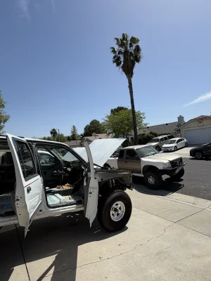

Weekend up dates on the body swap.

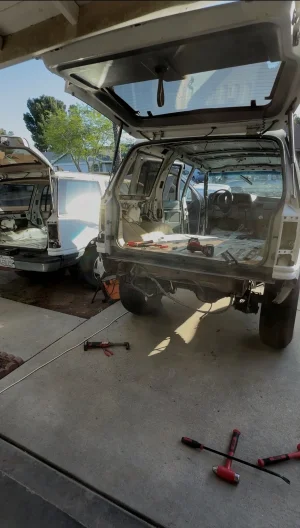

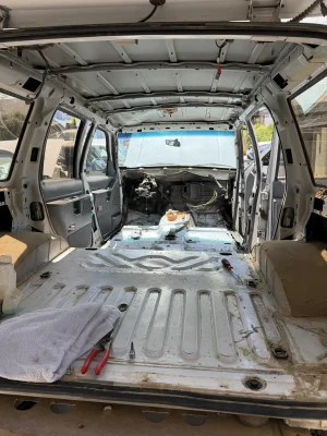

Since the kid is dealing with the
Donor being a 94, automatic, 2wd, front Abs, some slight differences in the 4.0.
And the rolled one is a 92, manual, electric 4wd, no front Abs.
Makes it a little more work. With swapping wiring harness and dashboards.

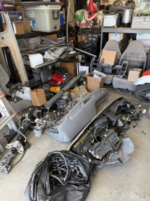

He got the dashs and steering columns pulled on both. He got the 92 rolled interior wiring harness transferred over to the donor body.

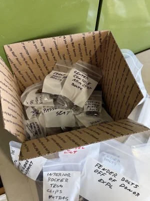

Keeping all the non needed wiring and dashboard until we get the body swapped and running. Just in case we need connectors or what not. This pile gives me anxiety. Can’t stand unorganized mess. But unfortunately there’s no room for organization.
Just taking our time and keeping everything bagged and tagged.

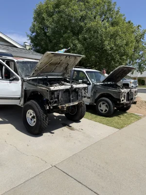

Got the fronts clips on both removed.
