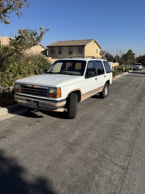

IMG_4824.webpBought the truck maybe 2 weeks ago from bakerhotrodworks pretty clean explorer
Build thread of my 1992 ford explorer 2wd.
Plans are for a unequal set of beams coilovers, deavers etc

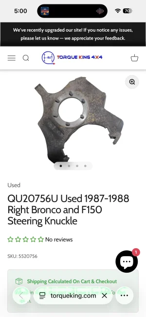

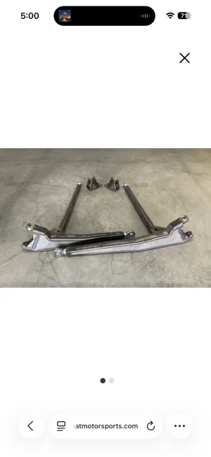

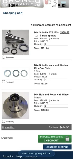

Question for the smart people of the internet
Would these parts work together I know very little with Dana 44 stuff all I know is I have 6 bolt knuckles and honestly just want a complete kit so there isn’t second guessing
Explorers are d35 TTB, d44 is a larger war spread on the knuckles to the beam.
D35ttb is narrower ear spread on the steering knuckle than d44 TTB. The parts are not compatible however I’ve made d35 camber adjustable uniball knuckles in the past that would work but that’s not going to be an on the cheap thing. My advise swap to d44 beam ends on threat’s 2wd d44 beams. Then everything posted is compatible from my quick overview. You might have to modify the pivots but that’s easier than making d35/44 adapter steering knuckle plus the ear spread and ball joint size is much larger on d44. Stronger

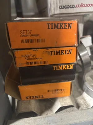

You’ll also need a Timkin set 37 and a set 45 to run this hubs on d44 snouts.

I have d35 ttb from an explorer on my gmc Sonoma. I replaced the entire knuckle with a set from a friend’s 1981 Bronco, so d44. I used a tapered reamer (forgetting what taper it is at the moment) on the explorer beam ends to accept the Bronco ball joints. This is all TTB though. Idk if 2nd is different.

Not sure about threat motorsports but majority of Companies out there with beam kits like that for 2wd will still use a 4x4 d44 knuckle so you shouldn't need to ream the beam ends. putting d35 hubs on fabricated beams wouldn't be worth it

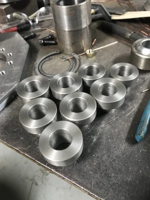

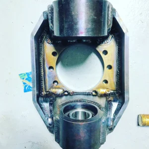

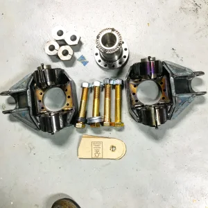

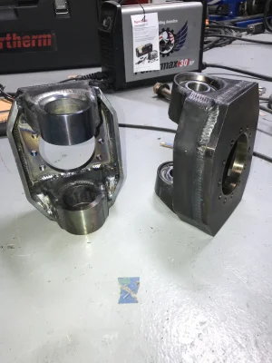

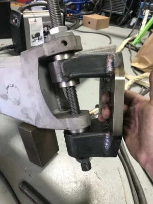

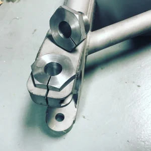

I got stuck with a guy once hard pressed to keep his d35 beams so I made him a set of uniball camber adjustable knuckles. I Dont think it’s really relevant but there are solutions for the baby ball joints of the d35 beams. If I had to do it over I’d chop the beam ends off and add d44 beam ends and adapt 4wd components as needed. These knuckles I always hated because they were in single shear so I sent them off with double shear templates for the customers kid to cut out and add to his beams. Still not a fan of d35 nor am I a fan of the 2wd f150 factory spindles. They have a snout ( spindle shaft) tip that’s 3/4” diameter at best and are looking to snap off if you jump it. Hope this gives you you some ideas. Use all thread and multiple nuts to align before welding cups.

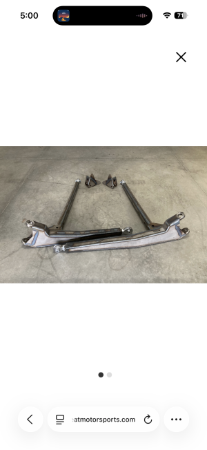

Thanks yall, and yea so the beans that are being made are going to be for d44 ends
I’m going to be going with stock knuckles for the time being I might add a camburg 2.0 hub kit if it works but that’s down the line
I honestly just want simplicity and be able to replace parts at any auto parts store so luckly I think everything I have pictured is everything I’ll need other then bearings and brakes calipers
Everything you have in your cart will work.
You’re doing oem style d44 knuckles, so anything for a 1980-92 6 bolt spindle d44 will work. Lots of awesome info has been added in this thread, but to answer your original question, you have the right stuff.

D44 ball joints are pretty hard to kill. I’ve ran them with 33,37,and 39” tires they can change with a lot just make sure you get raybestos or moog ( blue rubber boot) ball joints from Napa. I have part numbers if needed they last longer than the cheapo’s. But the cheapos hang surprisingly well also. Meaning duralast.
Yea, those look like the right parts for D44 6 bolt.
Blue boot BJ's from Napa... stock D44 knuckles/snouts/brakes and drill out the steering for bigger bolts(even single shear is OK.) Weak spot is the steering box/sector shaft really. Make sure to use the one piece fixed camber adjusters, because the 2-piece adjustable ones break with heavy abuse.
2ghetto/BroDaddy/G3 have all been been beat on for years with those factory parts like that. I wouldn't run larger than 35" tires on this setup personally... but I like parts to be overkill.
