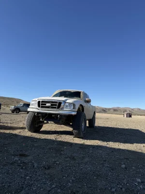

Your bed floor isn’t limiting you, the shock angle/max size shock you can fit is. You’ll be able to get the axle to bump at frame with whatever shocks (sized within reason) and without the pumpkin hitting the bed floor. You won’t be able to stuff longer shocks like 16s into the wheel well, which is what you’d need to get close to the travel you’re trying to get, at the angle the shocks would be at. There are ways to get they I’ve shocks through the bed and still have a very usable bed space. When I have time to look through my pictures I’ll show you what I’ve done with the same setup you’ll be running.

Ok that makes sense, the bed cage were you just cut the bed is what im trying to avoid because ill load my truck bed with wood, quad, tools, gravel, ect so i cant really do holes i think what ill probably end up doing is waiting to buy my bronco 8.8 and swap the axle and put the tower in the wheel well like on the tacomas it looks pretty nice and will make is 10x easier than a full tube bed cage

Yes and no. You’ll still have to do everything like a normal bedcage, just less tubes. Spring pack needs to be broken down, spring perches set up and burned in, I welded the spring and shackle hangers on as they like to crack when bolted on. If you actually use the truck you may fight issues with the shock hoops cracking. Everything is gonna be a bit of a compromise. Leaf springs need weight in the back to work well, like tubes, spare tires… so keeping a fully open bed will still be a bit limiting. It’s hard having it all, something’s gotta give.

thank you that makes sense i plan to make a fuel cell in place of my old spare location to help with the weight. I am curious does the cage have to go through the bed or can i basically cage under the bed with tubes and help with frame support? Why is the cage so necessary i think there is a lot im missing

Imagine your shock hoop is your arm while arm wrestling. Someone comes along (your shock) and pushes your arm inward towards the center of the bed (in physics this is called a torque). Sure, you can hold your own for a while, but over time you get weary and fatigued, and start losing and bending towards the center of the bed. So along comes a buddy with a stiff arm (a cross brace), who helps push your hand toward the outside of the bed. Strong. Trying to support from under the bed is like your buddy pushing your forearm just above the elbow. Is it helpful? Sure, a bit. Can it be better? Definitely.
I have since caged my truck and run down tubes to the bed cage, but here is my setup. I still run the same bed cage and can fit my dirt bike and gear in the bed with the tailgate closed. My shocks are outside of the frame rails and it’s worth noting that Toyota frame rails are wider than Ford in general, plus my truck is a Tundra. Either way, a setup like this was the best of both worlds for me - I could pack my truck for a weekend in the desert, beat on it, and drive it back home.

I think that kind of cage can help stiffen up a frame with the tie-ins via the bolts that hold the bed to the frame (if that's how the Ranger bed is held on - I only worked on one and can't remember beyond it having Torx bolts.)

You’re correct that the torx bolts on my truck also hold the bed down and my bed cage was designed with frame stiffness in mind. The spare tire carrier is also triangulated and ties the top and bottom of the rear frame together, so the rear of my truck has been rigid since I built it.
