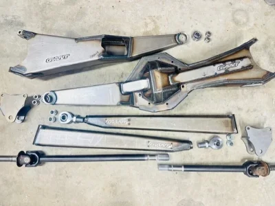

Desolate Solid Axle Kit w/ 3.0 IBP kings will now work the front end in place.

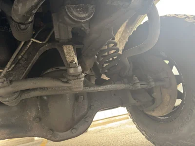

Out back we are still going to SUA, just with the 8 lug axle. 3.5” tube axle and I’ll probably weld the tubes to the center chunk to help prevent spinning the tube. Maybe we truss it as well. Front Dana 60 will end up with an under truss to help keep the solid axle alive.
