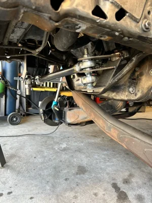

Yah I mocked them up in the locating holes and checked before I built those B pillar tubes. Reading Marcy’s build page I was like shit I better pay attention to that. I picked up some bump cans today with some questionable quality

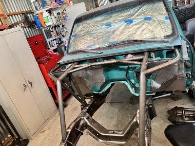

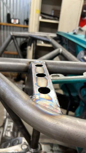

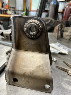

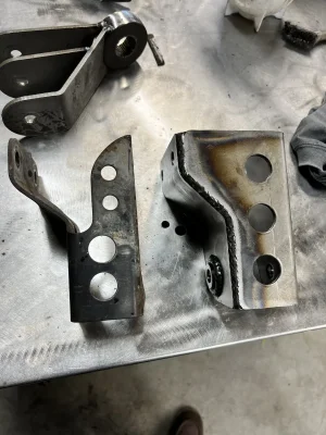

Here’s an update. Found this guy who makes a pretty sweet bolt on manual brake setup that’s 9” from the fire wall. I was able to get 14 degrees of shock angle at full bump. I Made some bump stop mounts so that’s next on the chopping block this weekend along with steering. I need to finish up making the plates for the shock mounts and tack all those tubes in place.

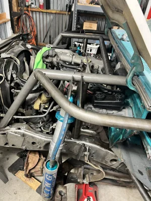

I’ve still got some more lacing in the engine cage as well. Gonna do a couple .95 1”1/4 kickers
will that set up leave much room for a bypass? i ran a portion of my brake master in the cab to gain room for shocks. But then again i was using CNC set up.

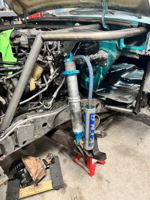

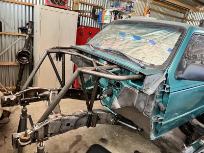

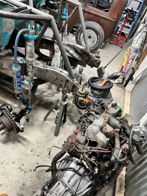

Finished up the lacing in the engine cage, Started on the steering, mounted the bump stops. Now to cap these shock mounts and work on the steering. Need some different heims for the outer tie rods

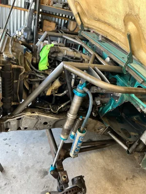

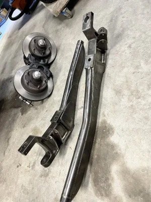

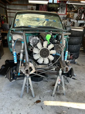

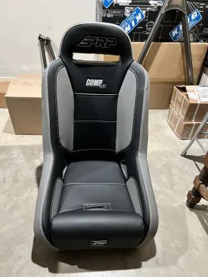

Here’s an update! Had the shocks rebuilt at downsouth Motorsports. Patched the firewall, welded up the engine cage. Got some new seats, harnesses and steering wheel from PRP. Grabbed a set of king 2.0x4” bumps for the rear of the truck. My 3rd member came in from quick performance. So my parts are stacking up. I’ve pretty much got everything I need to finish this thing haha. Gonna make a push to get the engine and trans back in. And finish up some plate work in the front.

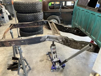

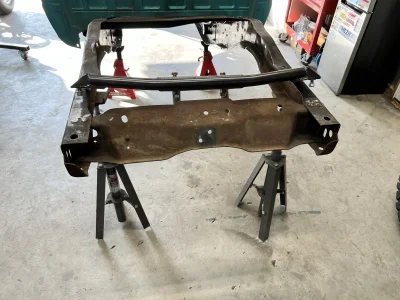

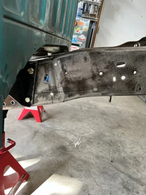

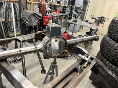

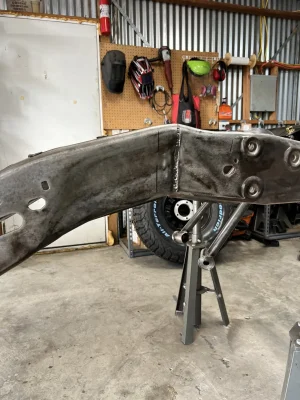

Here’s some progress on the back half! Kicked the frame 7 1/2 inches, working on tabbing out the axel and gonna add some taco gussets. Hoping to get everything mocked up in the back and start slinging some tubes.
