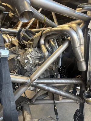

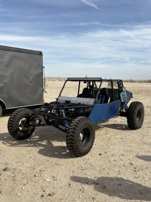

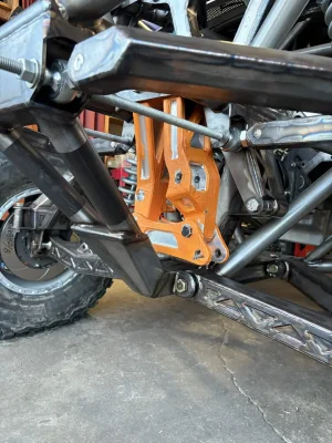

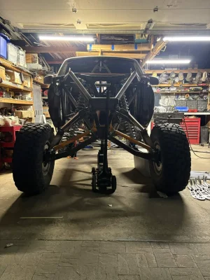

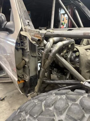

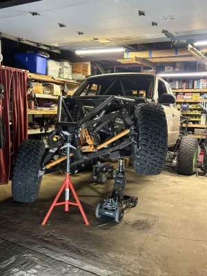

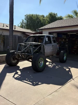

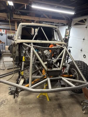

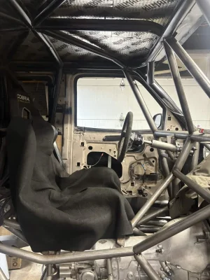

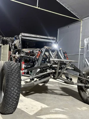

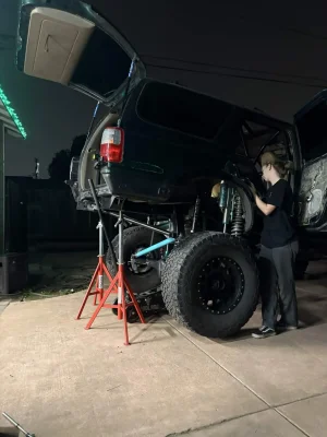

And here we are now. I am way behind where I expected to be but getting close. I took a break from working on my truck after my father passed away a few months ago then got pretty busy with work but I'm back at it now. Ill include pictures but I ended up finishing my dad's buggy which he was in the process of doing a new front end on, 3 linked a 4 runner and did the same buggy J arm on old class 5 car. The same front end featured on Hoonigan and if any ones interested it can be found on my site :Buggy J-Arm
I currently have the bulkhead on the truck, chassis structure completed and motor and trans in. I just built a front bumper, got the seats, steering and pedals mounted, built a stainless exhaust and Tri-Y headers and am in the process on doing the sheet metal. Goal is to have the fab work finished and ready for wiring before April. Im opting to wait put the front glass back in, build a dash or any of the other odds and ends until after its driving so that way I can take my time to finish it out fully while still being able to get out to the desert. Next up after sheet metal is building the custom extended sector pitman arm, which the parts for parts just shipped out from CNC. Then onto the little things such as shifter, mounting computers/controllers, trans cooler, plumbing and the little bits of fab left
