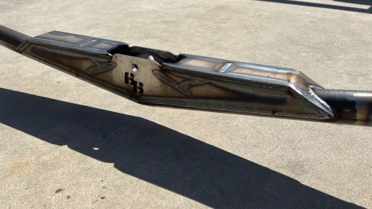

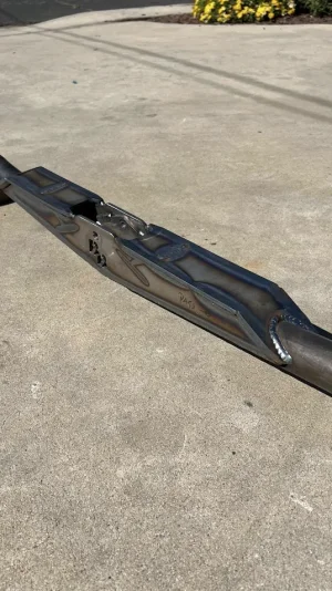

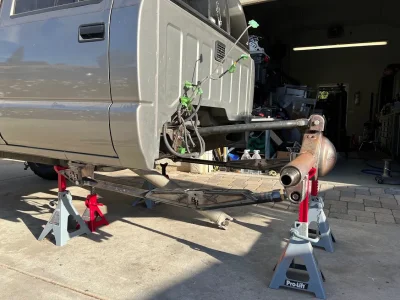

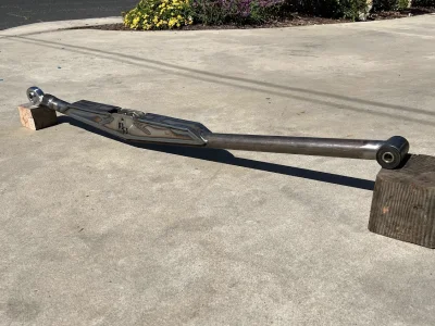

Side note: Got my argon bottle refilled and cut all the side plates for the lower links yesterday. Going to try having the lowers welded up by the end of the day.

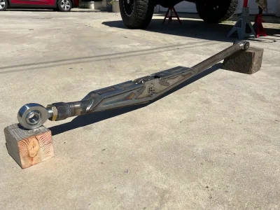

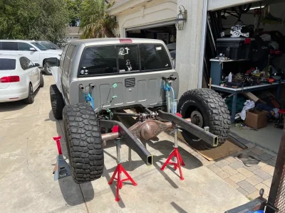

All the links are fully welded and ready to rock. Time to finish welding the mounts, burn on the axle truss, and get to assembling the rear end.

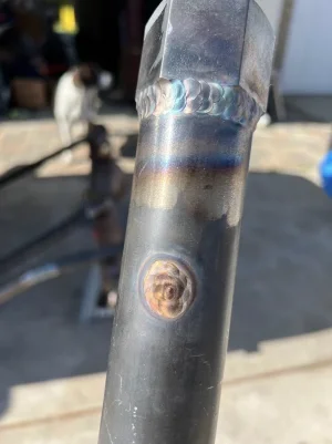

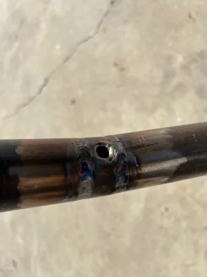

Added a weep hole for any water that may collect in the lower links
Plates mocked up and tacked in place
All welded up

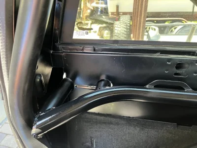

Are you going to can-opener the cab to get to the c-pillar for the bed cage? Tying in below the window looks like it'll be a gas.

Yeah, I'll be going beneath the window. It should actually be really easy to do. I may either just hole saw the holes so I can stub tubes through (plenty of room inside the cab to weld it in), or I may just cut a big rectangle so I have enough room to do what I need to do, and I'll weld in a patch panel and rhino line the back of the cab. I'm not running down tubes from above the window.

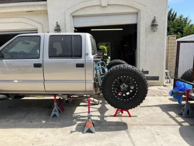

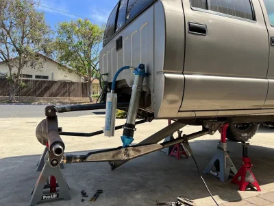

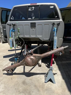

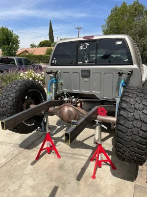

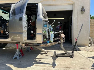

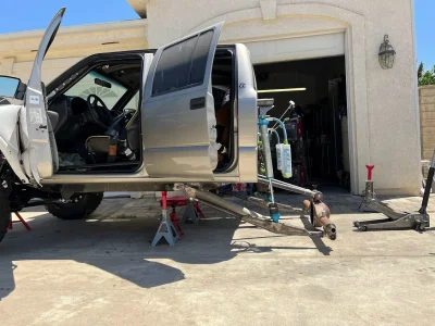

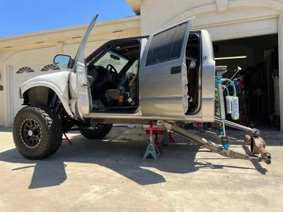

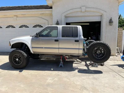

Here's where I ended off for today. Stoked with the progress, and stoked with the travel numbers! I was expecting 19", and bump/strapped at 18" with a 14" shock and pretty close to the axle. I ended up getting like a 1.68 motion ratio, kept the shocks at 90* at bump, getting 22.25" metal to metal (12.5" up, 9.75" down), and I'll be limiting it to 21". Very pleased with how the day went. Tomorrow I'd like to get the rectangular tube frame section in place.
Full droop
Full bump
All shock mount plates are cut. It'll be getting boxed in.
Ride height

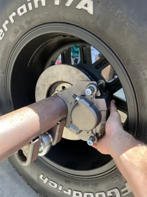

Brakes came in from Speedway, so I bolted them up and held them in place to see how it looks. The bleed nipple has to be pointing up, correct?

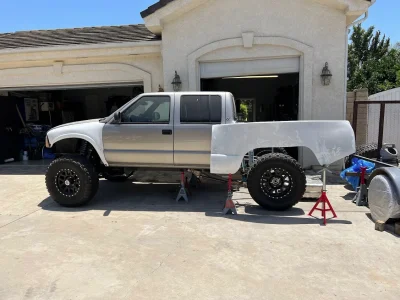

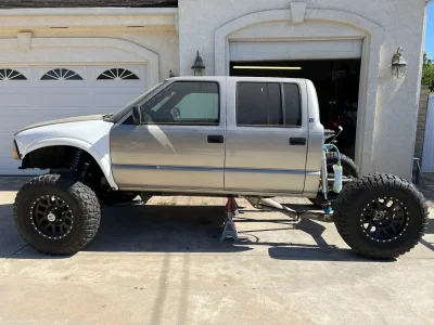

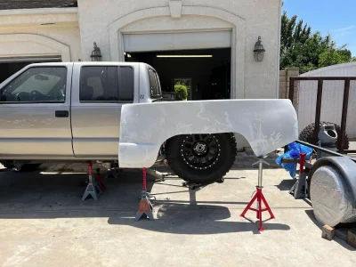

Set the bedside in place(ish) and rested the gas tank behind the axle to see how far back the frame rails need to come. I'm not a fan of this glass, but I'm going to see what I can do to make it work. Might just be a failed $400 experiment
Got started with the 2x4x0.250 frame sections. Just did pie cuts and bent them. Nothing is tacked in place yet, so it's not perfect, but I had to stop so I can head back to work and help with graduation.
