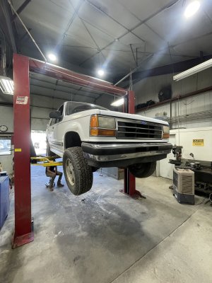

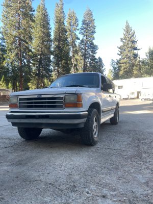

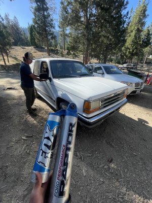

Not much really to say here but found this 93 with just barely 200k on the clock for way to good of a deal to pass up. Plan is the standard formula with 4” coils and a 2.5” smoothie up front maybe coilovers if I get crazy. So far I have a set of raptor 3.0 takeoffs for the back and a set of 4” lift coils for the front also have a mystery set of free wheels i need to find skinny 33s for but that’s about all there’ll be to it till my K10 is ready to tow it around longer distances. IMG_0919.webpIMG_0925.webpIMG_0928.webp

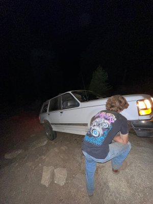

Any pictures of what you were driving on?

This is the best I have all 4 were up on rock when it happened I spun for a sec but not nearly enough to warrant the hubs going. I’ve driven d35 jeeps on 33s harder than this for sure
