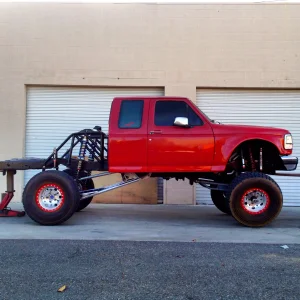

You definitely have enough shock and bump stop to make it boogey. Tuning is everything. I cant remember the exact number, but it took me 4 or 5 tries to get my 2.5's where i liked them. Each time was more and more compression.
I have 2.5x12 c/o and 2.5 bump shortened to 2” on the front (TTB), and 2.5x14 c/o and 2.0x4” bump in the rear (4 link). I have it working really well all around, but some compromises in each area. It’s plush so comfortable on razor chatter, but a bit soft for stuff spaced really far apart.
