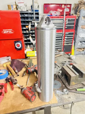

Dual IBP shock package
I think it’s a great idea. If you need more shock, then add an affordable shock, right? I can make these 4.0’ IBP in, any length, however you want the reservoir, clock it to fit whatever you got for $1,450. each.
“1450” the peoples shock! Haha

That sounds awesome!
I know it may be lame but, I’m currently not sure how interested how interested I am in the idea of having mix matched shock brands currently though!
What were all saying is it’s gonn work perfectly good with just a coilover each corner. A second shock of any kind will also only help not hurt
Well man, I very much appreciate your input on this, it’s definitely making me take this option a lot more seriously having some good feedback from those who have a lot more dirt miles than myself!
I think the shock builders are saying there is a cheaper way to get essentially the same performance you're looking for.

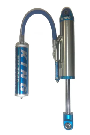

Are you set on running dual IBP’s? What is your concern with running say a King 3.0 smoothie? You can add clickers and King will even build them with a bottom port reservoir if you want. Im just not sure why you think you need an IBP coilover and IBP secondary shock.
I already have IBP Coilovers for the front and rear. I felt like it could be an advantage to just do IBP for the smoothies as well due to the added tuning capabilities.
Trying to get the most I can I guess without having to listen to check valves click through the cab cage I guess.
Would the bottom port be better you think?

If you decide standard bypasses, you can mount them on bushings and that’ll cut down on noise drastically
I have seen people do that too! The other possible benefit is if I went to a smoothie with the resi mounted like a normal bypass would be I could always add the tubes later, just buy the new bodies, at least I think that’s how it would work lol
And I may run it as is with the single IBP for a bit , but I’ll have that open spot on the link for more down the road. I just think a secondary shock would be a massive difference in valving to use, especially getting a large diameter shock could add a lot more performance I’d think.
