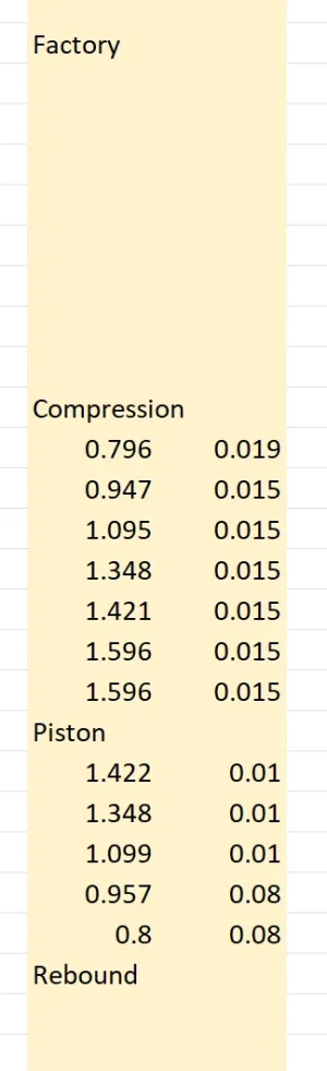

Looking for stock valveing on the 2.5 raptor rears. Or valveing that people have done that works. The bump zone is way stiff and need to lighten it up.
This is what I measured as stock valving for a 2 door rear shock, you can round the OD, that was just the read out form the micrometer. The .08 is really .008
