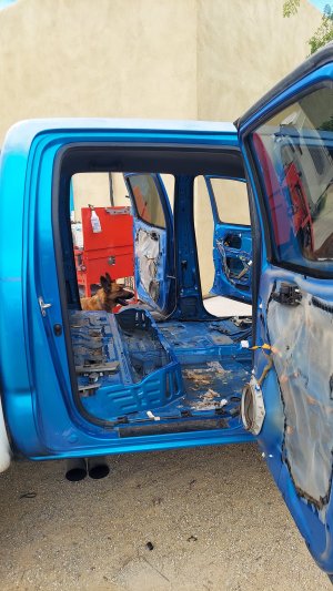

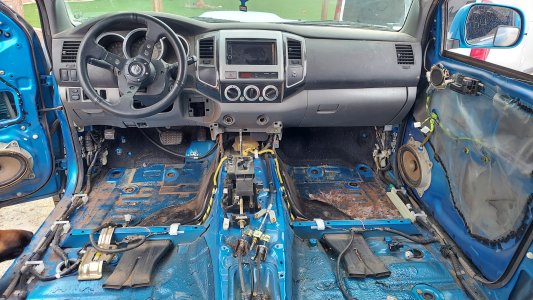

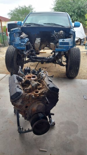

I figured I would get the thread started on this build seeing that its going to be more than a minor overhaul, and more along the lines of a complete teardown and built back up from scratch.
This is my buddies 2006 Tacoma, 2wd, automatic V6, supposedly a pre-runner model without the badging. Anyway, build plan morphed from doing a DK LT up front with spring under rear setup, to now, I'm doing everything from the ground up, all the design work, full drivetrain and powertrain, etc.

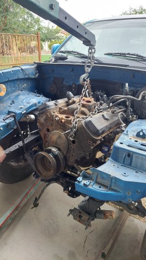

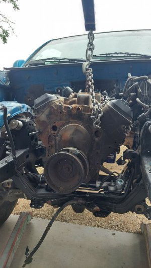

The Engine fits in the truck way better than I thought it would too, which was a nice surprise
