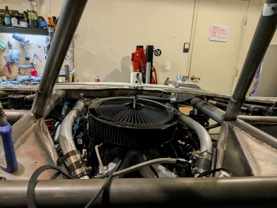

I bit the bullet and purchased the Aces EFI Jackpot pro kit on sale.
COULDNT BE HAPPIER.
Holy cow was it easy to set up and tune. For about $1,100 shift I got a 4150 flanged intake manifold port injection, fuel rails, injectors, four barrel throttle body, every sensor needed to make the engine run, 7-in touch screen, ECU, two wide band O2 sensors and a PDM module which runs all the electronics/ fans/ fuel pump ect... without the need for relays. You can't beat that with a stick. Started up and kicks buttPXL_20251216_013109670.webp
Always wondered about those kits. Glad to hear it worked out good. Looks like a nice setup
Man I did so much research on that kit for my bronco and the Holly kit and kegs and summit and edelbrock. The cars facebook page turned me away from it it was incredible at how many ppl had problems so I went with the Holly kit and love it. I’m glad it’s working for you that’s awesome.
Good thing you didnt go with the edelbrock kit. I tried it and didnt work, could never get the truck to run. Kept frying the relays in the harness, They were no help and stated it was an installer issue. i ended up getting fed up with their lack of support and threw the shit in the trash and bought the holley terminator. fired up first try.
We run the Edilbrock ProFlow 4 on our SBF, it seems to be ok. Melted 2 pistons from who knows what. If I was going to do it all over again, would go with the Holly seems to have more support and the Dyno techs are familiar with them.
Ya that’s what turned me away as well I called all the dyno shops around me and not one would or have done an aces but all loved the Holly.
