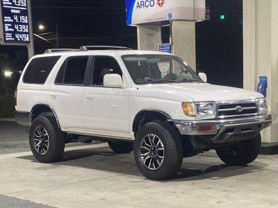

On the way home from his place I tried to score some easy husband points by topping off and ran into my truck twin.

Repurposed the skid I had on the condo to complete the 4runner's front end, years ago I had made windows in it for squadrons and put a set of SAE cubes with a nice cutoff that come on with the headlights (if I put them on a switch, my wife will never remember to turn them on and they fill below the high output H4's well.
And the icing on the cake I made some brackets to put the original lenses in the bumper because the stock housings won't fit with the wings I added behind it.

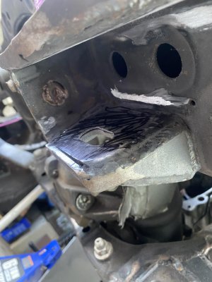

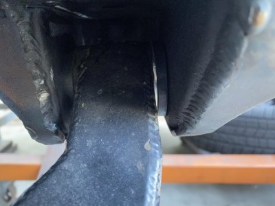

Actually spent time working on the "race truck" with a tool I never knew I needed until I had to modify the lower arm mounts which don't really work well with the XLT lowers. I had figured out that the uppers from Solo on my 4runner weren't made to clear the shock bucket, but I'm not sure whether this was the jig for Solo's lowers or my beat 2nd / 3rd hand rig.
https://www.harborfreight.com/53-am...Yl5r6Jnsibwgp_JxN_5WiRr54LtnxHKwaApiuEALw_wcB
I had made shims with Send Cut Send to make the lower arm inner and outer bushing sleeves fit the mounts. I needed to make them all fit looser on the inside mounting surfaces and tighter on the most fore/aft mount surfaces.

When I got the uppers from Solo, I couldn't get them to fit without modifying my coil bucket, so I luckily got helped out from my friend who runs a machine shop and shortened the bushings and bushing sleeves. He grew up working in this shop for his dad and is about to retire so he seems to like it when I come by with a new project to keep him from getting bored. He never lets me give him money so I always hook him up with snacks and sodas since he doesn't drink alcohol.
