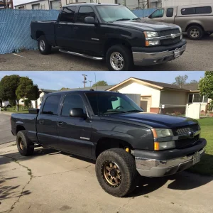

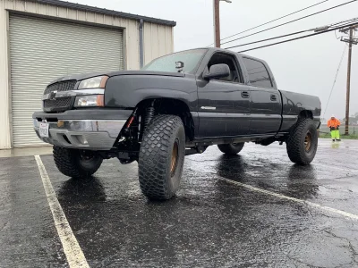

I got this truck back in 2017 as a “tow rig” and replacement for my daily driver. I can’t remember exactly, but it had somewhere around 160k miles and was completely stock minus some sicky gnar gnar lowering shackles in the back, a cherry bomb muffler, and some chrome grandpa steps.
That all lasted about a week until it got a black widow muffler, step delete, torsion crank, and some new wheels and tires.
![4FC57333-3C83-4C8F-BC6B-A09659CE80F6.jpeg 4FC57333-3C83-4C8F-BC6B-A09659CE80F6.jpeg](https://forum.badlinesgoodtimes.com/data/attachments/6/6987-4533f7dbd046227fec1f37784a5341e9.jpg)

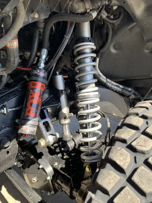

It stayed like this for a couple years. Towed the old Tacoma to KOH, took it on multiple road trips with the family, and daily drove it. I eventually switched to 35s with some help from the trusty cutoff wheel, put Fox 2.0 IBPs on it, and put a baby sized cam in it in late 2018.

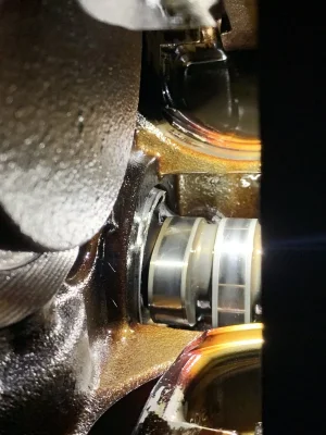

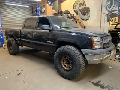

Around late 2020, I noticed a drop in oil pressure. No tick… but hot idle pressure was around 10-15psi. I assumed it was the oil pickup tube o-ring, so I ended up pulling the front cover off to do oil pump and switch it to a bigger cam since I was already there (bad lines good times, am I right!?)… Well, the o-ring looked fine, but I kept going and started to pull the cam out. It came out part way, but stopped and would not move past about 1/4 of the way out… tried a few things before aggression, and eventually got it to slide past this odd brick wall I was against, just to hear the cam bearing “ring” against the cam lobes behind it…
