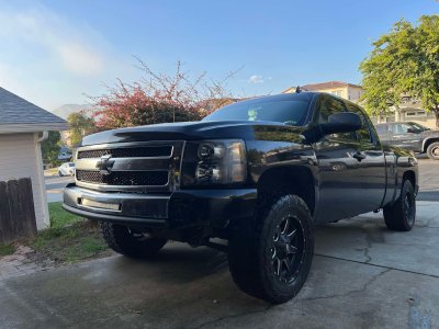

I’ve been MIA for a minute. Had knee surgery, had to relearn to walk, then had a few heart attacks and then heart surgery. I got put through the paces but ultimately had to sell my s10 prerunner.
I ended up buying a Silverado and now want to DOD delete because I have some pitting on my valves causing a unmetered air condition.
