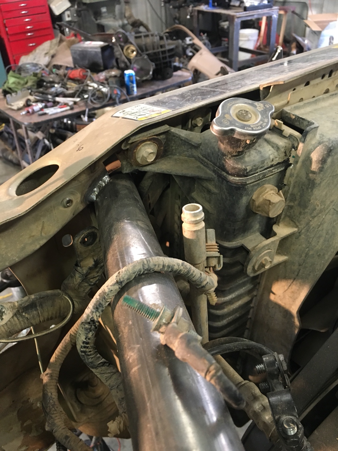

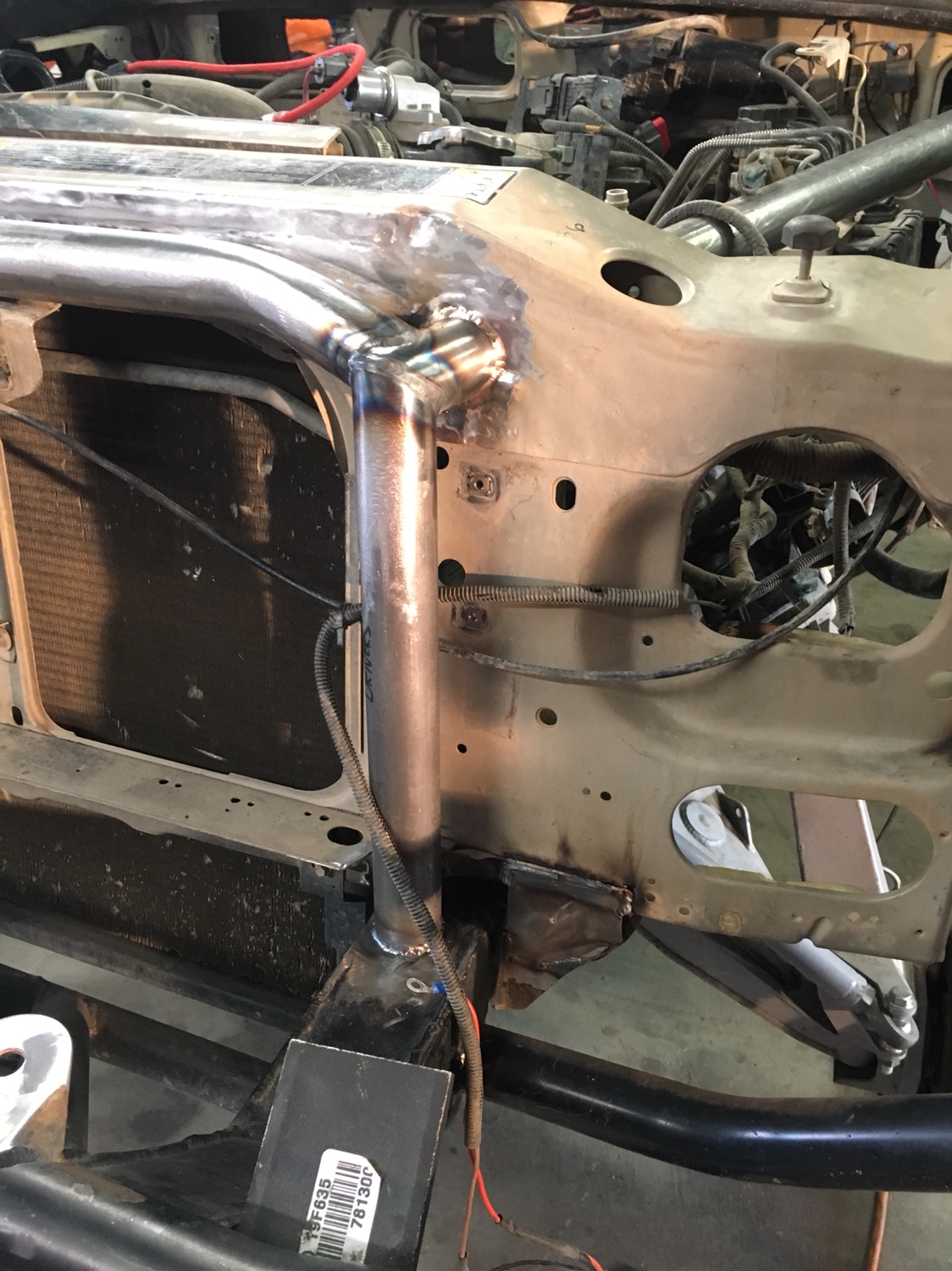

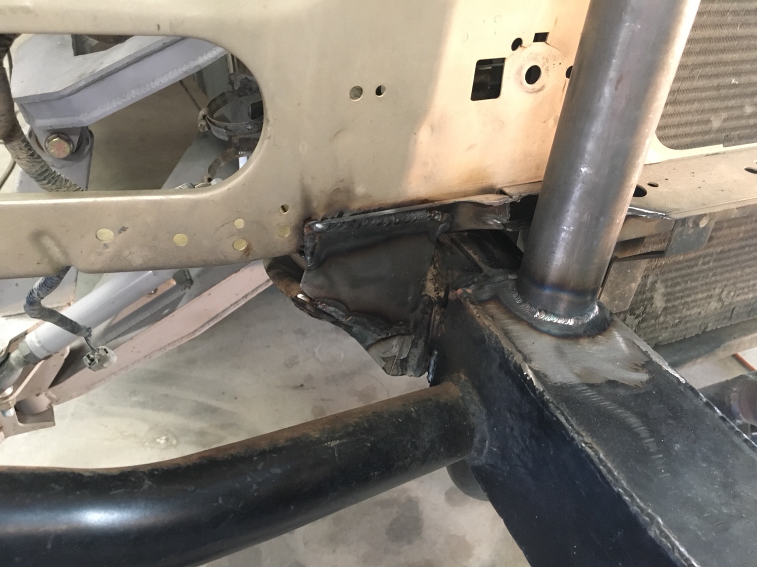

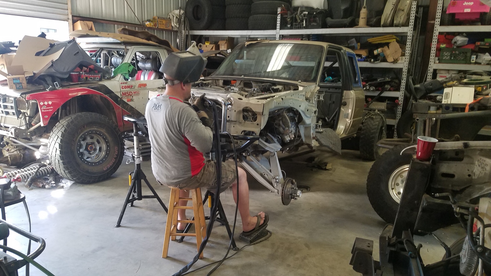

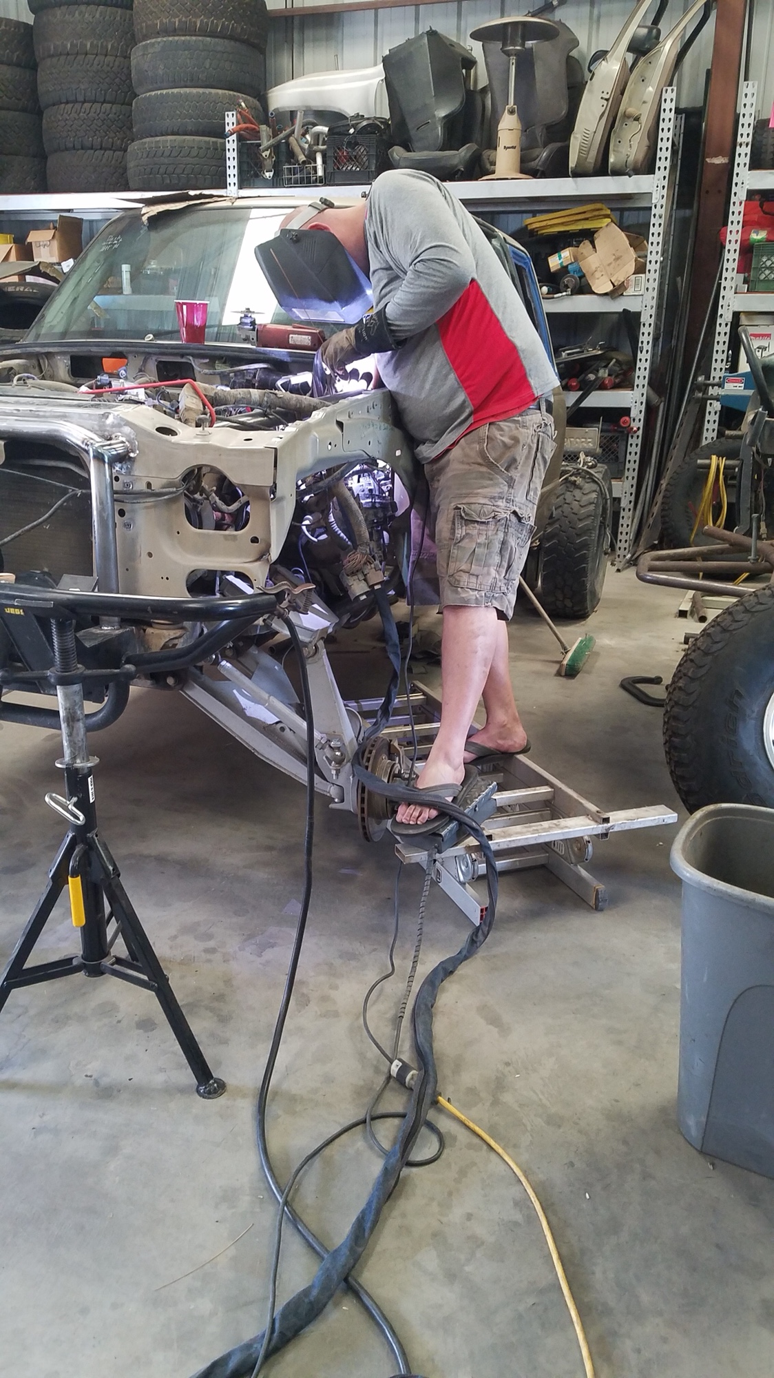

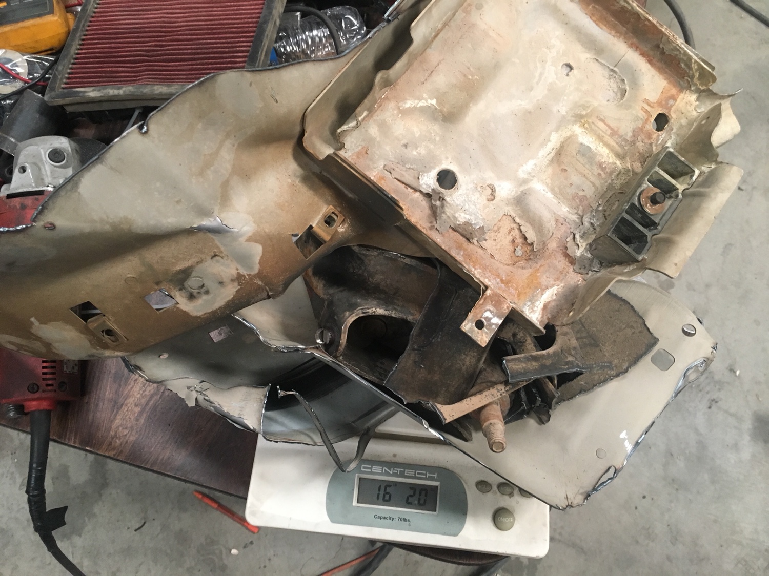

BroBroBrosephBroBrent cut out the front fenderwells:
Time: 1.5 hours
Tools: 4.5” grinder & plasma cutter
Weight saved: TBD

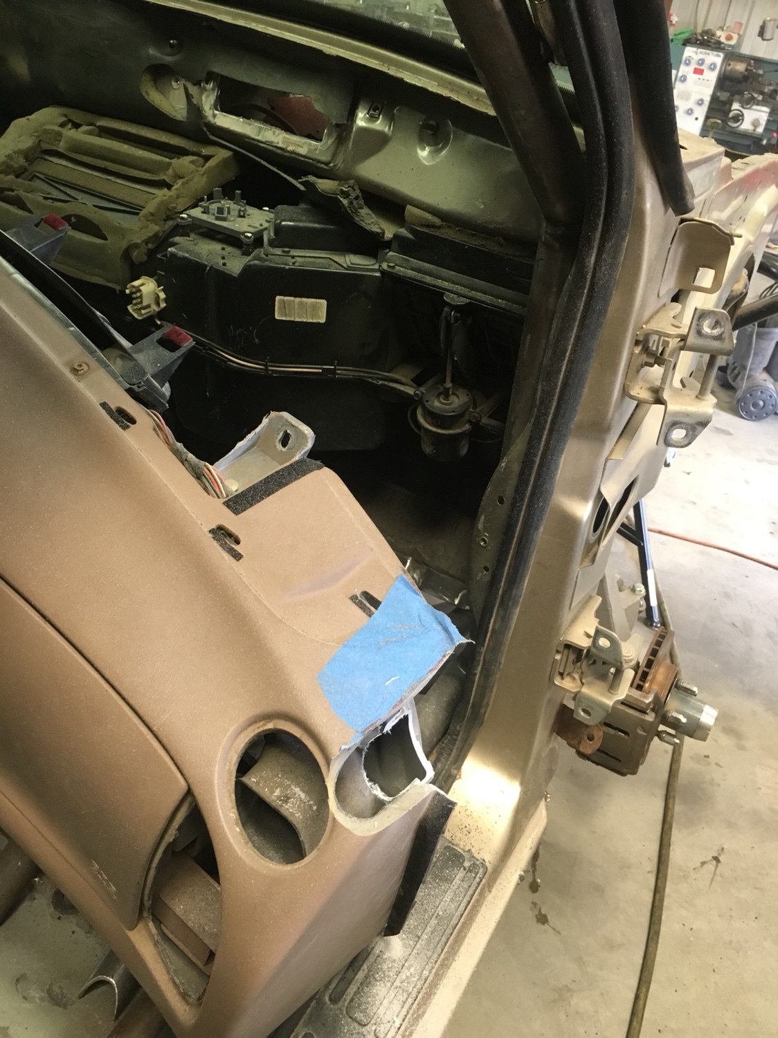

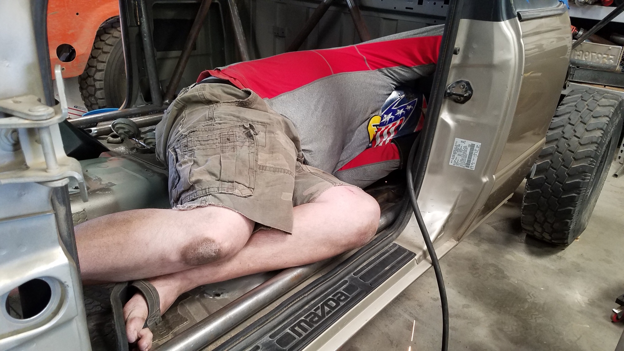

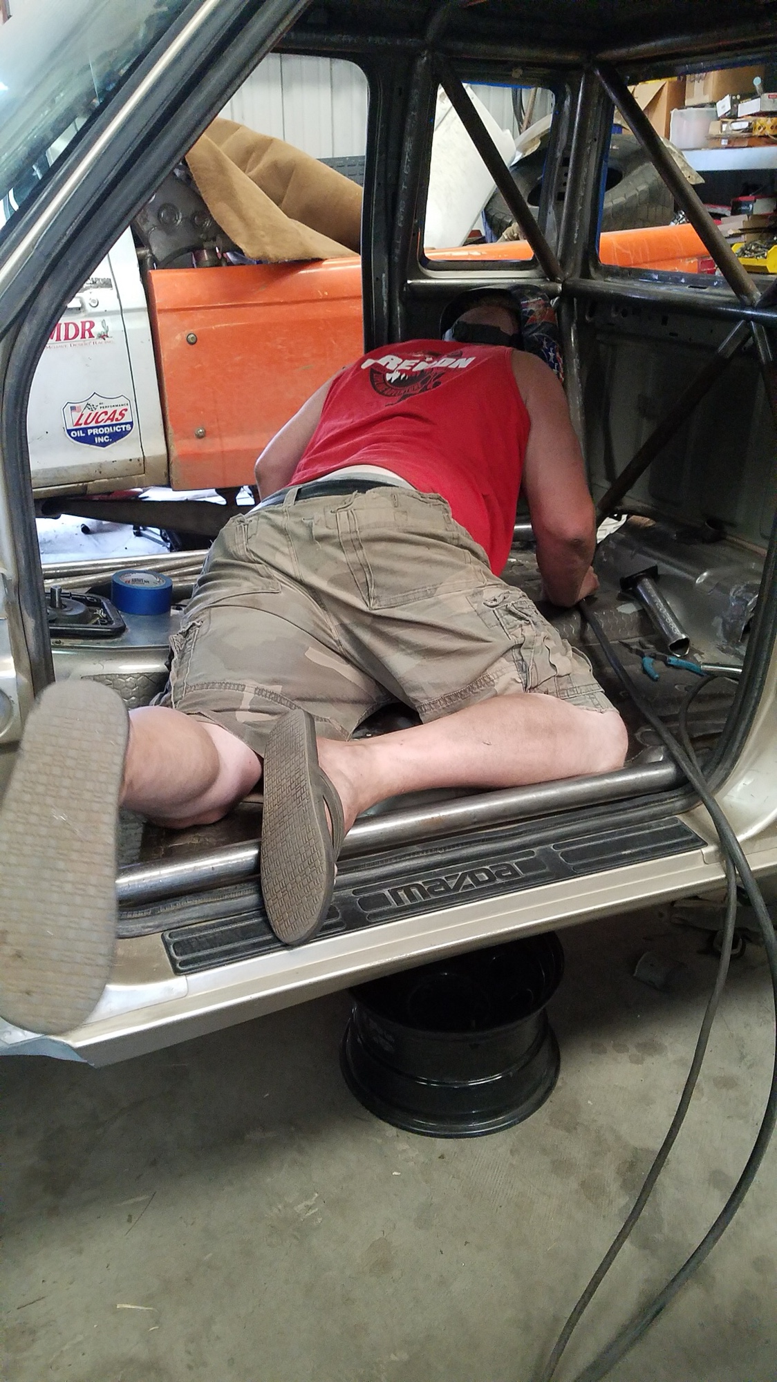

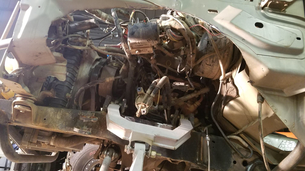

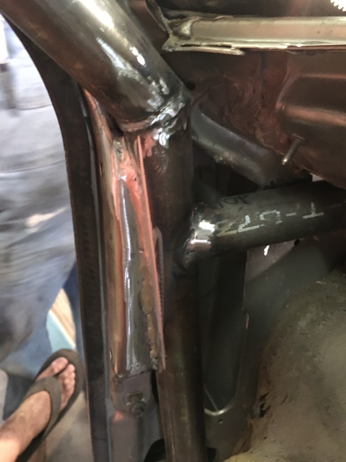

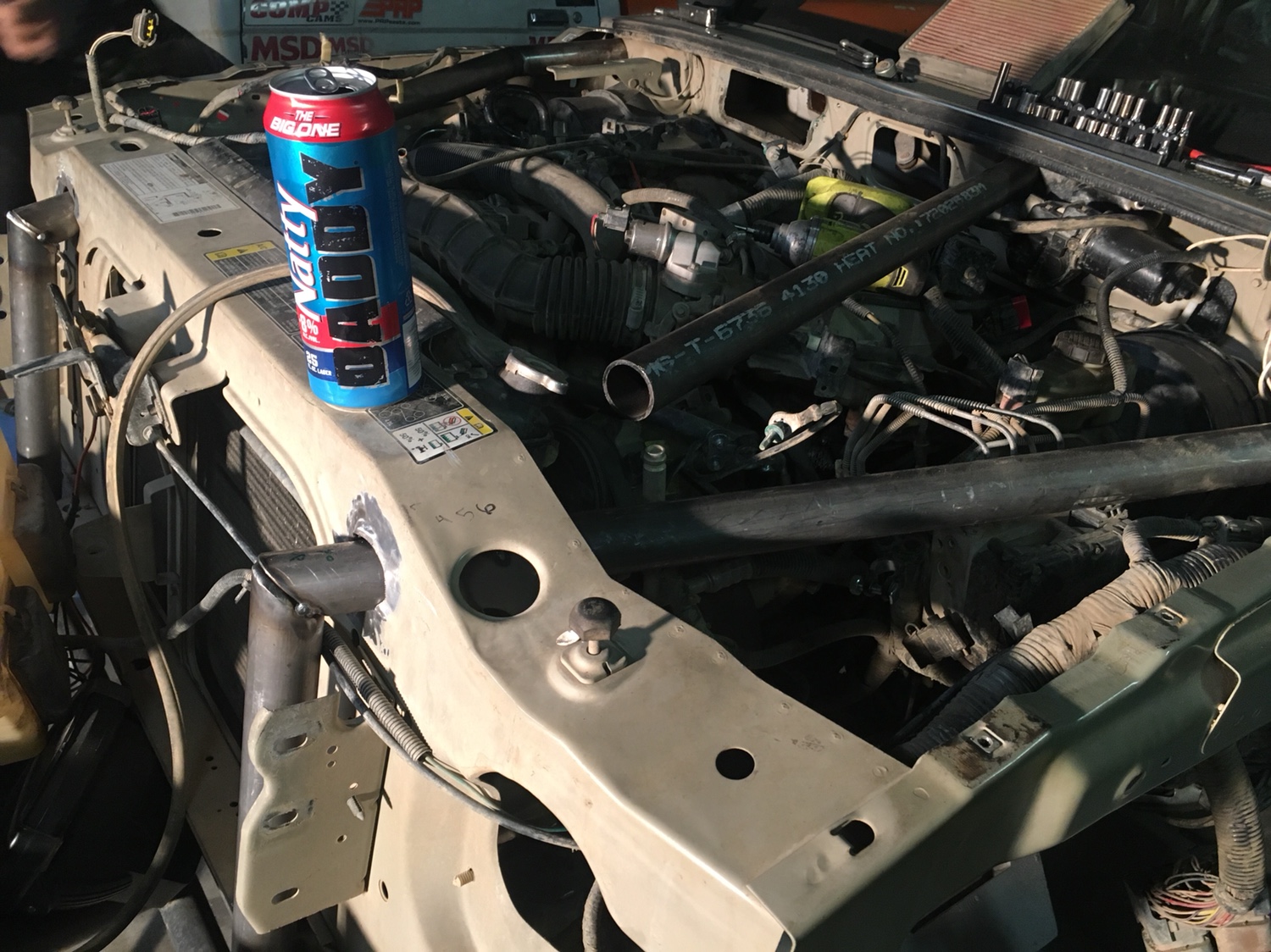

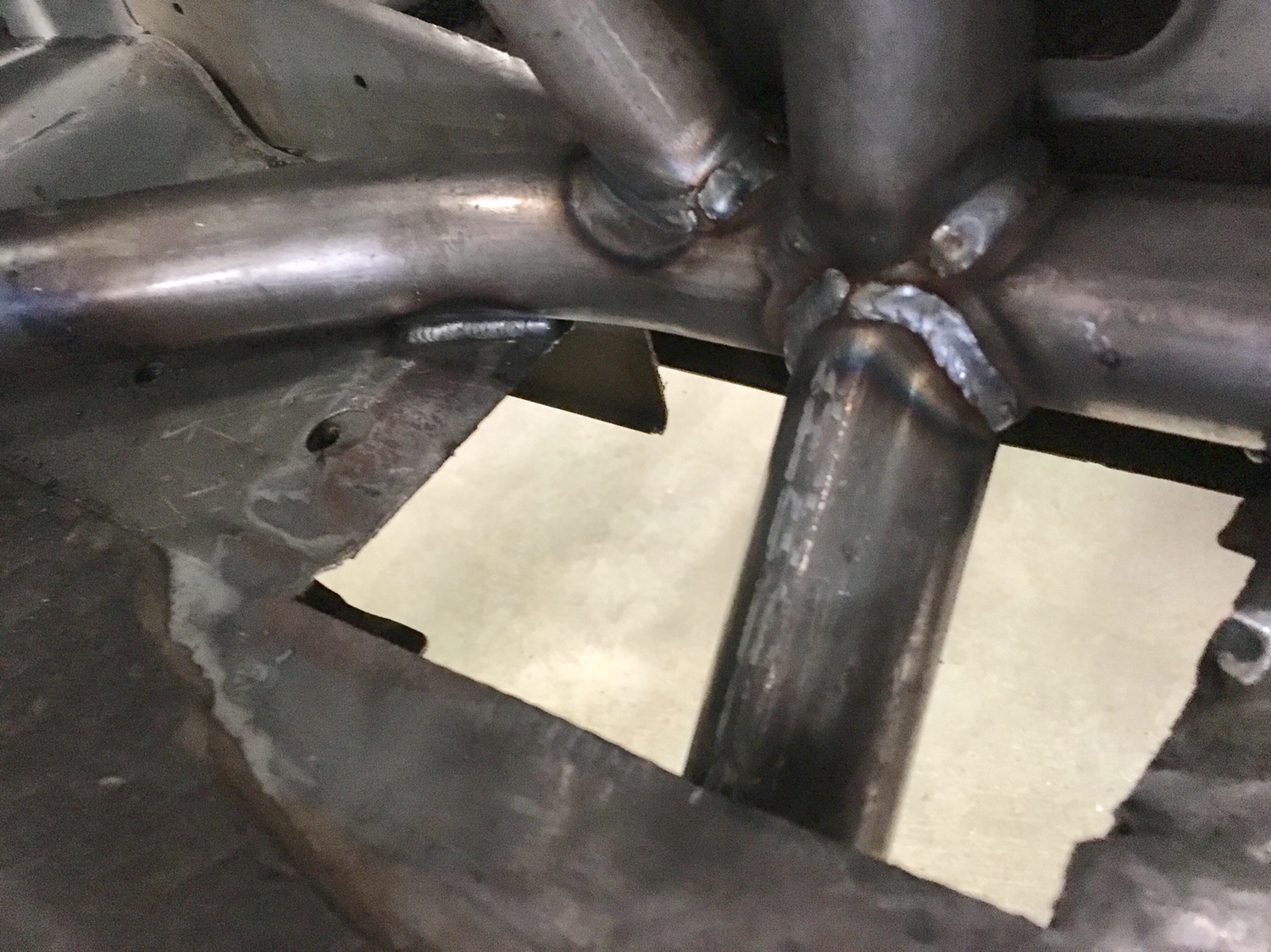

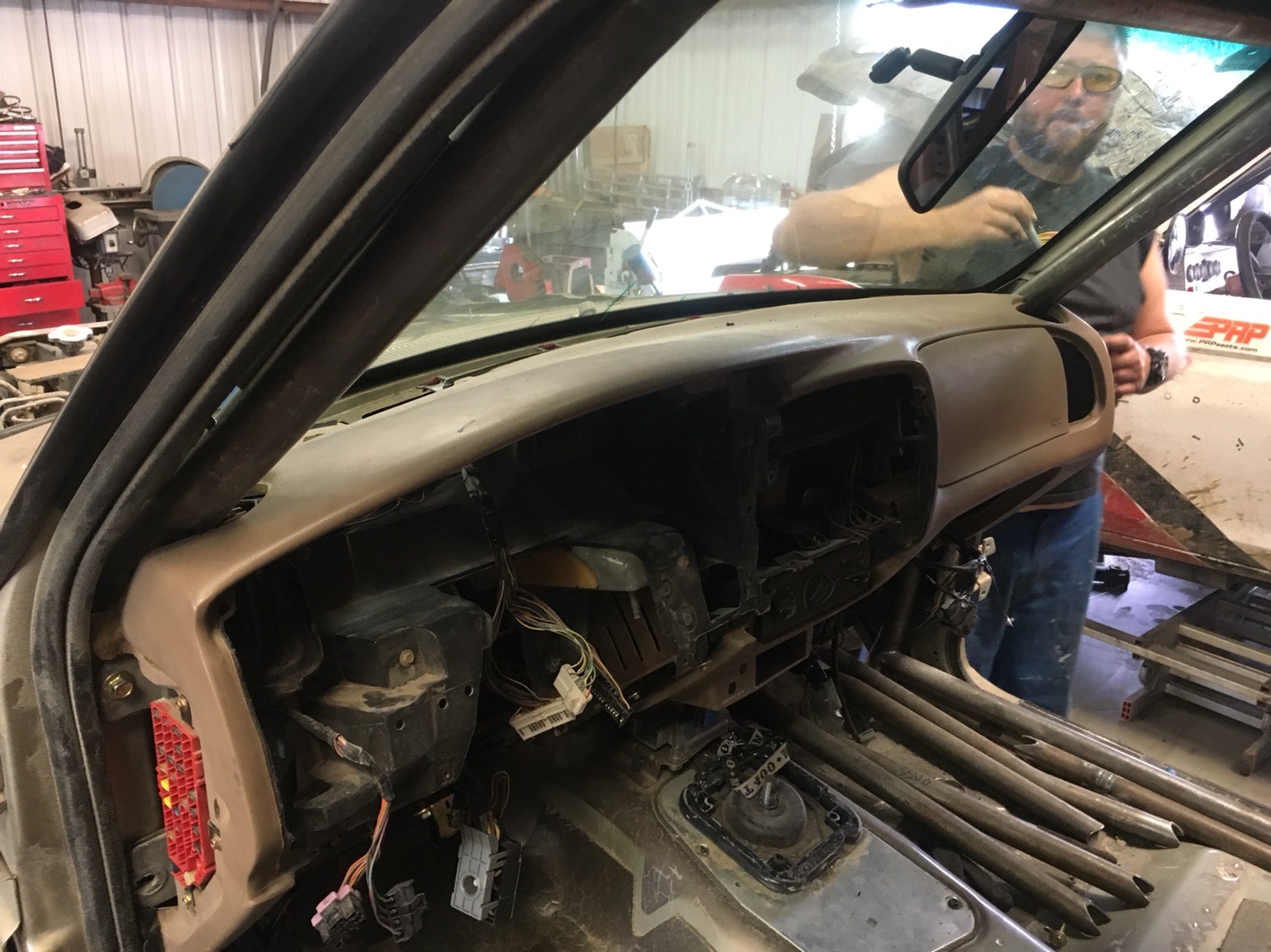

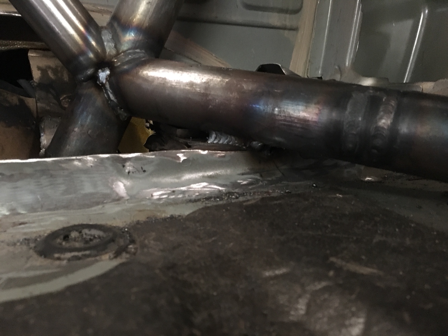

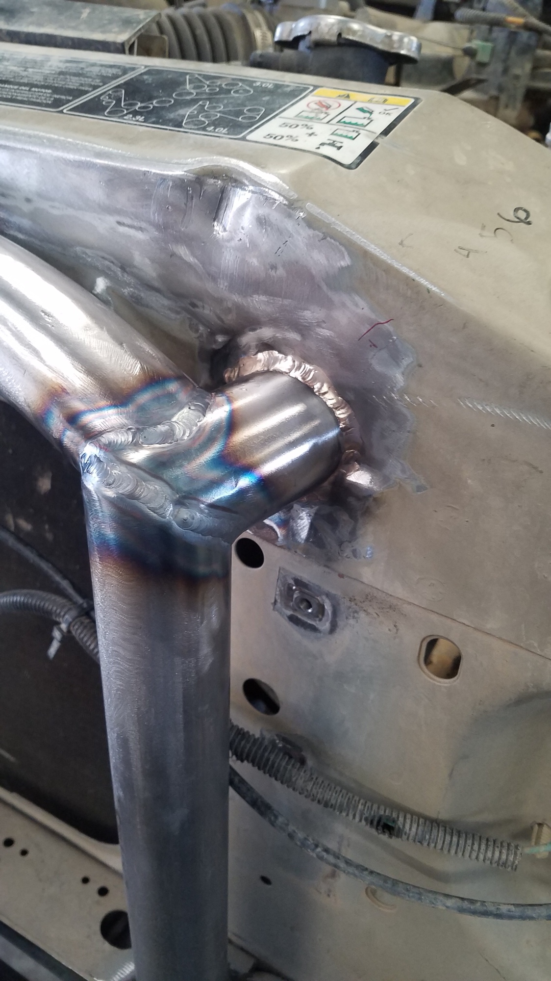

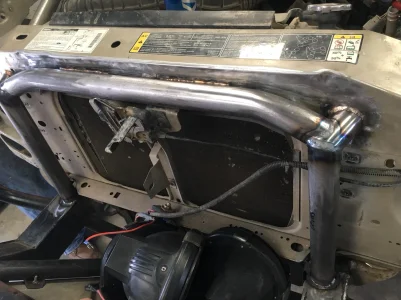

Engine cage tubes are progressing. Driver’s side clears wiper arm. The inner engine cage tube that ties into the windshield bar passes through the mounting bracket for the wiper motor. I will have to modify the passenger side wiper arm linkage. Computer will get relocated. The cross member just above and behind the hood latch on the core support was a challenge and took me around 3 hours.
Time: 4 hours
Beers: 1 natty daddy tallboy and a couple keystones, because i like to keep it smooth.
