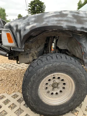

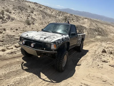

KeenYota Member Joined Jan 16, 2026 Messages 7 Location San Diego, CA Jan 16, 2026 #1 Hey! This truck has been in progress for more years than I can count on my hands, but as time goes, I hope to share a little of where it’s been. From a Body Lift and 30s and a Posi, To the Current Duffco Long Travel and National Leafs, and the future!

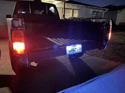

KeenYota Member Joined Jan 16, 2026 Messages 7 Location San Diego, CA Jan 16, 2026 #3 Thanks! A little more building will be coming soon. Attachments IMG_1135.webp 2.8 MB · Views: 23

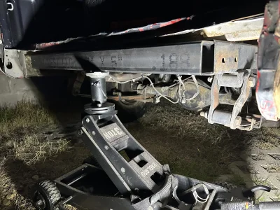

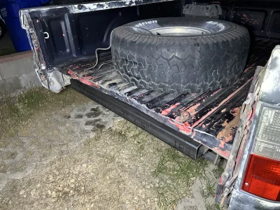

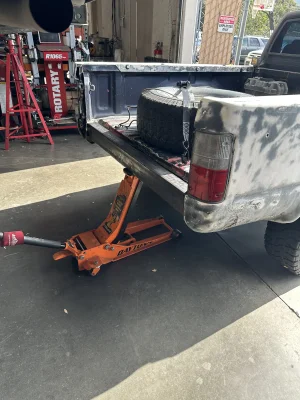

KeenYota Member Joined Jan 16, 2026 Messages 7 Location San Diego, CA Jan 20, 2026 #8 I’m in the process of a stage 1, temporary bumper since I recently got some tailgate damage. Planning on getting some F67s in there in the next few months with some bigger Foxes through the bed with that tubing! Attachments IMG_1162.webp 2 MB · Views: 6

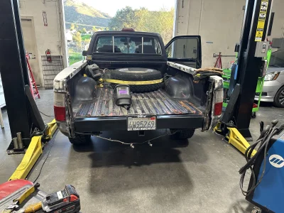

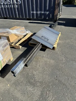

KeenYota Member Joined Jan 16, 2026 Messages 7 Location San Diego, CA Jan 23, 2026 #9 Special Delivery! A little mockup of the main form of the bumper

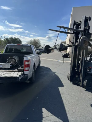

KeenYota Member Joined Jan 16, 2026 Messages 7 Location San Diego, CA Jan 24, 2026 #10 One thing I did not see a lot of confirmation on the web for: The particular axle that got from a 2002 Tundra does in fact have the same 60mmx60mm pinion flange bolt pattern as the Pickup I saw a lot of back and forth about the possibility of 66mmx66mm
4XForOffroad Well-known member Joined Nov 10, 2023 Messages 373 Location LA Jan 24, 2026 #11 2nd Gen Tacoma has the different bolt pattern. That was the first (truck) model with the wider spread.
