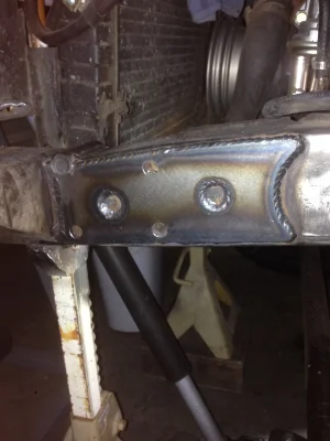

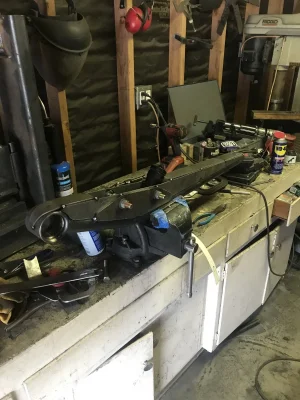

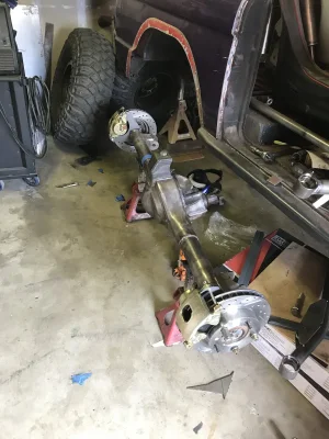

I figured I should probably start a build thread since I'm working on this thing again.

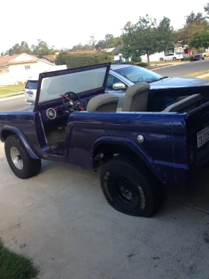

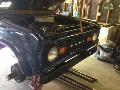

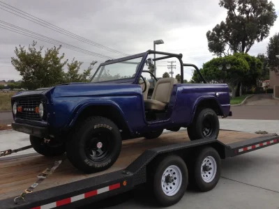

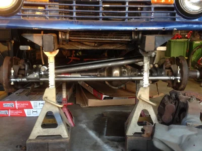

little back story, I have always wanted a early bronco and one day (years ago) I decided to bite the bullet and get one. craigslist led me to this beautiful pile for $4500. it was a pretty big mess. it had tons of bonds from a previous owner filling in the door inserts to make no seams and to hind all the rust. oh it also had a 2wd trans in it.
the game plan:
full size bronco axles (should of just went with superduty axles)
coil overs all around with desert style rear links
4r70w trans and dana 20 tansfercase
full cage

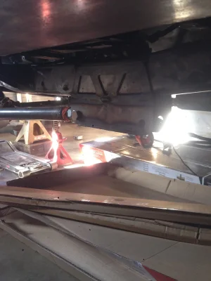

a lot of other stuff I'm missing20130921_094751_FE17C52A-43DB-41E5-8913-333F32140F1E.JPG20131130_152652_D73B1681-2962-4559-B8C0-918A05D04084.JPG20131130_152756_2A78DC0B-4907-40DB-8B5E-E0CF91BB7FC8.JPG20131130_152811_02ACBB44-0A5D-42A1-A6C7-5E879CC20276.JPG

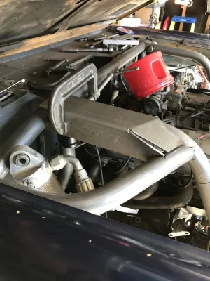

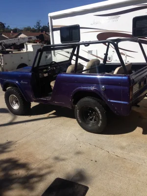

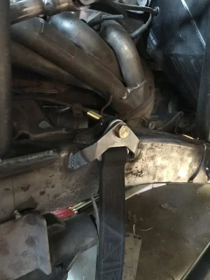

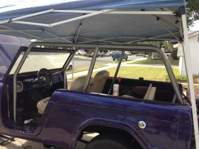

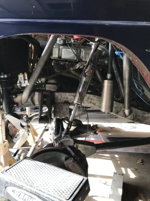

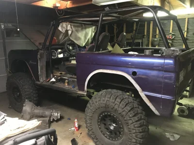

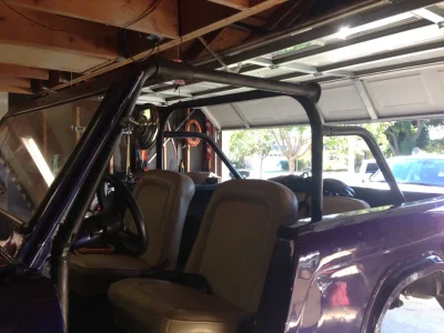

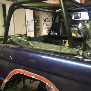

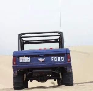

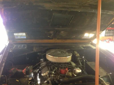

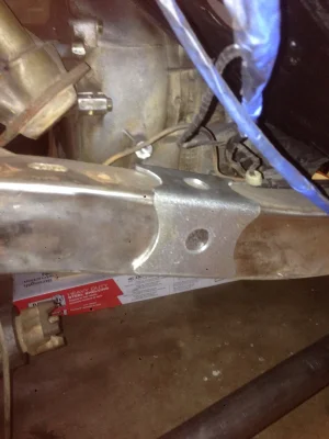

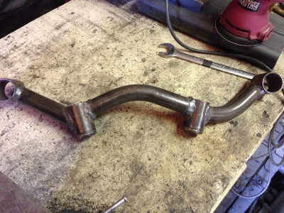

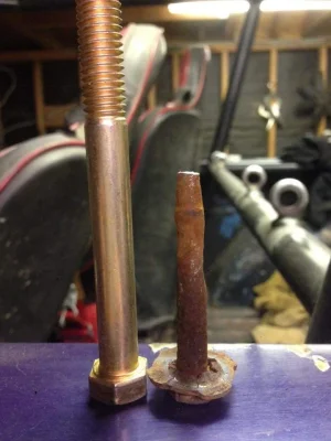

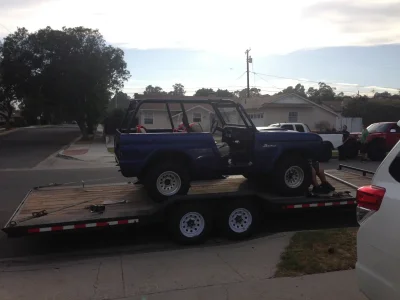

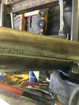

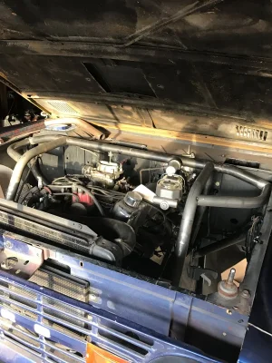

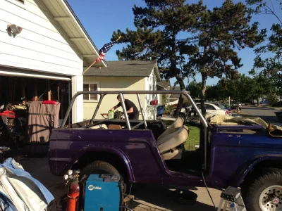

so it sat for a long time while I was building my tacoma. we had a Pismo trip planned and the tacoma wasn't going to be done so I took a day and built a cage for it. Pismo was fun for a few minutes at a time. the engine looked like someone dropped it and the pullies were all bent to shit. so it would loose a belt at high rpm. oh and the front axle was using the the oil pan as a bumpstop20140719_080543_F893CA98-DD56-4187-A5A5-35901A04718B.JPG20140719_170404_5C0B8B8B-0F4C-4063-898B-2B89070A5812.JPG20140720_182818_06B7E581-E95D-4D2D-B36A-CA320CA1E1F1.JPG20140725_182637_2304FE8E-FB52-4A69-ADE1-5AA345862C8B.JPG

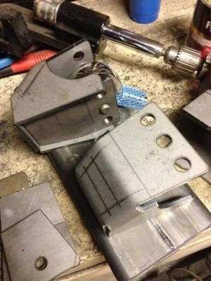

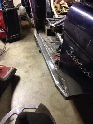

then it sat for a least another year before I decided to get after building it. we also decided to move to Arizona during that time so it didn't get finished. flash forward 5 years from that, I'm starting to work on it again. man it's depressing that I have taken so long on it20141215_234733_DBCAF0C8-D7D2-45C7-AAB8-BE9802661E7D.jpg20160221_144137_64948561-4EF9-45E1-95D2-CA3489E208F5.JPG

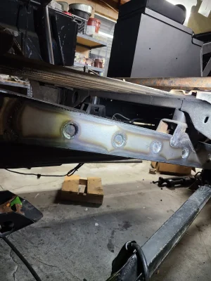

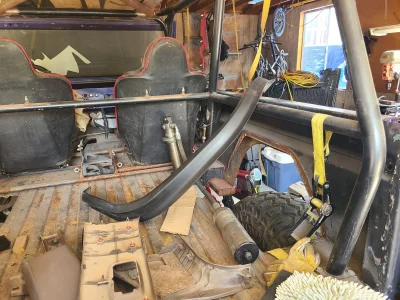

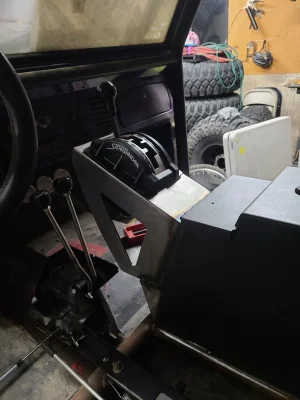

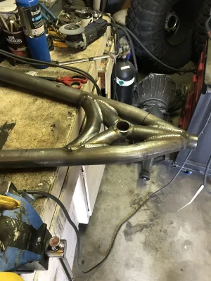

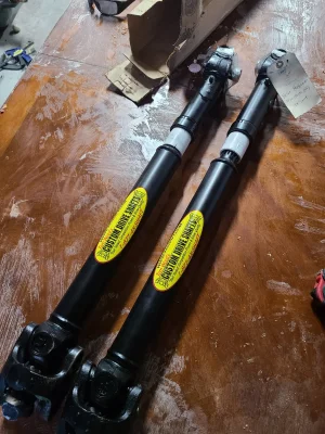

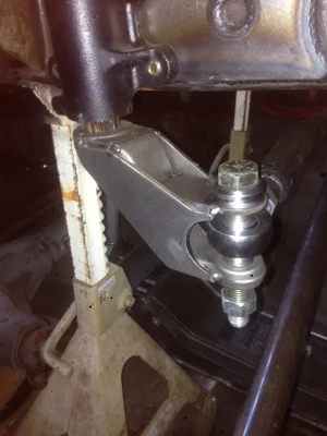

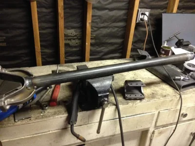

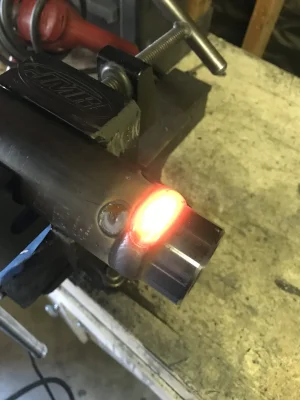

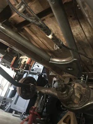

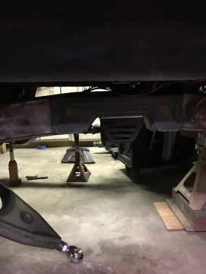

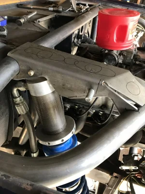

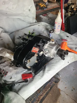

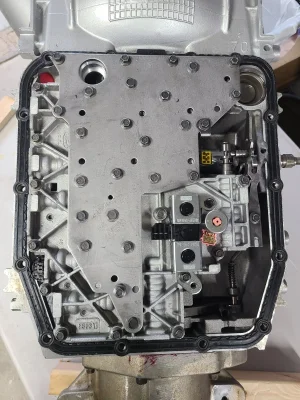

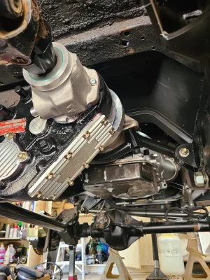

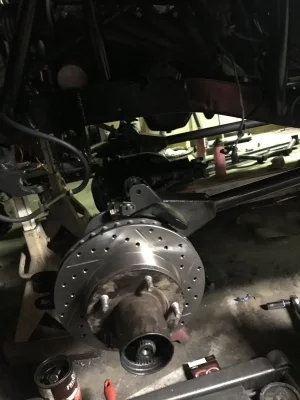

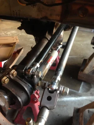

so new stuff. I rebuilt the transfer case and got it ready to go in, put the manual valvebody in trans. once I get those both in there home I can get driveshafts and check to see if I will be using my existing 14in coil overs or if I should go with 12s. then I can start the fun of building the rear shock mounts and sheet metal20230815_171410.jpg20230820_073653.jpg20230519_110746.jpg20230519_110734.jpg

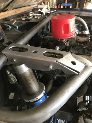

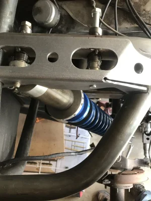

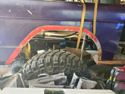

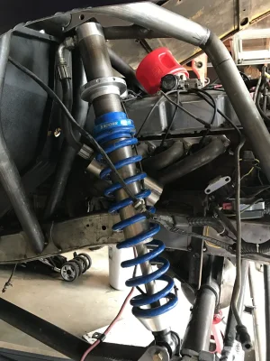

I had my old ricor coil overs. after checking with a driveshaft and everything mounted, I found out I needed a 12in coilover not a 14. So I got a pair of ADS 2.5s. eventually I would like to put them on the front too. the ricors have a 1in shaft which probably won't be to friendly on square edge hits.
