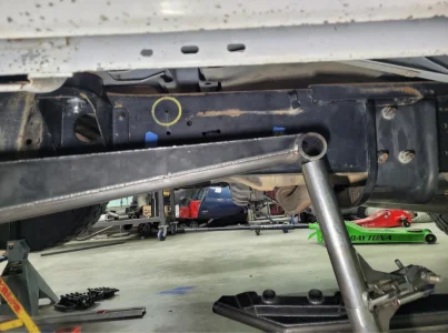

Also asking about the link because me and Brett are doing it this summer I hope. Where are the links mounted in front? Is it inline with the drive shaft joint
The lower link pivot is in front of the double cardan joint, and the upper link mounts are about inline with the DC. I dont recall how much driveshaft plunge I have but its pretty minimal. I dont have any good measurements for you off the top of my head. But I found a picture from when I was mocking it up.
