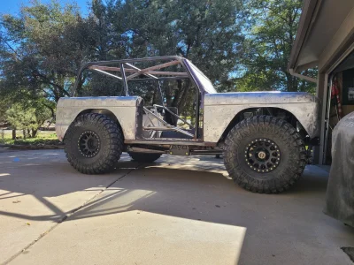

Is that middle tie in to the shock mount necessary? It has that much leverage?
the towers are pretty tall off the frame so there is a good amount of leverage potential. is it overkill? most likely but I would like to build it only once. that is why I set it up for dual shocks too. if I get bypasses someday I won't have to rebuild it all

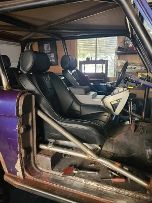

sorry for the delay. I blew my back out again a few weeks ago and then went to KOH with the jeep, so that stopped all progress. I'm feeling better now now and got started back at it. I havent taken pictures but the tower tie in's are all welded up, got the rear seat mounted, front seats remounted since I changed brands, got all the seat belt tabs positioned and welded up, rear harness bar in and modified the front harness bar to make the rear more accessible for the little ones and the dog.
20240214_165701.webpcage wise I just a few more small things and then I will be ready to pull it so I can finish weld some things and spray the body for bedliner. slowly getting closer!

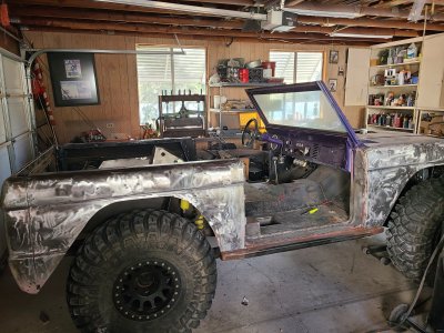

some more weekend progress.
last bit of frame plating done on one side.

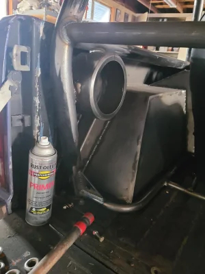

20240218_164749.webpspeaker cans welded up and welded in and some corner gusset/tie downs welded in 20240218_164710.webplock tab to be able to lock it in park and you can barely see the transfer case shifter cover is made. just need to put the boot on it
b pillar seat diagonals done and cut out the section of rust that was above the sliders and replaced it

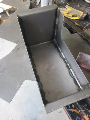

battery box tray.

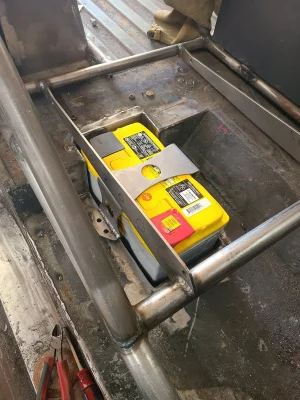

battery counter sunk under passenger seat

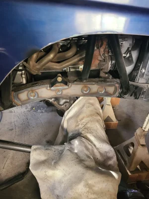

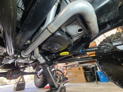

exhaust is built and in!

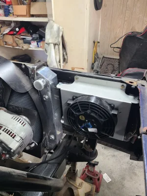

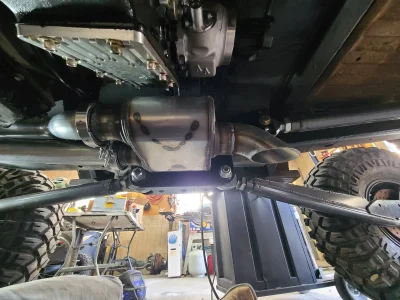

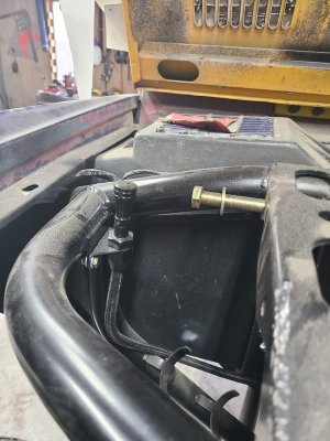

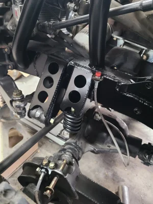

front bumpstops mounted and brakeline so I can start running the hardlines

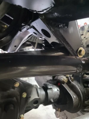

plated in the backside of the trac bar like I should of from day one.

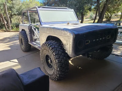

cage pulled
most of the body stripped down

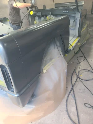

no pictures but the body is prepped, interior floor stripped and ready to primer on Saturday if all goes right.
