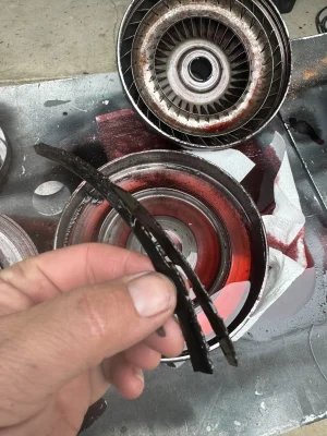

So transmission issues are still plaguing me. I didn’t get to take it on our sand hallow trip because of it. I dropped the pan again the day before we left to see how the filter looked. It was night and day better but after a test drive I noticed the pan was super hot and the cooler was cold (gauge is at the cooler). I pulled the cooler lines and I’m not getting any flow from the transmission. Everything still shifts fine though. My best guess is I have a blockage somewhere but who knows where.
So still battling the transmission and being pissed at it so I haven’t touched it much.
Went thru the valve body, reinstalled and everything working correctly … for about 15miles and then lost cooler flow again.
I finally stopped being a bitch last weekend and pulled it out.
I pulled the pump off and it looked pretty good so I cut the torque converter apart.
AND I found the issue. The lock up clutch exploded which caused all the material in the filter the first time and the transmission never slipping. There was enough material inside that it would plug up the flow to the cooler. IMG_3800.jpeg
