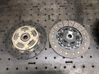

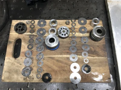

Is the new clutch something special? Maybe I skipped it?Clutch assembly was finished about a week ago. Apparently their guy lost my number.View attachment 1310
I had a company here (Valley Friction) build one that encases the springs better. I’m not sure that I entirely needed it, but I have seen a couple guys destroy the stock ones.Is the new clutch something special? Maybe I skipped it?

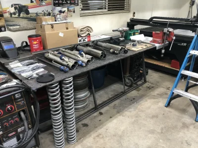

That was the original setup. This is my first time opening these up. After consulting the elders, I’m going C/O .008 Rebound .012 Comp Bypass .008 Rebound .020 CompNever owned a fancy linked truck so I'm not going to be super helpful... but why not just run a 12 on compression to keep the CO compression simple? I can't image it needing a flutter stack.
Completely openThat's not enough rebound control in my opinion, what do your tubes (rebound) look like with the current setup?
Wow okay, what about bleed screws in both shocks? Also how much preload on the springs?Completely open
450/500 with 3/4” of preload. 2 bleeds open on BPs and all bleeds open on COsWow okay, what about bleed screws in both shocks? Also how much preload on the springs?

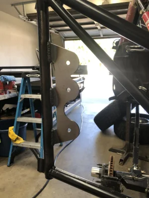

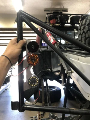

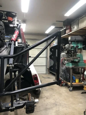

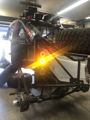

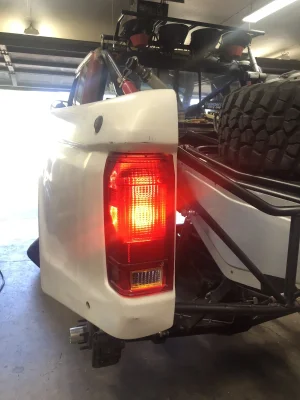

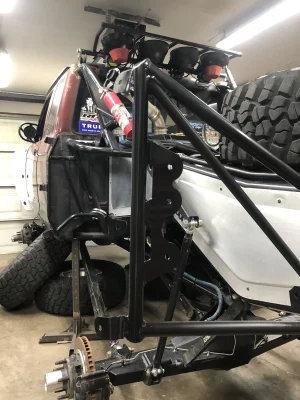

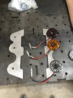

Definitely is. I had to cut about 20 zip ties anytime I had to remove the bedsides. I fucked up the wiring the last time I did it.Dude that looks great. Having the tail lights separate from the bedsides is a game changer
