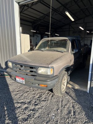

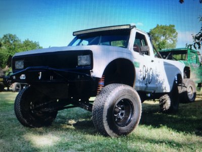

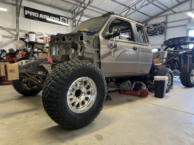

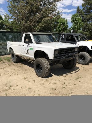

So to start this story my brother has been in the scene for a while now and has had a few trucks and I bought his first truck from him after he decided to upgrade
The truck was an 88 single cab ranger he got for $400 sold it to me for $700, I threw some 10” kings on it and scored some f150 beams for it as well.
BFFFBC1A-978F-4887-B172-56D122F1055C.jpeg910F357F-4031-4A09-9F7A-9A9B63C6FA5C.jpeg83A8719F-EFB4-48C5-A4F5-C04E975AC2F0.jpeg
Took it to a few tough trucks and rolled it on my second run out. Pretty much wasted the truck. Cage was crap as it was just bolted to the cab. Parted it out mostly and waited to find another deal to actually build a legit truck.

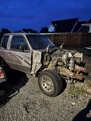

That was in 2018 so fast forward to last year in august we moved from the Bay Area to the valley. My neighbor had an extended cab ranger on a trailer with a flat bed and he was trying to get rid of it for a friend, offered the guy 400$ and we drove it over to our yard. Pulled the flat bed off and sold that for parts fund.

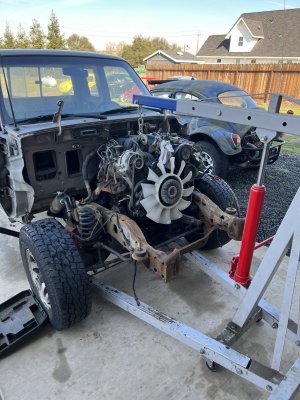

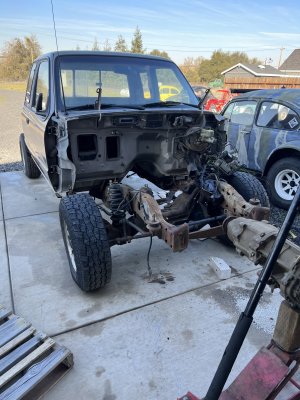

Then started the disassembly stage

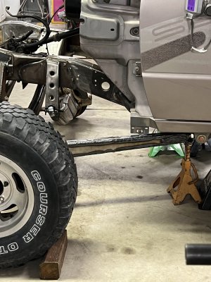

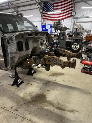

Pulling the front off and engine

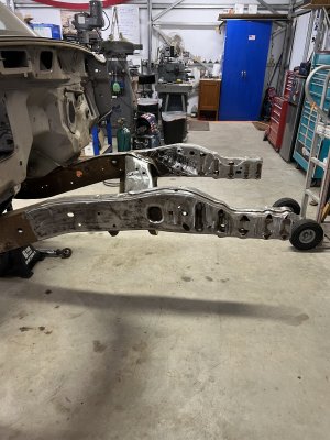

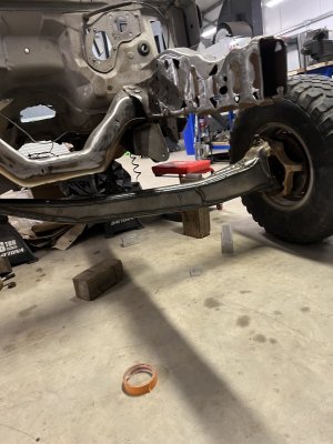

Found some d44 ends I needed for some giant WIY beams we were gonna run
And started chopping those up to weld to the new beams

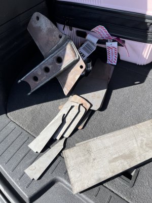

Me and the gf went to Disneyland and I figured it would be a good time to grab the beam kit , ended up getting hangers from Geoff as well since I was gonna need them anyway

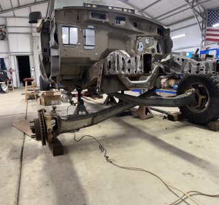

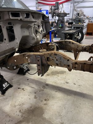

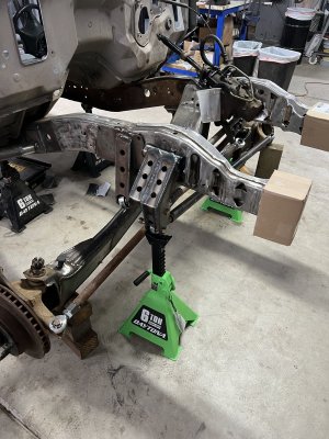

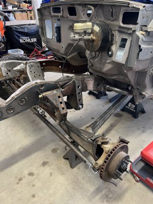

We got back and pulled the truck into the shop and removing all the front steering and suspension.3824A13B-AD74-4DBD-AF3F-470D5FDBF63D.jpeg5415BF07-BA7F-4706-BCC8-77D8D5FC7EBB.png
Mocked up the hangers for a pic then I ordered some diy off-road plans for I think is baker fab steering swinger1C76A308-B44A-4CC2-BC70-1BE117A007F6.jpeg

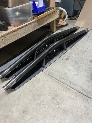

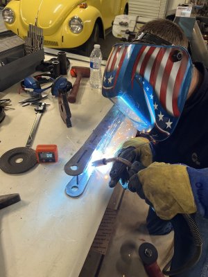

Also got an affordable bender and started on the beams, was my first time using a bender, I think they came out okay

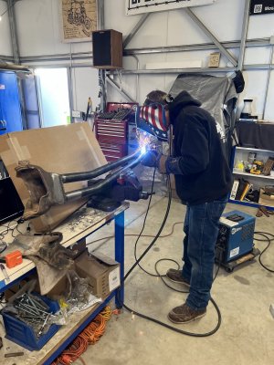

And my brother does all the major welding since he has a ton more experience in it than I do I’ll usually tack where we want it and he’ll finish it up

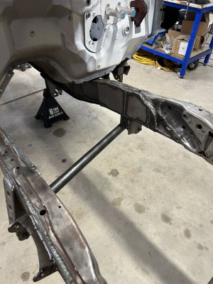

Front end all cleaned up ready for fresh parts

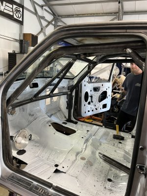

Bought the cage from. TE Designs , nice cage and really easy the assemble everything is marked with a laser so we prepped the tubes and started getting everything together

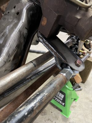

Beams finished and mocked up
Next was radius arm pivots from baker fab

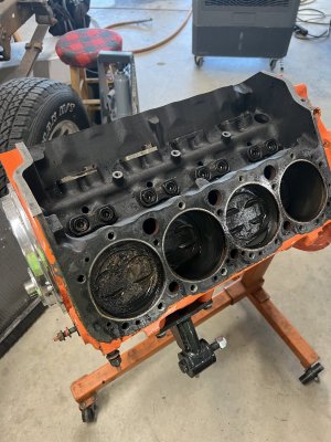

Also got a 350 from a friends table for free so started tearing that down to clean and rebuild with a cam

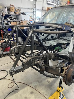

Hit up oddball motor sports for the radius arms and started welding those up and figuring out the camber and caster for the beams

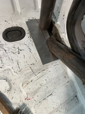

Had some holes needed filling in the cab so got on those as well
More radius arm pics

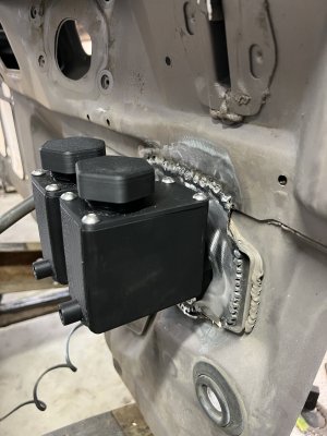

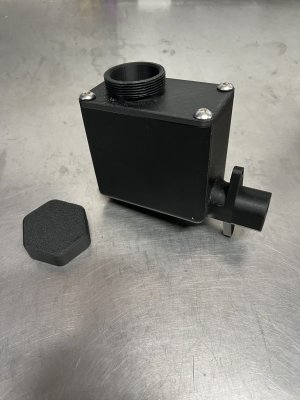

And started on designing some master cylinders for the brakes
These are 3d printed for mock up purposes

Masters mocked up
Ended up taking out the whole firewall so we’ll have to remount these guy

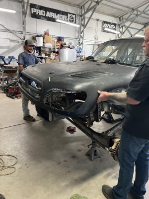

And a Toyota one peice on a ranger?? Brother in law wanted to see how it looked

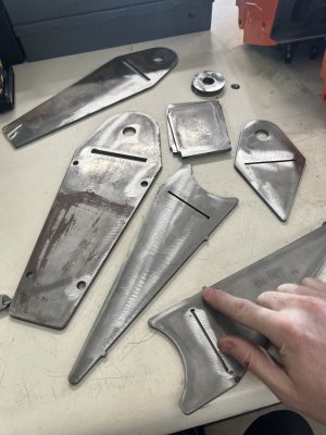

Lower shock mounts
Cam showed up and made a stainless steel double shear for the pitman arm

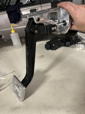

Made a bracket for the brake set up and a billet pedal instead of the stock wilwood pad

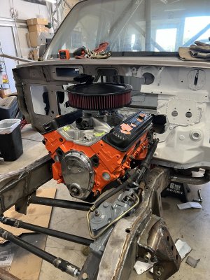

Now was time to throw the engine in and get the mounts tacked in
Realized we wanted to push it way back so there goes the tunnel and firewall
Engine mocked up to get mounts set for turbo400 and engine

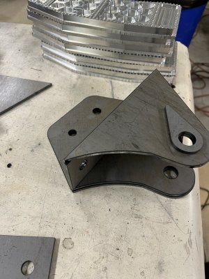

Pitman arm double shear tab

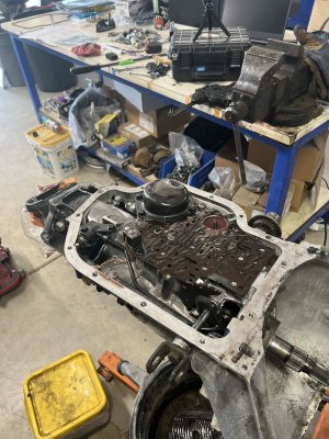

Shift kit for the th400 going in noW
Next was engine cage

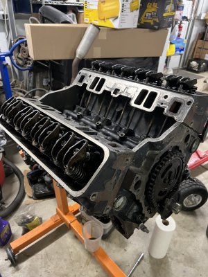

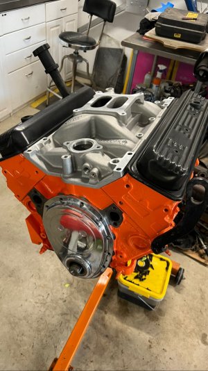

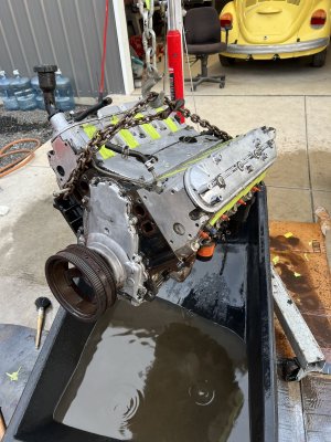

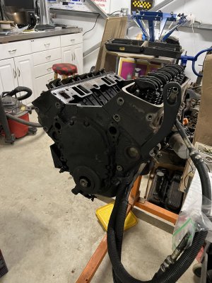

Engine tear down for cam and parts
New ls6 springs as well

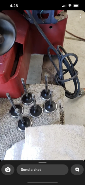

Resurfaced intake rod and new exhaust rods
Going back together

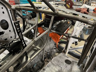

Got the front part X in the cage gonna run the LS after my first season, gonna build it up while I run the 350 for now

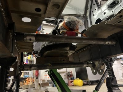

Rear trailing arm pivots came in so I’ll mess with those soon

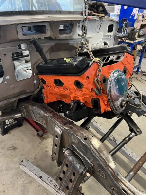

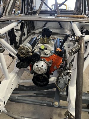

Engine is mounted now and headers going on soon

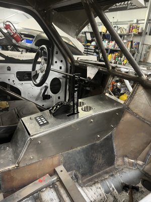

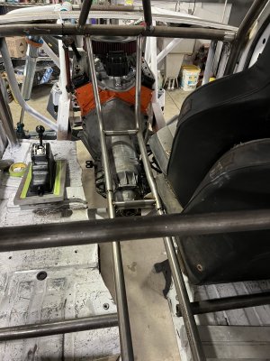

Started working on interior paneling cage and firewall recently F28EA74D-9B50-4856-B524-C49394B921A6.jpeg

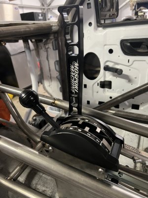

Mounting shifter and ebrake
I know the tacks look like shit for now but we’ll be cleaning them up after final fitment

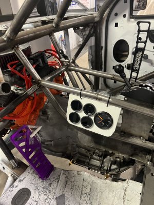

Did some quick and dirty wiring to get that going as well as a 3d printed gauge bezel so they’re not rolling around the floor

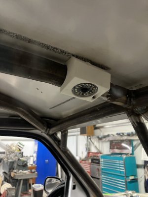

Also 3d printed a dome light mount. Here’s half other half is still printing.

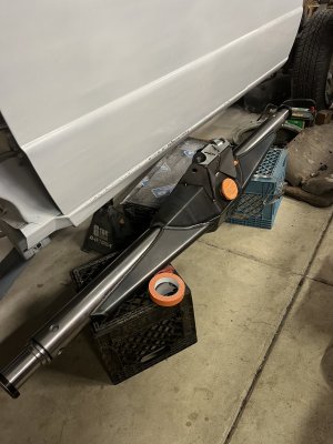

Camburg rear end showed up so we put the upper link bracket on and threw the snout on, still need to weld those up3A8481D7-CB78-4315-A21B-766175AB0554.jpeg

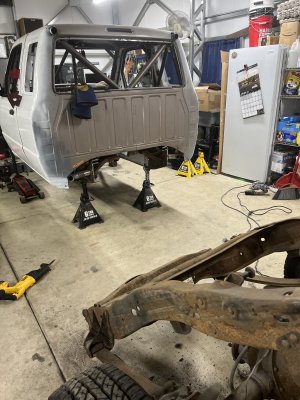

Pulled the motor and trans today to get all the panel and firewall tubes 360 welded and waiting on the panels now to mount them and getting ready to cut the back half off. Shooting for tmrw on that.

Fire wall and interior paneling is done now

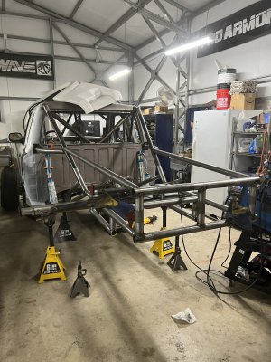

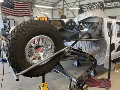

Was doing some fitment checks on the rear fenders with the wheels on313F526D-6B9F-47B6-8526-3B62EA33F20E.jpeg

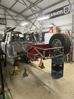

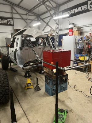

Started the back half and got the fuel cell set where it was going to go9316FC01-375C-4E43-A816-E35DD1F5735F.jpegAD09139B-0DDA-4295-9CDF-56CD89709E6C.jpeg
Fully tucked
And started working on the spare mounts

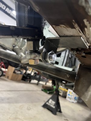

Also got the rear shock mounts in from sent cut send and welded those on too

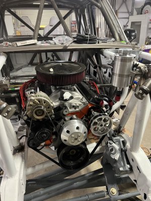

Probably start brake lines this week. The engine is back in after I painted the firewall and the interior so that should be done for now
Gotta get a couple spark plugs, 2 snapped off when removing the engine last time
Then the headers can go back on and I can get the plug wires and the engine wires buttoned up.

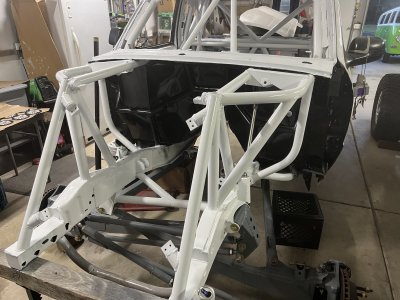

Firewall and front end tubes painted

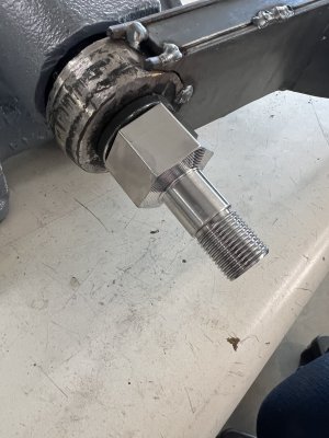

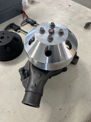

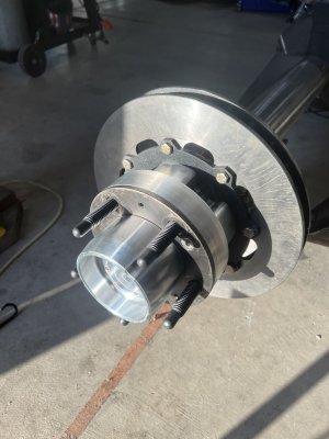

Designed and made some hubs, 2.5” timken bearings waiting on the set from anodize too.

Threw the gauges in for the picture made a billet switch pros faceplate anodized the gray to match the rest of the theme.

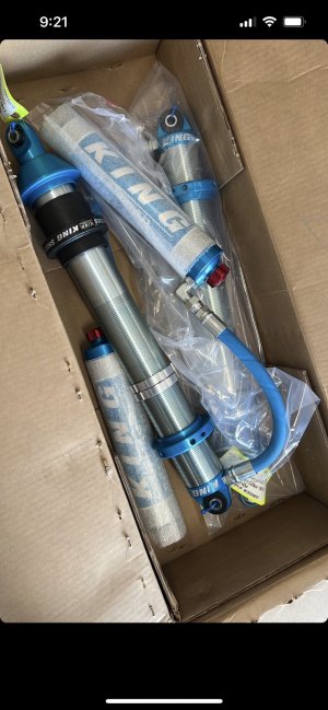

Also was down in San Diego last weekend so had to grab some springs from king. Always wanted to check that spot out and their shop is sick.

I want more info on that brake pedal pad for wilwood pedal ... but i didnt see it on website
Ideally.. i would want one to extend the pedal length some in addition to the larger size of course..
ok, I am game for one for sure. pretty sure it is same bolt pattern.
i will sketch something out when I get some time. might be a little bit. I need to focus on paint in next few weeks. And taking old truck, 2ghetto, to the TerraCrew event.
Edit: What is current dimension on height and width from bolt pattern. I'd like to compare to the wilwood one.
