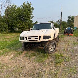

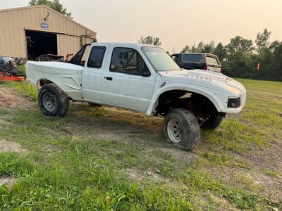

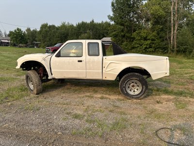

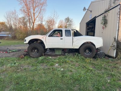

Pulled the boys truck out got the fiberglass swapped over and going to get it in front of the barn and up on stands so we can mock up the motor and trans and get the dana44 and 9” swapped in so parts aren’t just laying around.

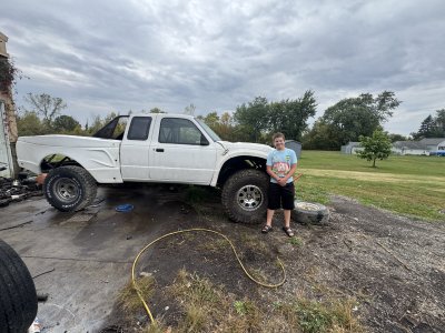

Well a buddy/ local racer got ahold of me this evening to see if I wanted some used 40’s. For spares for my bronco. Went to pick up one and ended up with a set of 6. So I guess we are going to run 40’s on this. Now.

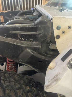

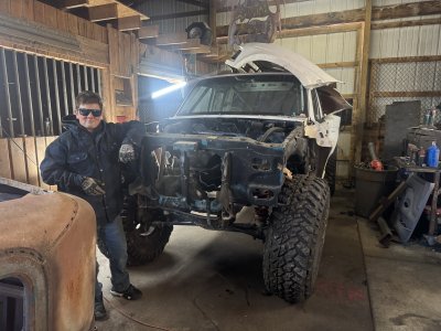

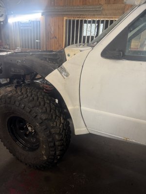

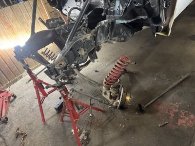

Put the boys truck in the barn for the winter and started a few things in it. Fit the mini fenders then cut the core support out and pulled the 2wd beams and bolted the d44 beams in. The d44 are just temporary so we can come up with a game plan for new mounts. Going to push the axle forward a few inches
