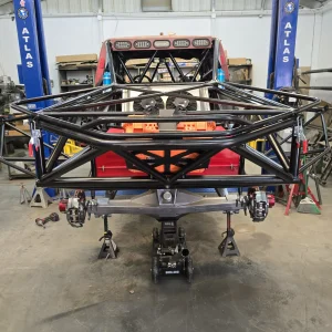

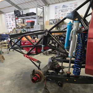

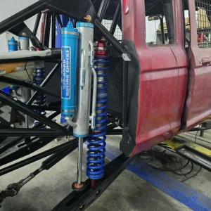

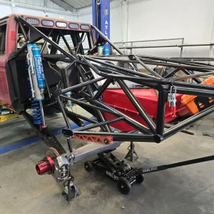

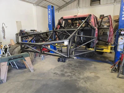

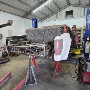

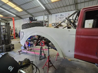

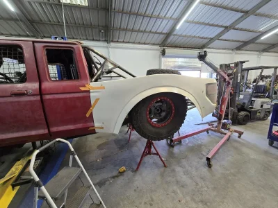

So today I got both bedsides mounts tacked in place. Now i can finalize the dual spare mount on the hinged lid and then final weld everything. Once driveshaft and carrier bearing crossmember is done it's time for final welding on those pieces and then paint to reassemble.

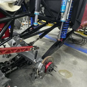

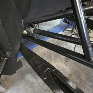

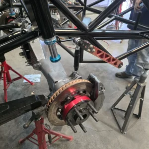

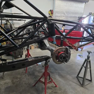

Lookin sweet man! One thing just make sure your rear bumps are 90 degree to the bump pad on your axle. Looks like it's a little easier to adjust your bump pad now than redoing the bump now.
Yeah bump pads on the axle are at a retarded angle on this housijg and not the same side to side either. Different distance from end of axle and everything. so I'm gonna weld a new bump pad to make it all perfect again.
Coming together sweet, love the rear nurf bar/bumper. Finishes out the rear end nicely.
Rear tube work gonna get paneled in also?
Got the rear all painted and reassembled and it got picked up today. She also bought a mitch made front beam kit so after I finish the work on the double cab taco I'm doing now it'll be back for more work on the front and get this thing finished up and in the dirt.

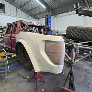

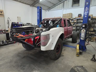

looks like you might need them, but god I hate the TT style bedsides.... LOL
Yeah the front fenders run raingutter grill but same style. It looks 11% better with front matching.
