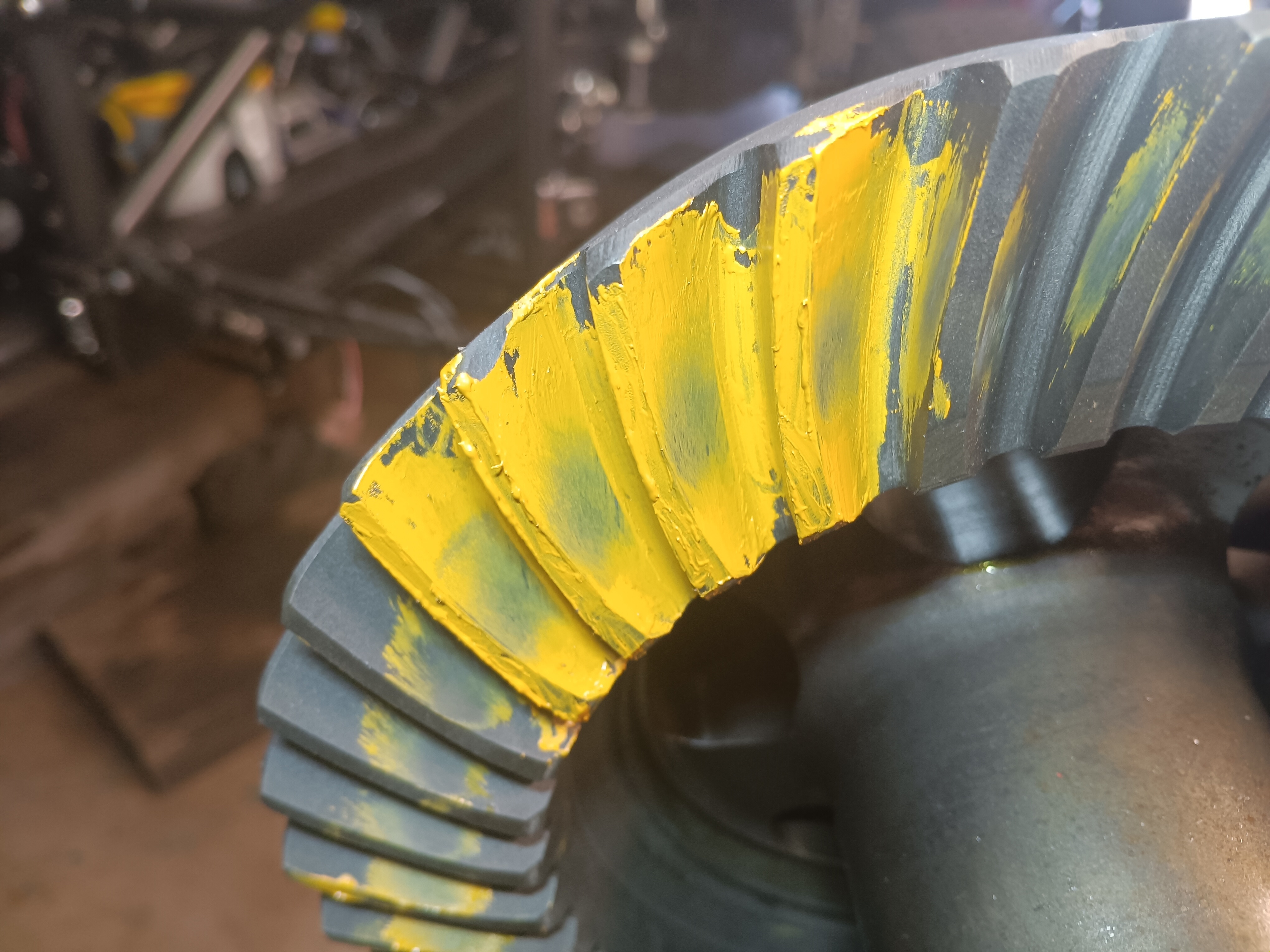

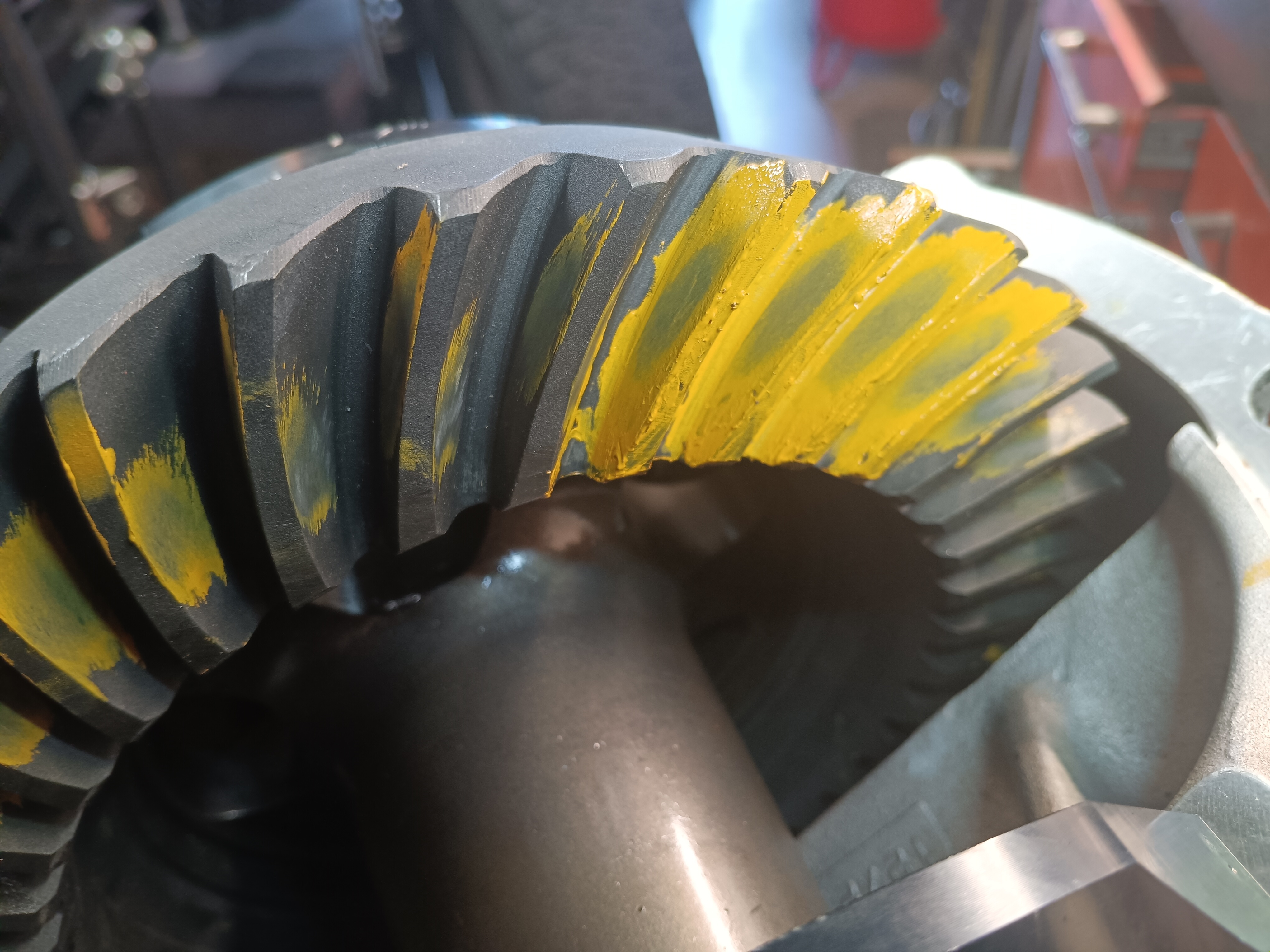

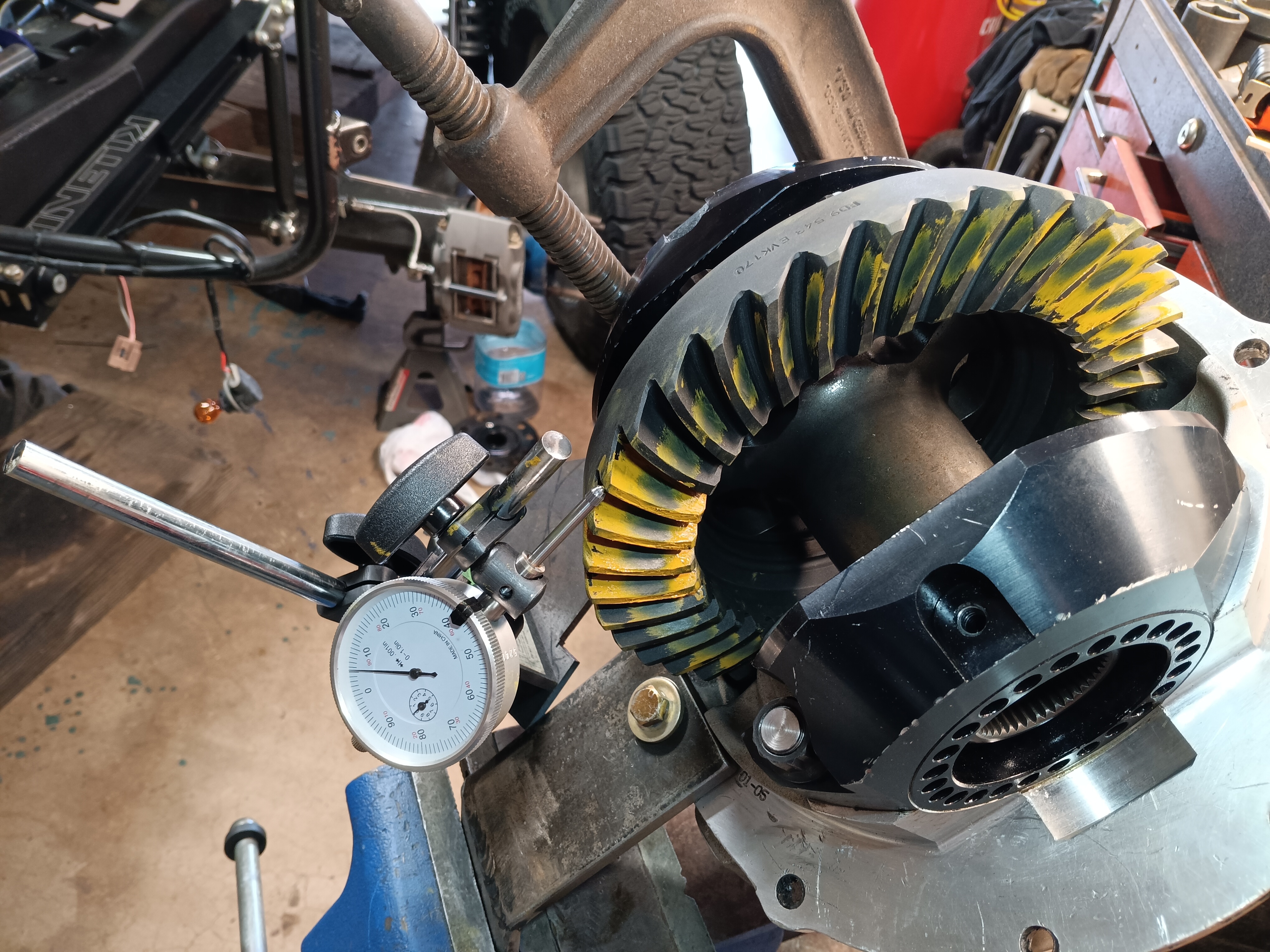

Pattern looks greatwell, finally got gears done. I think it looks OK? I guess the right person to ask is @Raceranger97 ... as he used to gears I think!!
Had to make my own custom adjustable pinion sleeve... got it set to right about 10in/lbs... which is a alledgedly a little high for used bearings, but good enough. Backlash seemed spot on for tight side at .006. It was between .0055 and .0065 depending on measurement location.
This was pattern I got. I basically used old pinion shim pack depth and pinion gear marking, and did the math for the new pinion gear marking for depth. Shim pack math was within .001 of old set up.
even if he said that sucks, it's already installed!!! Gear oil is trickling in it as I type.
