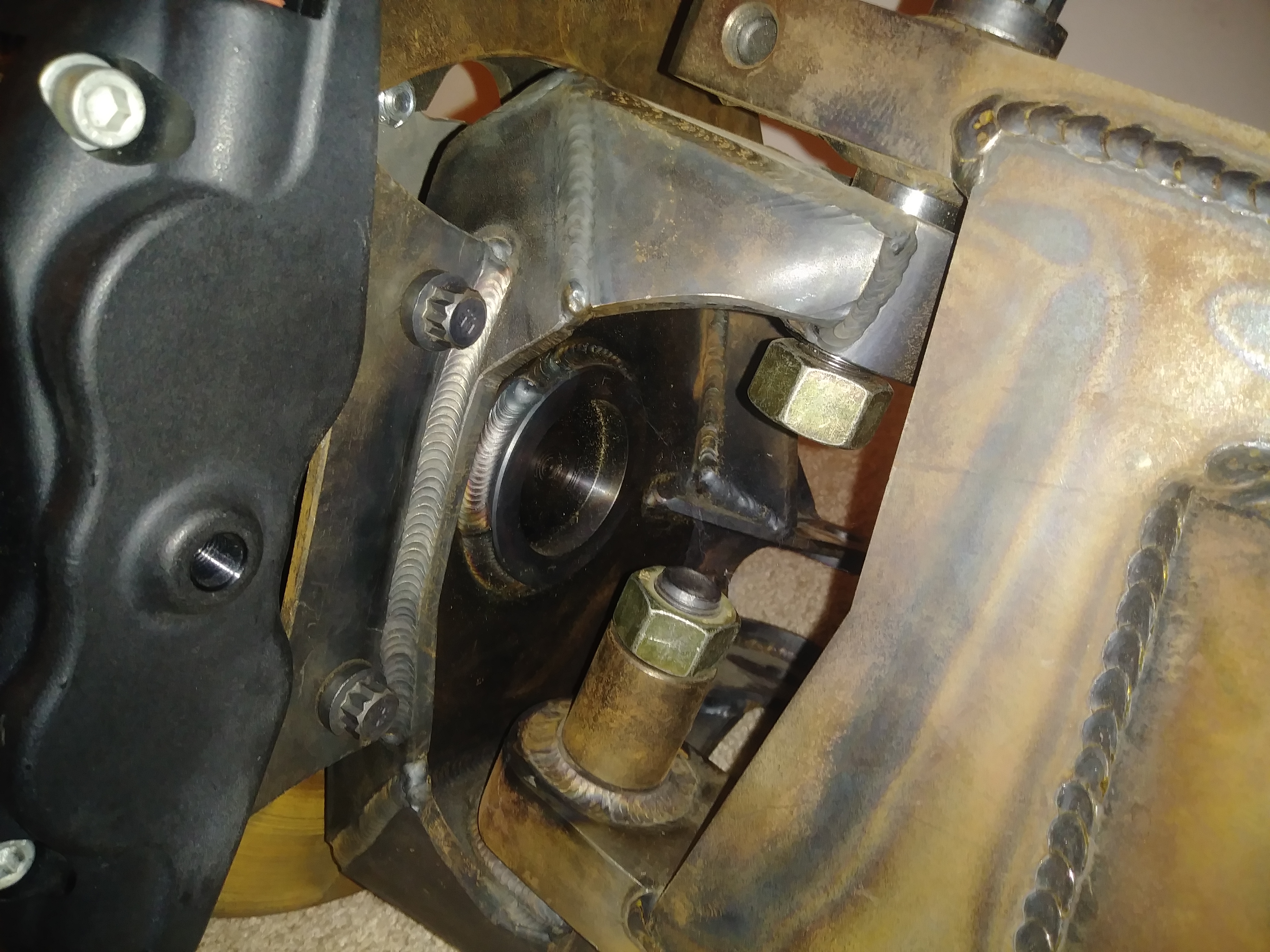

Had to snap pics before I left. Spindles seem nice.
I was told the custom spindles were done by ES mostorports. Being fixed with no adjustment...Hopefully that camber is set right for the ride height I want. Otherwise I'm gonna have some fun trying to redo camber!!
Billet ends and that unique 3x bend/clamshell design that I loved of Threats. (don't see them done this way anymore... stoked on um aesthetically)
Darlington Bolts, BRO! Only lowers seem to be shanked... with some extra spacers for fun instead of cutting bolt down?

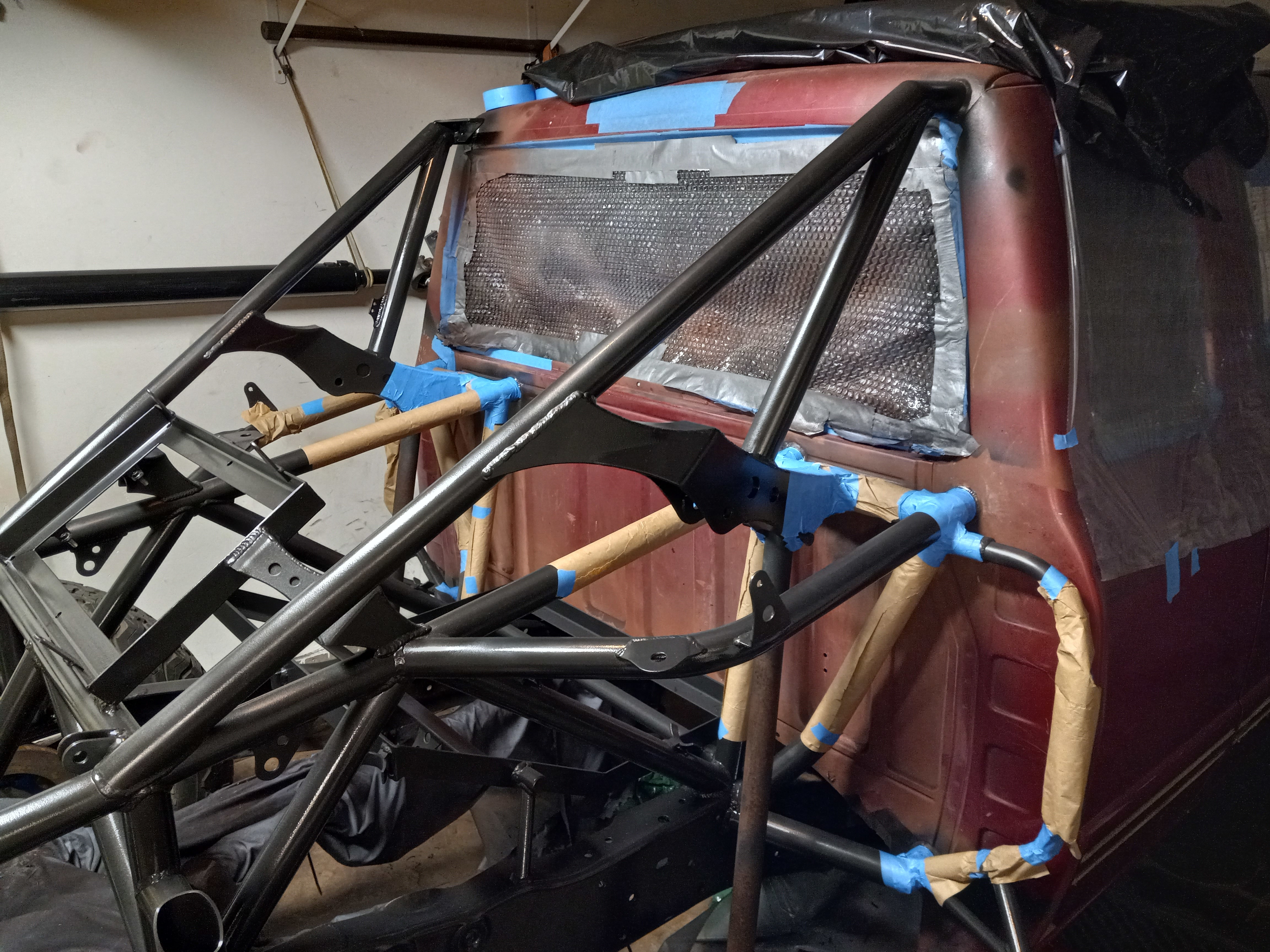

Did I ever tell you how much I HATE this part. masking sucks...
end result is nice though.

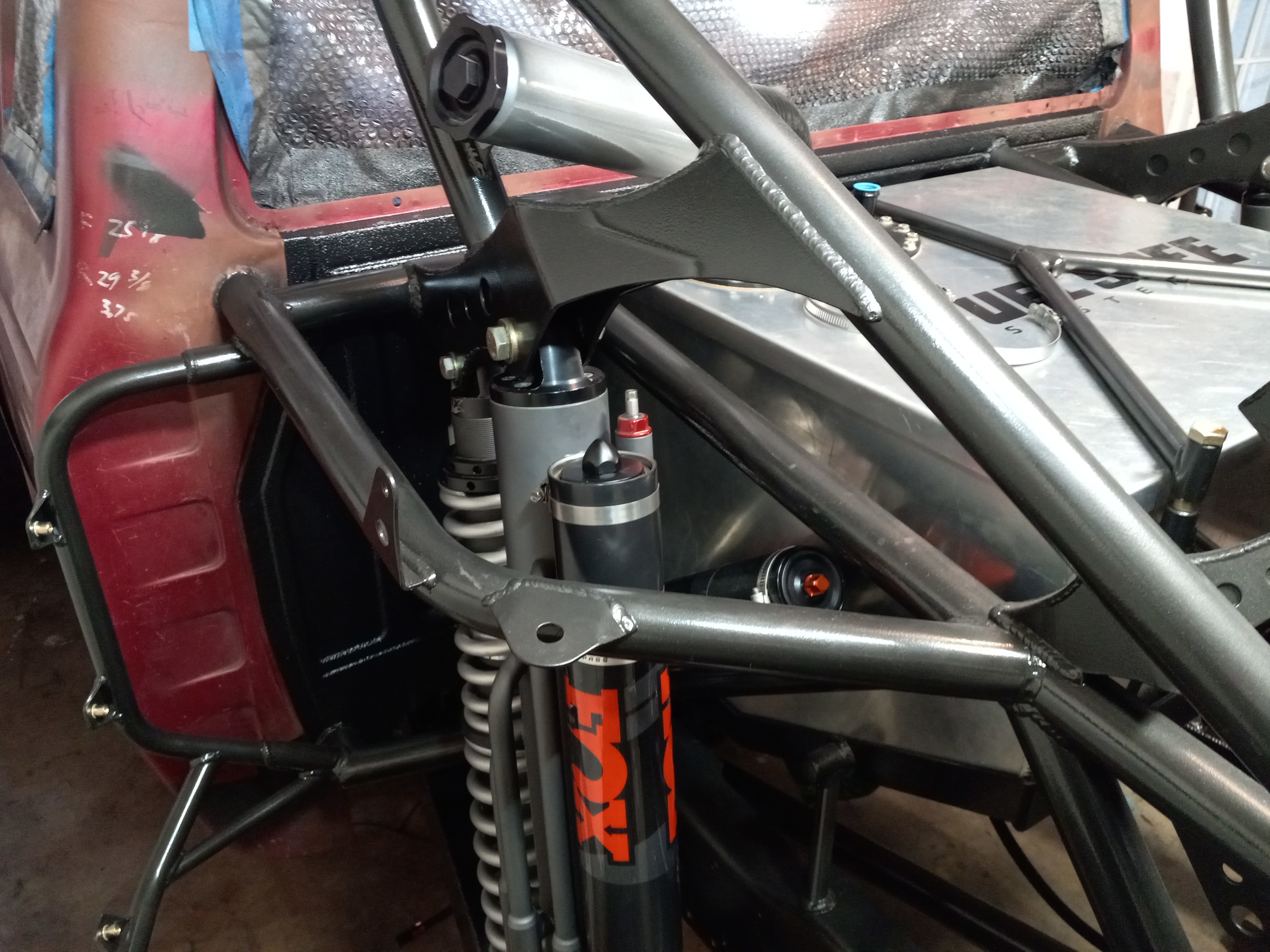

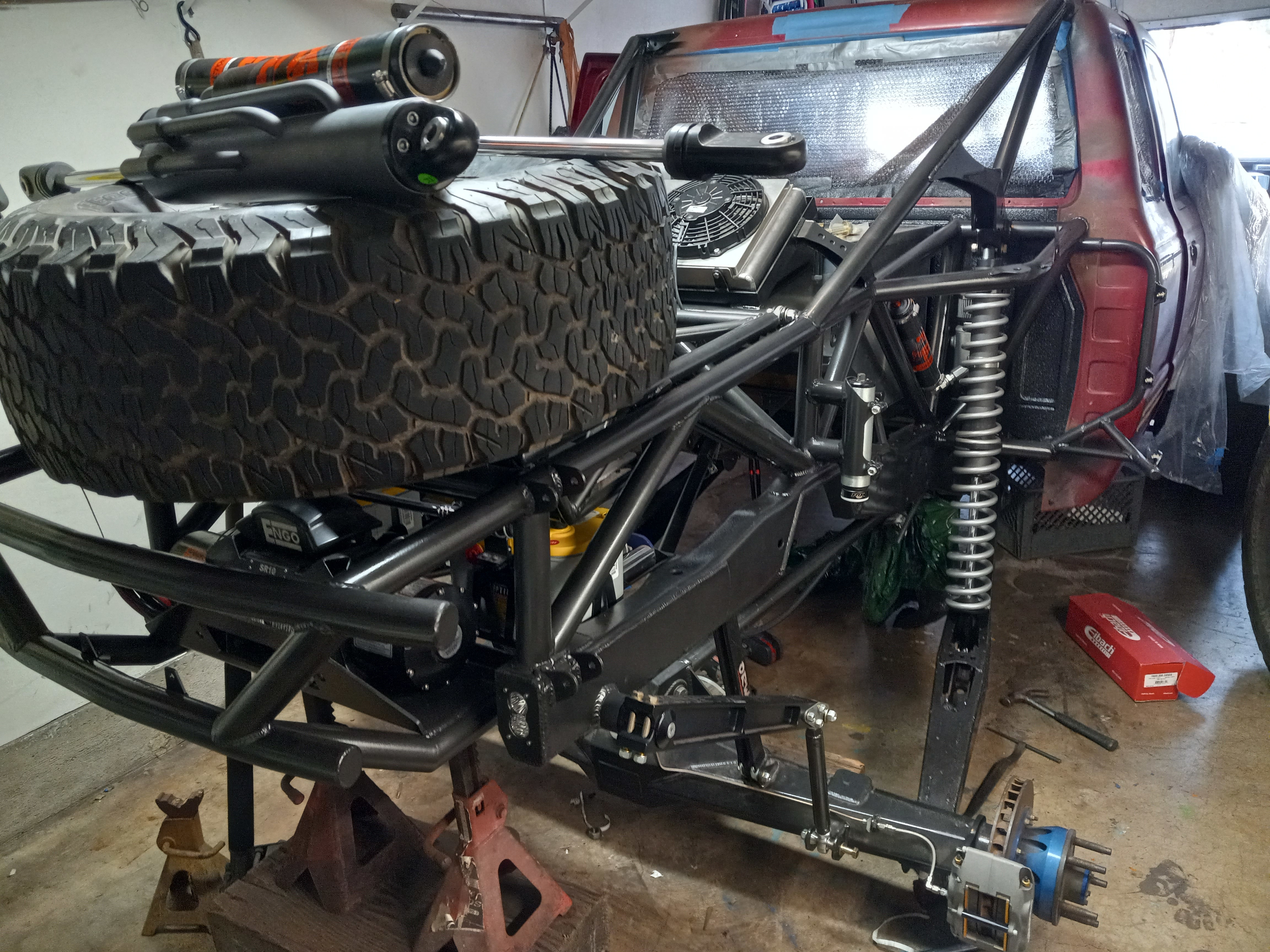

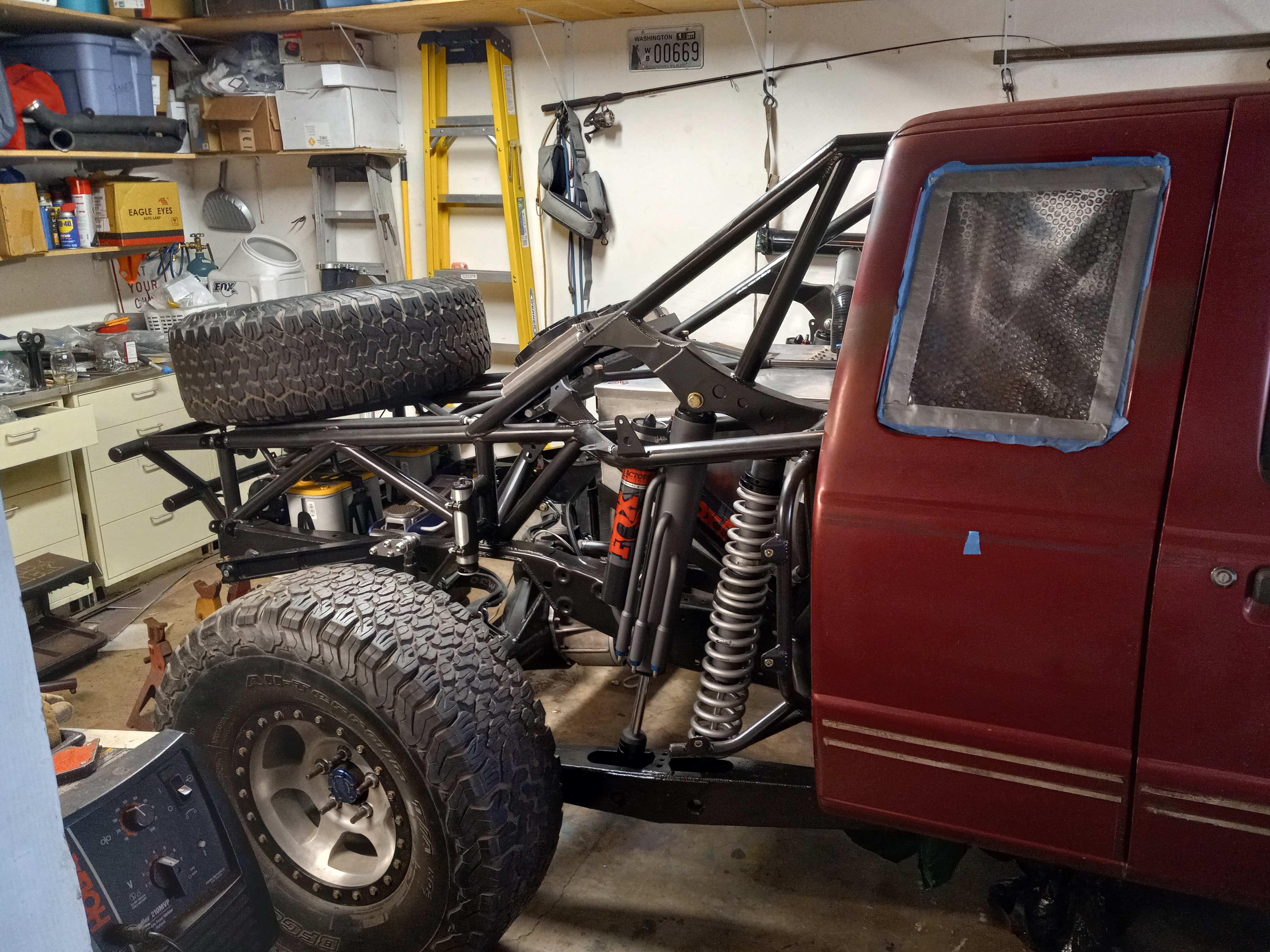

Day 2. Set up the rear axle location for good and more assembly...

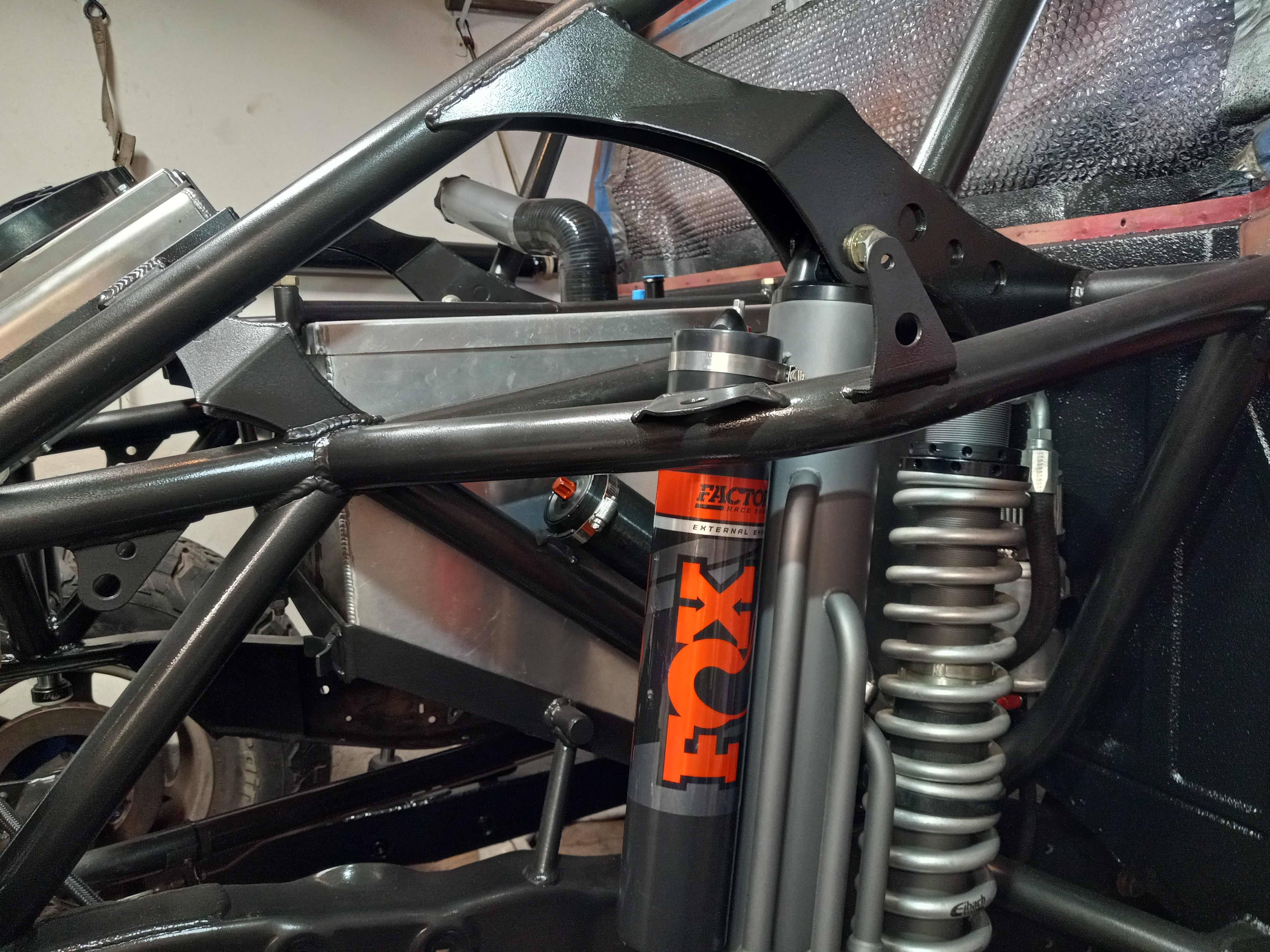

Rate that shock set up...

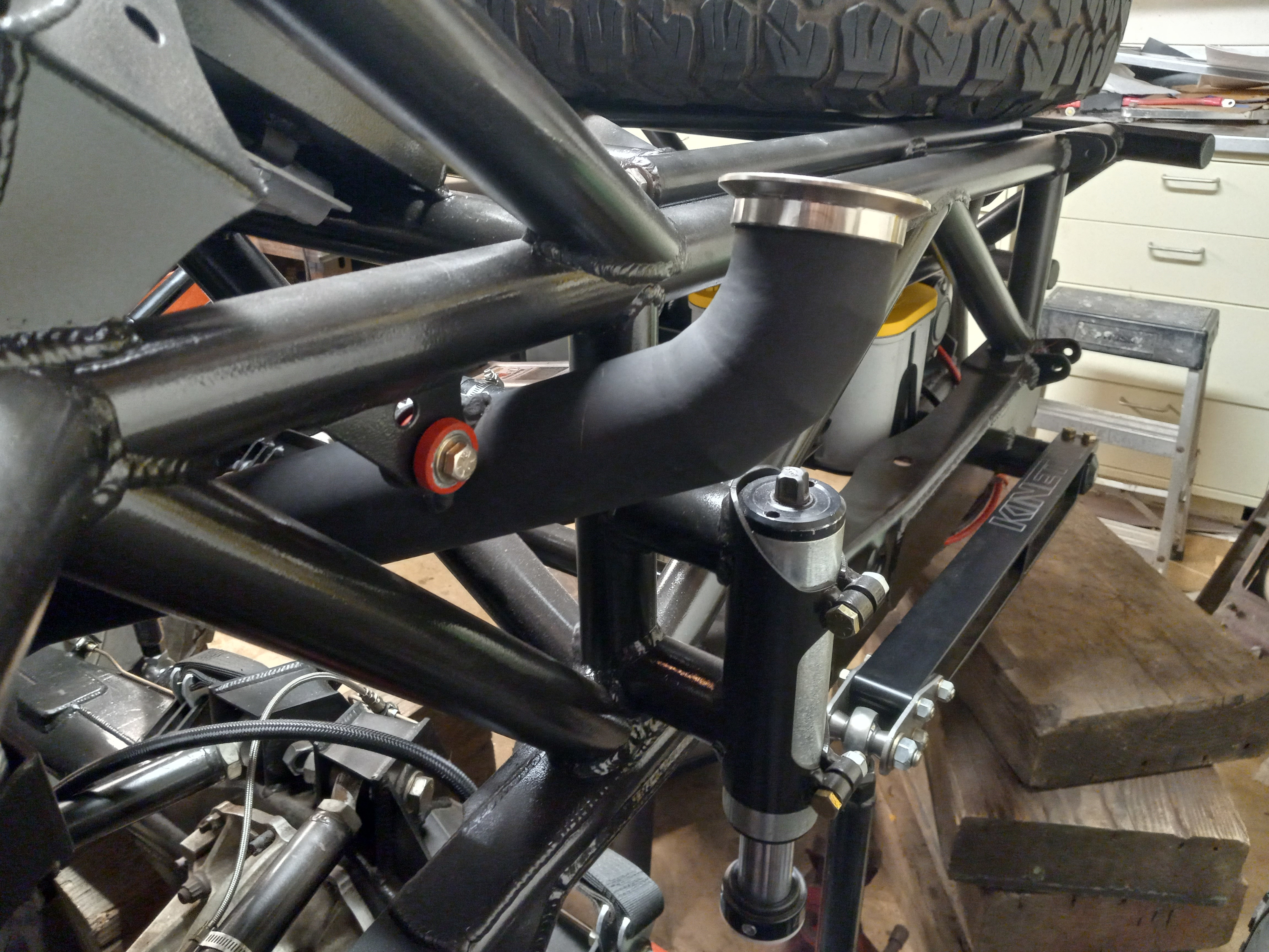

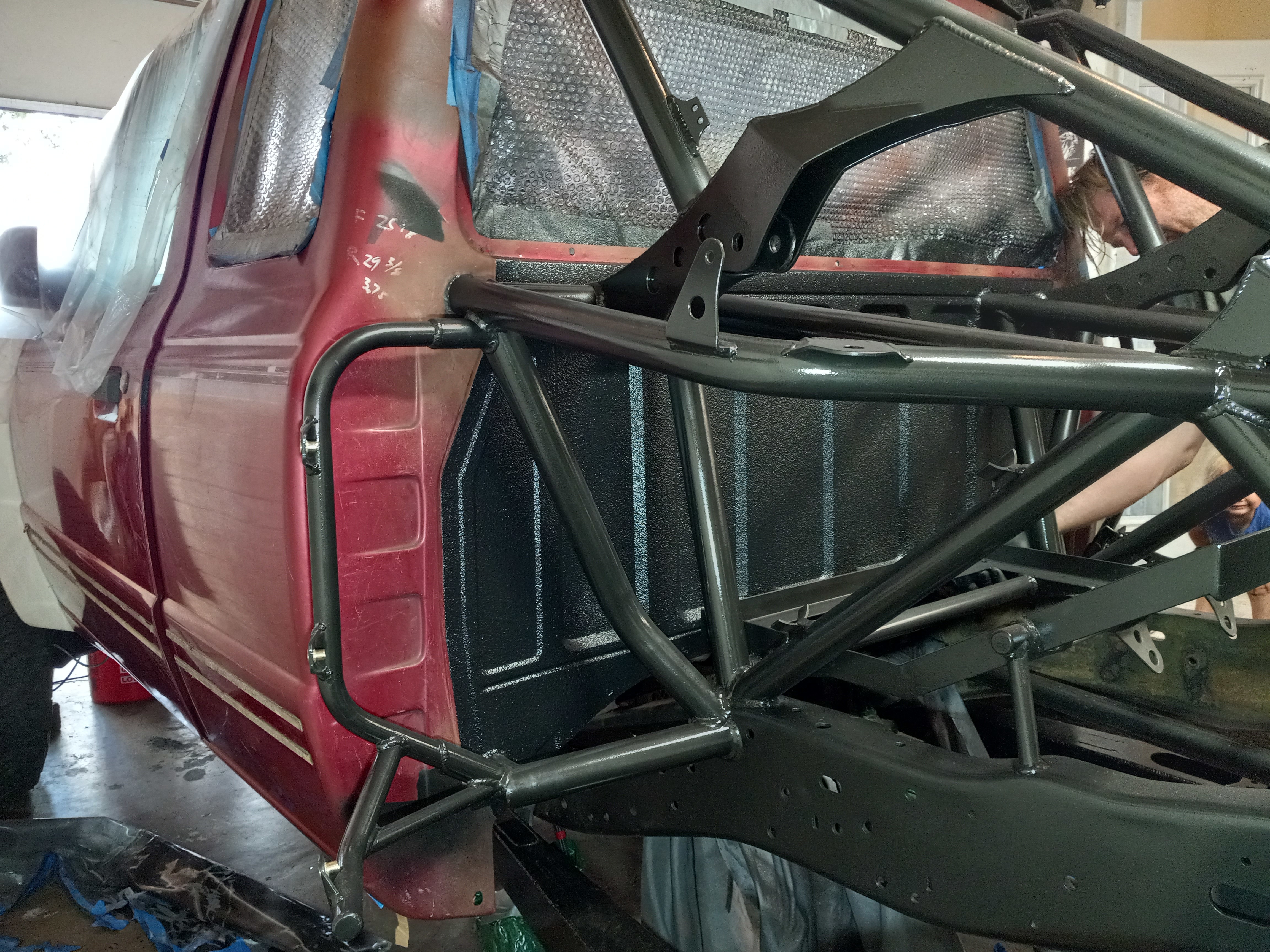

been slowly adding all the parts on the back. Trying to get brakes bled too... so it will be easier to move around. Will have to pull the brake lines in cab for handbrake when I eventually have to craptor line the floor though.

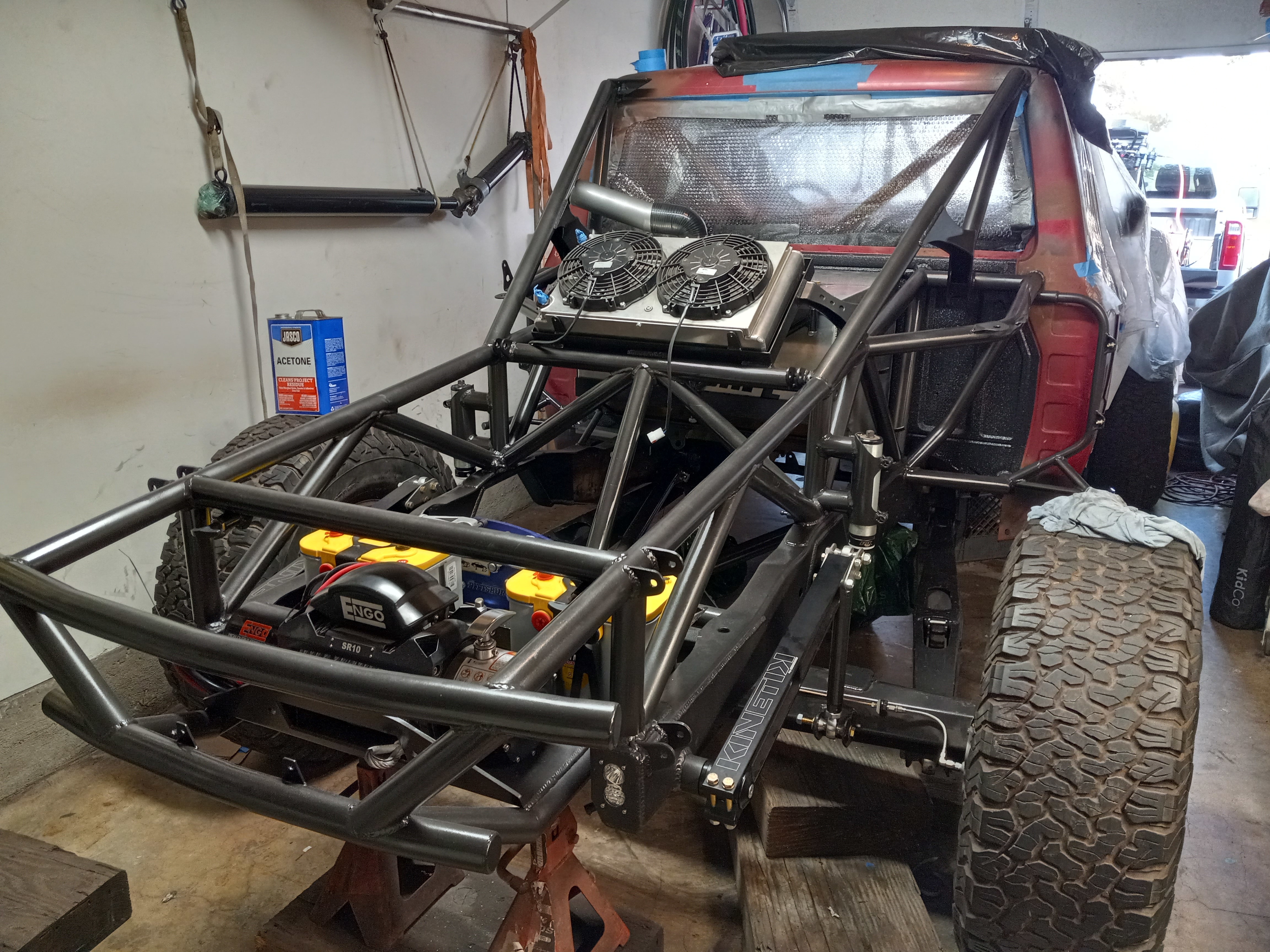

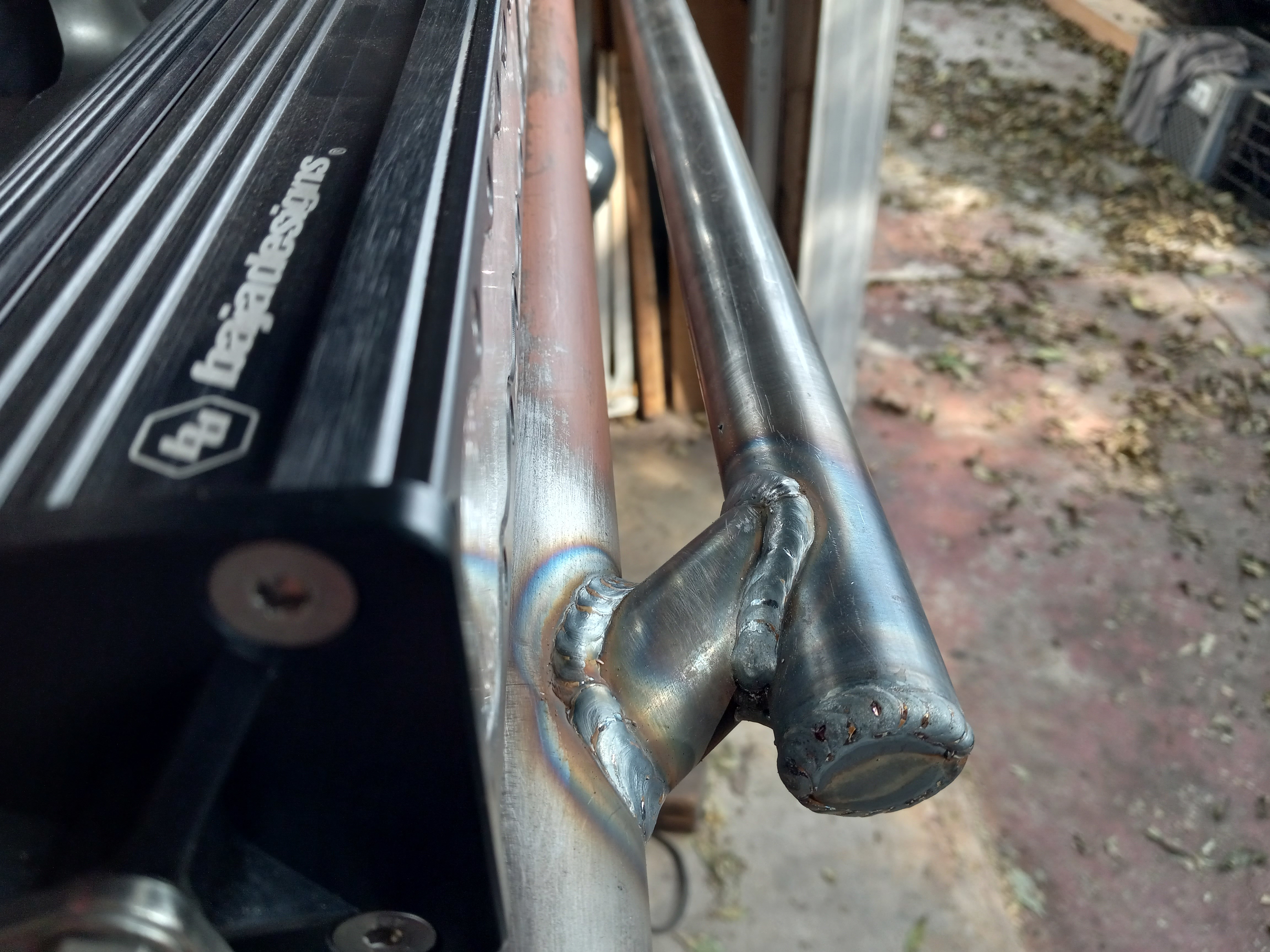

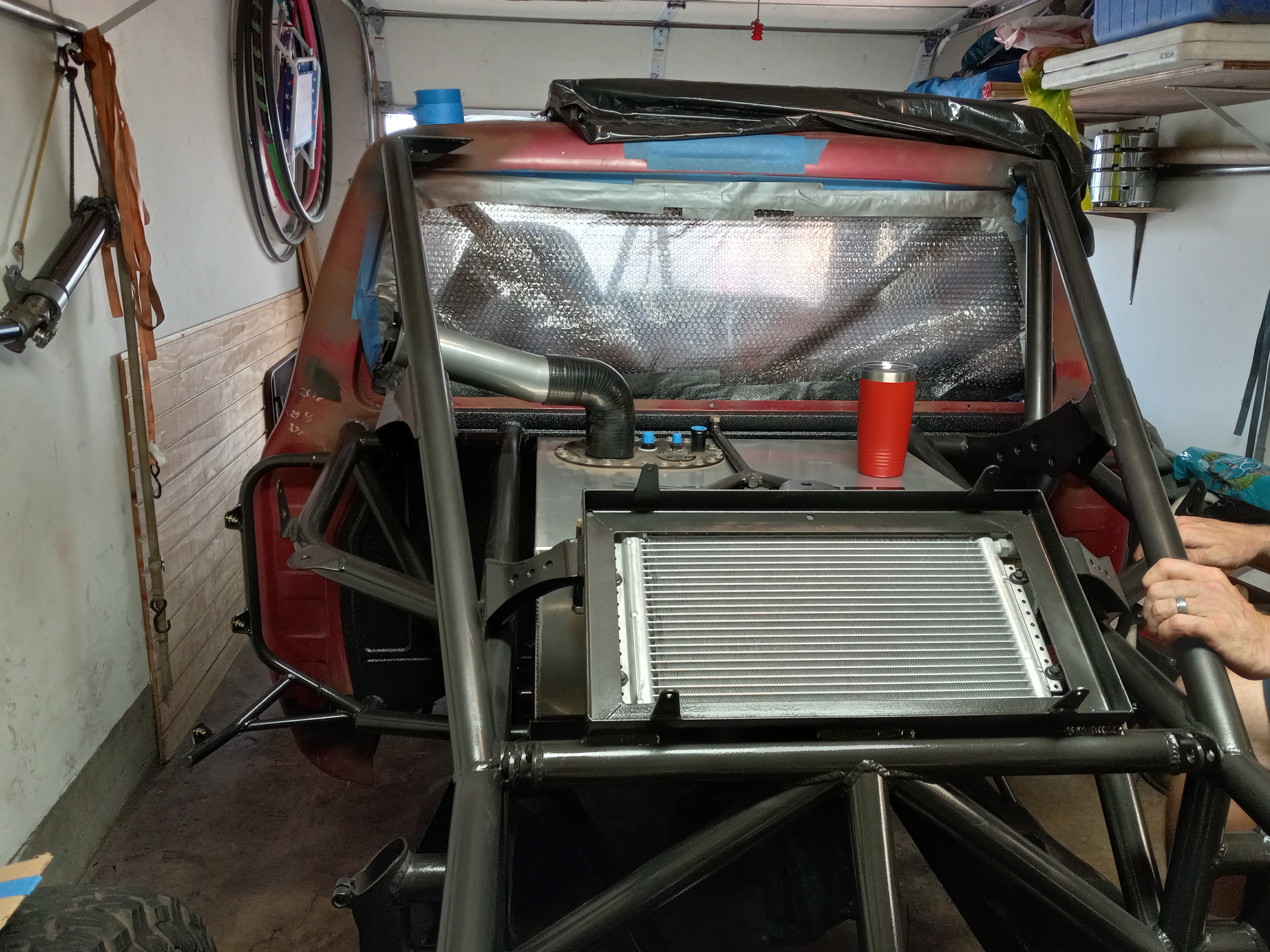

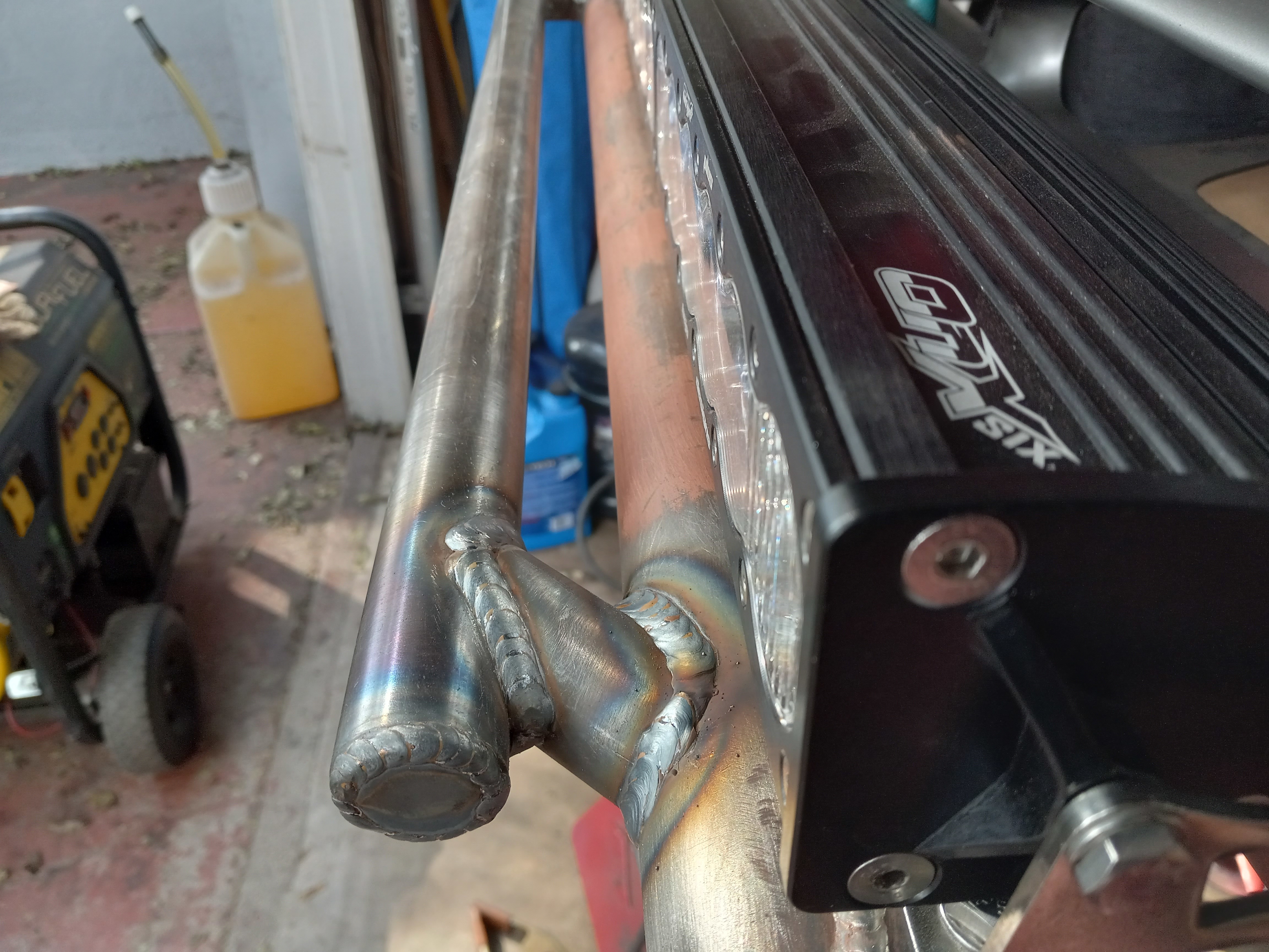

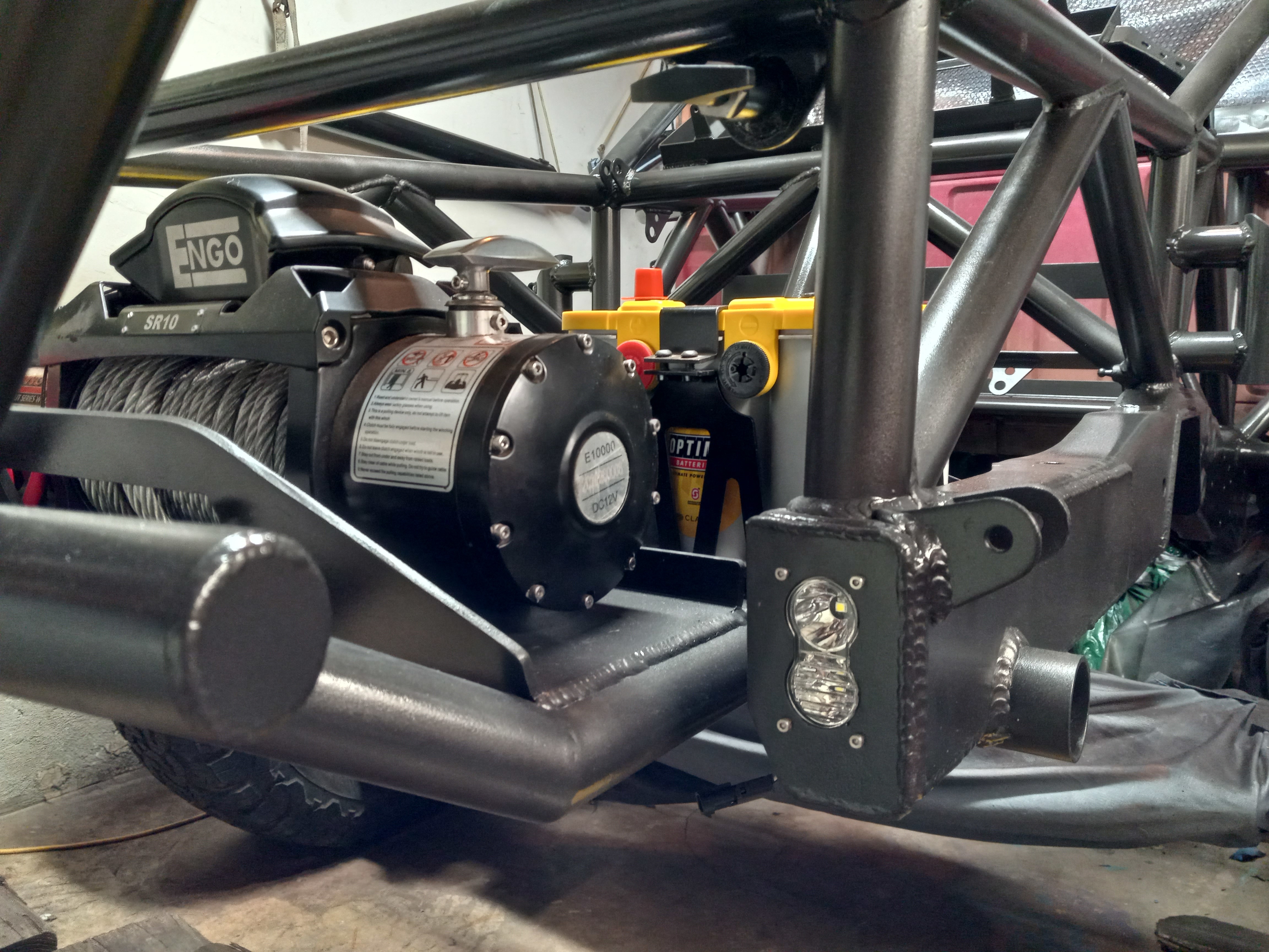

I keep saying almost done with fab... but had to build the bumper extender. This really helps as a high lift jacking point to get truck on the jack stands quick.
Also protects the high dollar light too!

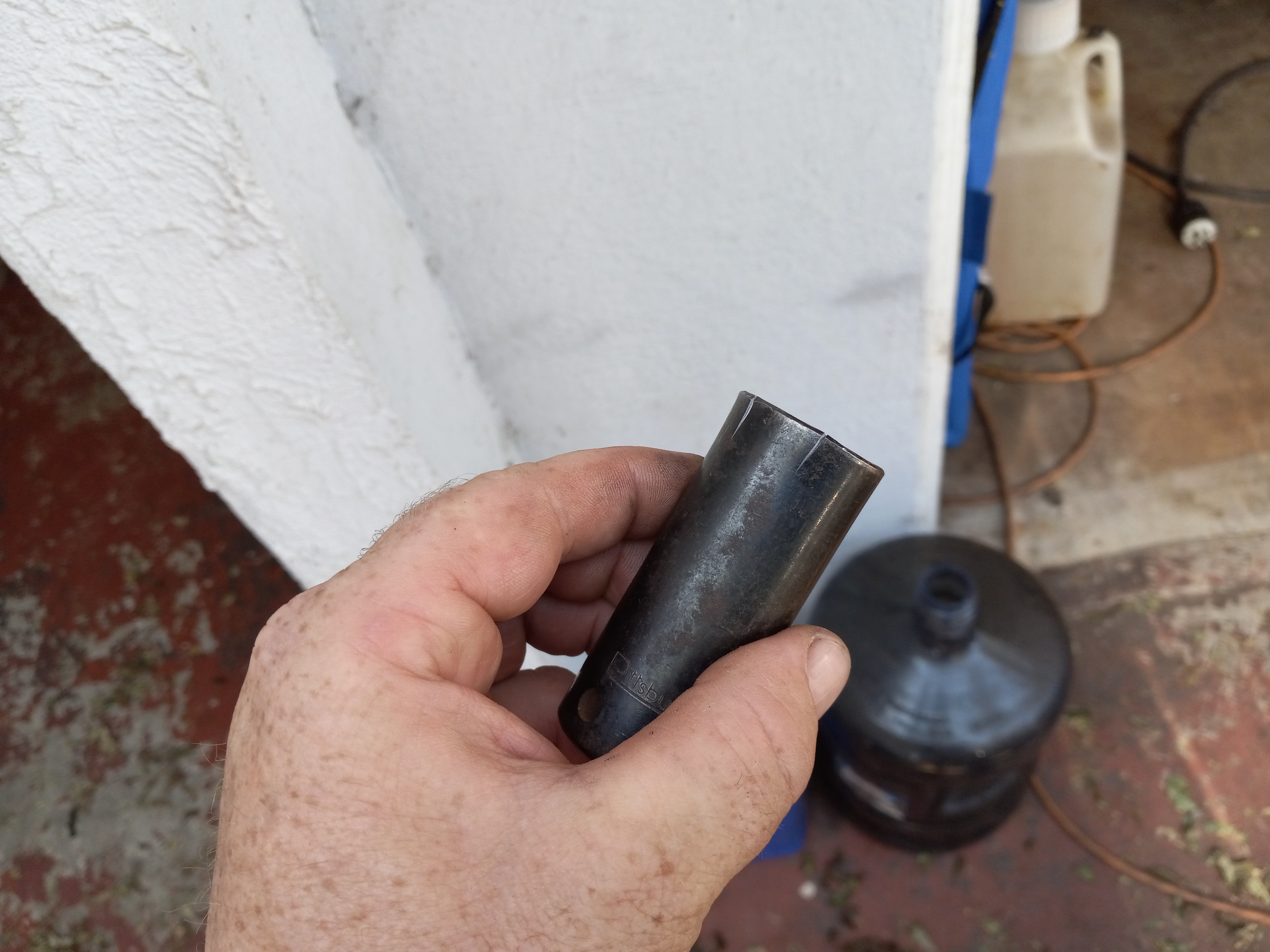

So, tried to torque the balancer/crank pulley on. I read it was 37lb ft... then get it to go 140* further of bolt rotation. Well, I got it to like 100*.... and then my tool broke. Gonna have to assume it is tight enough. Had a huge cheater and swear shit was bout to blow up.... then I heard the cracking sound. lol

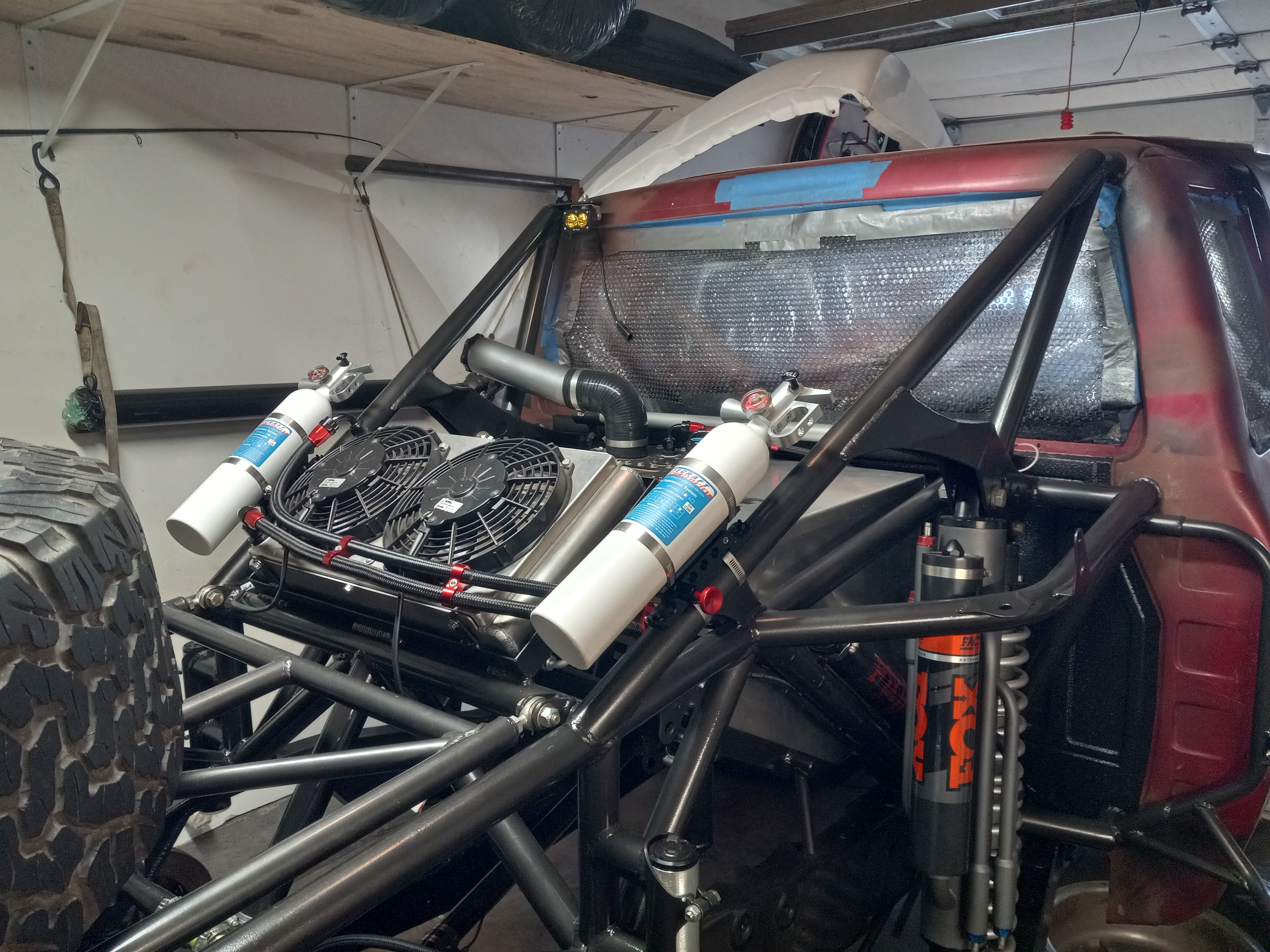

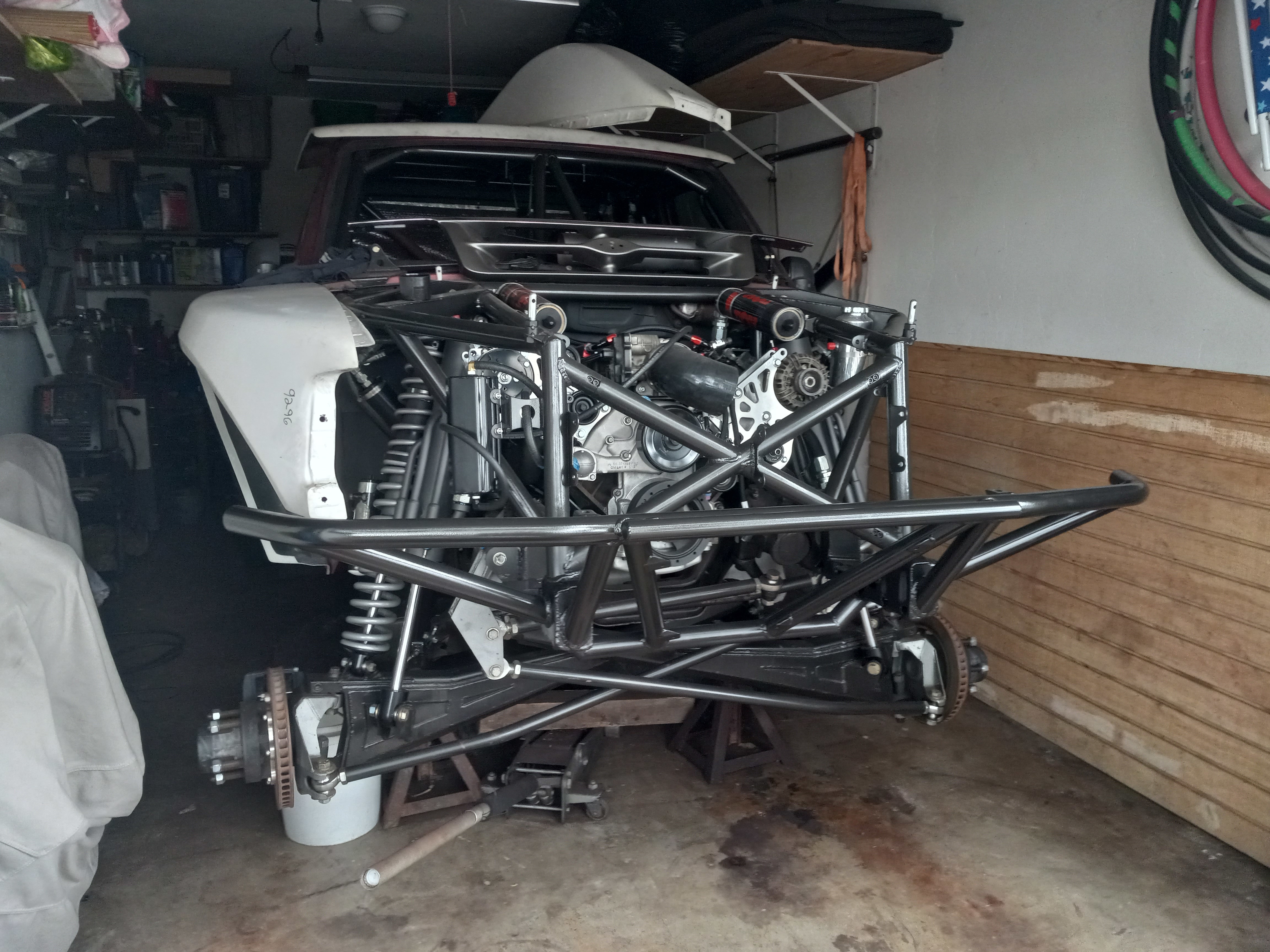

Got the rock screen installed.

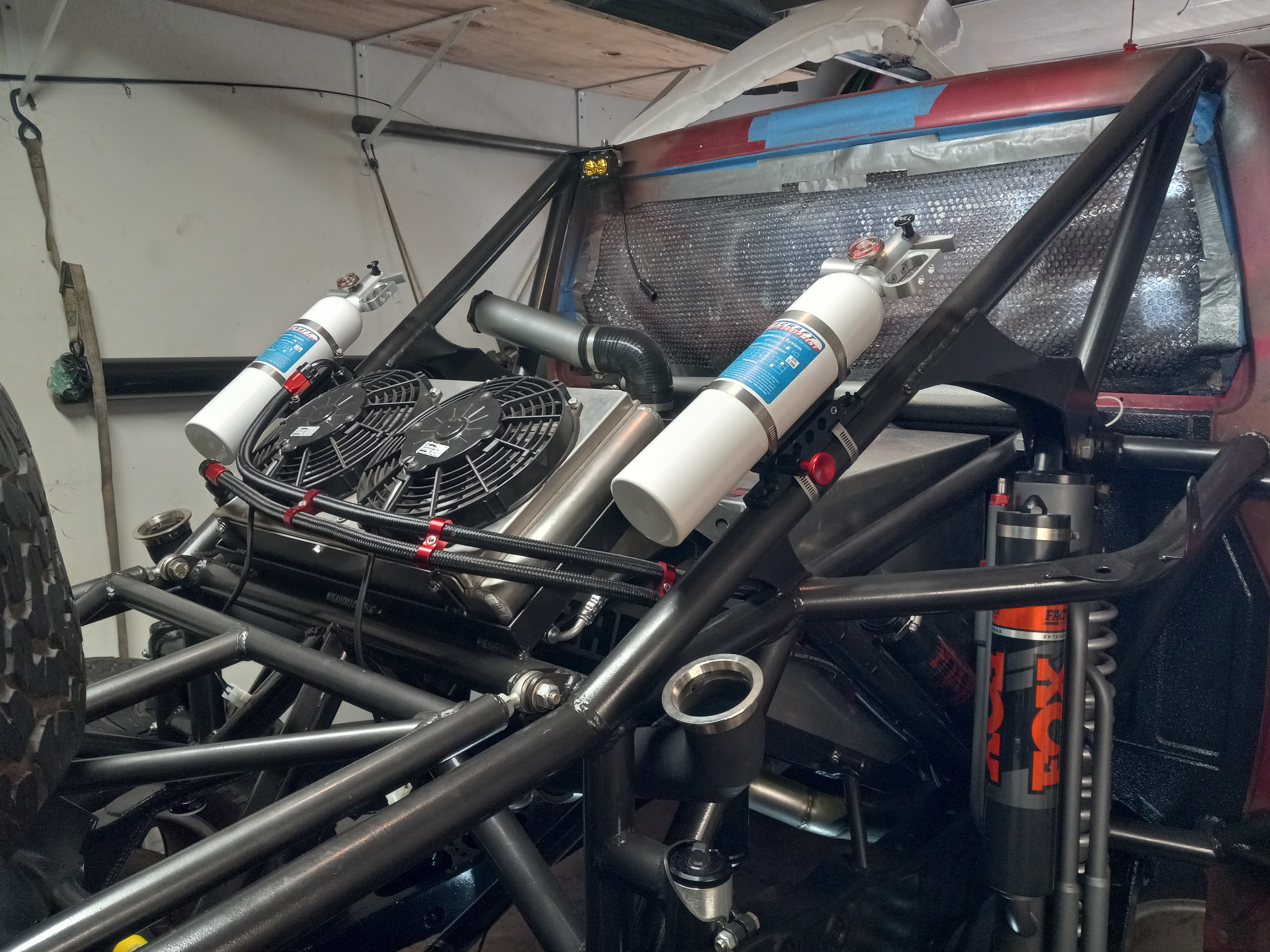

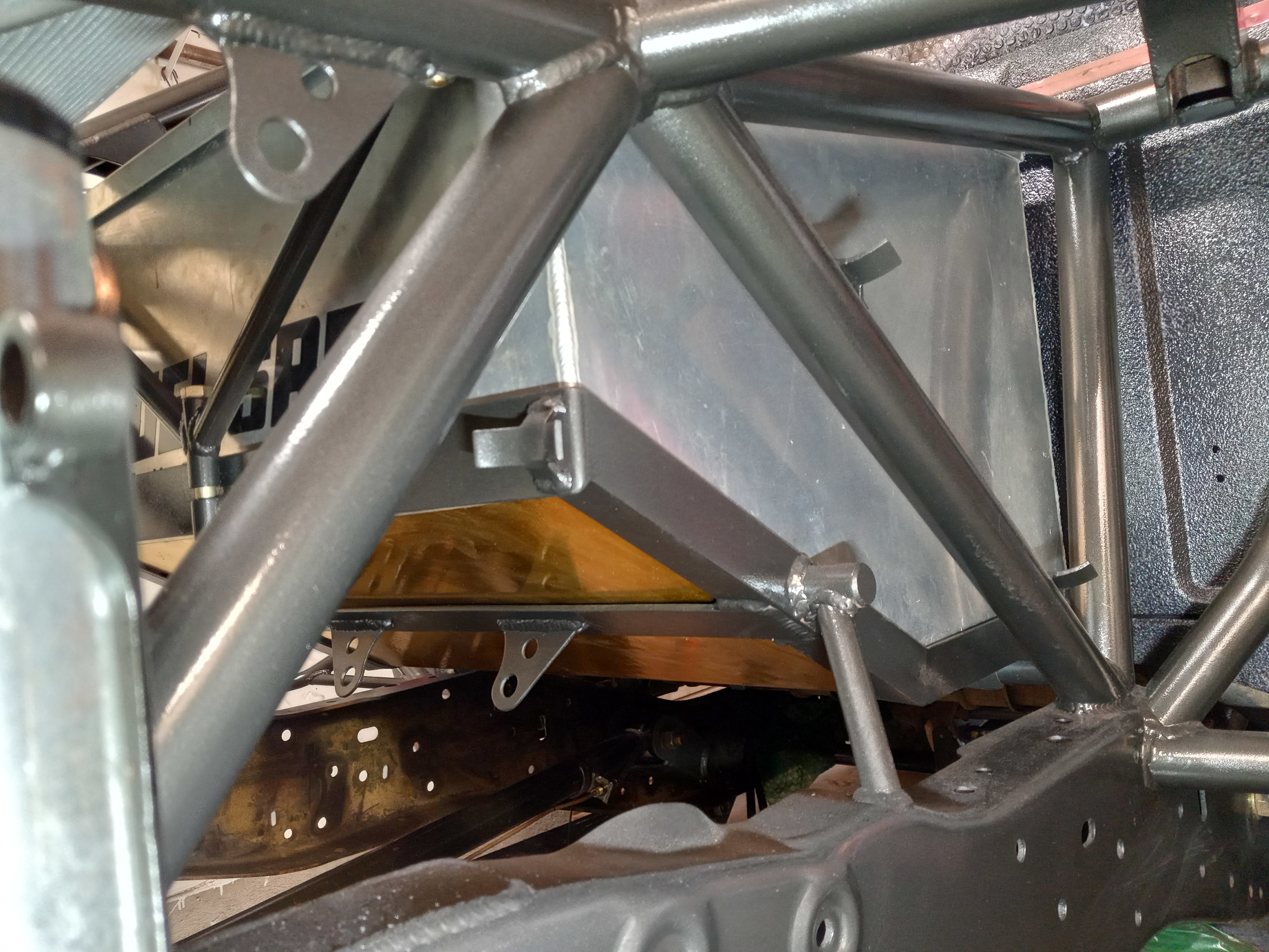

And did lots of mechanic work you don't see... got all the fuel fittings tightened up, and intake mounted, and injectors plugged in. Then I could throw on the exhaust. Which made me realize... shit, have to move the fire extinguishers up! They would have been getting blasted a little by exhaust... and dont want to be reaching around hot exhaust too. So, those got moved up some.

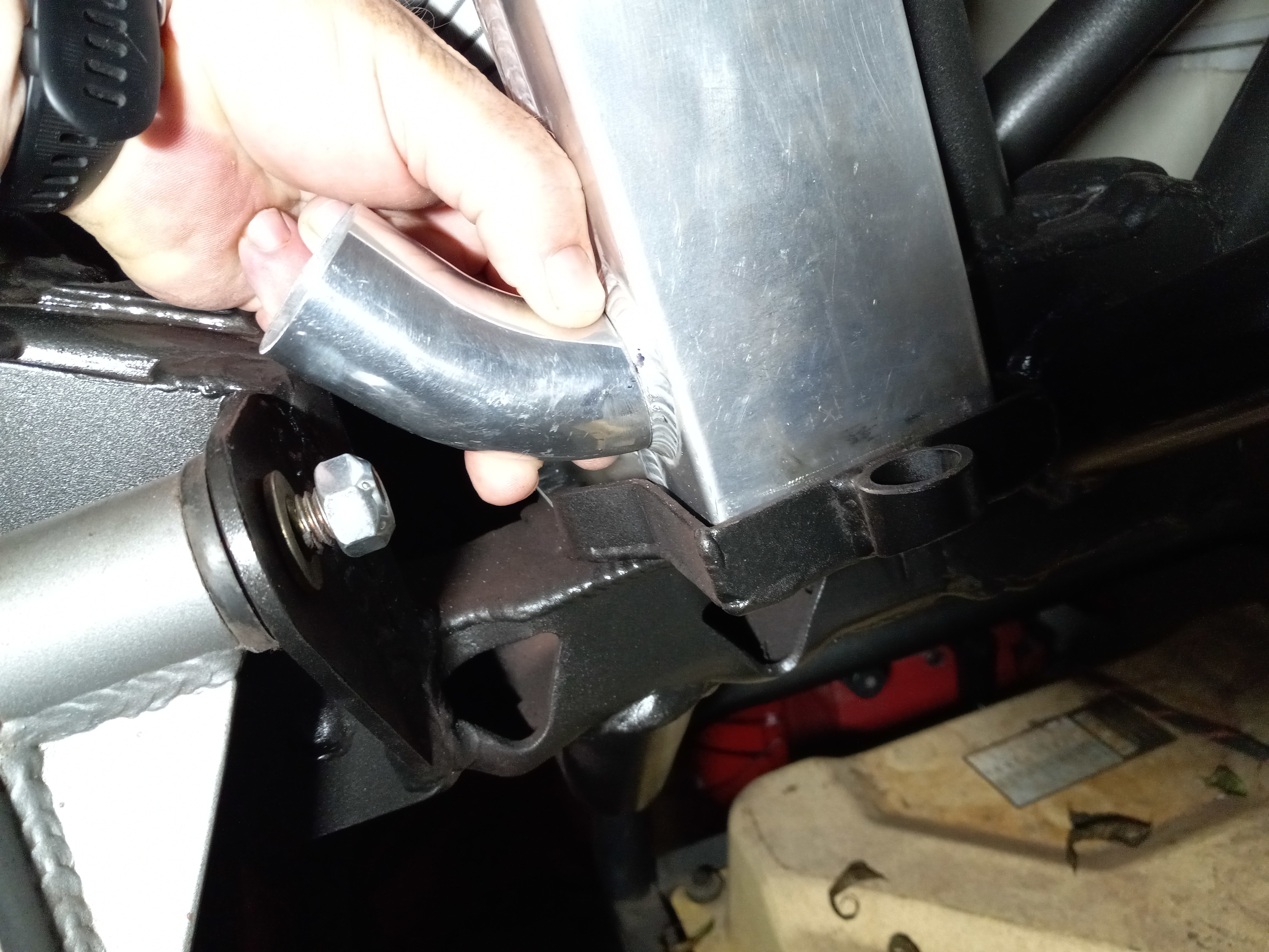

Need to get the vent line figured out on cell and it will be ready to be fueled.

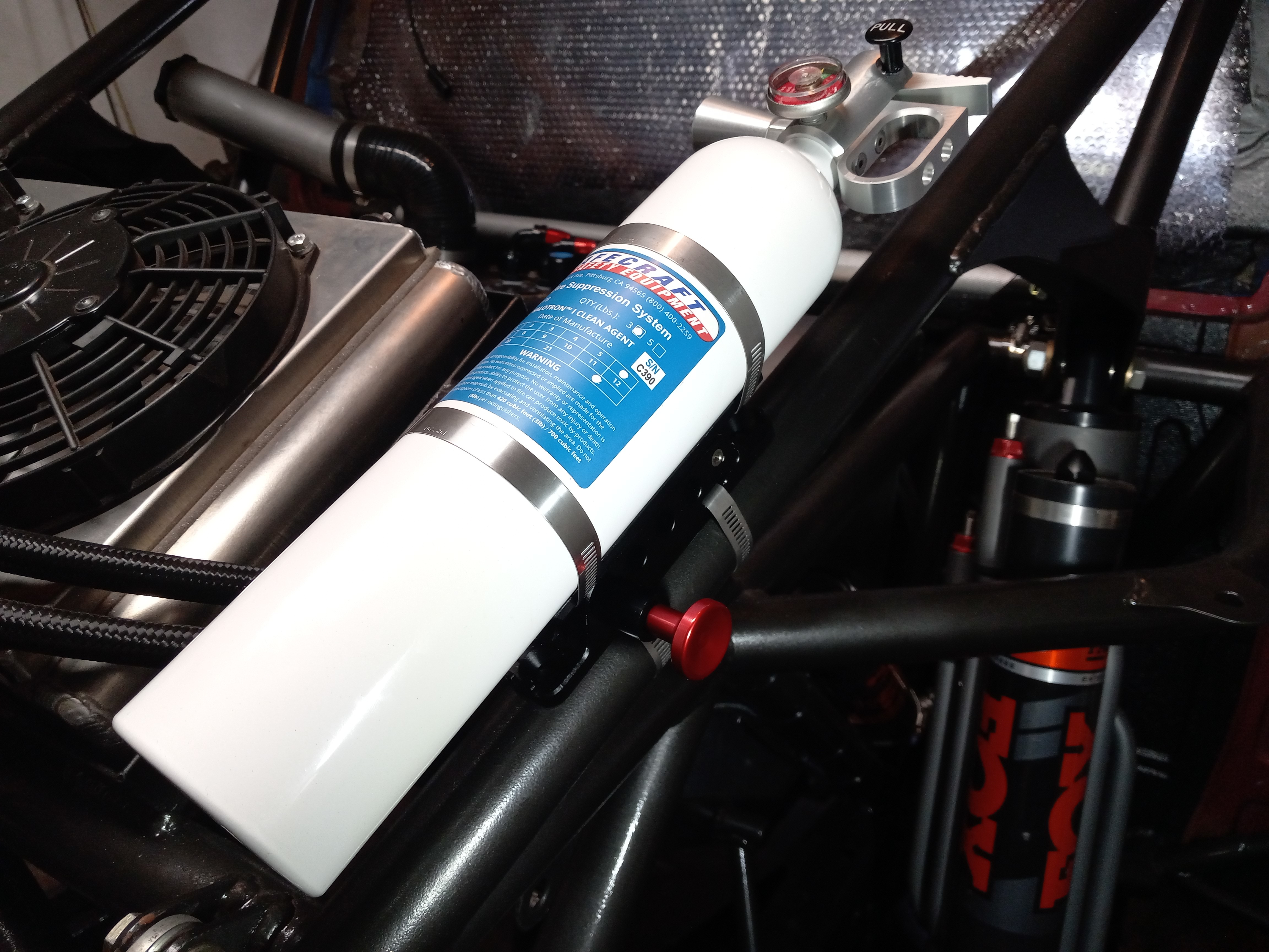

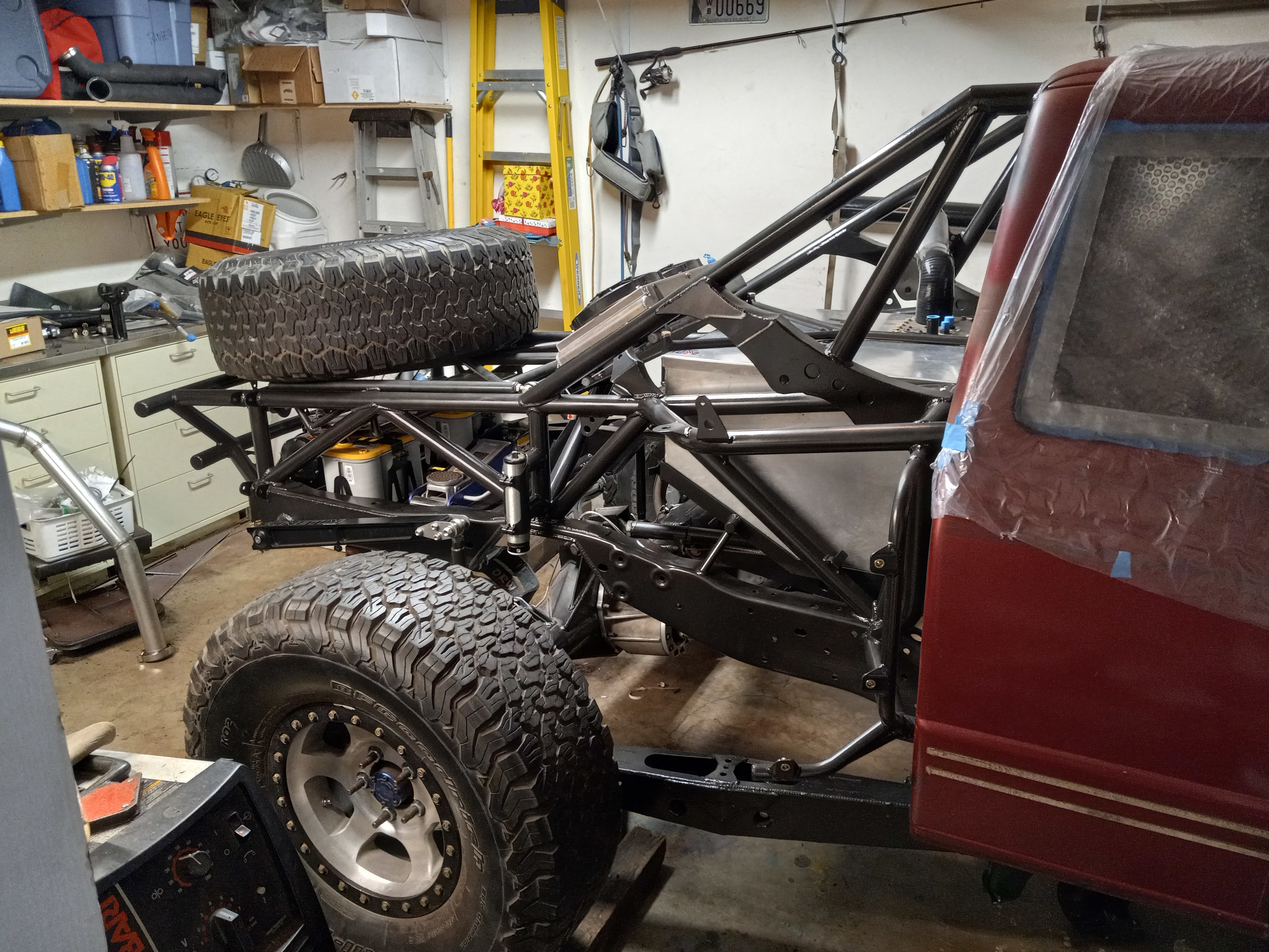

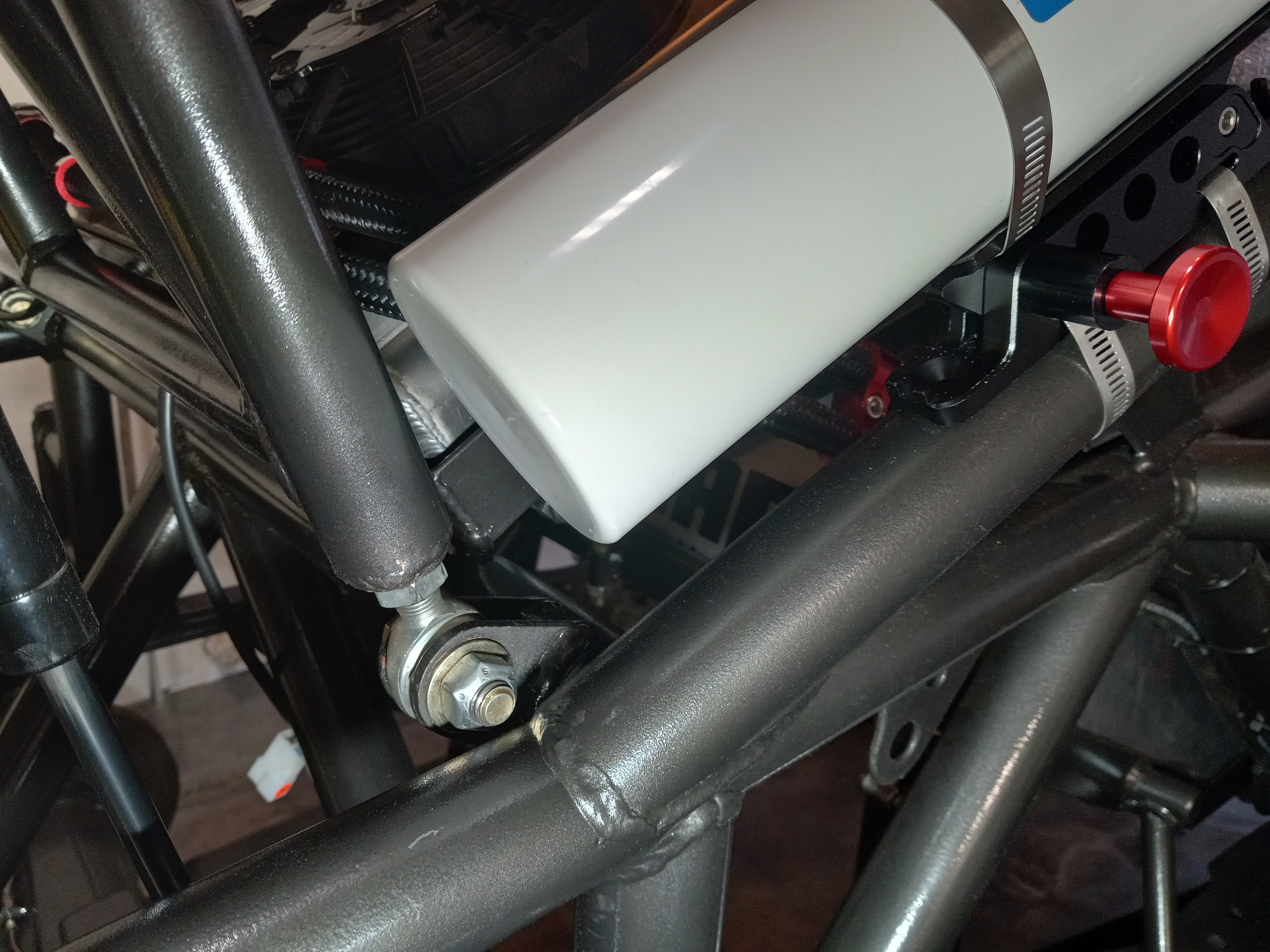

What's everyone's thoughts on the fire extinguisher mounted like this... I was always concerned that if I had rolled the truck the FE might get damaged or not able to be take off or something.
Truck looks nice man. Getting close
There should always be extinguishers inside the truck as well.
Also not a fan of mounting them where they will be destroyed in a roll.
should be pretty safe there actually... if you draw a line from roof to top of tire, I think they should be ok? Plus, i think I saw them there on someone elses truck.. so that's proof they will be fine! AHAHHA
Would have been safer lower... and perhaps off side/ tube that goes to shock support. But, I hated them there. Form over function bro-chacho!

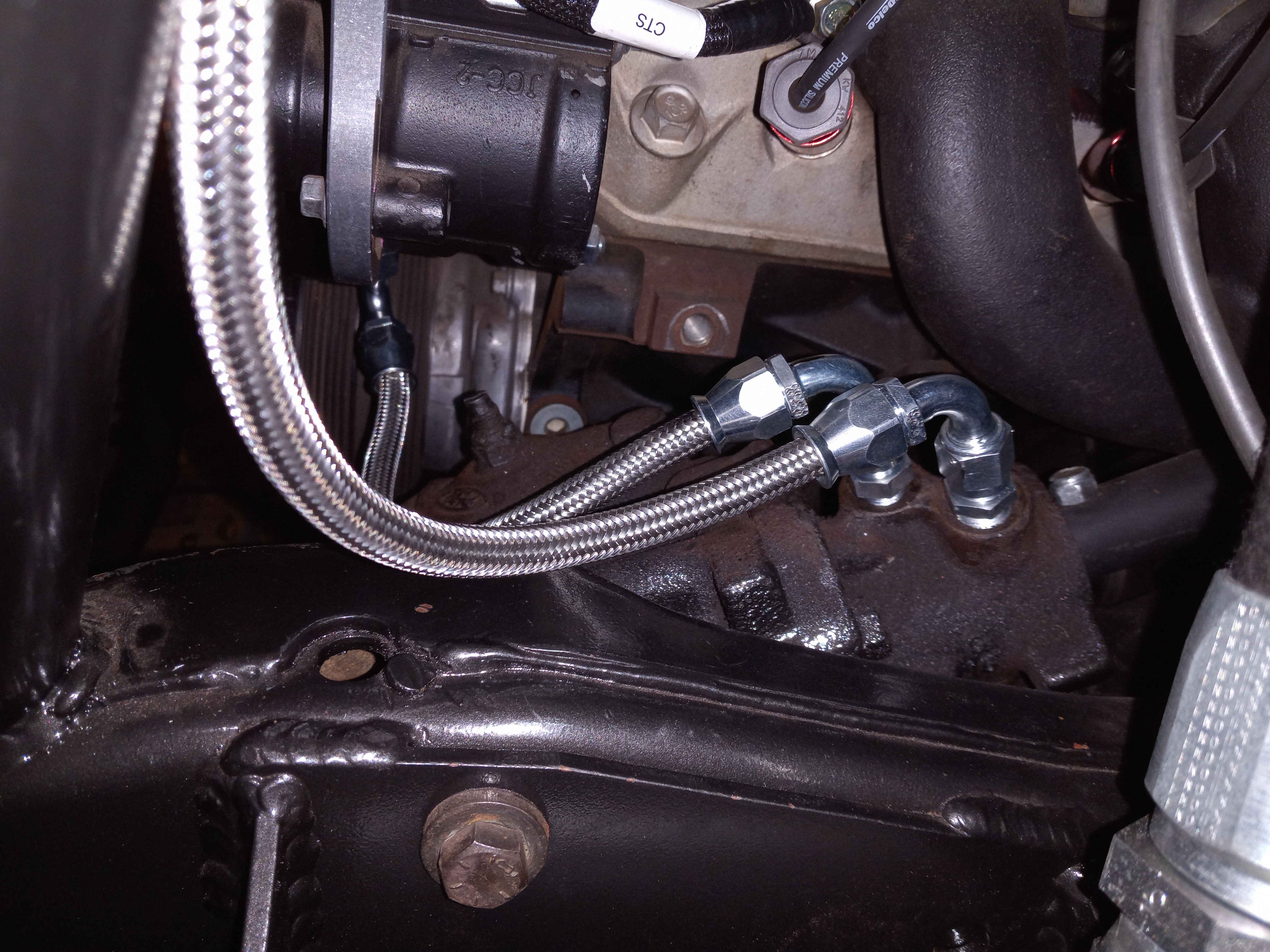

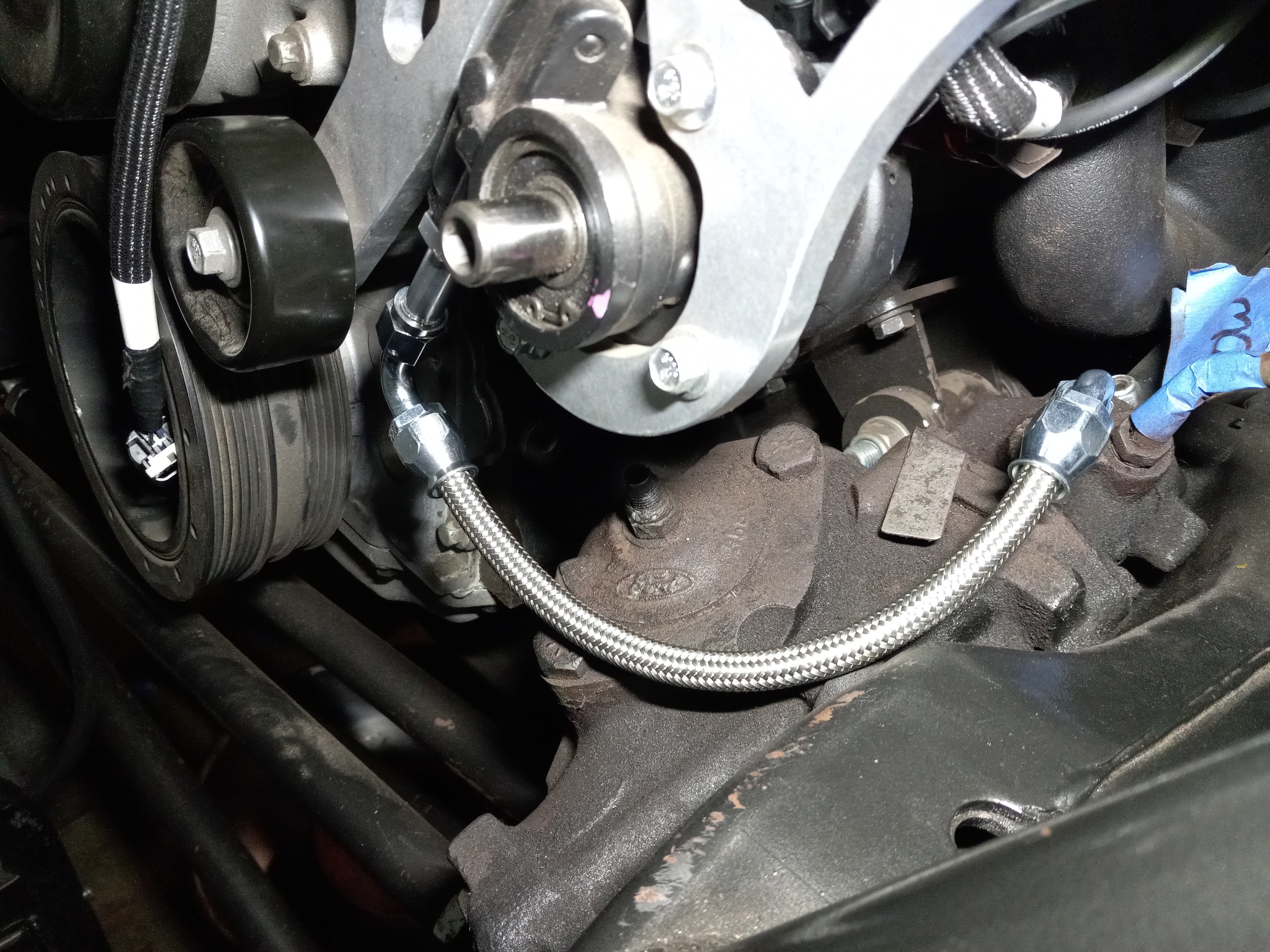

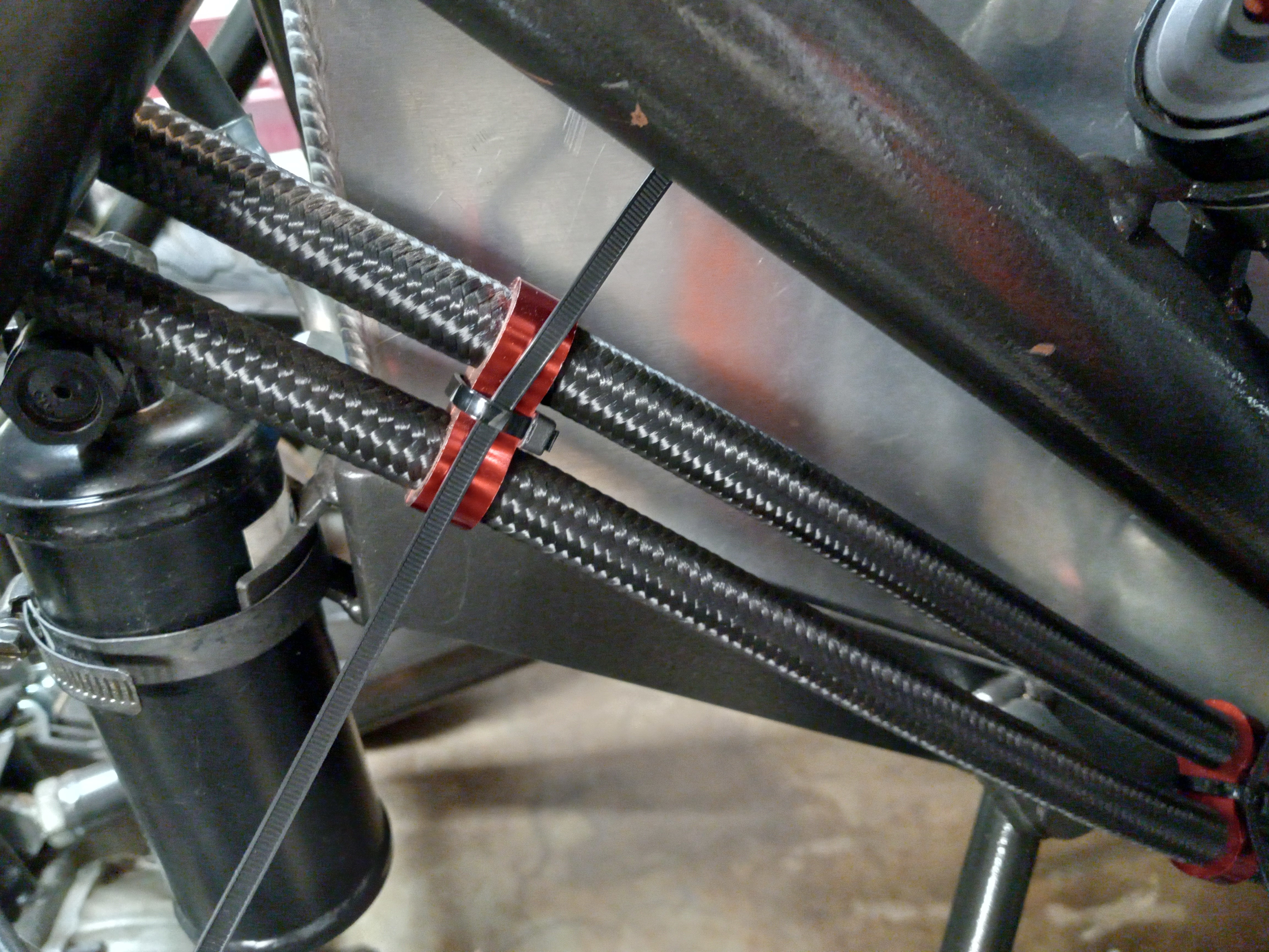

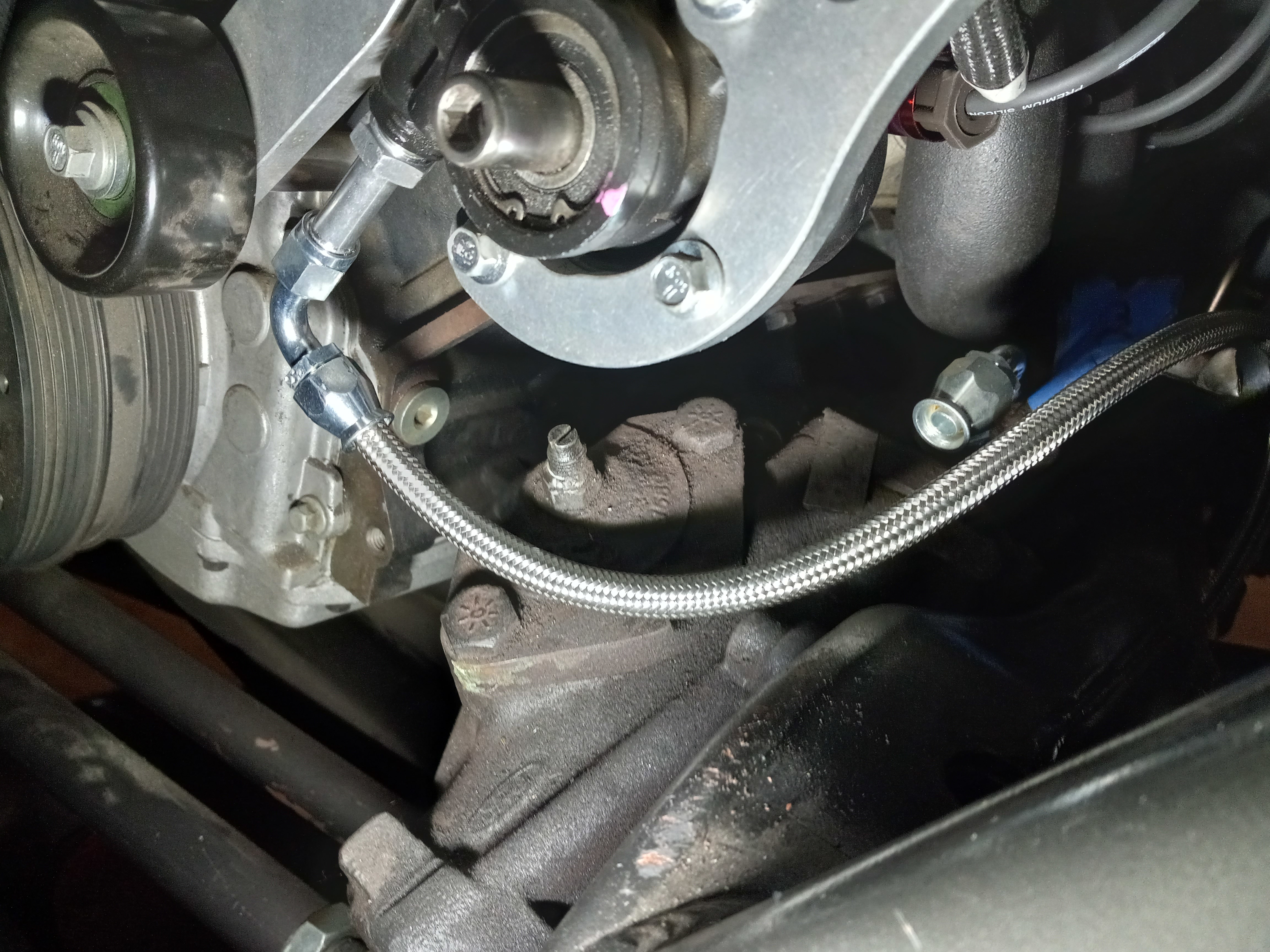

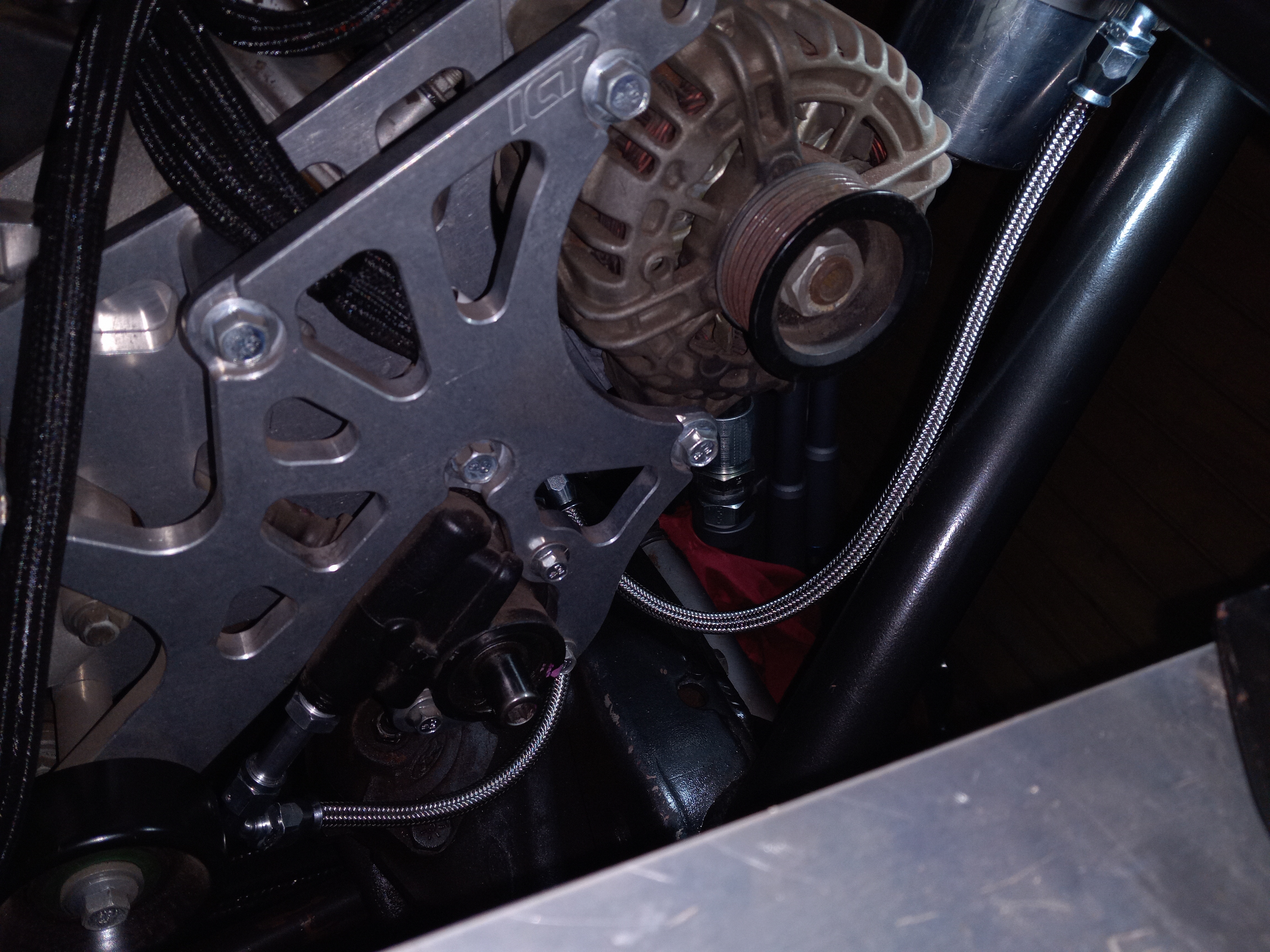

Got my fittings in yesterday afternoon... and quickly installed the Inverted flare to AN 6 adapters into the steering box... and then made some power steering lines. Hope they don't leak... although, I suppose it's not like they are any more important than the brake lines I made. LOL
The high pressure one was kind of a pain to get clocked right and tight. (Hose spins when you get tight.) Of course this is one I had to back off and re-clock a little. So, we'll see if it works.
Low pressure return. Not as likely to leak.

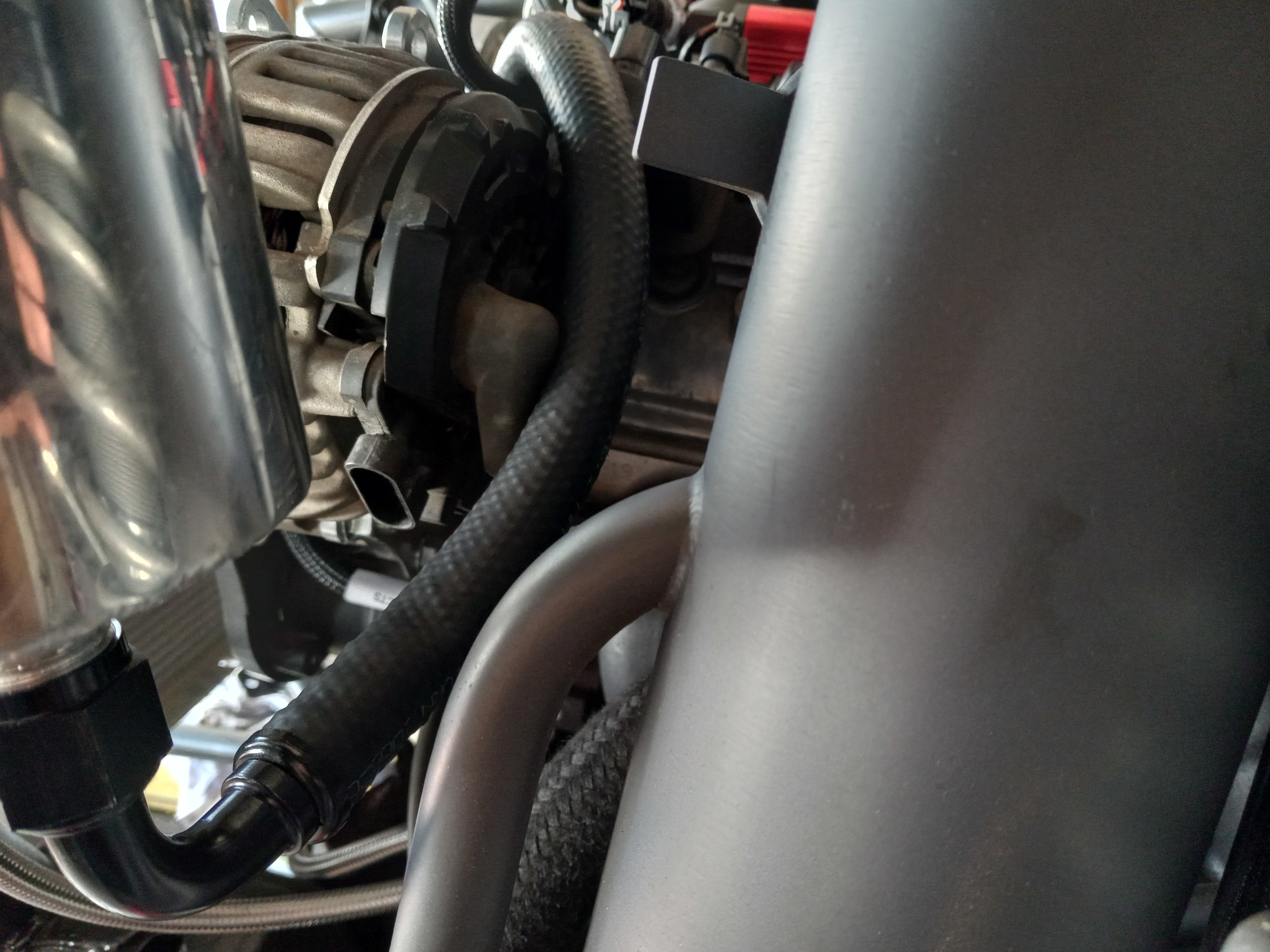

Just ran to lunch and got 5/8" for the barbed suction line. Not my favorite route... but couldn't come up with anything else that would work. Really wish I could hide it better.
Nice! You'll be driving it here pretty soon.
I ended up tig welding my high pressure lines together since I converted from the s10 saginaw pump to the explorer steering box. Holding strong so far!
