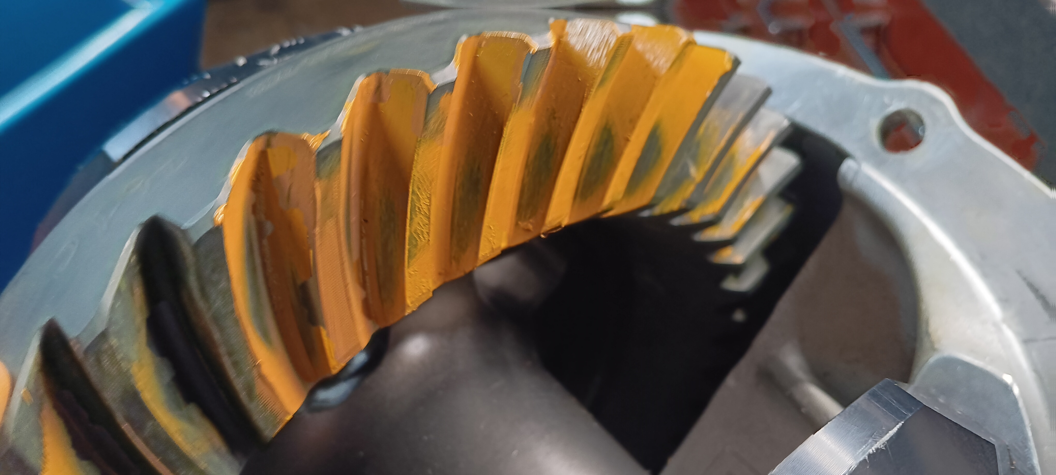

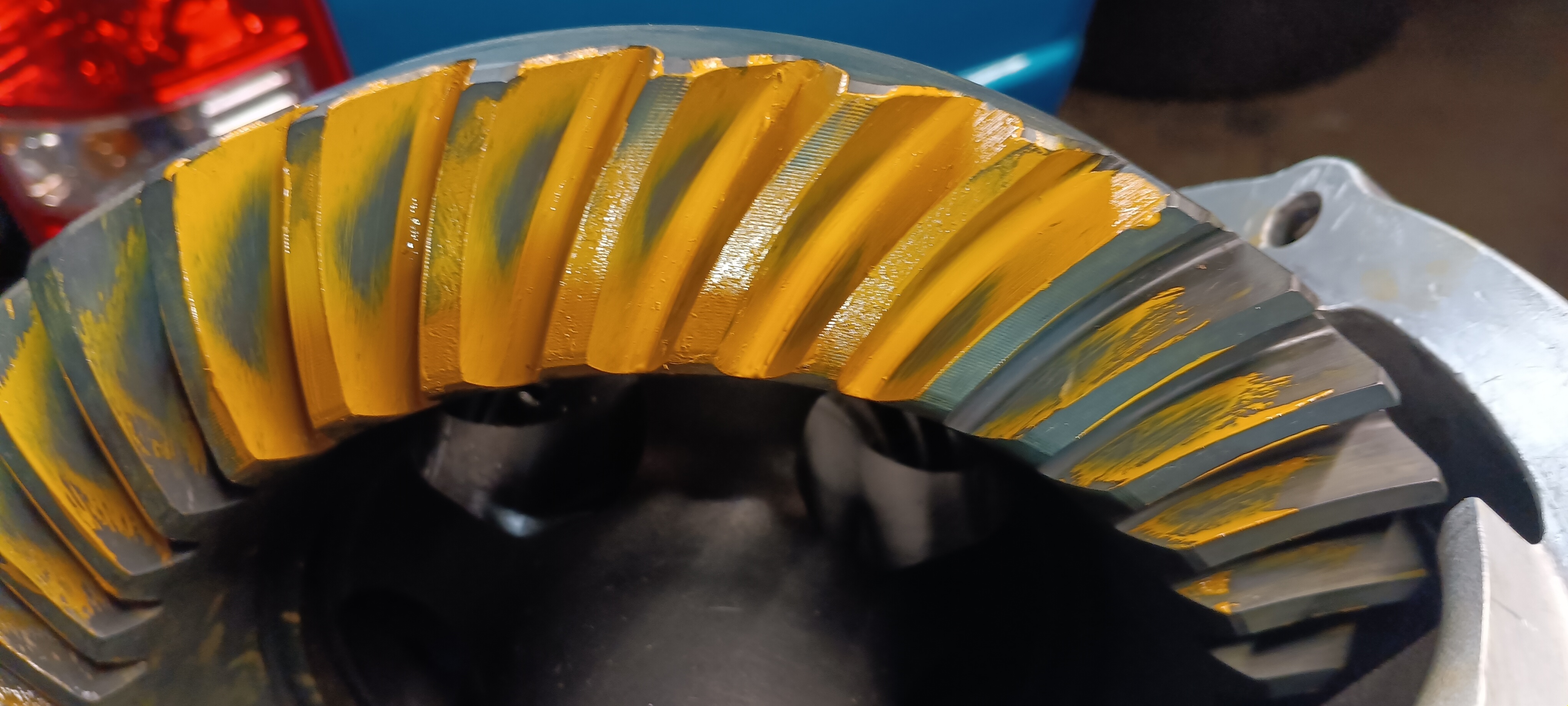

So this is the first pattern. with backlash about .008.
I feel like the drive side is maybe a little too deep and close to toe???

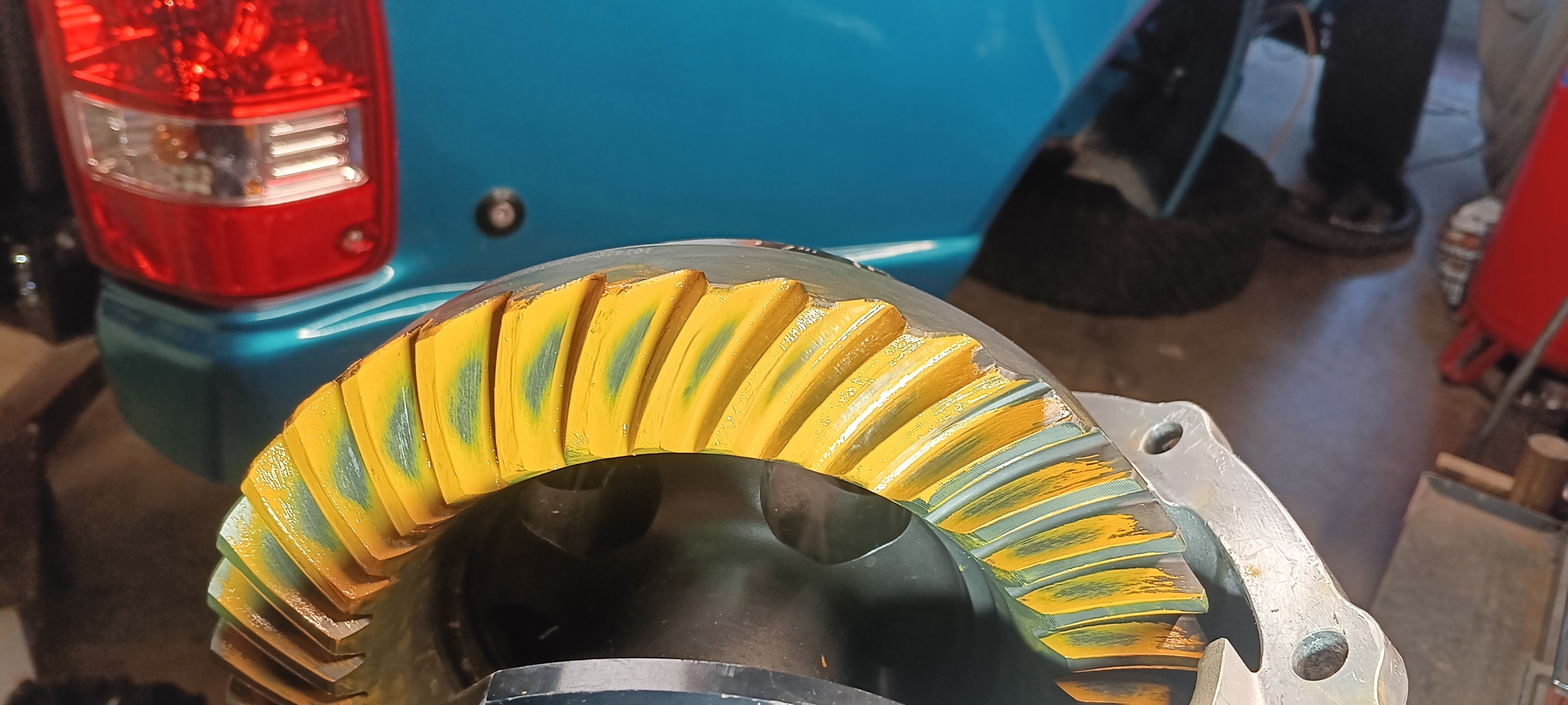

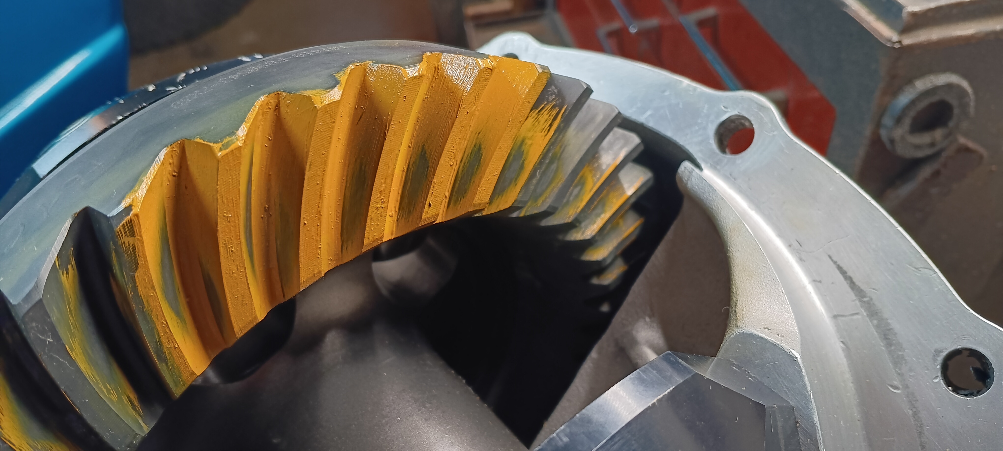

Here is coast.
I am going to try it .002 or so deeper and see what it looks like
Well, shit.... guess I am going the wrong way.
Wouldnt that move the drive even closer to the toe!??

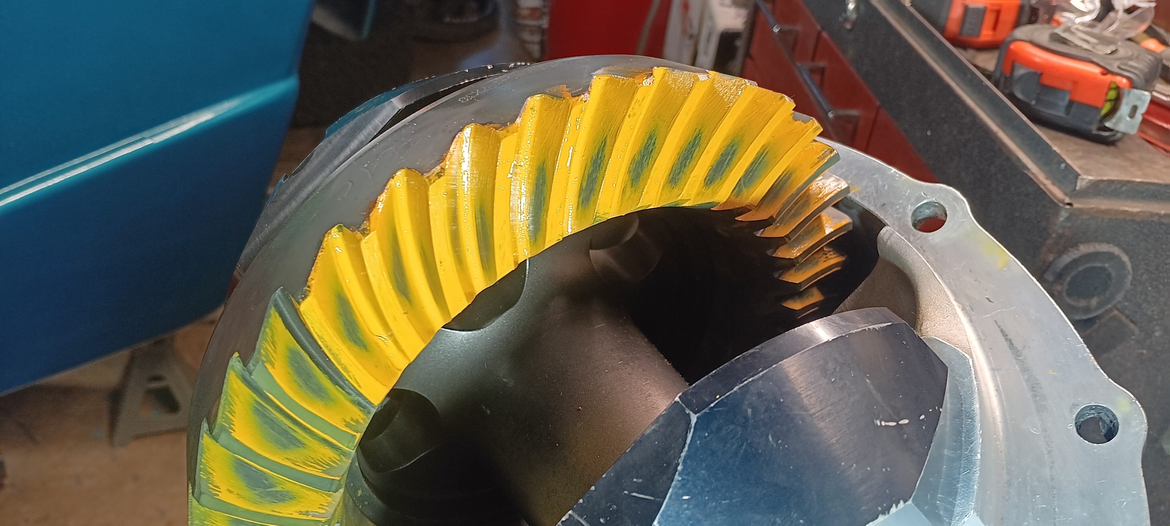

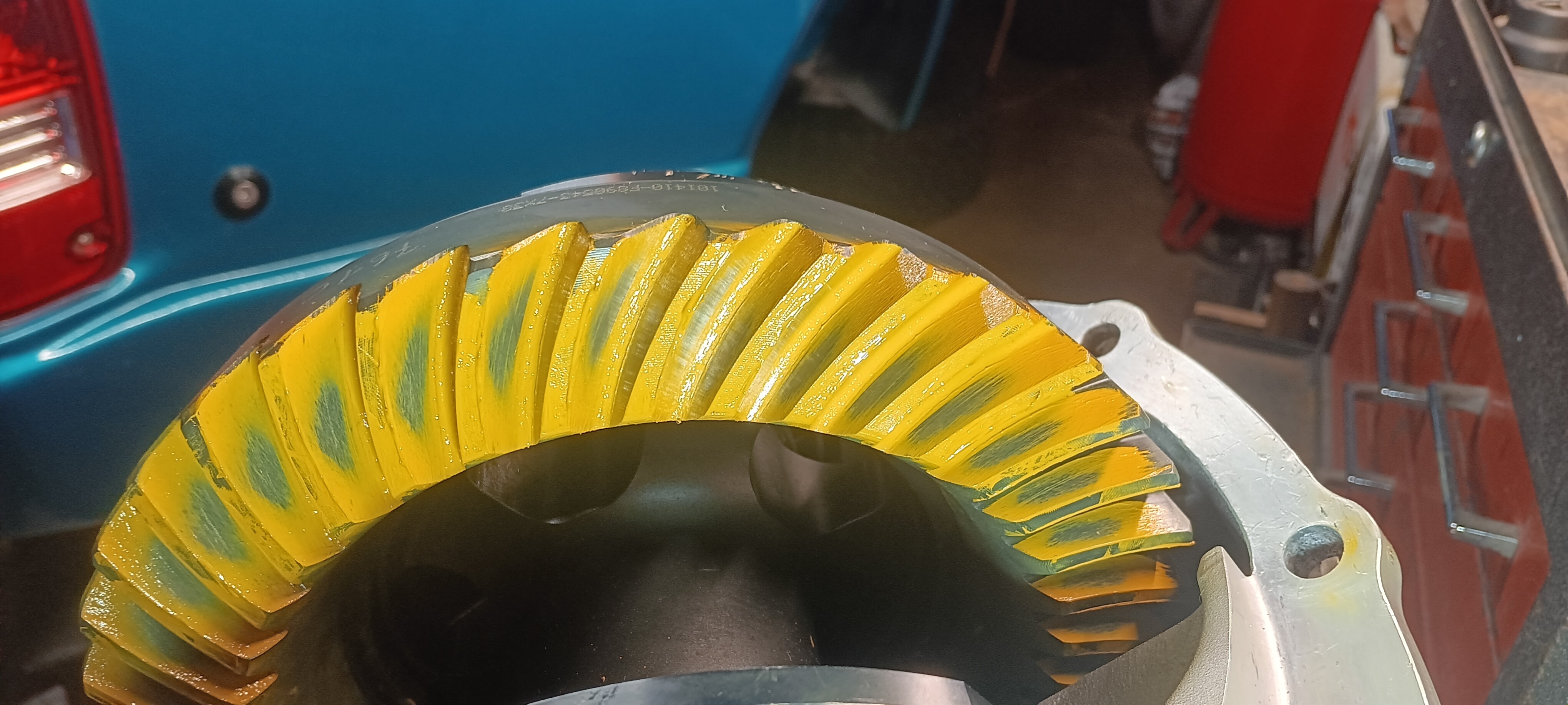

Above is .018 of shims. I just finished changing it to .016, I will run that pattern first here in a second...
Then I will re-do it one more time and put .021 and run that pattern too

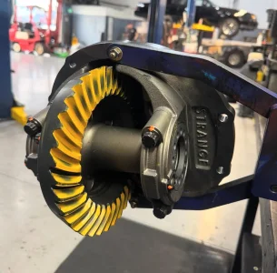

Built one the other day using that exact gear set, different case and opinion support. But also using Strange components. IMG_8490.jpeg
OK... man, this certainly doesnt seem to match the "math" based on pinion face numbers...but I can see the pattern seems to be looking more centered.

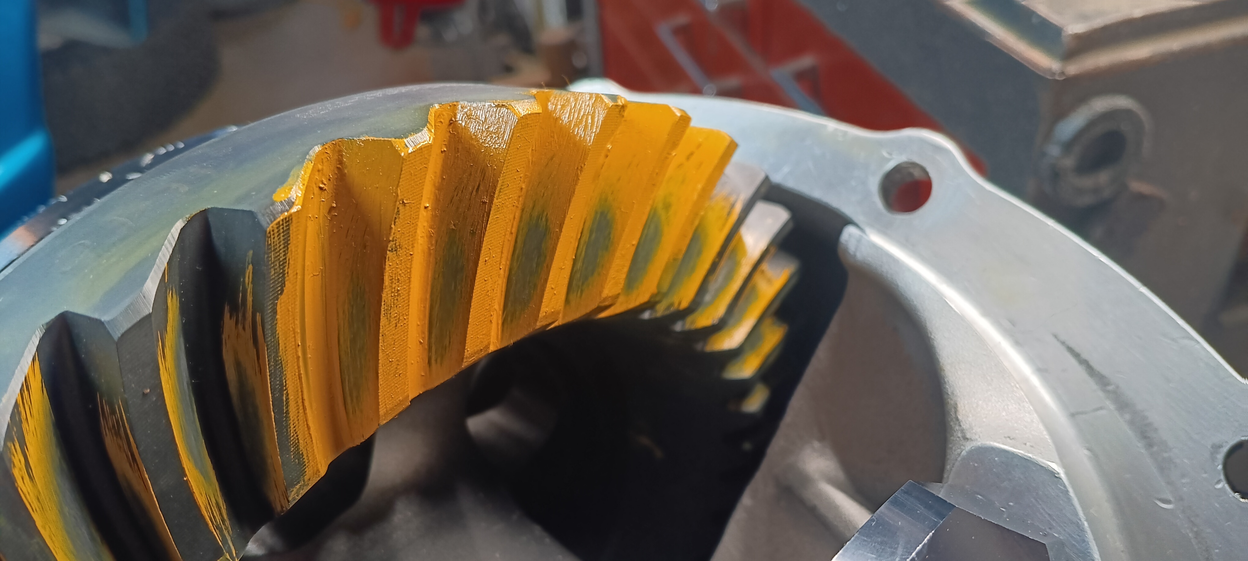

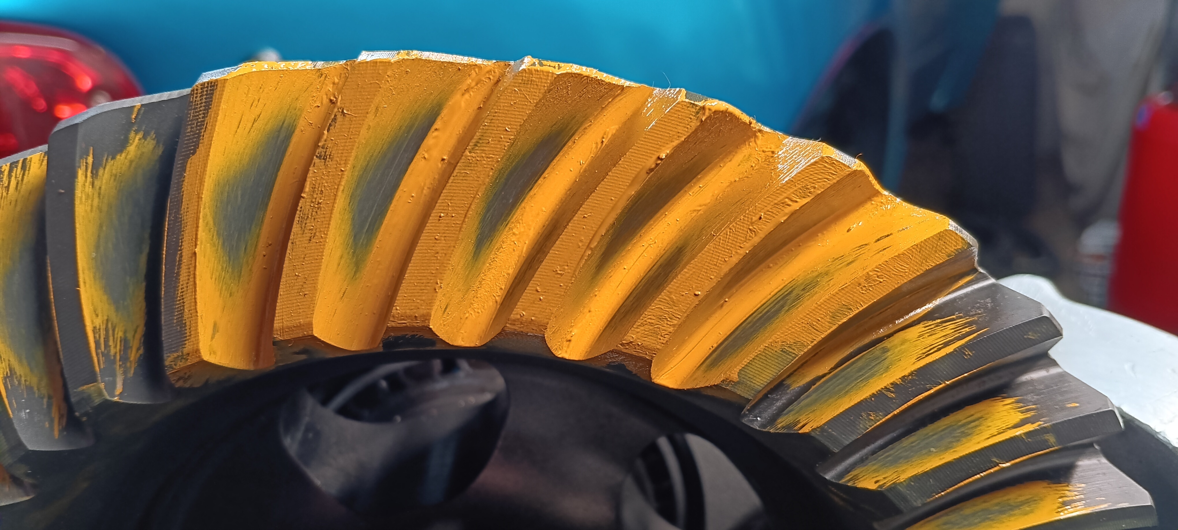

@Raceranger97 Here is .024. Should I keep going? I totally owe you a beer too! hahha

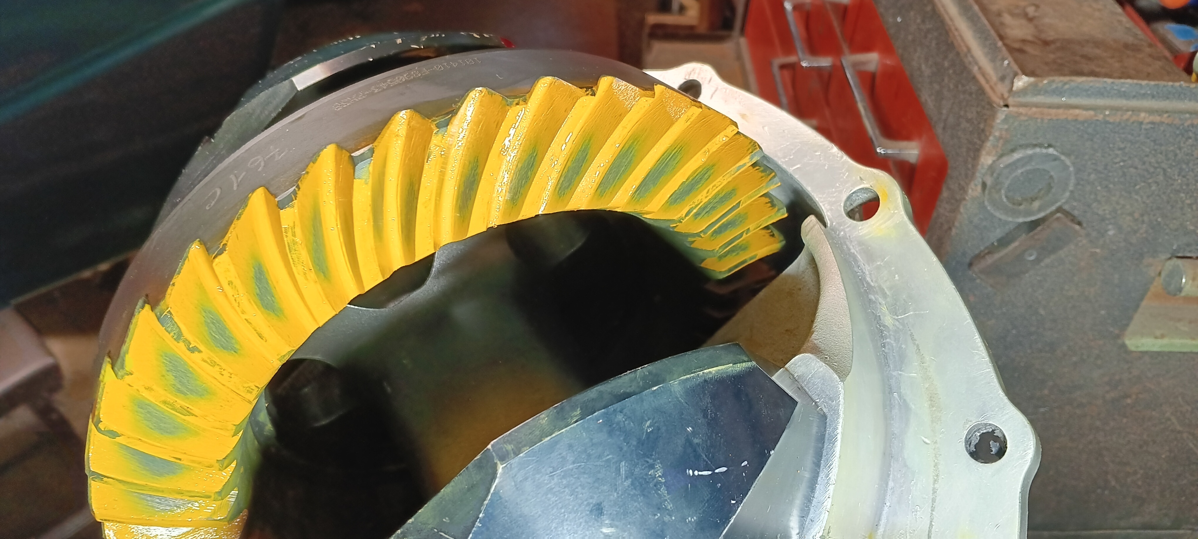

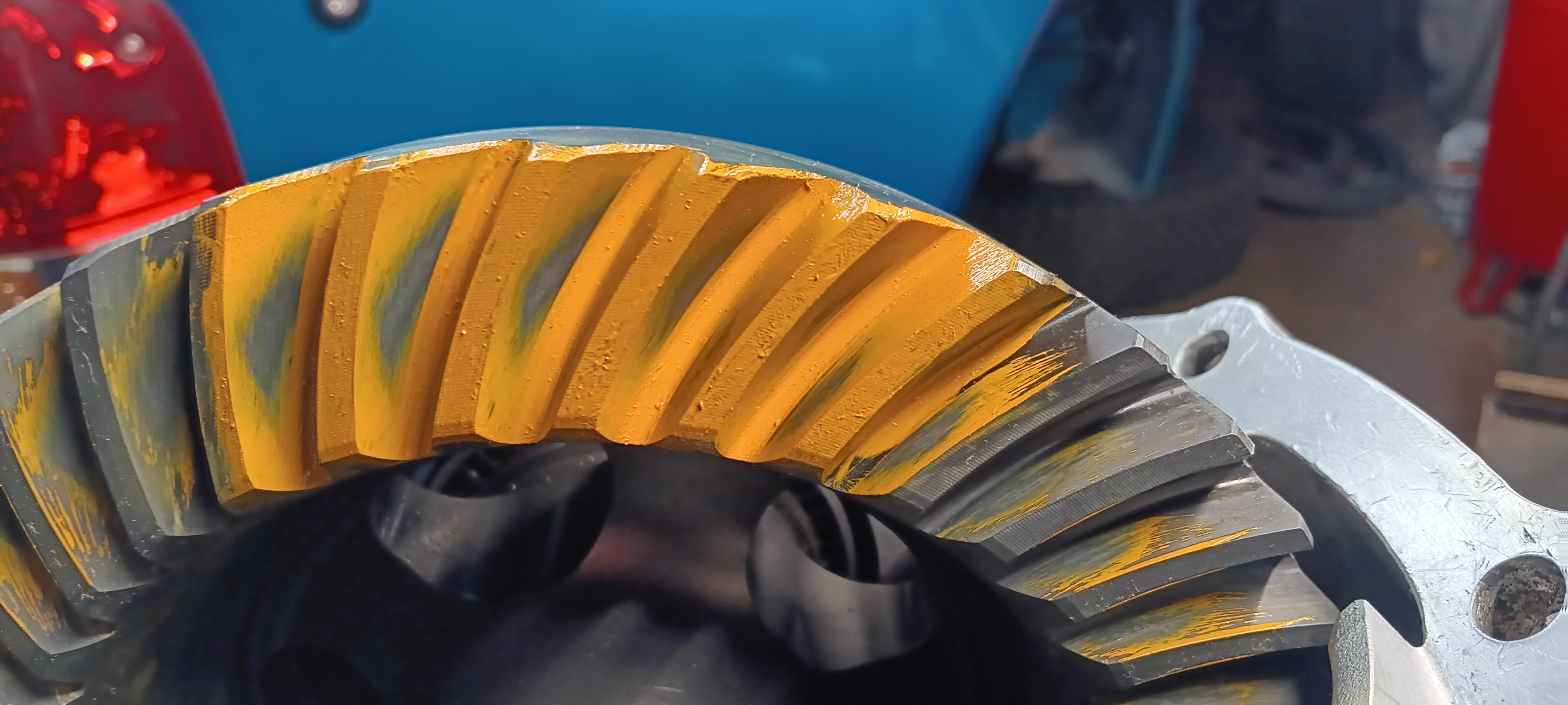

OK.. @Raceranger97 here is the .026. Have to admit.. I cant see a ton of difference between last and this one. *note too. Last two changes haven't required me to move the carrier for backlash. Others did. Current backlash is like .008
When I was setting up my last 3rd I noticed I had a couple diff pinion shims that visually didn't change the pattern on the gears. I also ran slightly tighter Backlash at .007. Been driving the truck now and it's silent, BUT i've only put like 300 miles on the rearend now
^^ yea, I wonder if that means you are in the proper range... I read some like tighter backlash for offroad.. but I also read it can cause more noise too? I would think tight is better because of constant loading and unloading gears see in our application
@Raceranger97 What did you think of the .026 pattern vs the .024?
So, looking at the motive gear paperwork.. they show the drive side to be closer to toe side. and the coast is centered. I feel like my pattern looks pretty close to their paperwork..

looks pretty good at .026 but I would keep going out to see if it continues to get better.

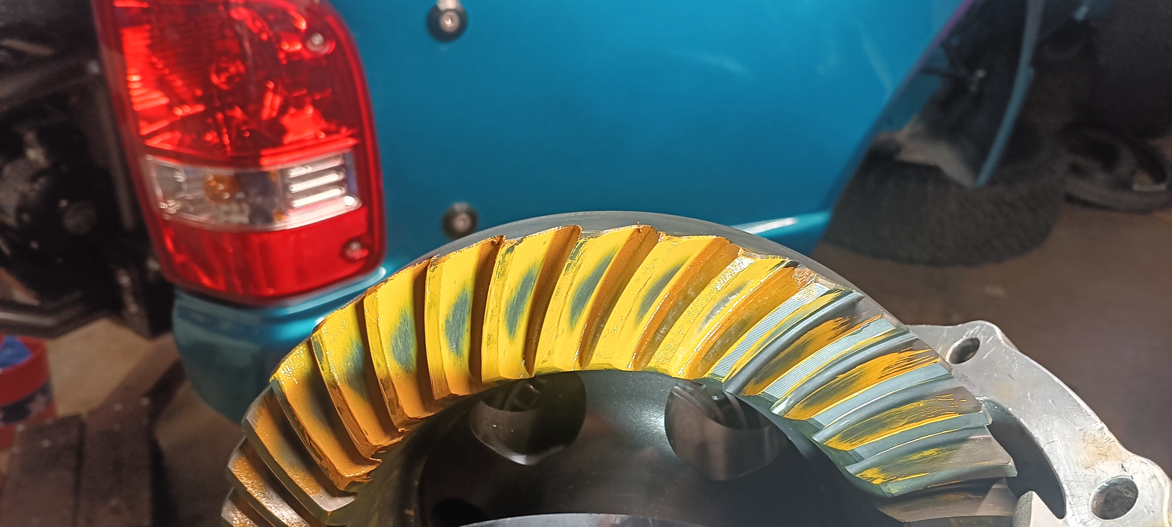

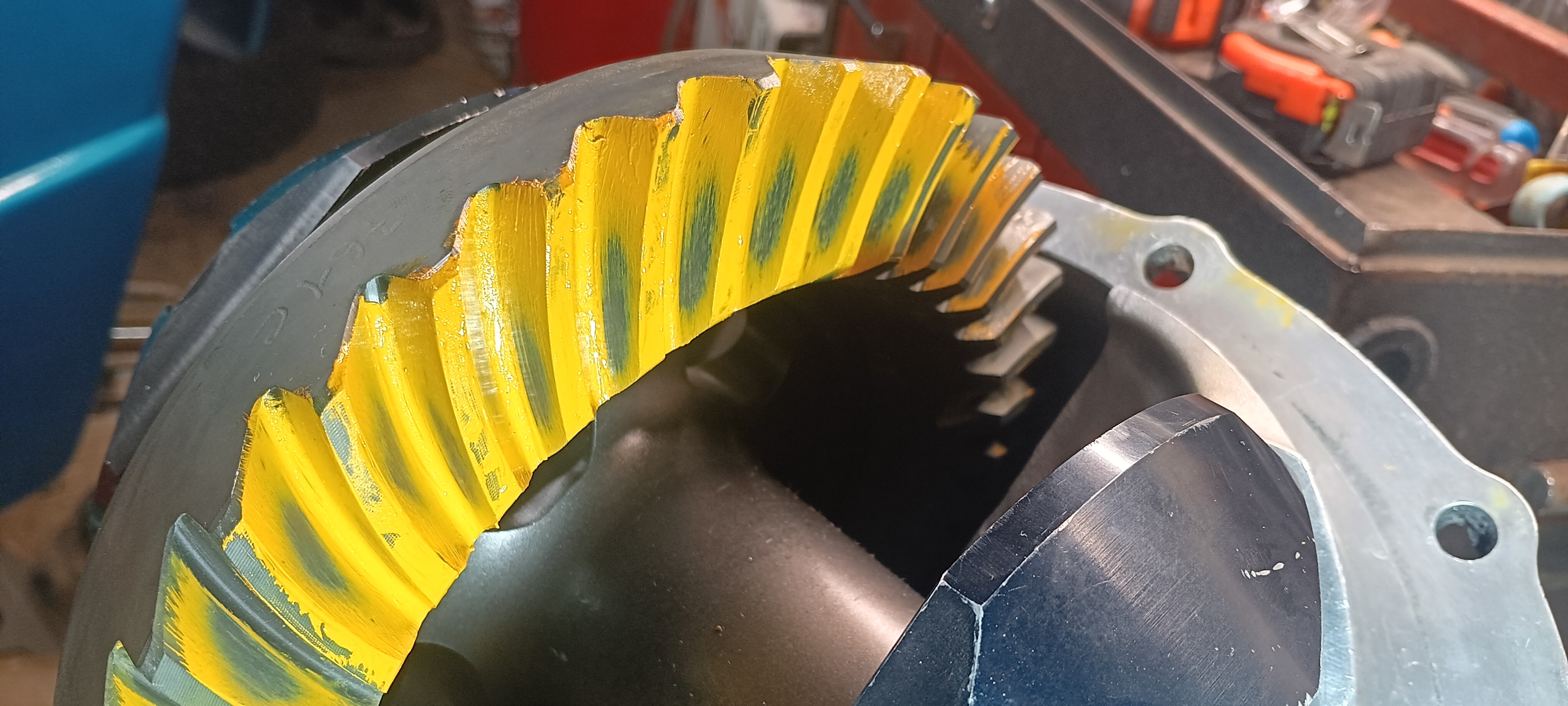

OK, Here is .028.

OK, Here is .028. Is it just me or is the pattern not as consistent looking??

Yeah .028 photo looks perfectly invisible
