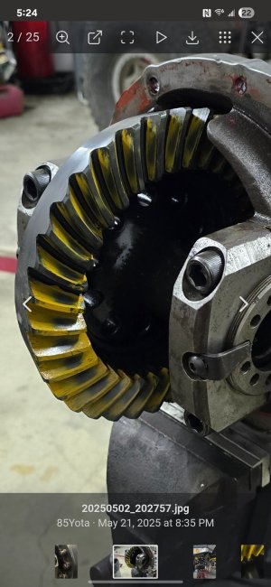

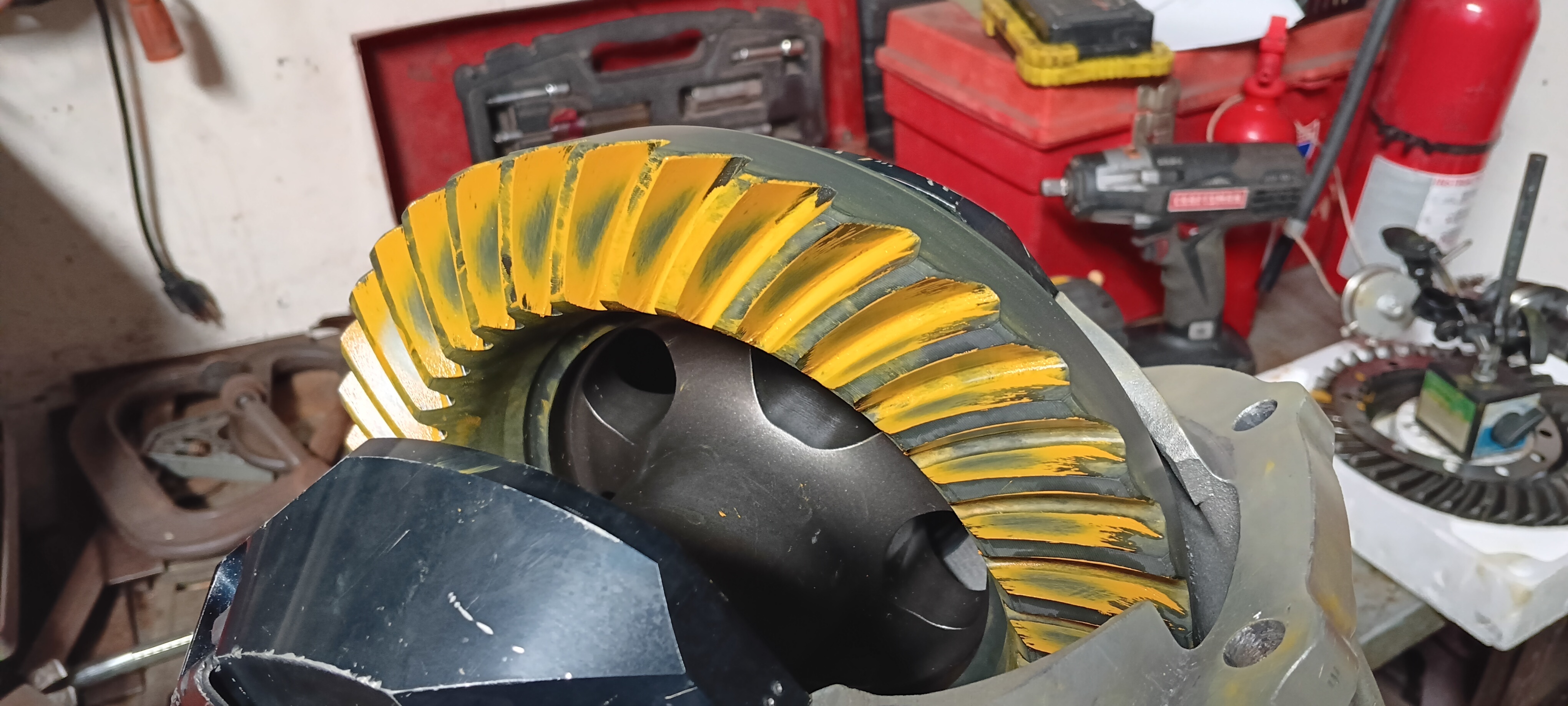

OK, Here is .028.
PS:
Motive tech guy told me he starts with .030 on these gears...and goes from there. go figure.
That's an odd thig for him to say considering it varies greatly between case/pinion support combos. Unless he was familiar with your exact set up I suppose. The pattern looks good but a few coast teeth look a tad deep in the .028 pics, happen to have a shot of the "ghost"/transfer pattern? sometimes it tells a better story. I can see the drive ghost and it looks good.
Yea i think he said it was just his starting point for a new setup with motive gears in a higher ratio like mine.. (when discussing the number srcribed on the pinion head.. def not needing .07" of shim).
when you say ghost/transfer. Are you tallking about when it carries the yellow marking compound over from the painted section to the bare teeth?
I liked looking at that during this process.. seemed easier to read the actual pattern that way
I will get some more pics later. And when you say the coast looks deep... that again would mean to keep pulling the pinion out with additional shim, right?
Yes and yeas. Looks really close though.

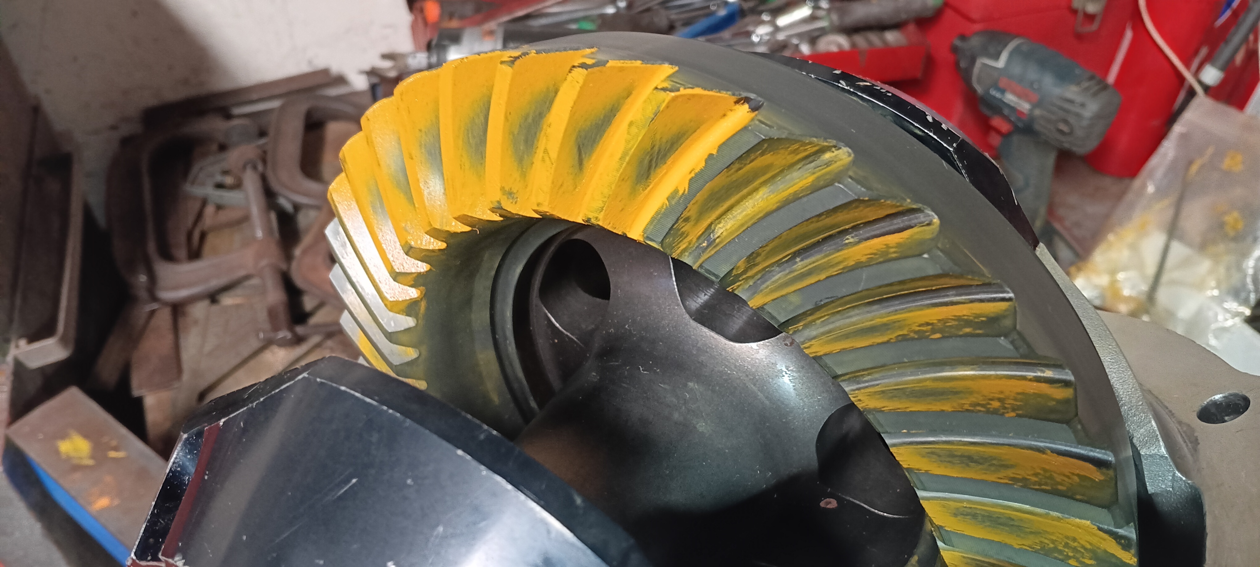

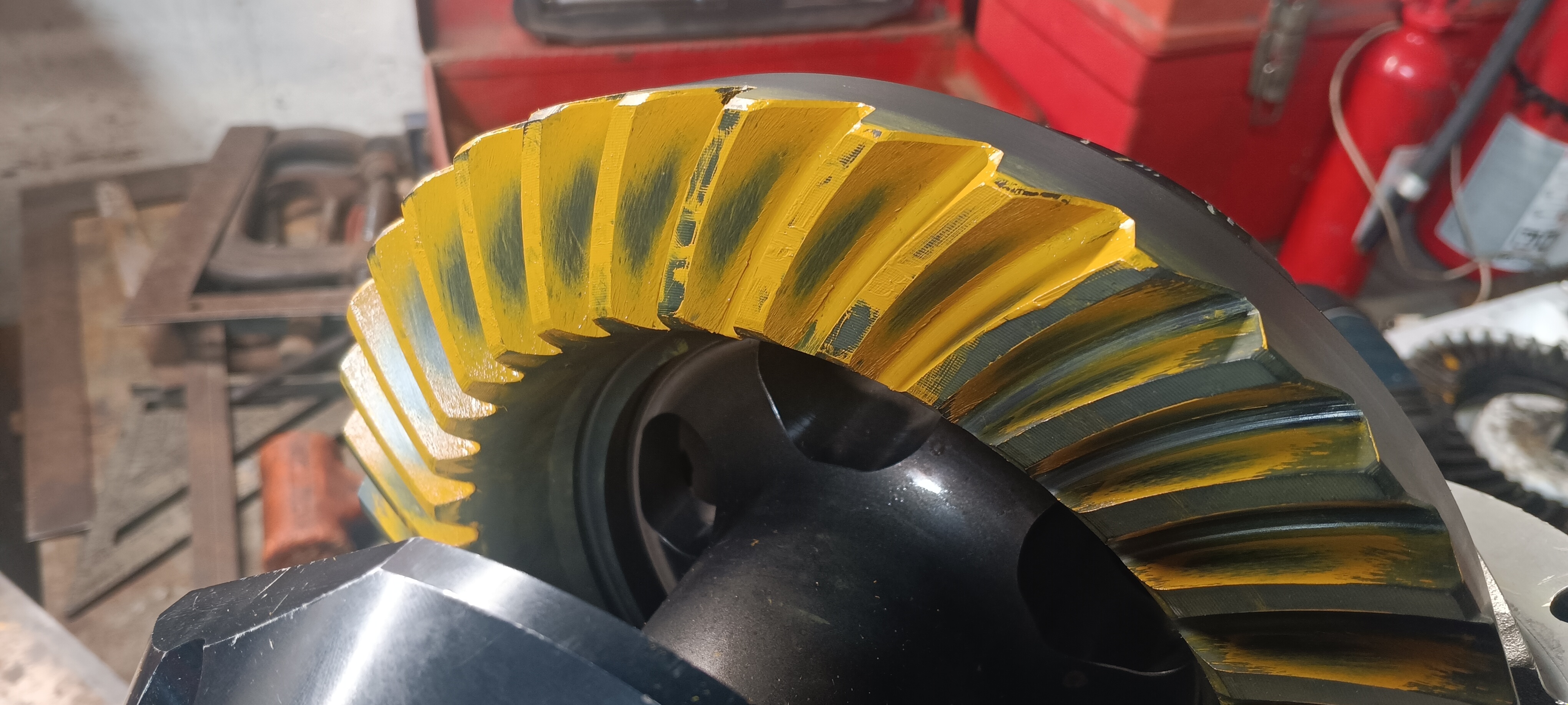

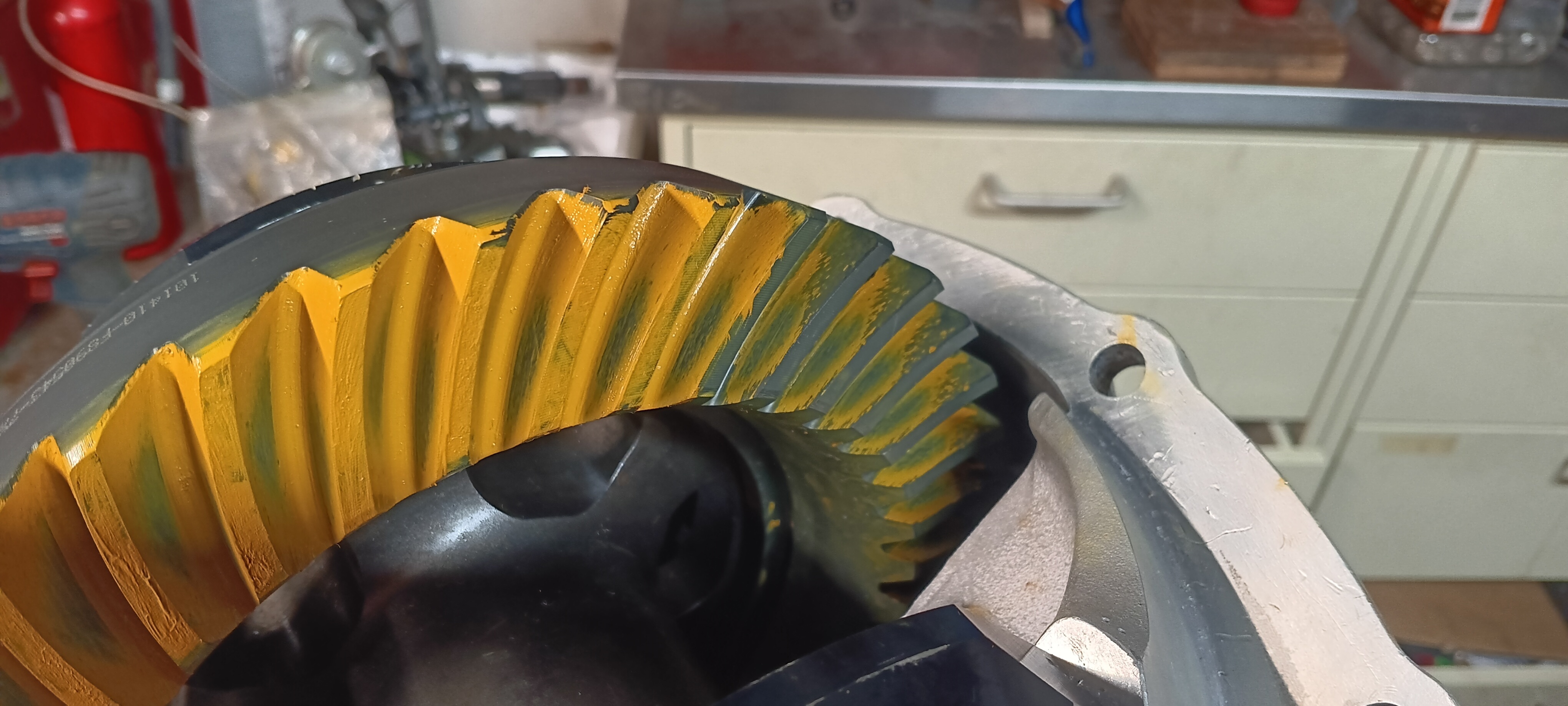

OK... here is some more of .028. I wiped a bunch of this marking shit off... I look like I have jaundice now. haha.
It looks pretty dang good to me, but what do I know. LOL. What i noticed is the drive pattern ends right before the middle of tooth radius, where it kind of drops off. It's hard to explain. BUT>>> still seems like it could go out more?
I have a feeling @Raceranger97 is gonna tell me to try a .030 and I dont wanna! So tired of taking this thing in and out now. haha

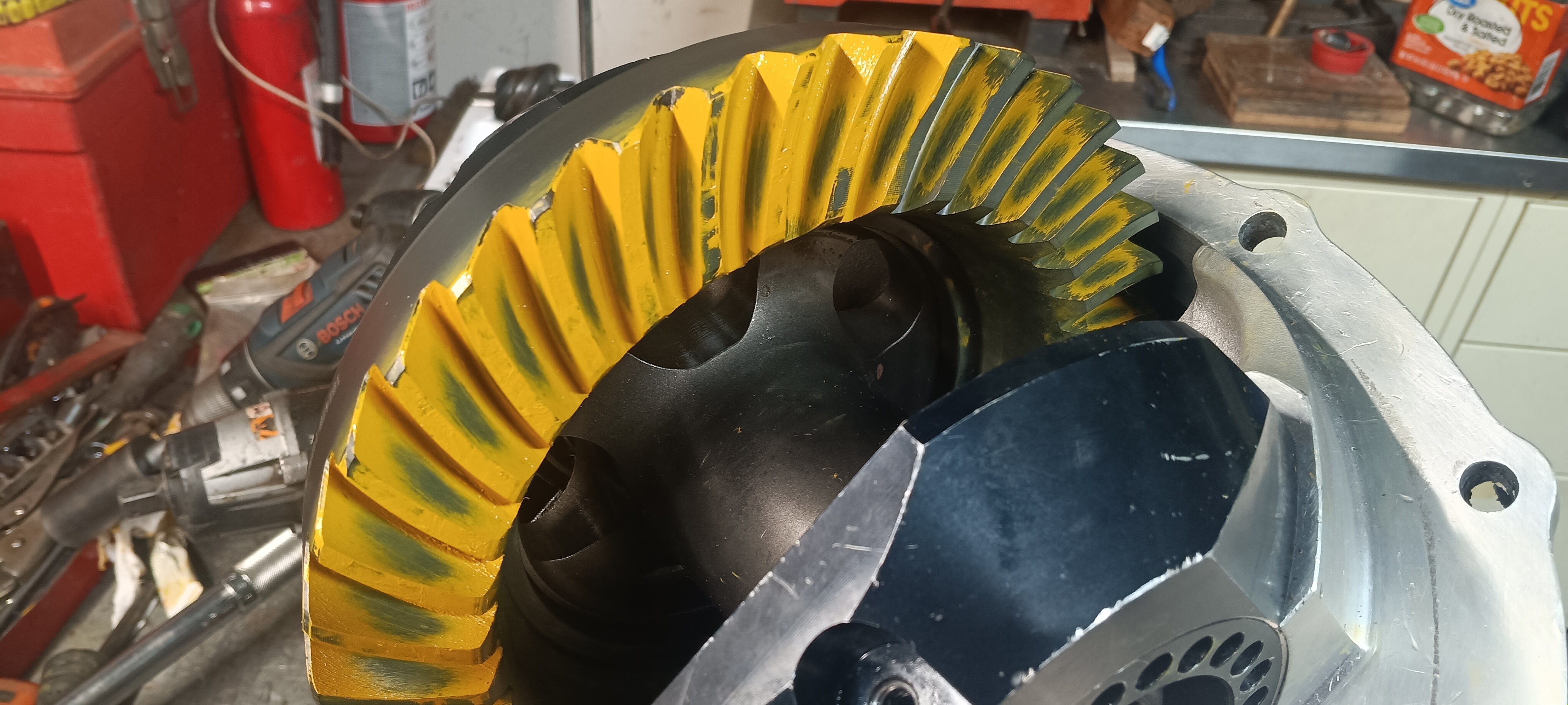

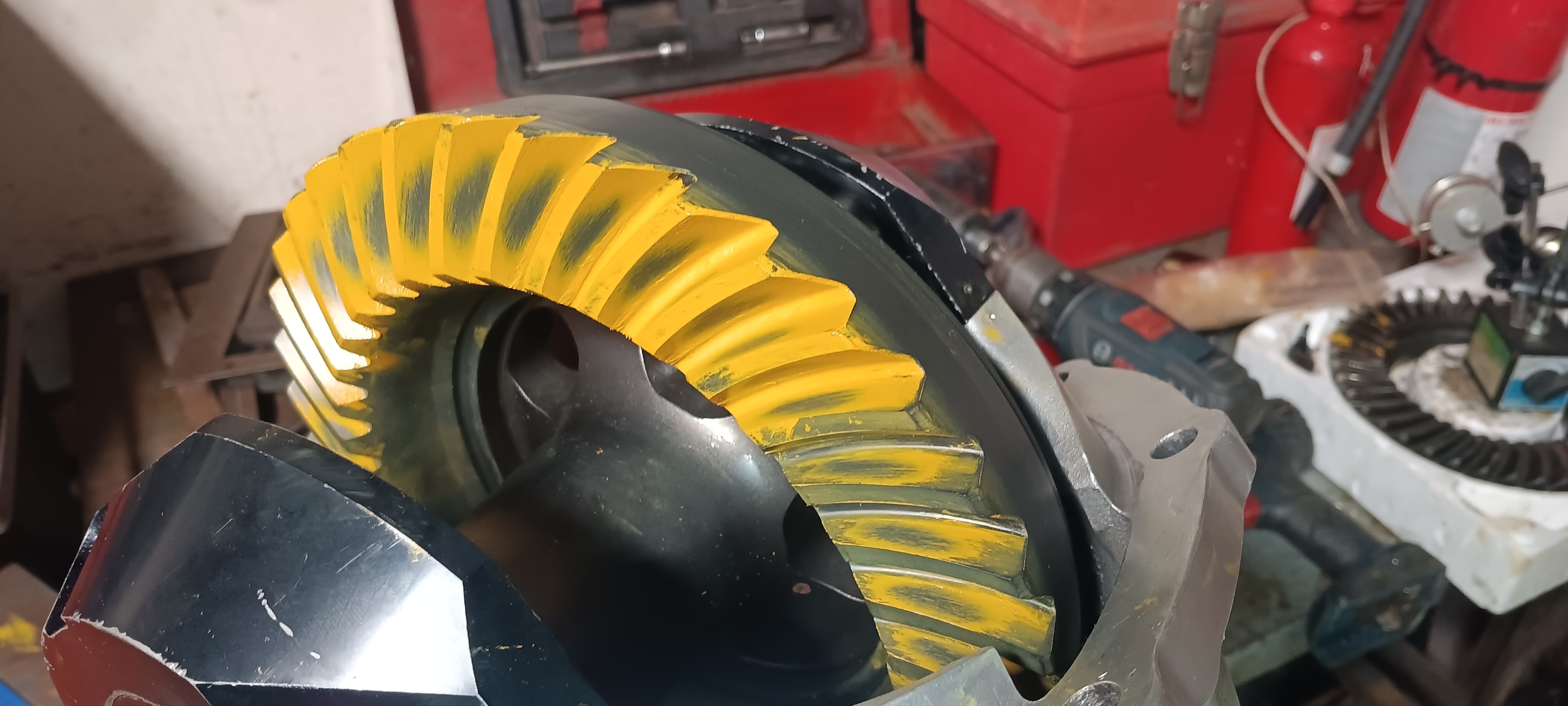

Okkkkkk. Here is .030. Is it any better @Raceranger97 ? I had to move the carrier spanners this time. Backlash got tighter this time.... Like .004
The backlash options were either .006.. or like .008-.009. So not really in the middle like it was before. Pattern is run here on .008-009

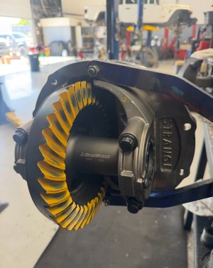

Hmmm. Weird the coast isn’t getting better. For what it’s worth, I built another one just now for a desert customer. Here is the result at .044, but in a completely different case/support.

Hmm. Yea yours are way more centered on drive side.. and higher up on tooth too.
Maybe I will go try a .032 and then something big like .040

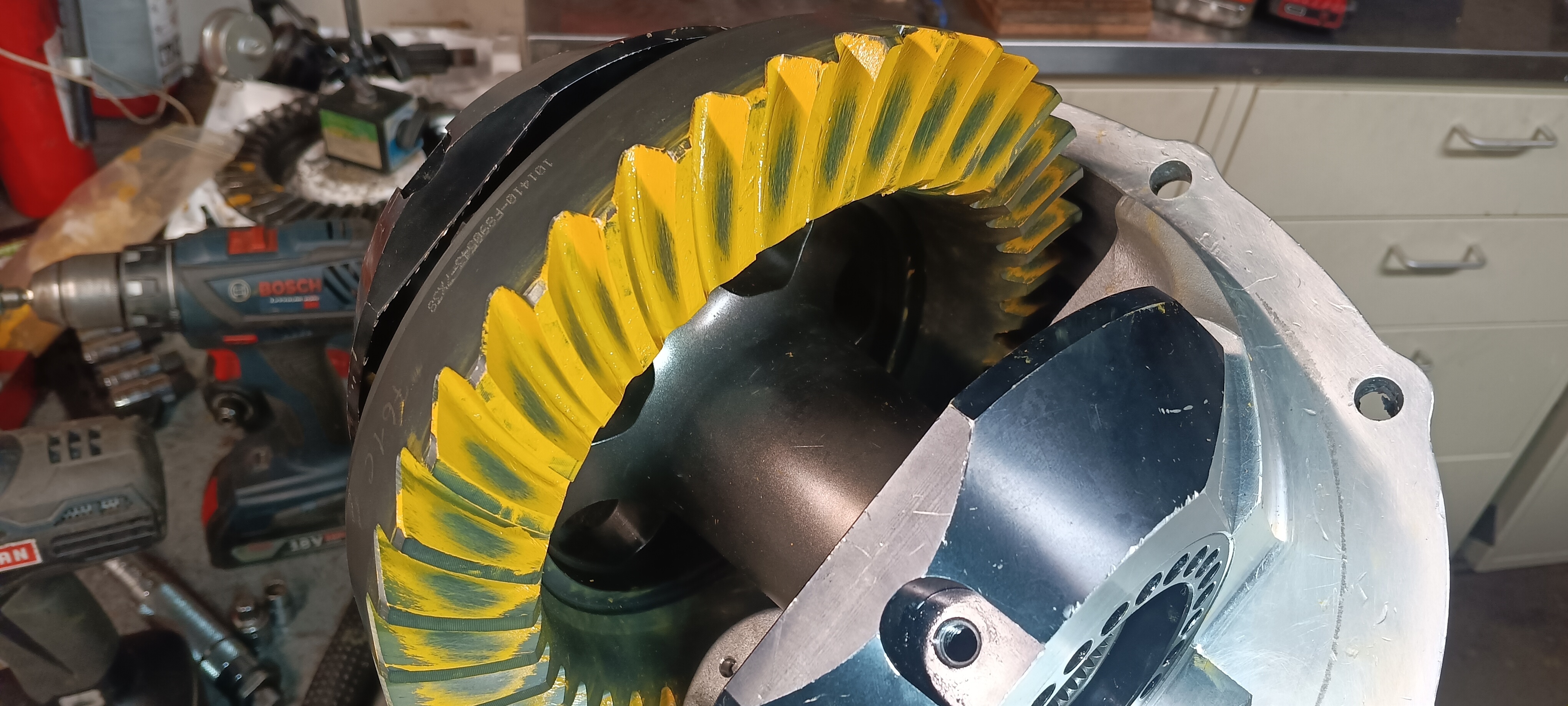

OKKKK>>>> well this is funny. I'm a total dipshit and apparently took out the .008 and didnt put in the .010!!
SOOO>.. that last pattern was actually .020. Jesus. NO wonder the backlash went wrong way.. and no wonder the pattern was worse.
I will get the pictures of the .030 pattern for real now. When i took it apart i was like ohhh. DERRR DA DURRRR. Wonder if I was drunk on that one. Dont do drugs kids. LOL

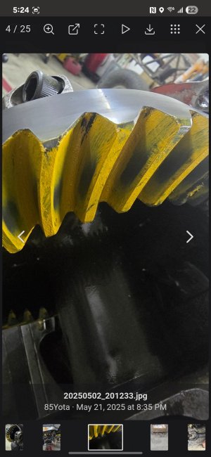

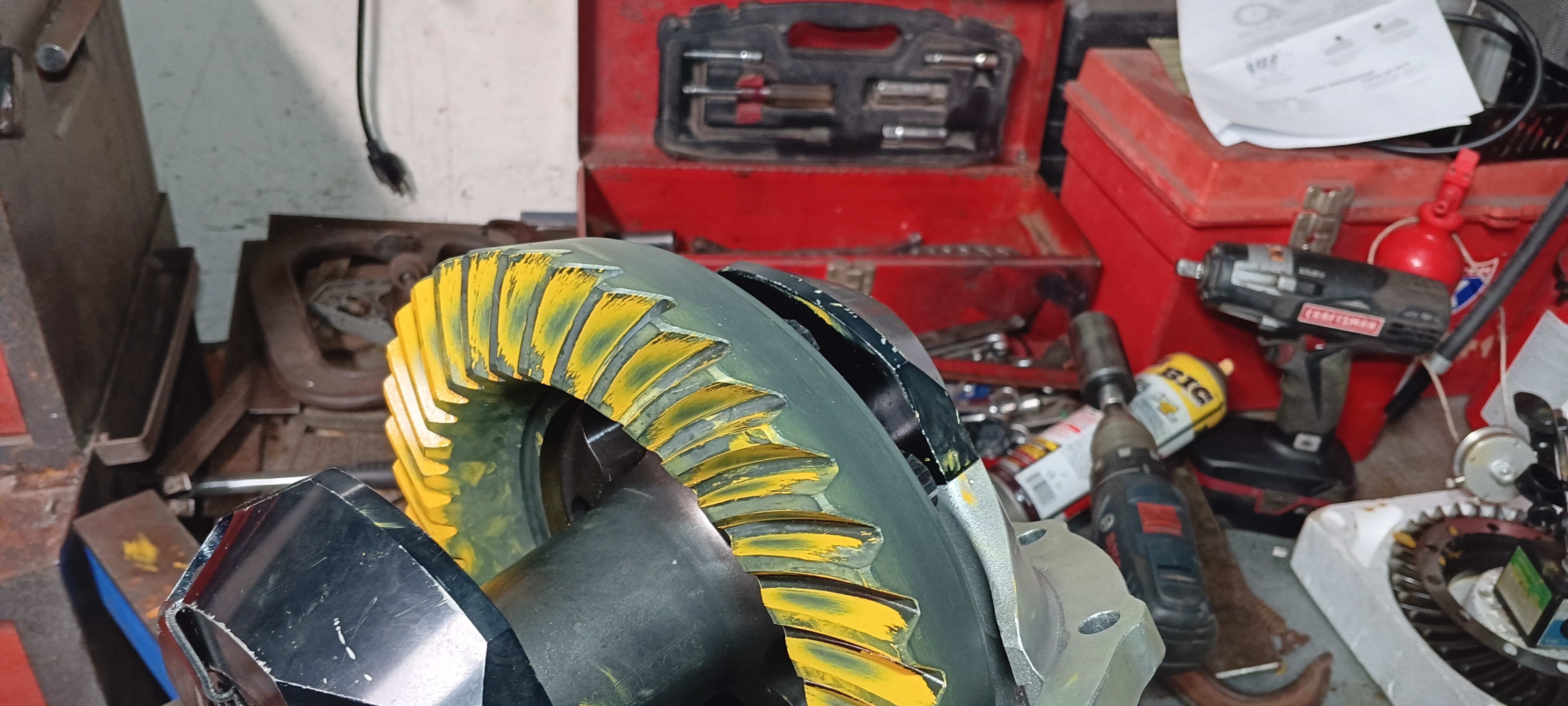

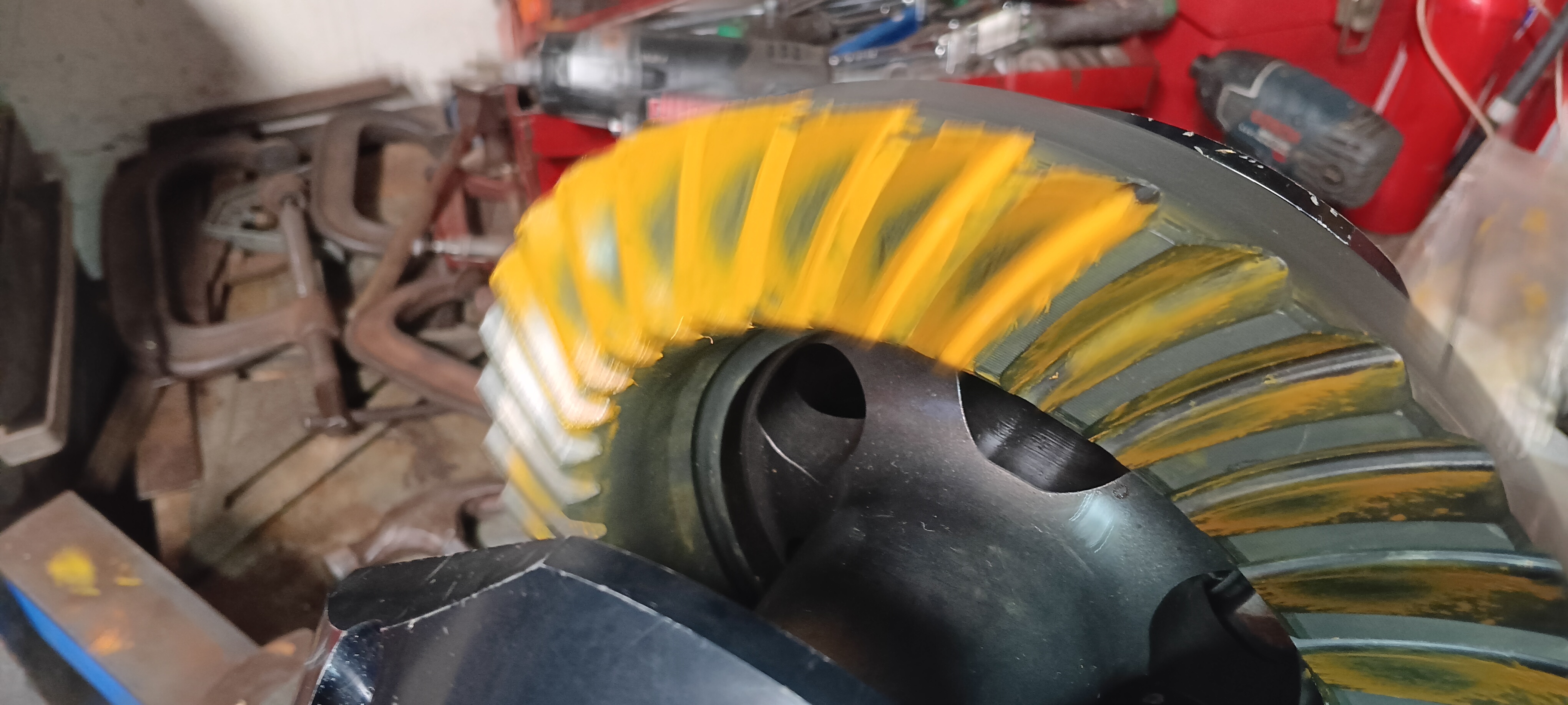

Here is the actual .030 pattern. now that i have done this like 9x ... I have removal and re-install speeds in top shape, that is for sure. LOL
Shit looks pretty good to me. But I assume I should still take a look at .032 or .034 or ??
@Raceranger97 Are you focusing more on the drive side or the coast side when you look at it?
I had "Elsa" helping me "paint".
I'm no axle pro like Axle pro's is but I like that.
Now add another .002 and try again. Lol
AHAHAHH. Seriously. I would throw this one in for sure. I have another .003 shim staring at me though.
