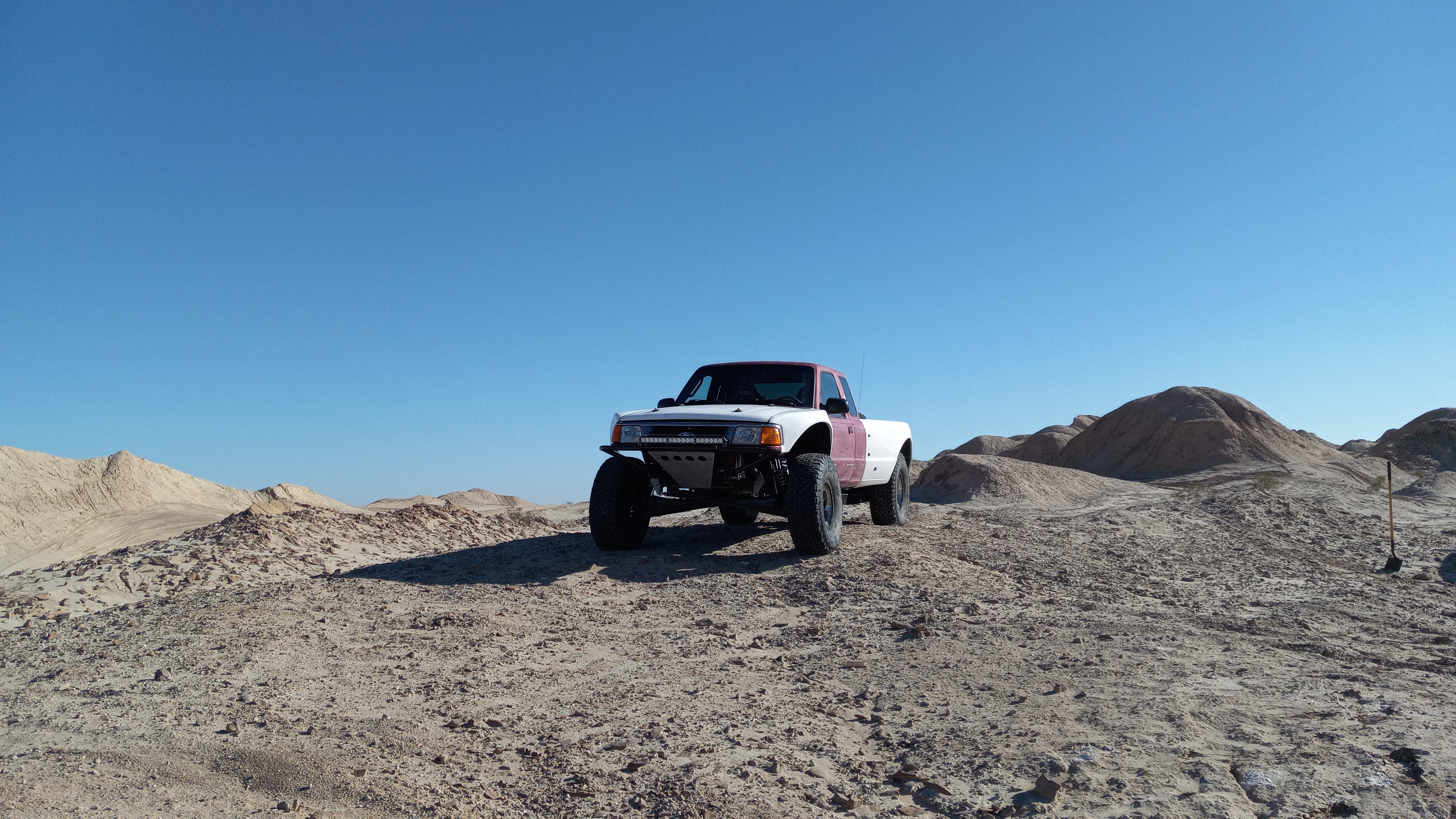

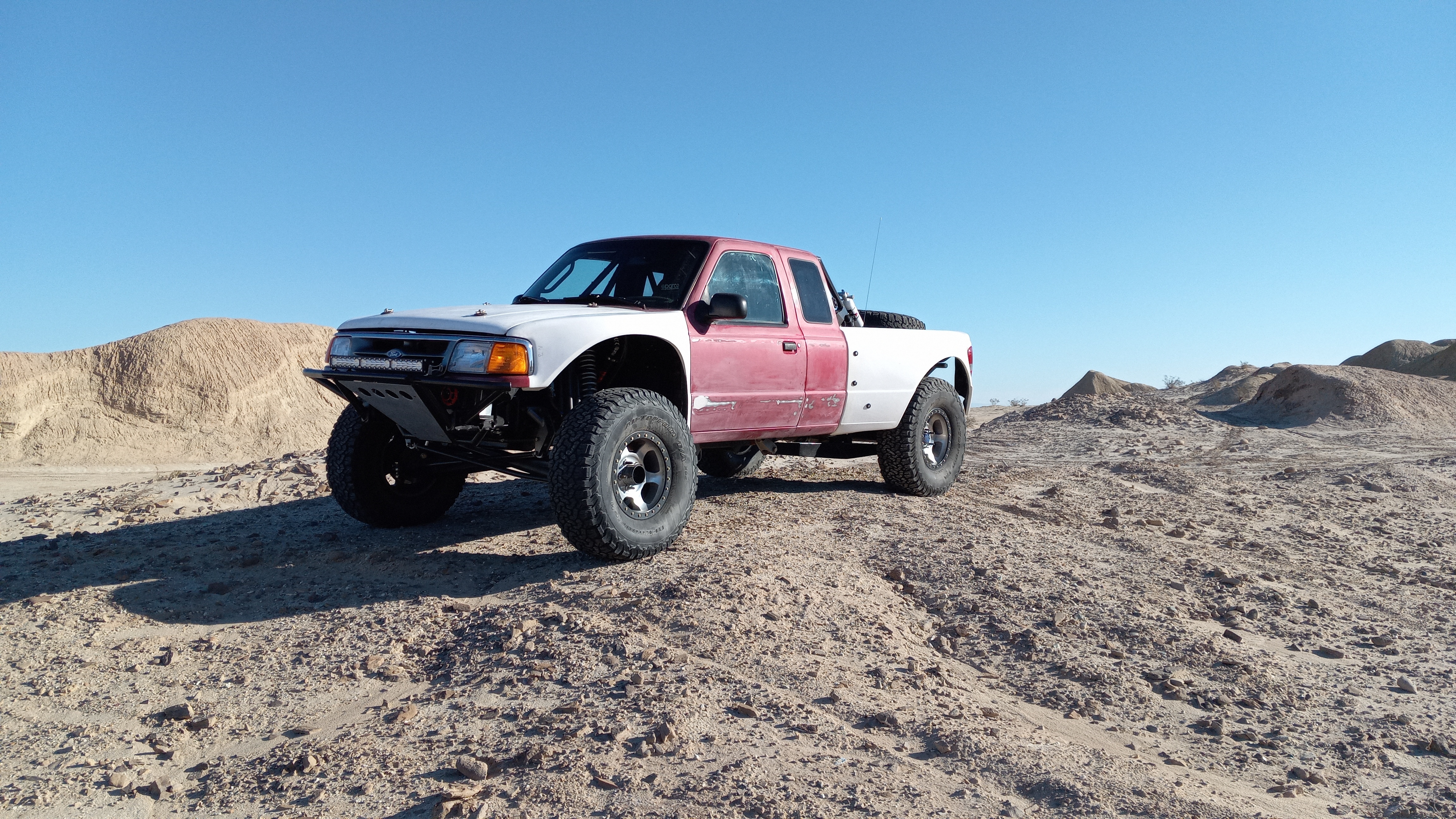

only photos from second test. should have gotten video of the camp double/turn... exactly like I have for 2ghetto to see/hear difference. maybe next time.
