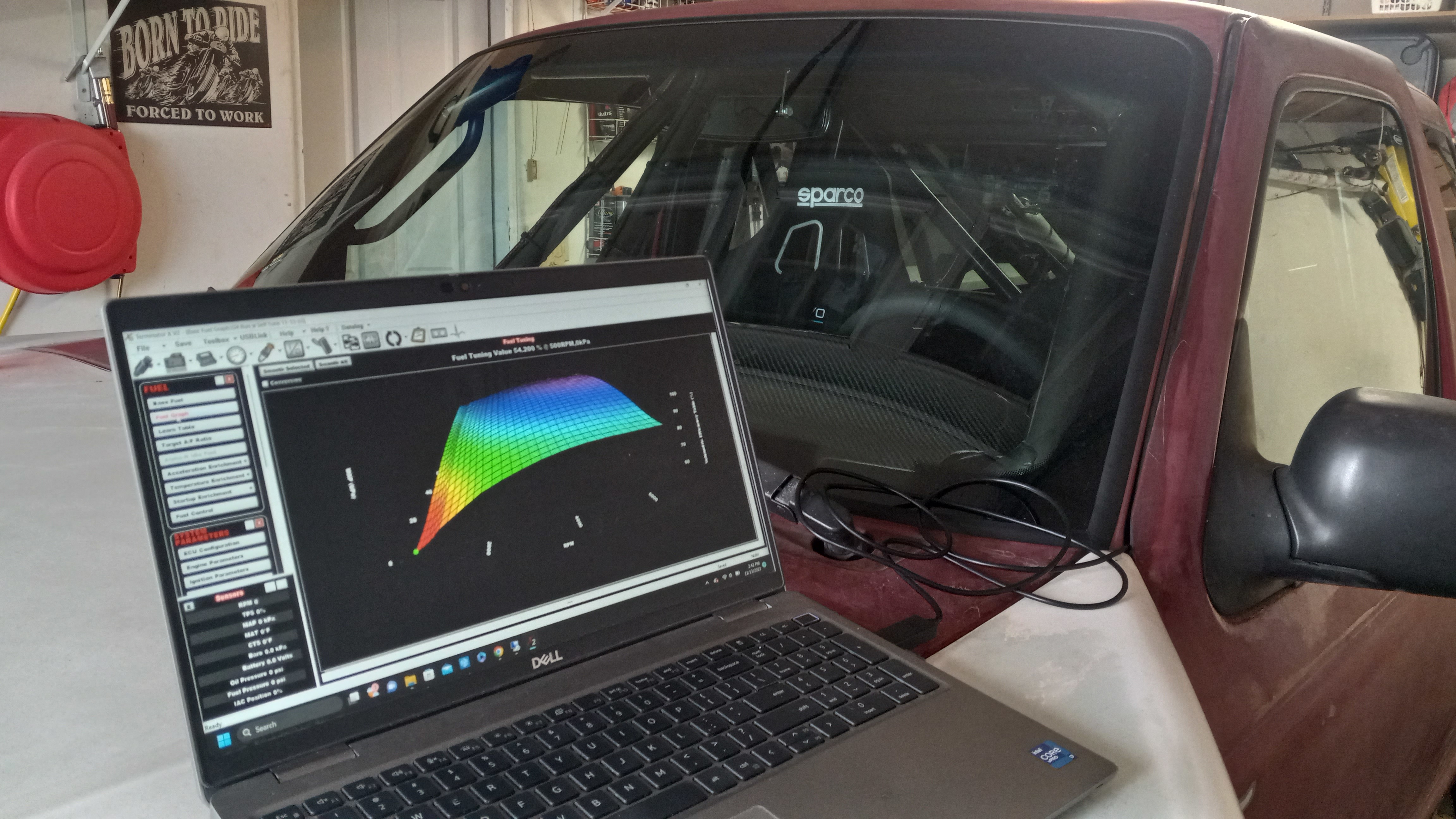

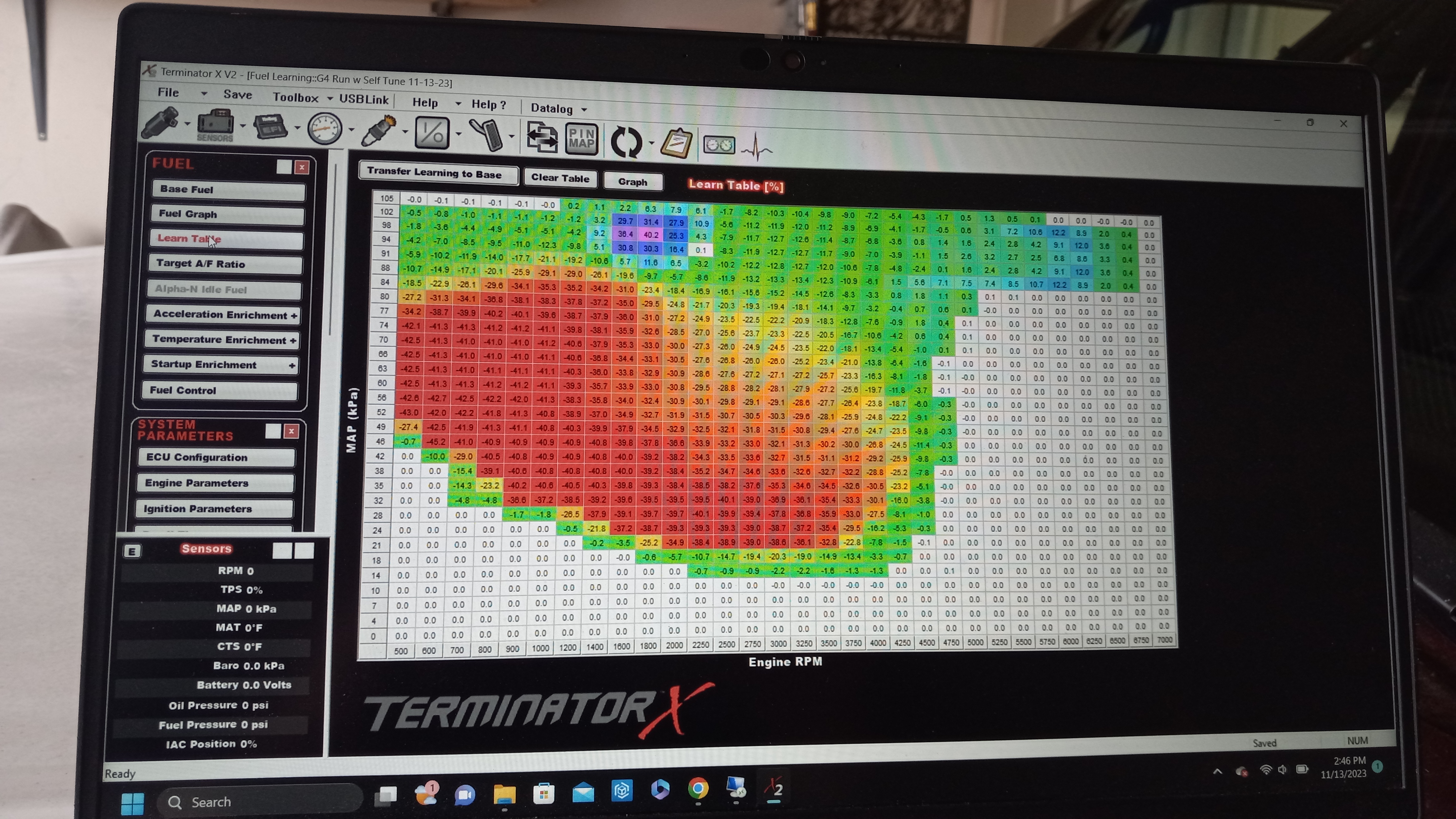

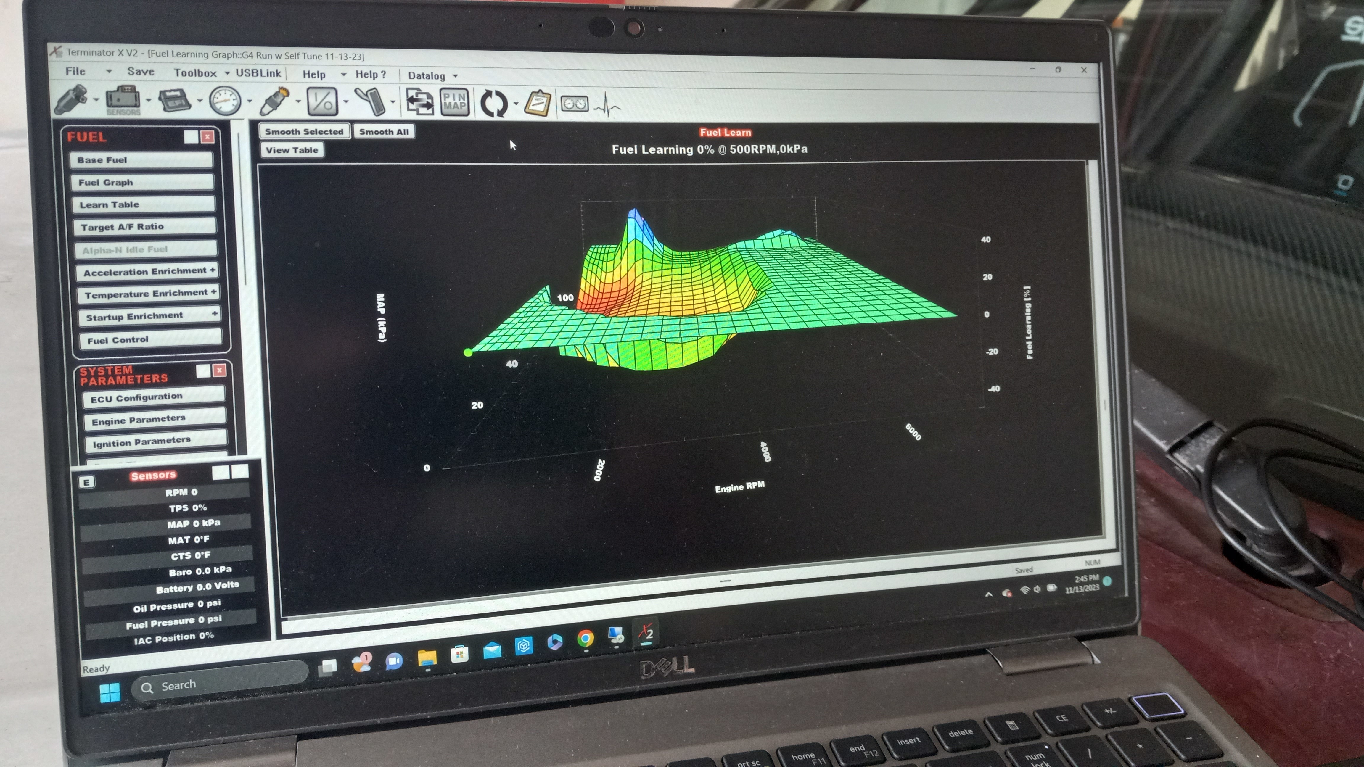

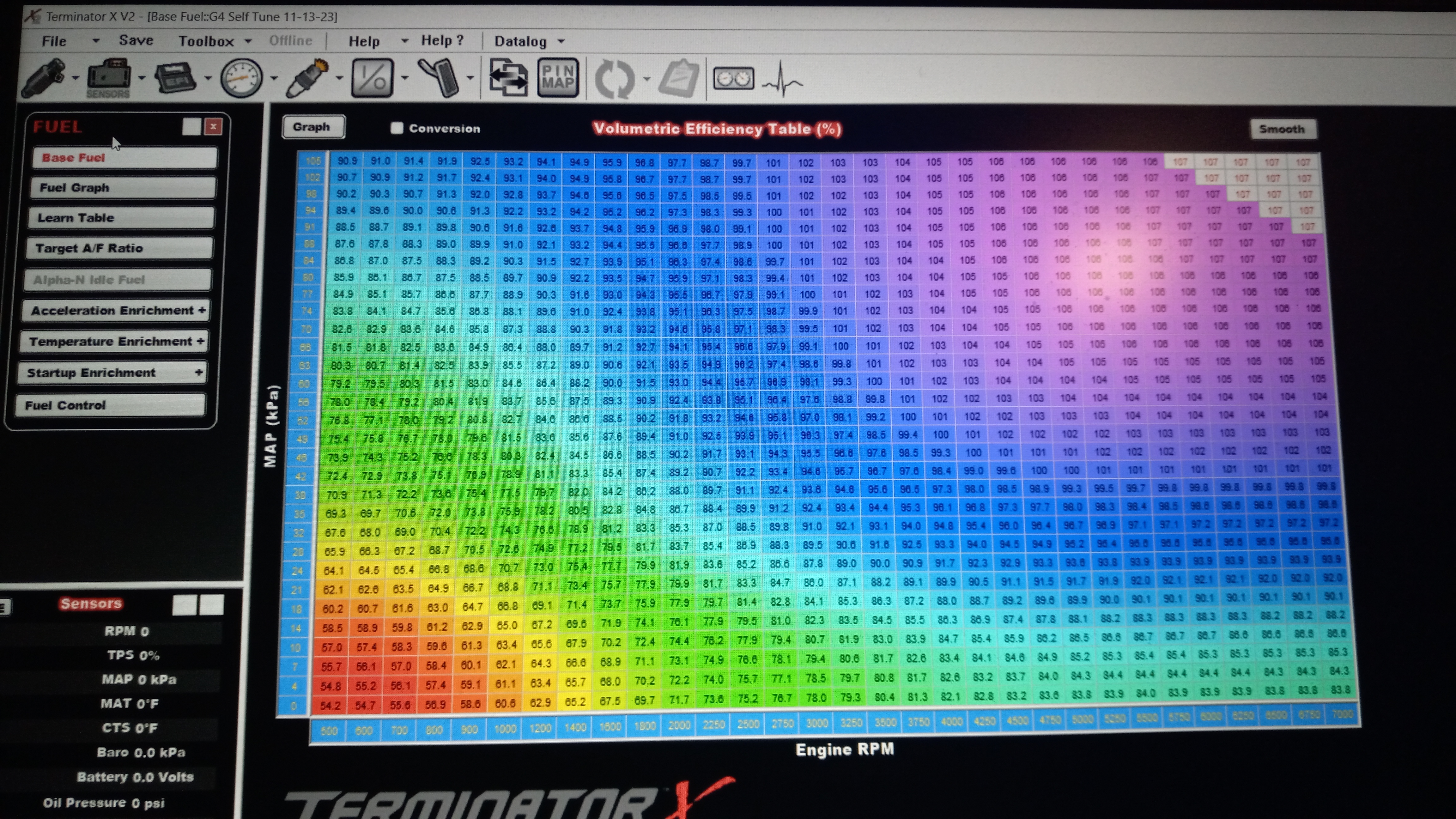

And playing big pretend tooner guy again. went in and changed some stuff. (changed the compensation numbers down from 50 to 20 for closed loop and down to 30 for learn, and a couple other things)
Seems like the Holley "autotune" still has a ways to go? Weird spike too. Wish I knew what I was looking at! hahaha. It seems the self learn was higher than 30 though.... so this will be interesting. I really want to go get some new injectors that are on drop down list, and get it tuned by a pro. But, also want to drive it like ASAP in dirt.

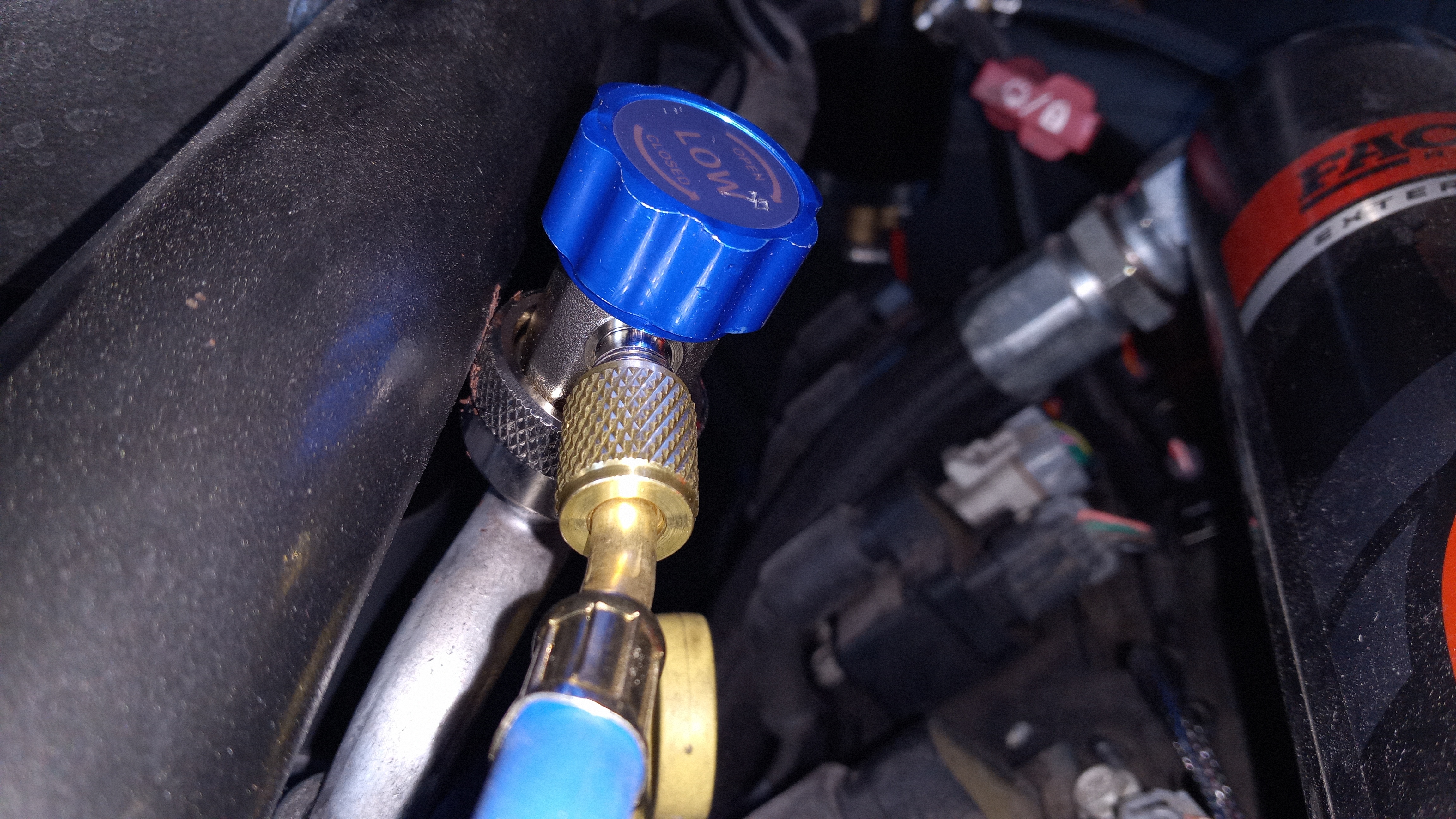

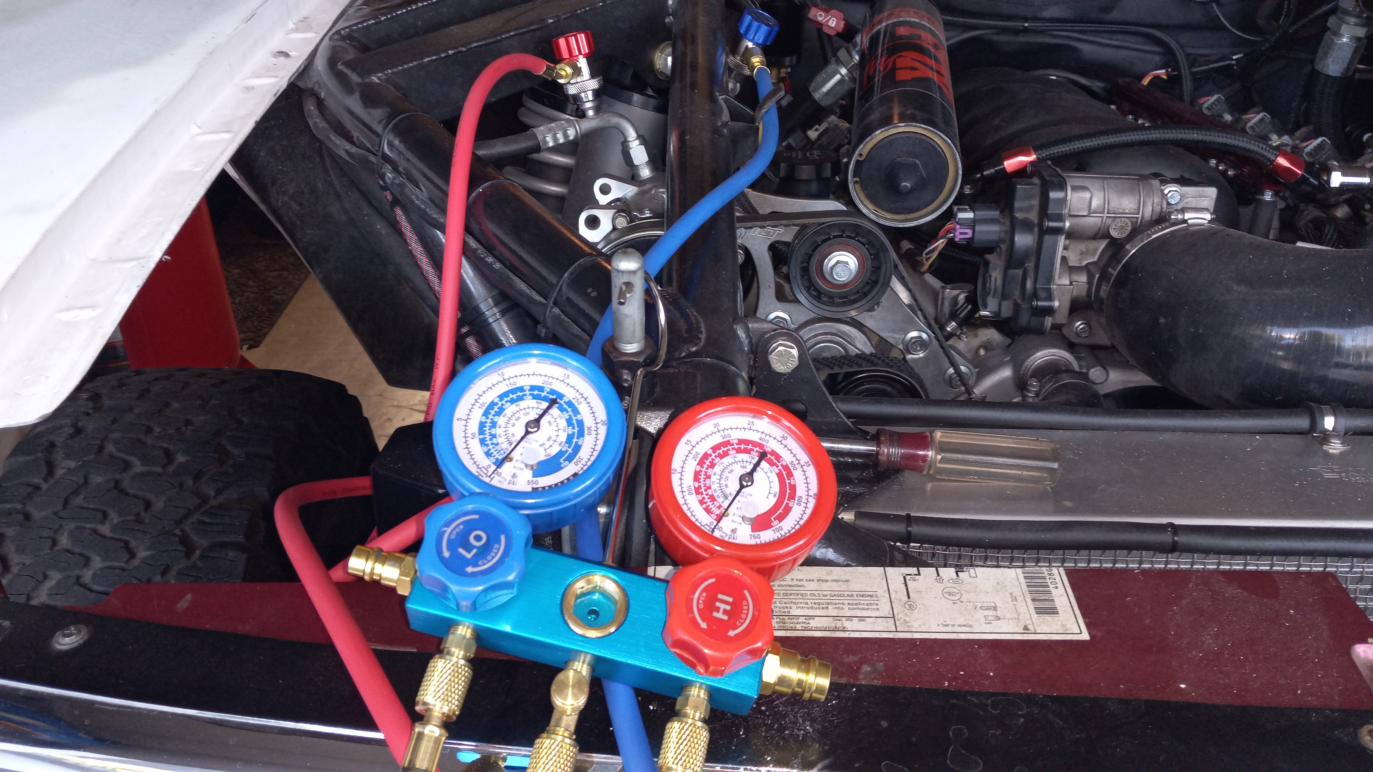

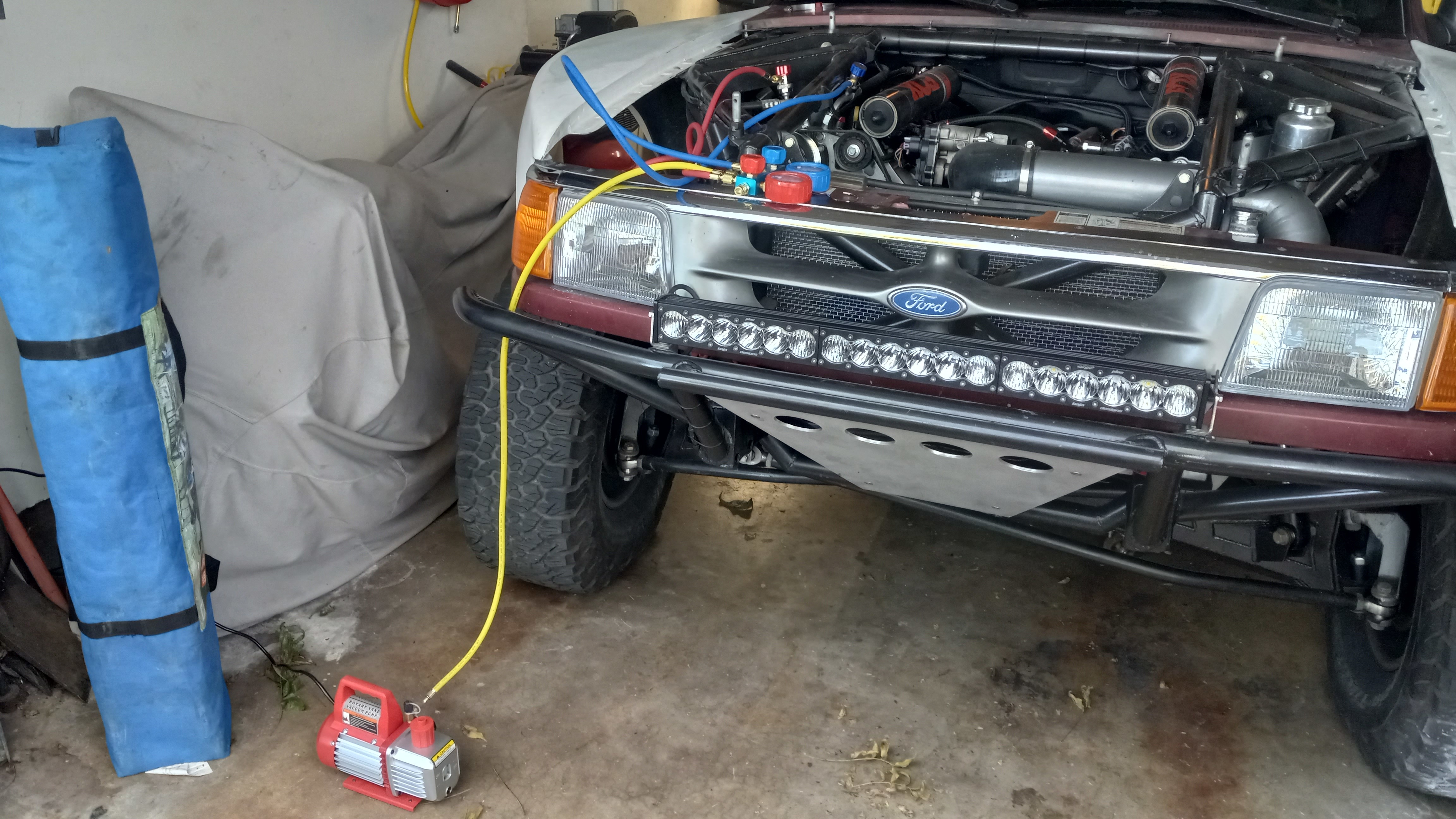

Went ahead and took a shot at charging the AC. Total rookie here, so probably didnt do best job.
Restomod claimed 24oz refridgerant for all systems... and I only got 12oz in there. I dont see how all systems could require the same as they would have different volumes??
Tell you what. Barely got the low pressure fitting on!
BUT>>> I did manage it to blow some colder air. Not sure if it's as cold as it should be.... might try again later. Certainly already better than no AC.

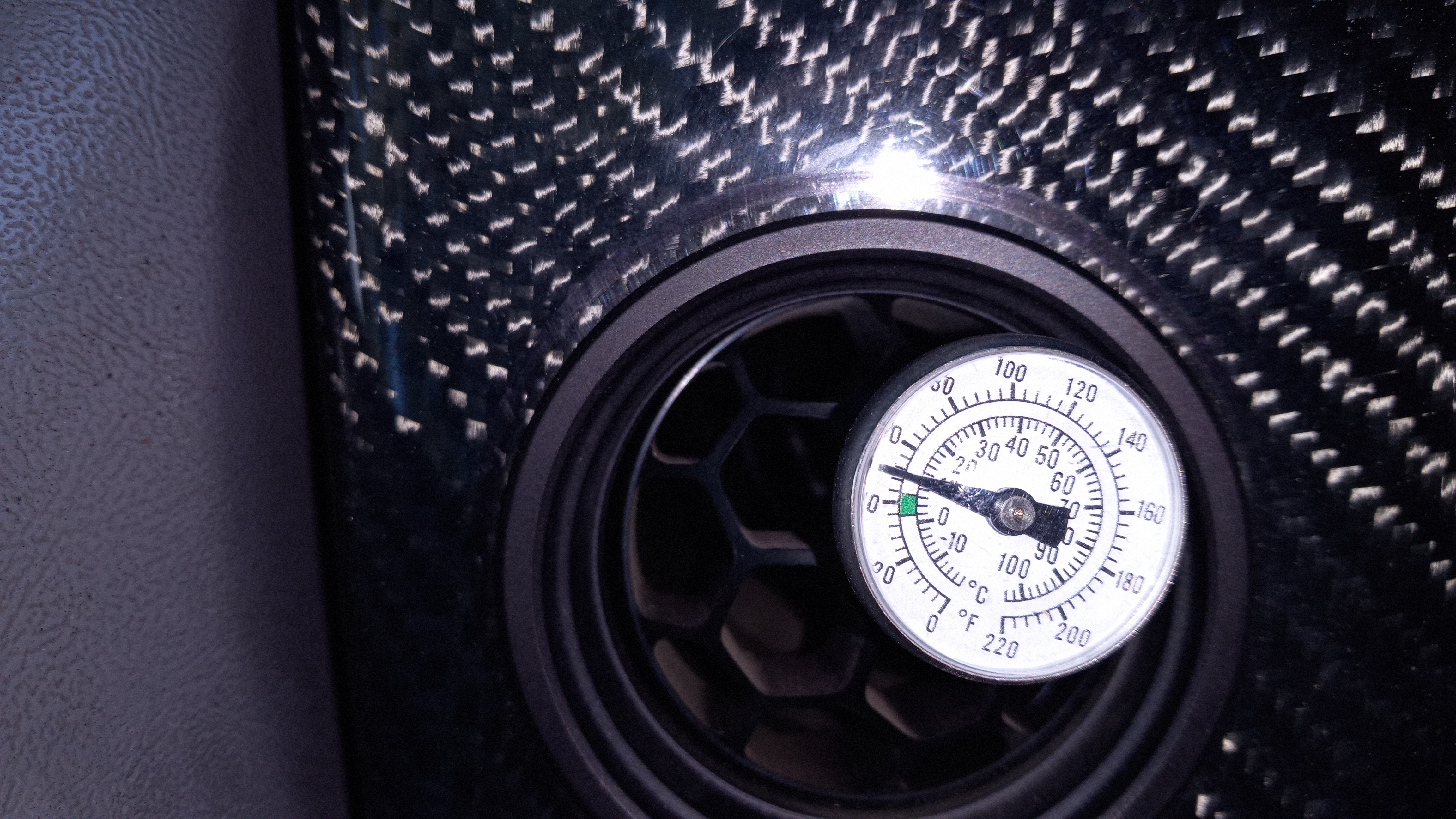

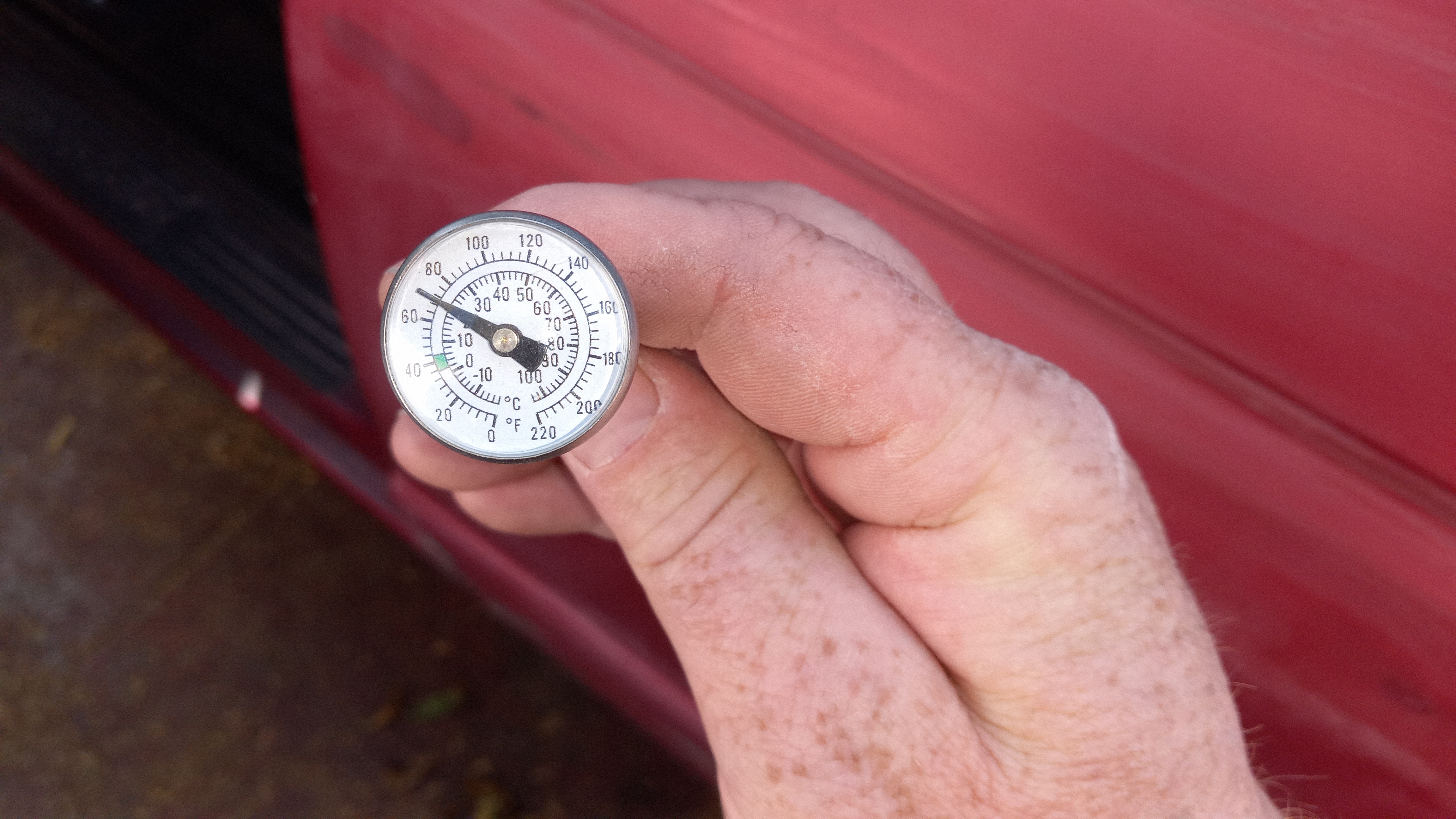

Garage temp, which was waay less than outside temp where truck was in Sun. Think it was in 80's
Here is the air blowing at idle sitting still in full sun. Feel like this should be way colder, no? But, it still felt cold.. and was over a 30 degree difference from ambient I think

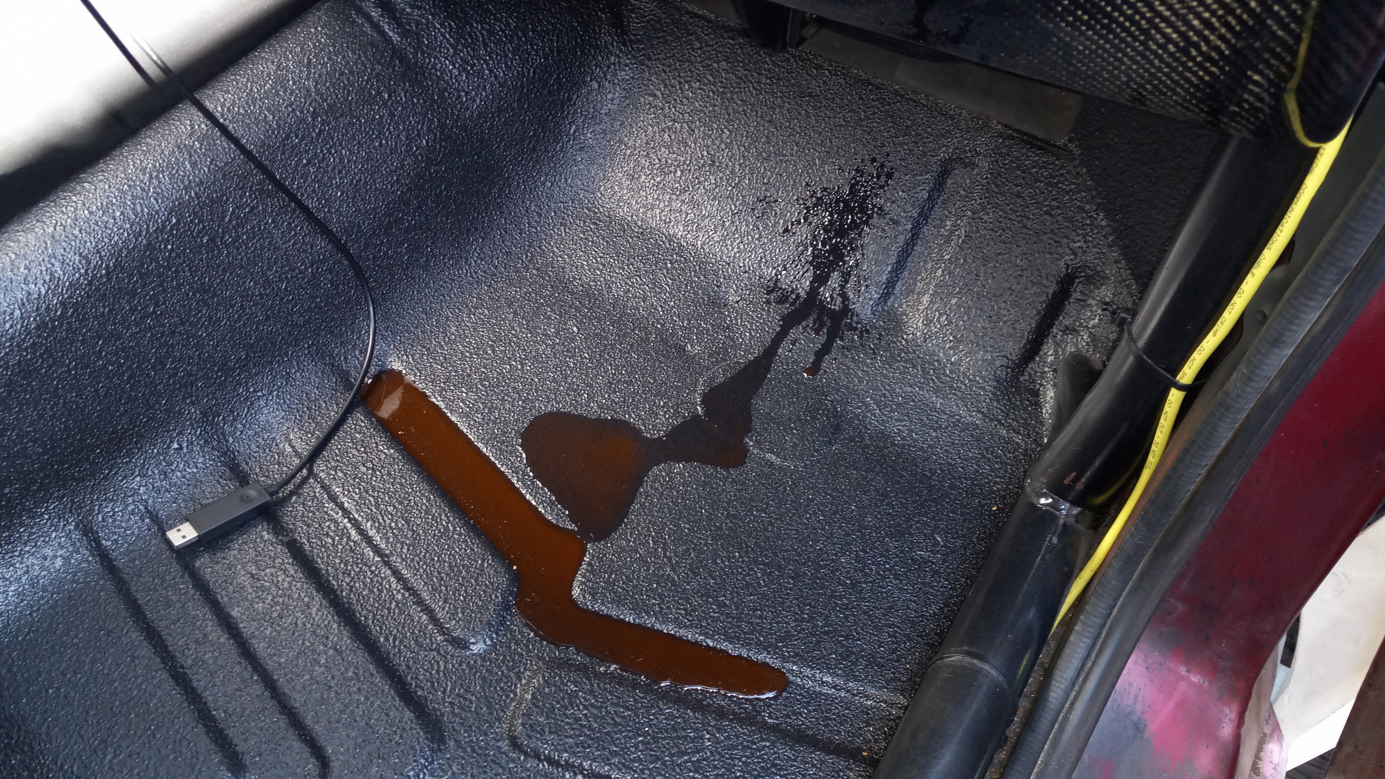

However, not so confident in this AC evap box from Restomod though. I have had it randomly leak twice now. Doesnt seem to come from my fittings either... so a bit baffled. Seems to come from box itself. Maybe it is me doing something wrong, but I was pretty diligent. I will double check the water valve.
But, I ran it after cleaning up the spill again... and went through all cycles slowly... no problems. Hmm.
Hopefully the restomod setup works good for you since I have the same setup for my ford.
god damn thing is leaking. i stuck my cell phone light up in there. Looks like it may indeed be one of the heater lines(and not the unit). Son of a bitch. That requires dash removal, which requires center console removal. total shit show. ordered a heater core bypass hose for now. gonna go test it first. That would still be better than the units internal heater coil being bad though. haha
Oh, and stuck new 36lb Holley Injectors in it too. I know for sure the injector info in table should be correct now. And no way I should run out of injector now either. Still seems to be pulling a lot of fuel out at idle.

I did get the new 36lb injectors in. They flow around 42lb at 58 PSI. I did a couple test blasts from 0-55 ish mph 1st gear redlines while data logging. (i had done this with old injectors too) Pretty sure I was maxxing out the OG LS6 injectors, or at least hitting a really high duty cycle above 5k rpms. Data showed I was flowing 260lb/hr at highest point now. Which is about 30lb higher than the theoretical max of the old injectors at 58psi. Add in the fact the fuel pressure actually drops as low as 55psi ... they were probably falling short. But, maybe this tune is waay rich and I don't need that much? target AF is like 12.5 at WOT
