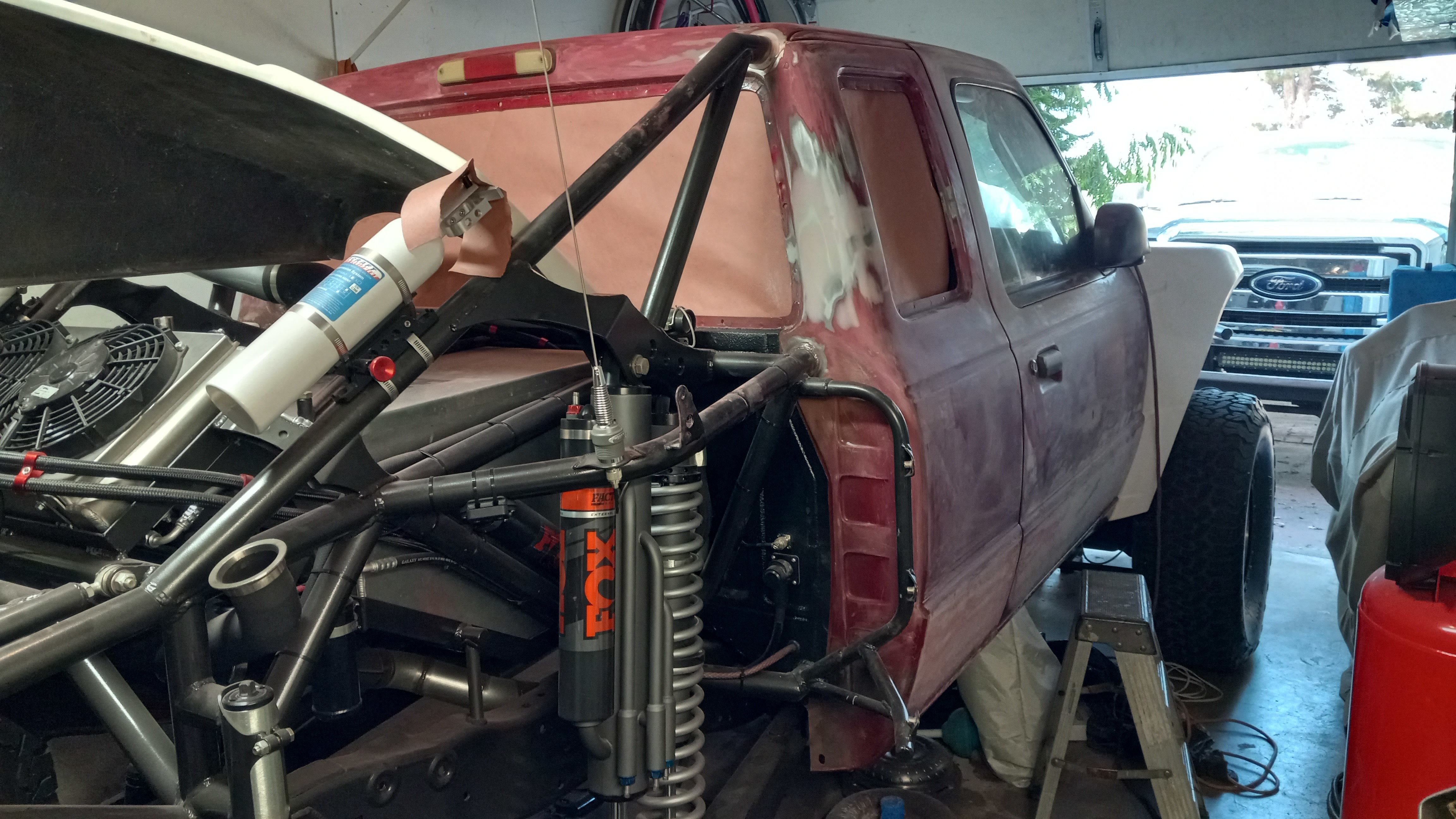

I could be completely wrong as its been a minute but Im pretty sure thats how iribe wants people to set up kings. zero preload on the top preload adjuster at droop,, and then set ride height (assuming its sprung correctly) with the secondary adjusters?
Not sure what the fox setup is, but i assume close?
