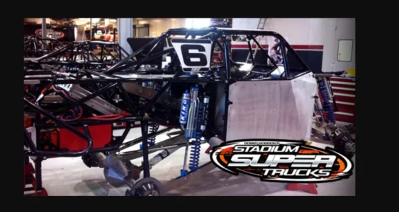

Do Robby's SST's have two sets of calipers? I couldnt find any pics. They seem to work good ... on the street at least. lol
kibbe put 2 sets of calipers on my fraptor. although when i got it the hoon calipers had twisted mounts, so i pulled them all off.
From what I can tell its a single caliper rear setup just based off brakelines on the housing. I cant find a good photo with a rear wheel off of one of these anywhere haha.
^ I couldn't either. I tried to find the pics of when one ripped it's wheel off and did donuts to the line to finish
and damn that brake line is hideous. LOL

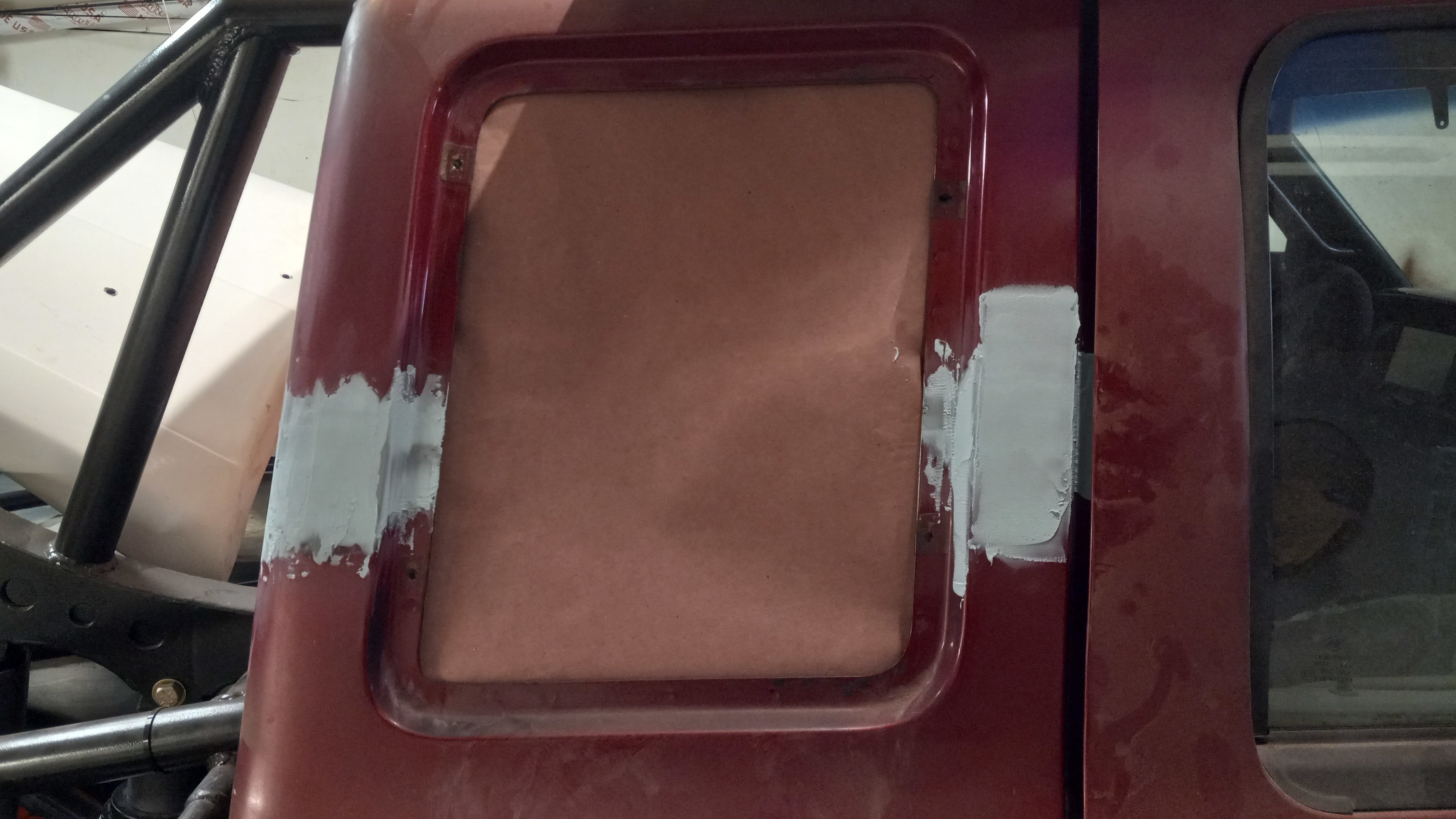

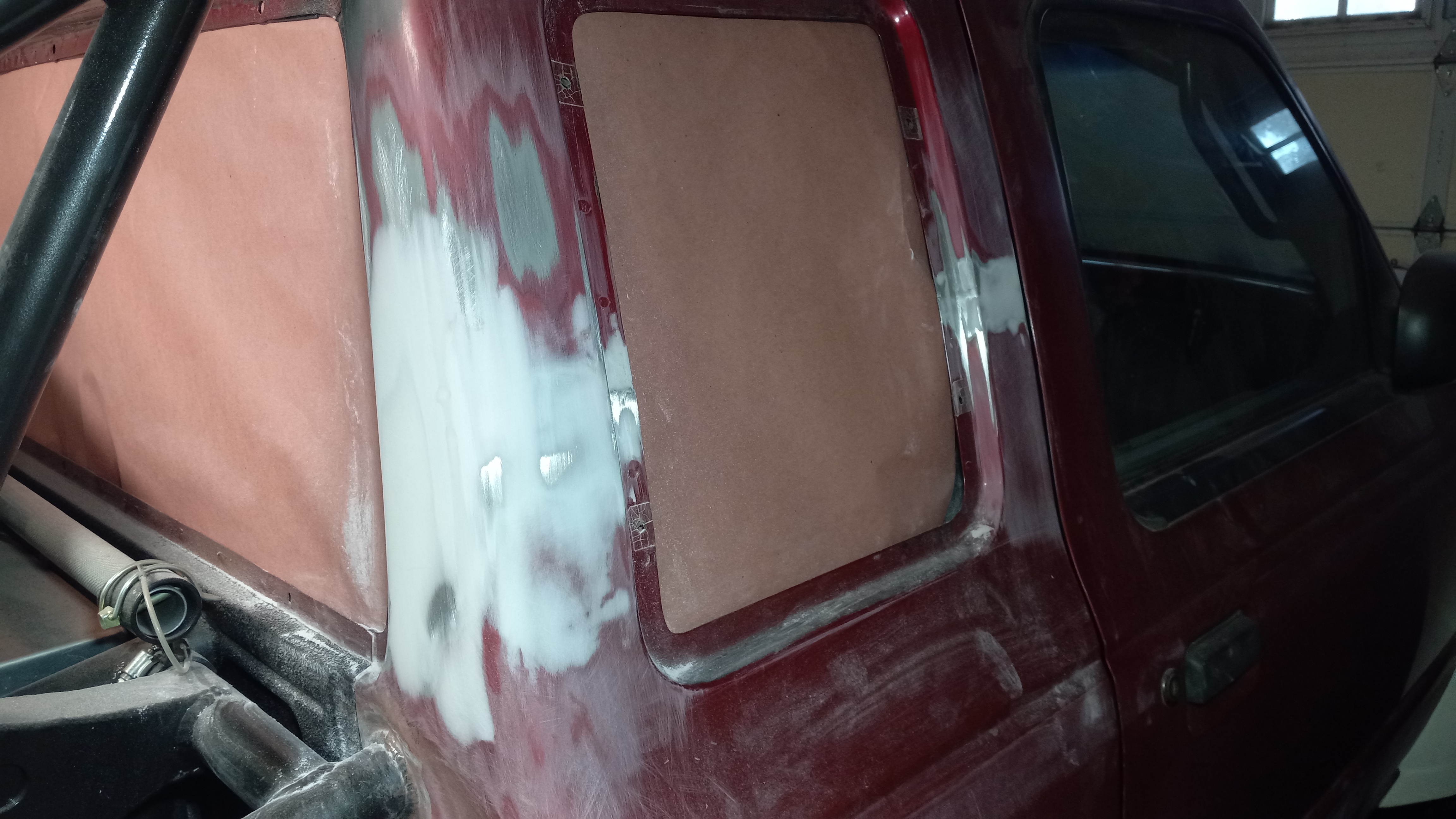

I still suck at this body work stuff and don't care for it... but just gonna keep on truckin.
