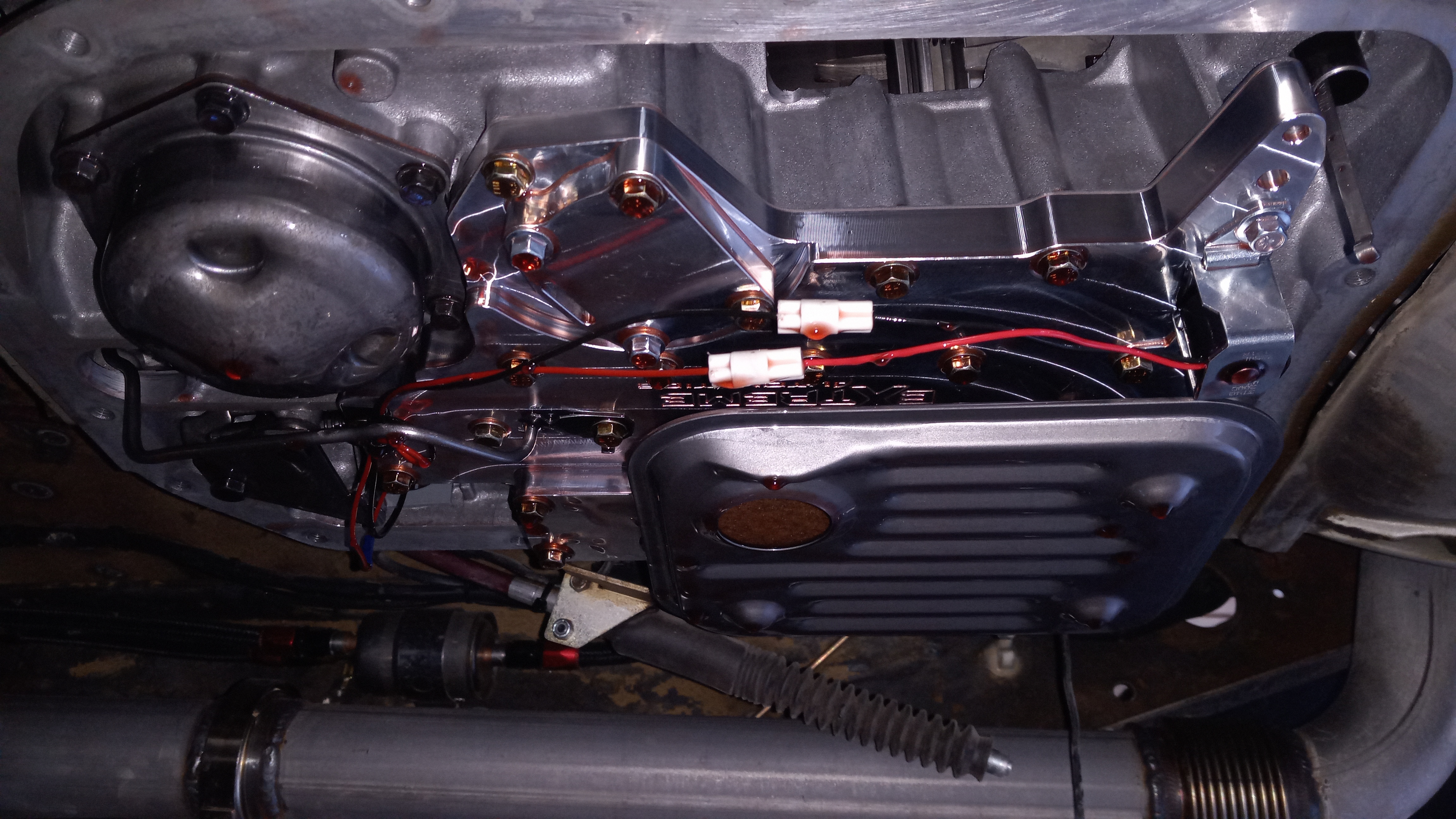

finally got to see the new billet manual valve body...
Seems the dipstick level is off? I have read that the oil level should match with the pan/case when hot/full. These marks were much lower than that. This is factory dipstick too... but I read online that it's not uncommon to be off .5"!? I went ahead and center punched the dispstick level with case. So, I have another reference point

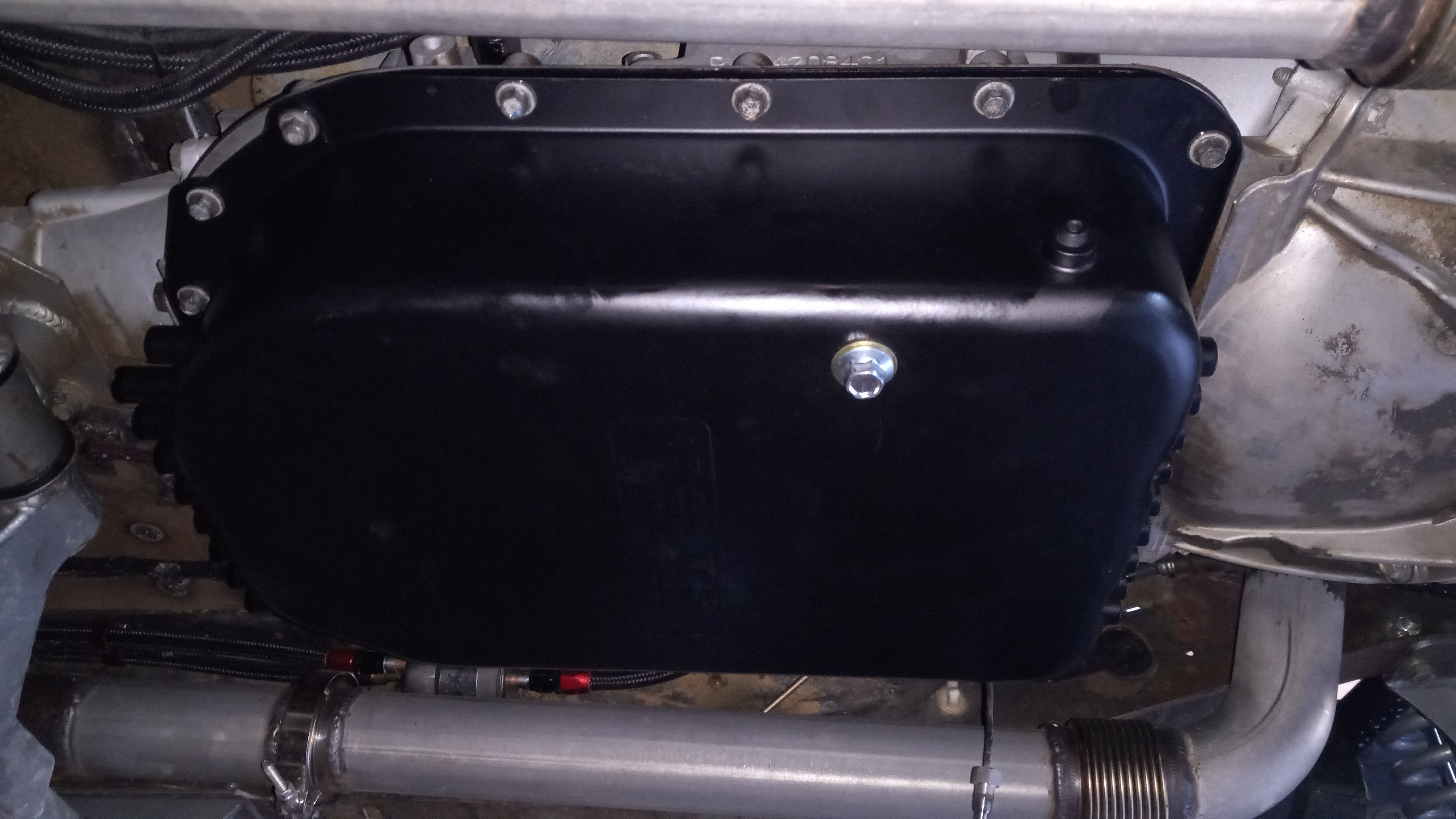

And here is the new pan with TURBULATOR! I hope my temp sensor wiring will reach over to other side of trans... will check that today. If not, that will suck and require some fixin
let use know how that works. like others have said, it will most likely get lots of debris stuck in there and over time cause more heat. i looked into those while battling trans heat.
I figure a pressure washer and some compressed air should keep it clean. Worst case... maybe some pipe cleaners or wire? I try to avoid mud like the plague though. I hate cleaning that shit off!!

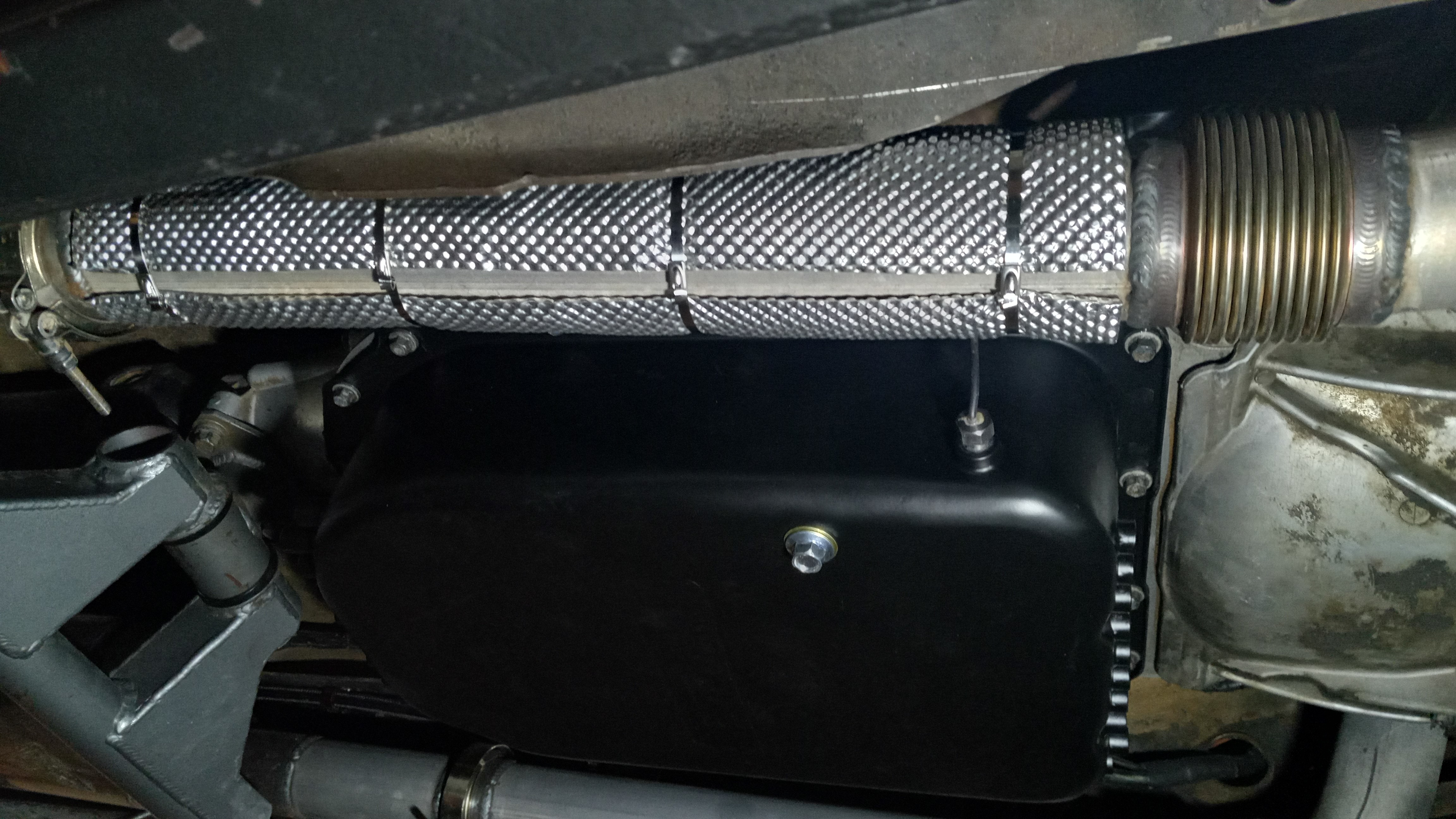

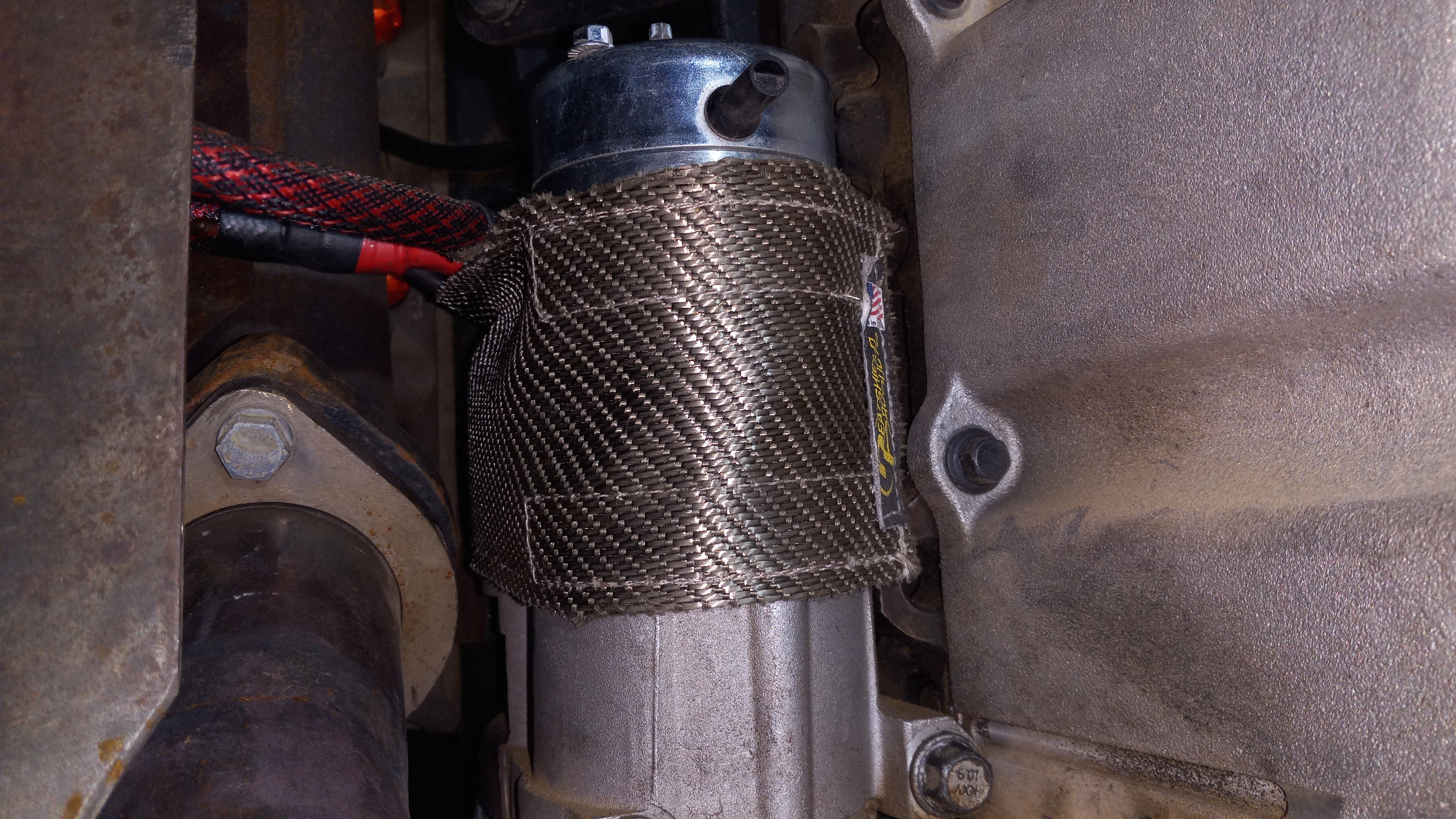

Trans sensor just reached perfectly. Added the Heat Shields lava protector to the starter. I have been worrried it's getting cooked since day 1. The wires to it.... I noticed the heat shrink glue had dripped down. So it's definitely getting warm. Bought some amazon special velcro heat shield to try out for those wires.

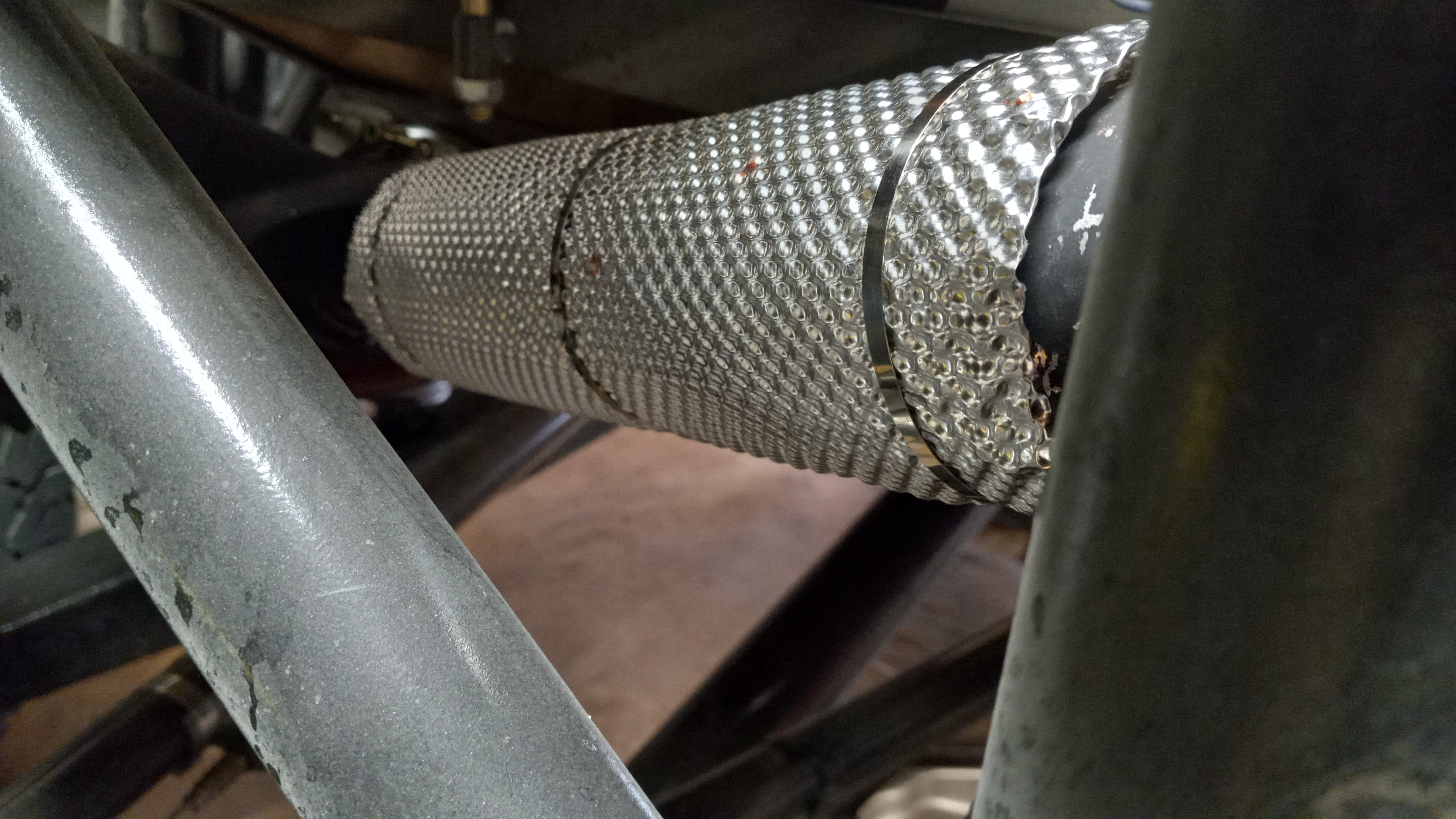

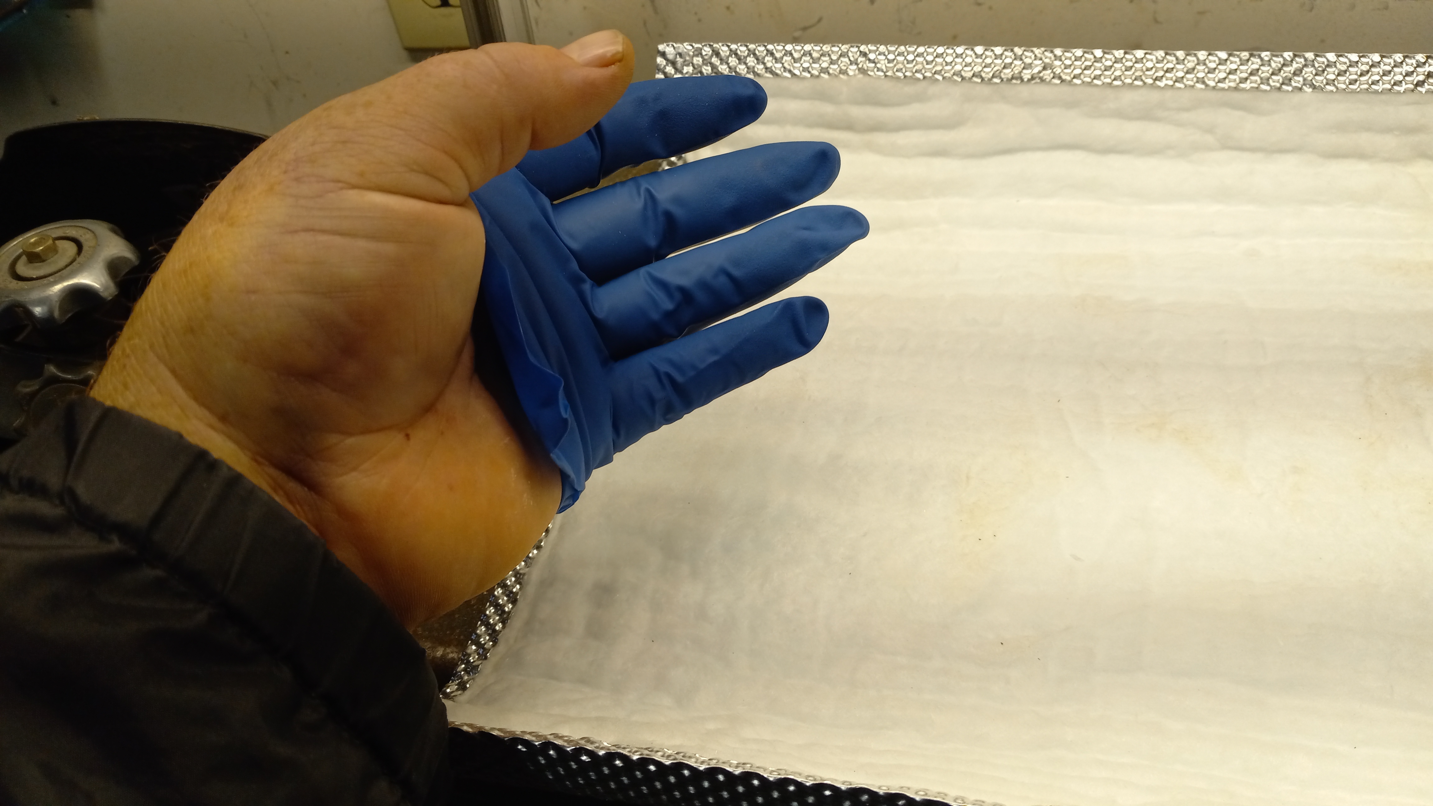

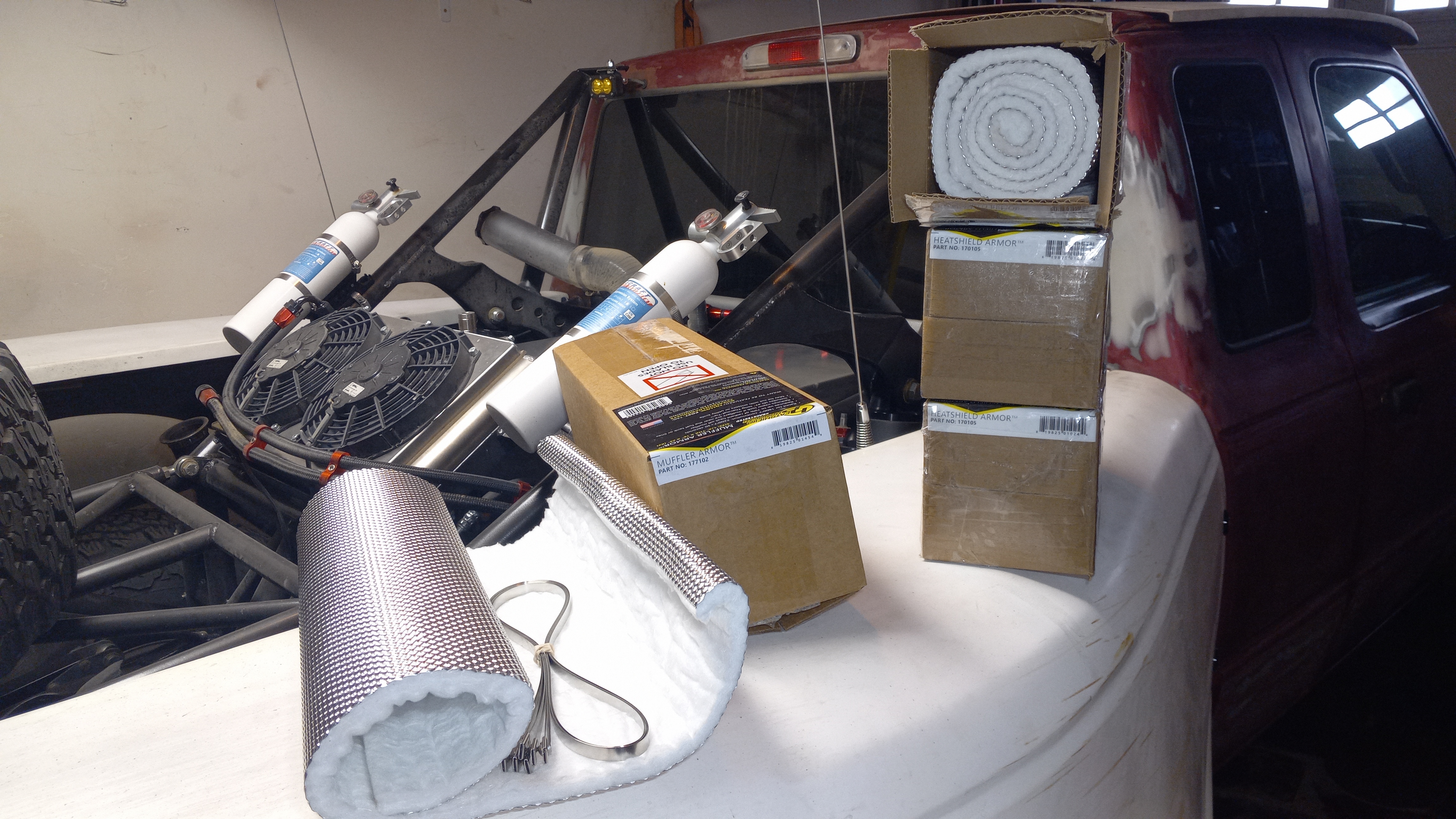

Also spent BOOKOO bucks buying the legit Heat Shield products for exhaust... got it all now... gonna start installing it here today I hope. That shit looks like it won't like mud either. haha
Plan is to cover the whole exhaust really. With "air gaps" they recommend facing down. I imagine it should drop heat on the floor quite a bit. I will fully wrap it at the ends by trans cooler without the air gap, because I doubt it would get too hot for metal back there.

So, been putting this shit on.

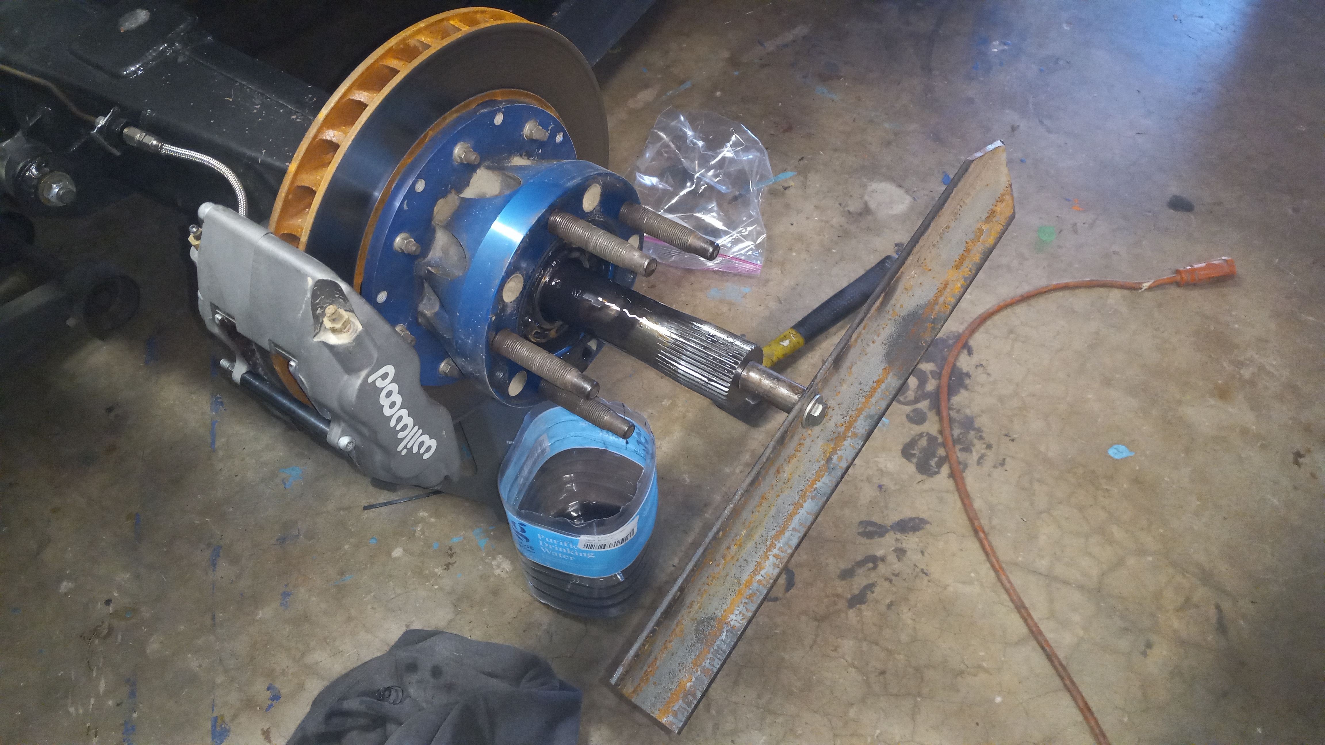

Go in for surgery tomorrow on my left thumb. Even with good hands...this wouldnt have come out by hand. Had to make a tool and smack this one out. Remember way back... one axehole has always been tight. Probably this one.
my bitch ass left hand meant I had to get creative...

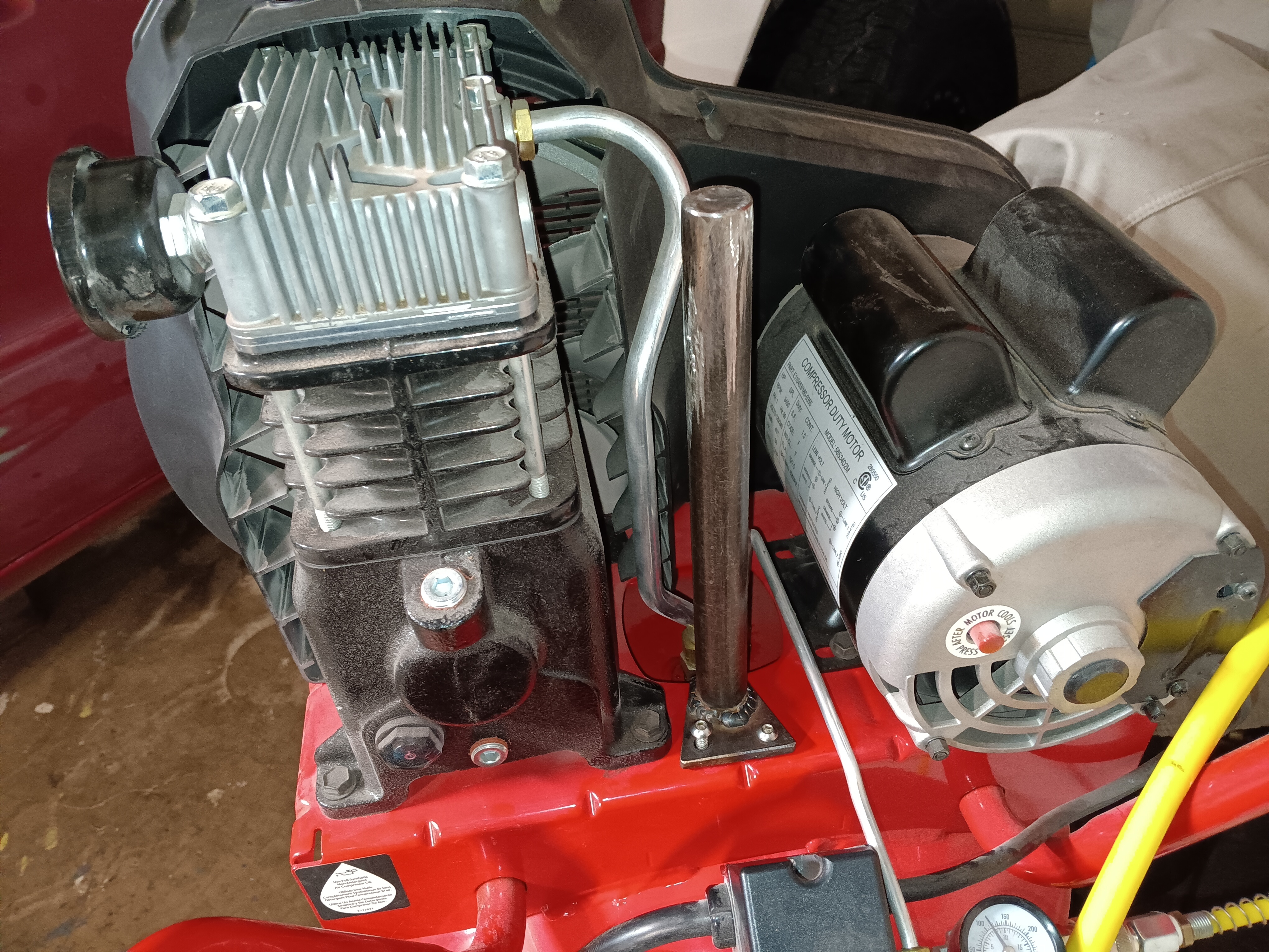

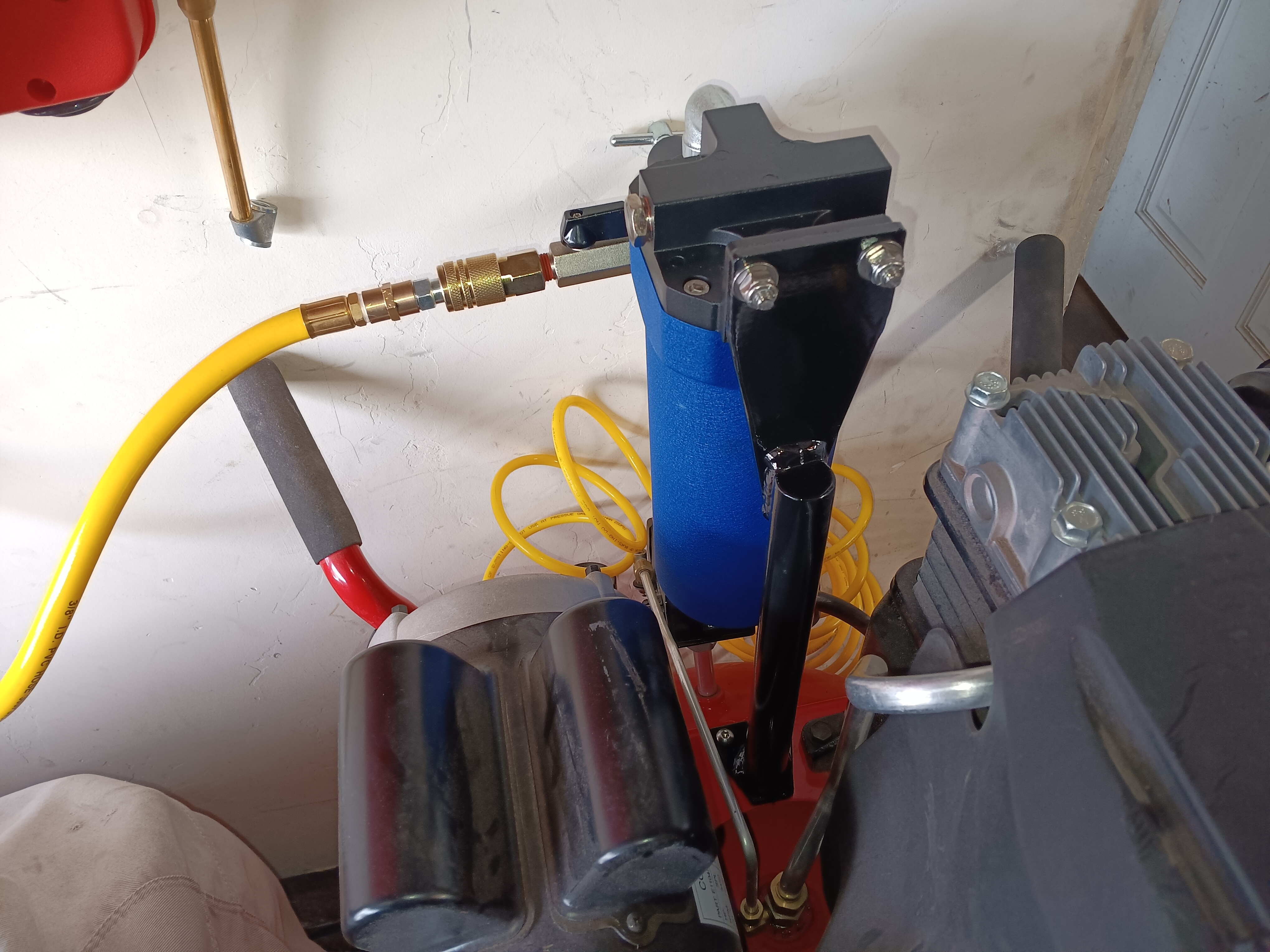

speaking of prep. Had to get a filter separator for tank. Figured I might as well fab a custom mount so it's mobile too.

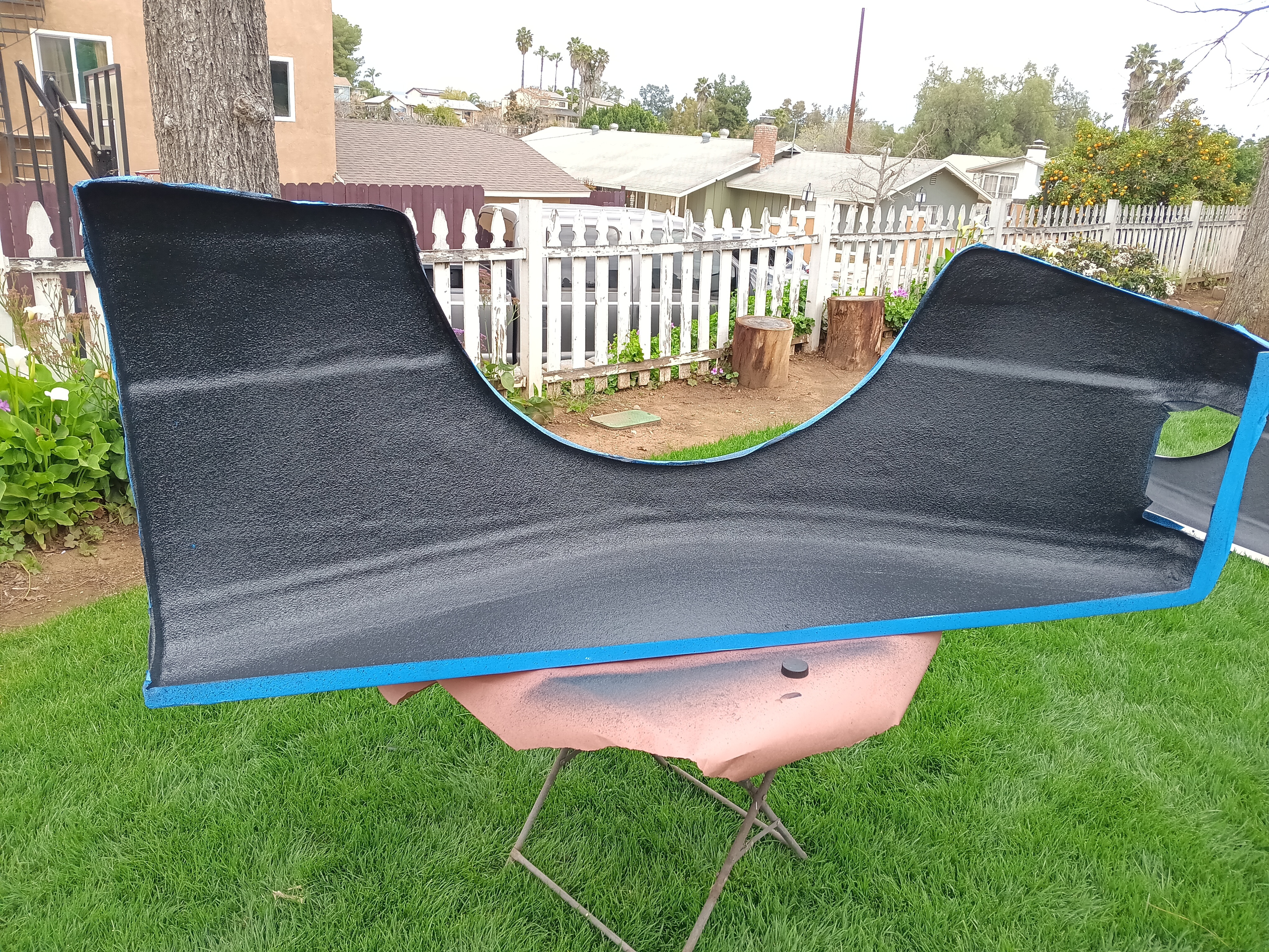

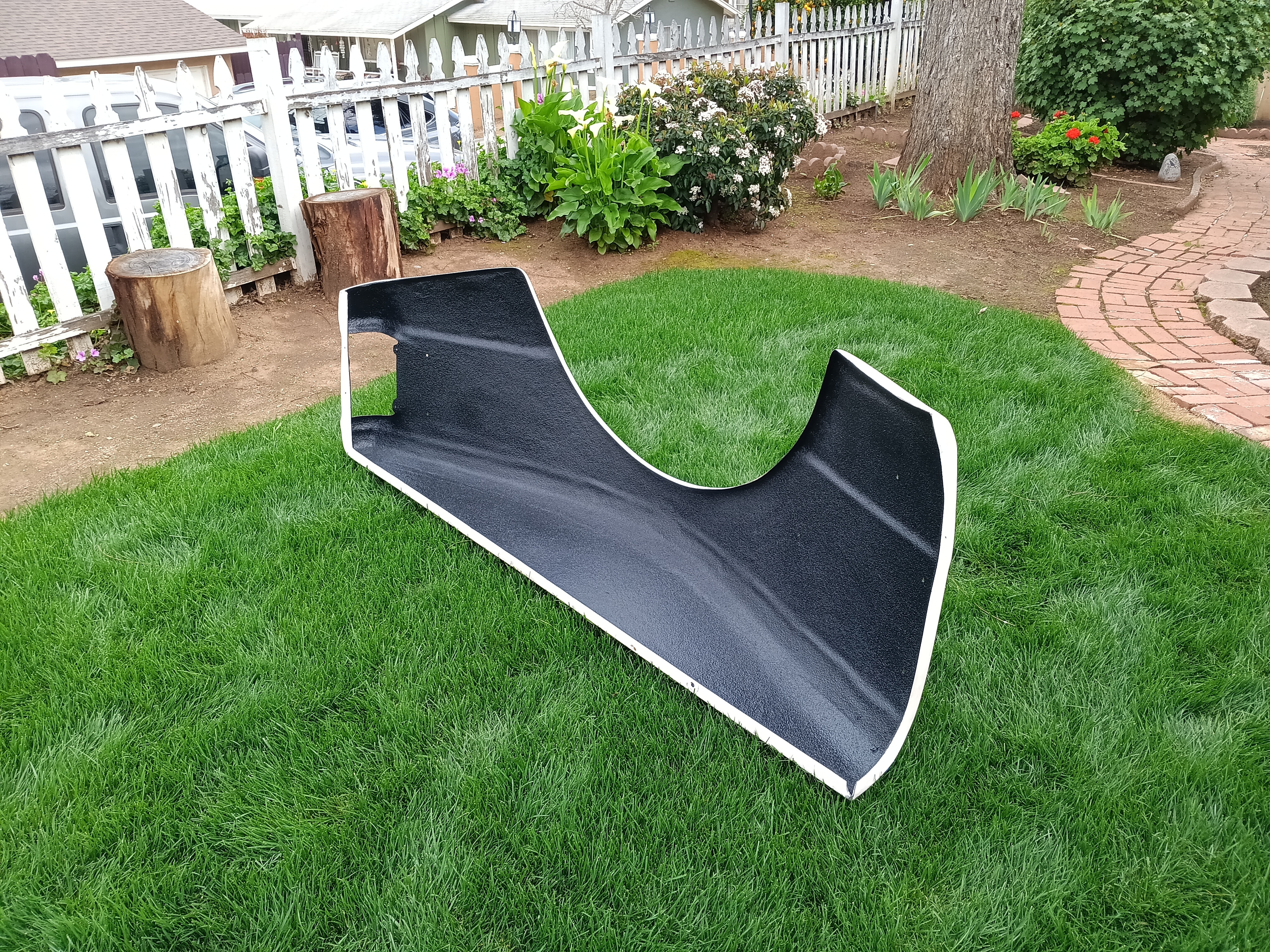

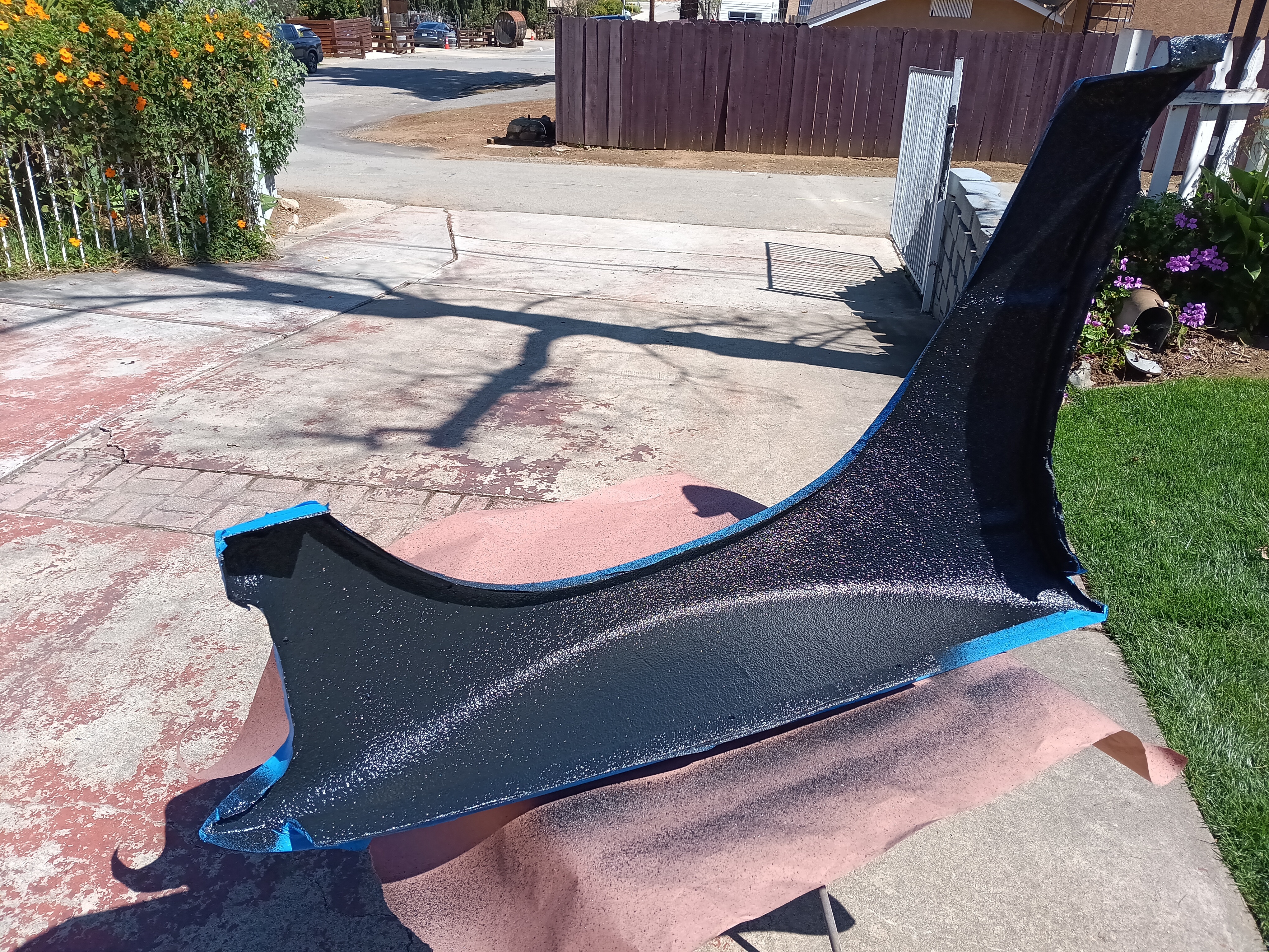

aaaaannd sprayed the raptor liner on inside of fenders and bedsides... hoping this will cut down on the rock chips I get from underside through glass and through paint.
