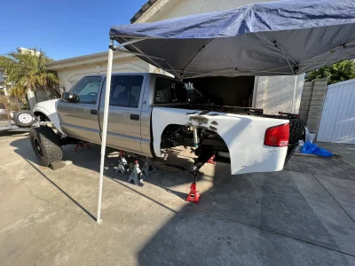

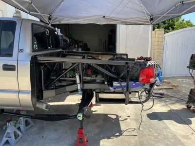

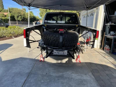

Got the third member in today and spent the day filling holes in the fiberglass and fitting the lights.

pointed out so far from the kick you can barely see them from the back. lmao

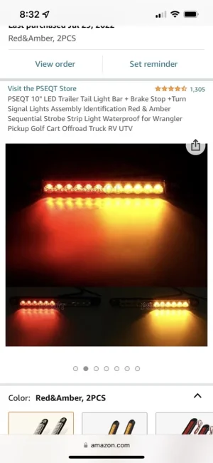

Actually, you got me thinking about it more and more. For safety reasons (I’m a nerd who ALWAYS uses his turn signal), I just ordered these
Just to give me some peace of mind and not to be hassled if the 5-0 are cruising behind me.

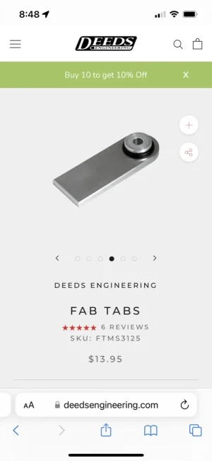

Anyways, I picked up the driveshaft in Ventura on Thursday, but they set it up with the slip yoke for a 2wd truck, which is smaller diameter. My dad works in Ventura so he brought it back yesterday and they swapped it out with the correct piece. Spent yesterday doing a lot of hub work. Tightened the fronts, assembled the rears and filled it with fluid. Put some coils from my small stash on the shocks and threw them on. I also mounted the exhaust with three fab tabs from Deeds Engineering. I saw SMP fab use their products, so I looked them up and they’re here in good ol’ Moorpark! Extremely nice father/son duo with great products at a good price. They do a lot of Motorsport machining and even had Armada Racing parts in being machined. I’ll definitely be giving them my business again!

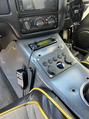

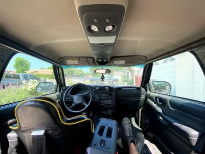

While waiting, I changed the pins and bushings in my driver door and installed the race radio and antennae. Gonna cut out a vanity plate to trim around the radio, so don’t worry about that hack job. I removed the diode in the radio so I can now transmit and receive on the usual 15x.xxx stations we use

Do you have a picture of your center console without the panels on it? I want to build one for my truck and would like some ideas of how others build the frame work.
It’s just 1” tube I bent to whatever degrees I thought would look god. Literally no math or measurements or anything. Just welded straight to the cage.
