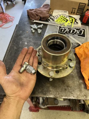

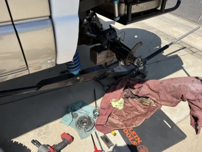

In Moorpark? I brought my blazer to them 6 or 7 years ago and wasn’t impressed. I just messed with the toe a bit more today but have yet to drive it and see if the wheel is straight. Also put a new serpentine belt on, and had to remove the rear hub to fix a sheared stud. Took the wife and bunny to my parents to get it all done this morning. I need to add more preload to raise the ride height, but should probably just go to 350lb lower springs.

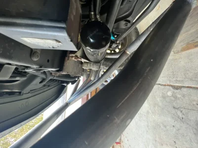

Well, spent saturday getting to the intake manifold to replace the gaskets. Got to the lower intake manifold and they had siliconed it on, and I couldn't find a good spot to wedge it off. I saw some leaking near the driver valve cover gasket, so I figured maybe that's the culprit of the leak. New gaskets, left the lower manifold alone, and reassembled everything with an upgraded spider injector assembly. Pretty dumb of me, because it's still leaking from the lower manifold. Oh well, at least now I can do the job quicker haha. Anyways, the new injector assembly made such a huge difference! The truck starts way better since it's not leaking fuel into the cylinders while sitting. It also revs MUCH nicer. It would vibrate really badly at 3500 and higher. Now it's smooth all the way to 4500+, so it's still a win for me.
Anyways, it's also leaking from the timing cover and oil pan. Normally you have to pull the engines to do the oil pan gasket to clear the crossmember, but I don't have that issue with the frame grafting, so it should go pretty easily. I'll do those at the next oil change.

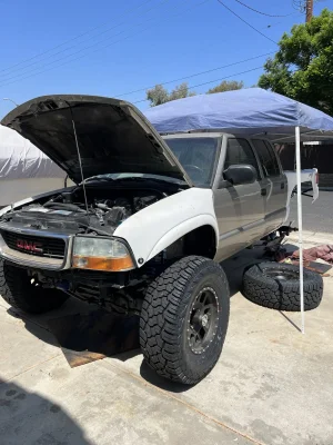

Raised the ride height a bit by cranking the preload a little. I think it’s pretty much perfect now. I need to adjust the toe a bit now, but it’s really good overall.

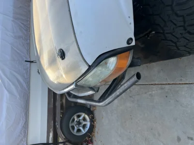

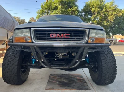

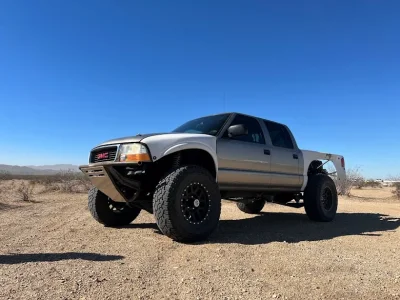

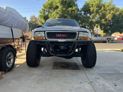

After the brake line, I got started on the bumper. I’m liking how it’s turning out so far. Going to cut holes in the skid for más airflow, and figure out how to get the yellow of the lenses and I’m tinting them orange instead.
looks like poopydoodoo
but seriously, I really like the base look of it. is that 1 3/4"? from the pikkkkkk the tubing looks like it could be 2", which would be badass just for the fact that "you're running 2" on an S10". haha. even though it feels like i shouldn't say anything positive about something Bodgjesusters built or bodgj's BFF (God) knows that i shouldn't say anything positive about an S10.......

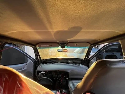

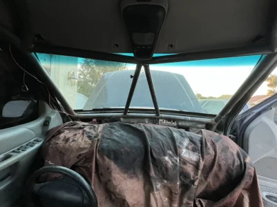

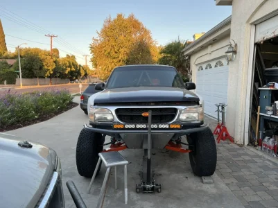

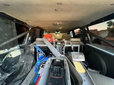

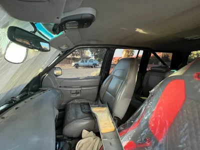

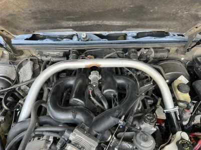

Still working on the rollcage. Got the dash tube welded in place, windshield A tubes in, and tubes through the firewall to the engine cage crossbrace mostly welded in place. Marshall cracked the windshield removing the rear view mirror, so it’ll get a new windshield and I’ll finish welding everything when it’s pulled out. Also got the holes in the floor patched up and mostly seam sealed. Just waiting on another tube of it to finish up. I cut the floor tubes connecting the A and B pillars, and tomorrow I’m getting 1.5” tube to run across so I can make the seat mounts. Then the x behind the seats, door bars, and off she goes.
Also got a couple more tubes in on my bumper.

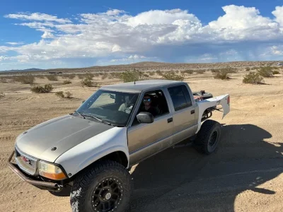

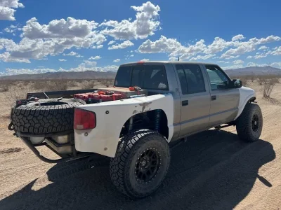

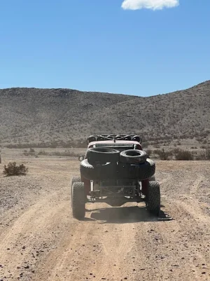

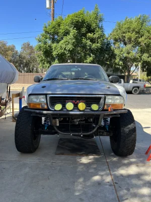

What a weekend. Knocked the skidplate out on Thursday after work and started packing up our apartment after. Worked Friday, quick nut n bolt check on the Sonoma, and got the keys to our house. Woke up bright eyed and bushy tailed and cruised to the Clean Dezert event for the maiden voyage of the Sonoma. Truck is freaking awesome! Drove there with AC and cruise control on at 70-80 the whole way (65 up the big hills lol) and averaged around 12mpg, so not bad at all. Got to the cleanup, talked with people for a little, and then went to find some trash. Mark A L(?) marked a tire pit and we figured we'd go snag some tires and head back. Well, the tire pit ended up being like 12ft deep just to get to the tires. So I hopped in and others dangled their tie downs for me to hook to the tires and they dragged them out. Well, NINETEEN TIRES later, and my lungs were coated in dirt and we couldn't fit anymore tires on the trucks! There were still at least 4 tires still in the pit when we left, but we just didn't have the room. Strapped them on the trucks and turtled our way back. Had a great time at the taco/hot dog buffet, chatting with people, looking at trucks, and my wife winning some swag at the raffle. After everything died down I was itching to drive, so Patrick (Ghan Racing), Chelsea and I took off for a short loop. We only did 7 miles, but it was so much fun. Chelsea started getting nervous when we were going 45-50 through some rougher stuff, so I had Patrick lead and we slowed down and cruised. Being her first time in an offroad truck she did really great, and I didn't want to push it by either overdoing it with her, or putting more dirt miles on and breaking something. I hate driving home into the sunset and we were moving into our house the next day, so we called it a successful trip and we parted ways when we got back to outlet center drive, around 3:30pm. We stopped at a weird little chachki shop in Little Rock on the way home and grabbed a milkshake. Made it home safely, with no truck issues, around 7pm. It was an awesome feeling, pulling into the driveway of MY house, in MY built truck, with MY wife next to me. Crazy how much life has changed in the last year!
Overall, the truck is killer. I'm not going to do any valving changes as it feels super spot on, but I think I may swap springs around to get a little more ride height in the front and more bottoming resistance. Realistically, for everywhere except Barstow, I wouldn't change a single thing. The front passenger FOA bump lost nitrogen so it wouldn't extend all the way out and was pretty useless, so I need to rebuild that. Eventually I'd like to do swingset steering and get rid of some bumpsteer and deflection, but stock extended is working great for now.
