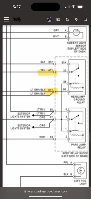

Check for battery voltage at these spots with the headlamp switch on. No voltage the BCM is the problem. No power at the yellow wire there is a short or open before the relay.IMG_1733.jpegIMG_1734.jpeg

Not a bad idea. Just about the only thing I haven’t replaced at this point
Been struggling with non-working headlights. Spent quite a while with the Fablab and Jesse to find the root cause, to no avail. Jesse ended up adding it's own relay triggered from the oem headlamp switch, so it works like oem, which is good enough for me.

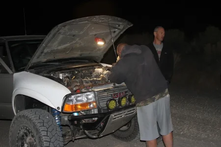

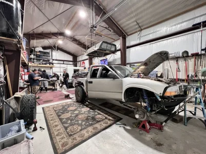

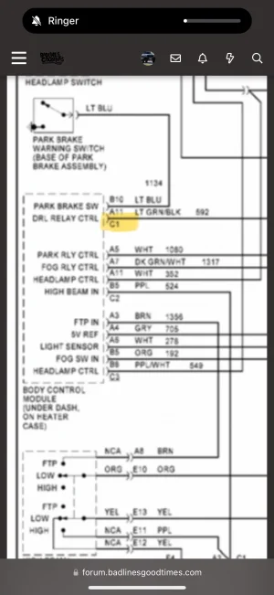

Beautiful scenery abounded, along with many laughs at certain member's dating preferences, and it was just an awesome time overall. Hit a cool jump 3/4 throttle in first gear and sent 'er a bit hard. Landed hard passenger front, causing me to lose headlights (eff). Kept jumping a bit more and then we decided to head back to Dusty's house. Hit a cattle grate at 50-60mph and the jolt caused me to lose all power. Spent a while trying to find the cause, but no dice. Towed home 9 miles, running over the strap the last 500 feet, ripping my passenger soft brake line off. Got it into Dusty's shop and had pizza and beer while repairing the brake line (thanks Turbo!), and finding my ECU mount had broken, letting it flop around. I found a schematic and Rouse determined it was ECM B that was most likely popped. Simultaneously, Patrick had been testing all fuses, only to find that one was popped - ECM B. A new 20amp fuse and it roared to life.

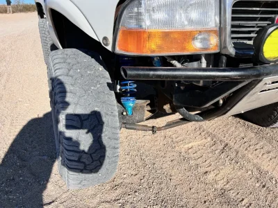

Didn’t have a ton of time the past couple of weeks to spend much time on the truck and prepping the camper. Made a quick fix to my slightly bowed tie rod by clamping a 1” DOM tube to the backside and welding it together. Ended up being a pretty solid fix! (Or so I thought… ominous foreshadowing). Added another inch or so of preload to the rear coils, and lowered the coil slider stops to where they’d actually engage. I never messed with them, and figured it would help with some bottoming resistance while towing. Also, added another set of limit straps with a higher bolt hole to limit droop while towing.

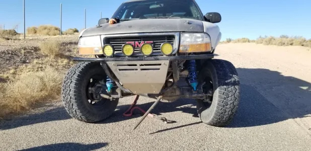

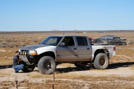

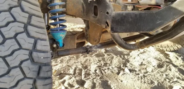

Bryan Benton, who I haven’t seen since the old Cal City DR trips some 10+ years ago, hopped in passenger seat, and @Potter147 got in the back with his camera. We stopped at a really fun downhill whoop section and dropped Potter off for pictures. Must have done 5 or 6 fast passes and the truck was feeling AWESOME. Way more bottoming resistance in the low speed compression stuff, and I was reallyyyy able to push the truck harder and harder. I was having so much fun that I entirely forgot about the tie rod I was supposed to be nursing. I told myself one last pass so I could get back to my wife at camp. Welp, I went a bit faster than before to double into the whoop section and felt my steering get super wonky after landing. I slowly bright the truck to a stop since I figured I bent the tie rod pretty badly. I didn’t want to slam on the brakes for fear of bending it even more.
We used a strap connected to the other truck to try and pull it back to straight-ish, but it simply snapped.
Used my jack handle and assortment of hose clamps and ratchet strap to get me back to camp.

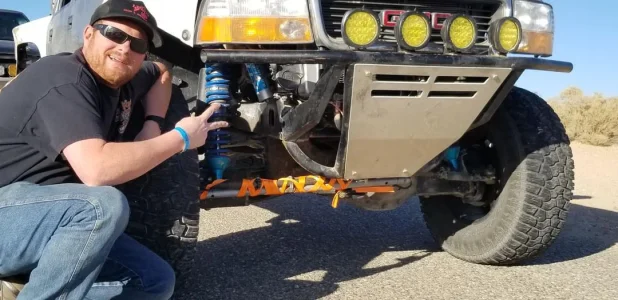

Bryan posing next to our handiwork
Found someone at camp with a Karnage welder and flex cored it back together. A different upstanding citizen hooked me up with a small bit of angle iron to add more strength. Welded together very nicely, and I fully trusted it to get us back home.
