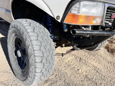

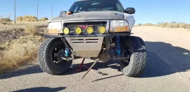

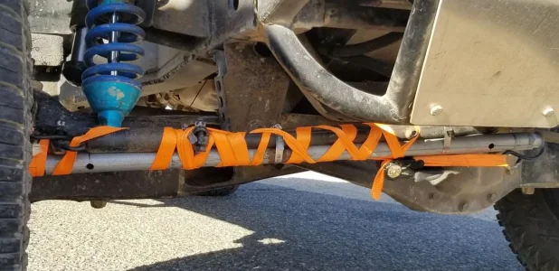

This
lead to this
Tried straightening it out to get back to camp. Tow strap pulling backwards lead to this
requiring this

Lol, I forgot about the "free hugs" your truck tries to give at full droop.
Even still, if you cant feel the bump steer and it isnt a problem, I say re-do your steering out of thicker material (we know youre not worried about weight) and call it good.
