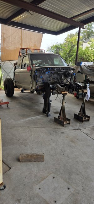

JUST SO I CAN HAVE THE LIST ON THE LAST/MOST RECENT PAGE TO LOOK AT.......

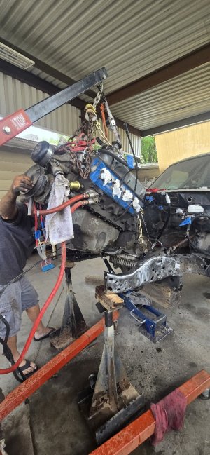

1. take the whole exhaust system off, since im probably going to have to have a full custom one made anyways........
2. hook the engine hoist up to the motor first and get the weight off it
3. snake the motor mounts off
4. jack up the trans off the mount, and get it on jack stands or something it can set on (which im pretty sure is gonna be a task on its on since the fucking trans and motor is touching the firewall pretty much everywhere it can)
5. CUT OFF THE RAD ARM/TRANS CROSSMEMBER MOUNTS
6. then ill pull the motor trans forward enough to get me some room between the engine/trans and the firewall, and get it where it seems to be set and everything will clear. along with this, i need to get a new radiator and fans and figure out that whole mess. where its gonna go, what'll fit, where it'll fit
7. all of that while planning for the trans crossmember/radius arm/ and motor mounts
