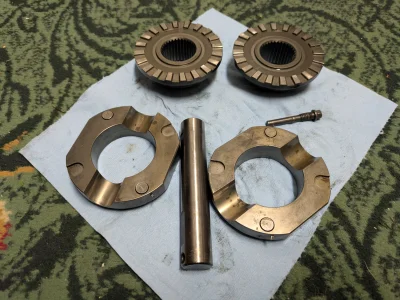

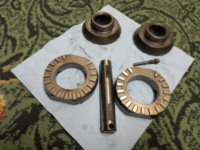

Do you want the lunch box locker that came out of my 99 explorer stock rear end? It only "slipped" twice in about 2 years that I ran it. It took me many places that my open rear end would have failed. Looks to be in great condition. It was $250 new, you can have it for the shipping cost, whatever that may be.
Part number is.
SL f8.8-31
Part number is.
SL f8.8-31
Yeah dude I’ll take it thank you so much!! I’ll send you a message

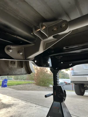

I did take a break from it and installed the upper portion of the cookcraft shock mount. This stuff went together perfectly. It locates itself on the frame with 2 existing holes and you drill the 3rd out out. Big time fancy pants.

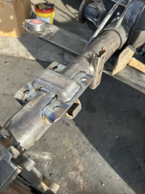

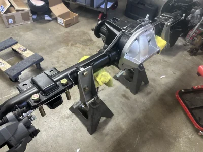

Yesterday I went over to Ryan’s shop and picked up the u bolt eliminator kit he makes. Since I had the axle in my truck I just welded it on over there with the use of his handy dandy forklift!
Years ago swore I’d never spend money on leaf springs again but here we fuckin are😩

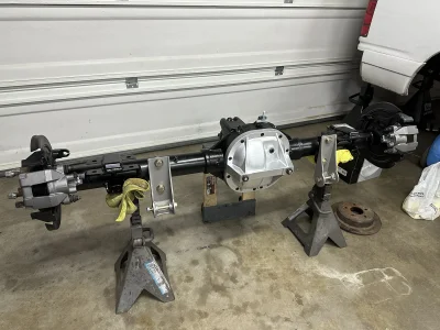

Got some work done lastnight!
Drained the fluid and cleaned up/inspected the gears.
I Installed a new diff cover, welded on some tabs for bulkhead brake fittings, and started bending up some brake lines for it.
I’ve got some stainless hardline and will be using -3 AN for all fittings on this.

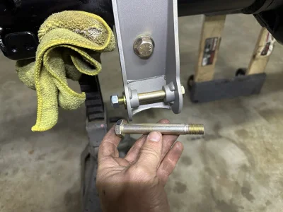

Also bolted on the supplied lower shock mounts and started trimming hardware for it.i love that cookcraft supplies hardware with correct shank lengths with his kits. Little Details like that among others make the extra money spent so much more worth it.

You're so right about the shanked bolts. Every "kit" or bolt on parts I've bought from well know bronco shops come with coarse thread unshanked bolts which get thrown strait into my random bolts bin then I have to go out and get all the right shit. Inconvenient for sure.

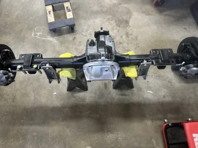

Handled the brake lines on the axle and then assembled the rest of the axle. I’ll be re doing all brake lines from the master to each wheel in stainless hardline and braided steel where needed. -3 AN fittings for everything to simplify keeping spare lines and or caps in the car!

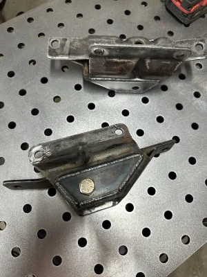

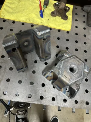

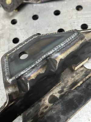

Also cut out some doubler plates for the leaf spring hangers to help avoid any ovaling on the leaf mounting holes and welded those suckers on.IMG_7880.webp
