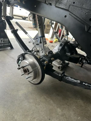

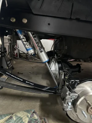

Picked up the cookcraft explorer pack from atlas and tore it down.

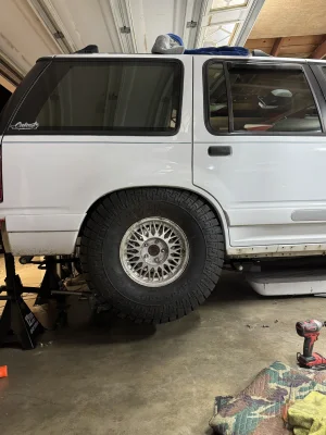

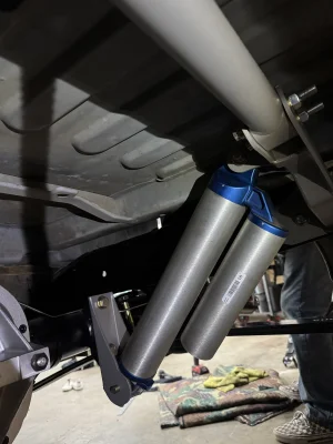

Cycled the rear to make sure everything was a ok. The shocks bump out right when the axle hits the frame so that’s good. Gonna throw a bump stop on the frame so that the shocks never bottom out. I need a bump that stops the axle about an inch away from the frame for 2 reasons. 1 they go far negative arch and it’s a bit concerning.
2. 35s hit the top of the wheel well if I let the axle hit the frame 🥲
Looks like 14.5” of travel overall. Not sure where ride height will be so I don’t know what bump travel is yet.

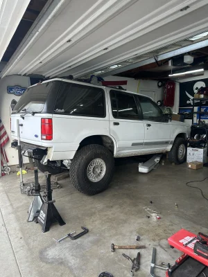

I hope to do final assembly on this thing by Saturday and drive it about of the garage to turn it around and start on the front!

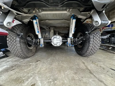

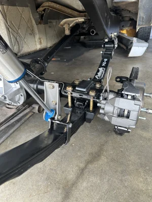

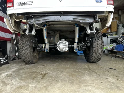

Finished up the back yesterday!

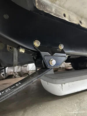

Replaced the junk center pins in the leafs with grade 8 bolts
Ride height is pretty tall right now. 10” of up travel. I’m hoping the springs settle
